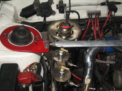

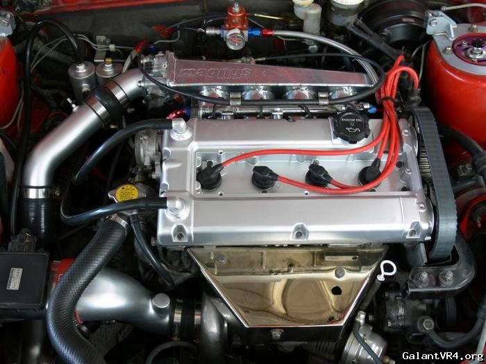

Help it breath by doing a catch tank breather setup like this:
Obviously doesn't have to be too drastic, but you get the idea.

Quoting OSiRiS:
It's popping out due to excess crank case pressure, the engine is getting tired. Crimping the end of the tube or getting a new stick is only masking the problem.
Mine did the same thing, dipstick popping out, till I had a setup EXACTLY seen in this picture. Get a catch can with two inlets and a filter, and it will fix it! It only pops out a little bit instead of all the way. Also, replace dipstick with a 2g one and you should be good to go.

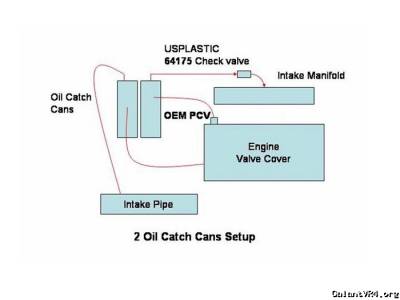

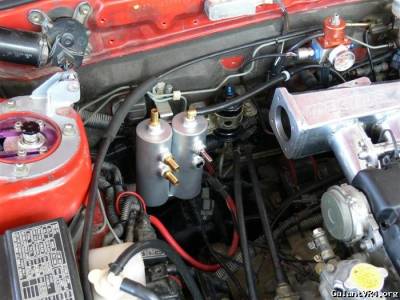

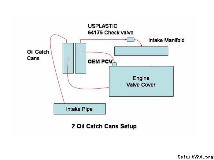

what about this two oil catch can set up i saw in the dsm forums? i read there that they prefer a filter-less system. dont know why.
i have a couple of questions about this set up:
1. im planning to DIY my own catch cans. is there any special materials that are inside a catch can? or is it just a plan can that stores oil? can someone show me an inside of a catch can?
2. on this set up, why do i have to connect one of the catch cans on the intake manifold, and the other on the intake pipe (please see diagram)?

Quoting chrisb33:
Thy wanted to run it pretty much the way it came from the factory. Probably for emissions reasons, or to prevent the smell of oil vapor, or possible to put a vaccume on the crankcase(which is a good thing to do, but the hp gains from doing this on a small displacement engine debatable).

ktmrider
Sep 10, 2007
3,128
Tempe, AZ
^^ +1, without a vacuum source ( in reality a lower pressure area than the head ) the vapors don't evacuate as well.
Excellent write-up with dyno testing in this months Import Tuner mag showing that filters don't anything and can even cost power.
Dialcaliper
Jun 22, 2007
1,303
Bay Area, CA
The "filterless" system is better because it pushes and pulls air from the intake, past the MAF sensor, and also routes to the intake manifold when it's under vacuum so it pulls fresh air in from the intake. The stock vacuum routing was actually designed pretty well from a performance standpoint, as well as from an emissions and economy standpoint. Double catch tanks and a check valve are the most optimum setup short of actually running a crankcase vacuum.
A breather catch can open to the air either doesn't replace with fresh air and doesn't pull a vacuum, or you're constantly pulling in unmetered air to the intake. Filter setups with no manifold/pcv connection also tend to spray oil vapor in the engine bay, which both gunks things up, and is also vaguely flammable if it ends up somewhere like on the exhaust manifold.

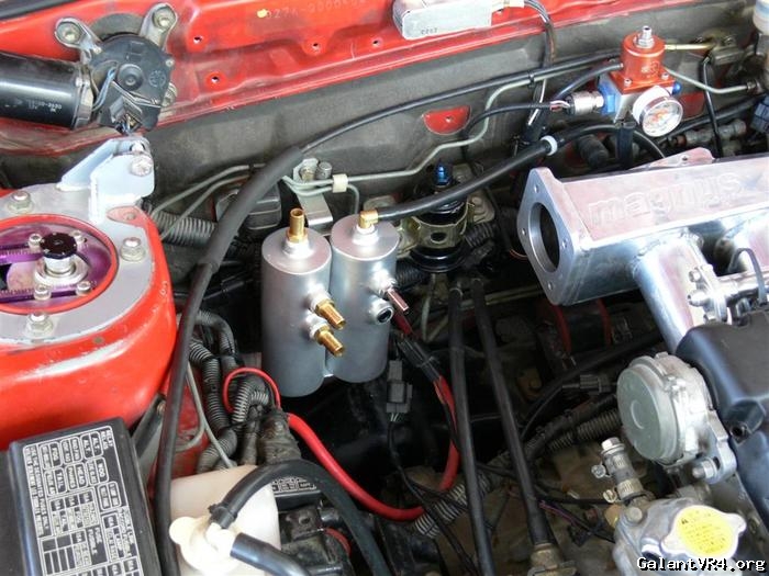

thanks to a guy in the dsm forum i am now in the process of making my dual custom catch can set up. much like the dual catch i posted above. I will post pics soon when it's installed /ubbthreads/images/graemlins/smile.gif wish me luck!

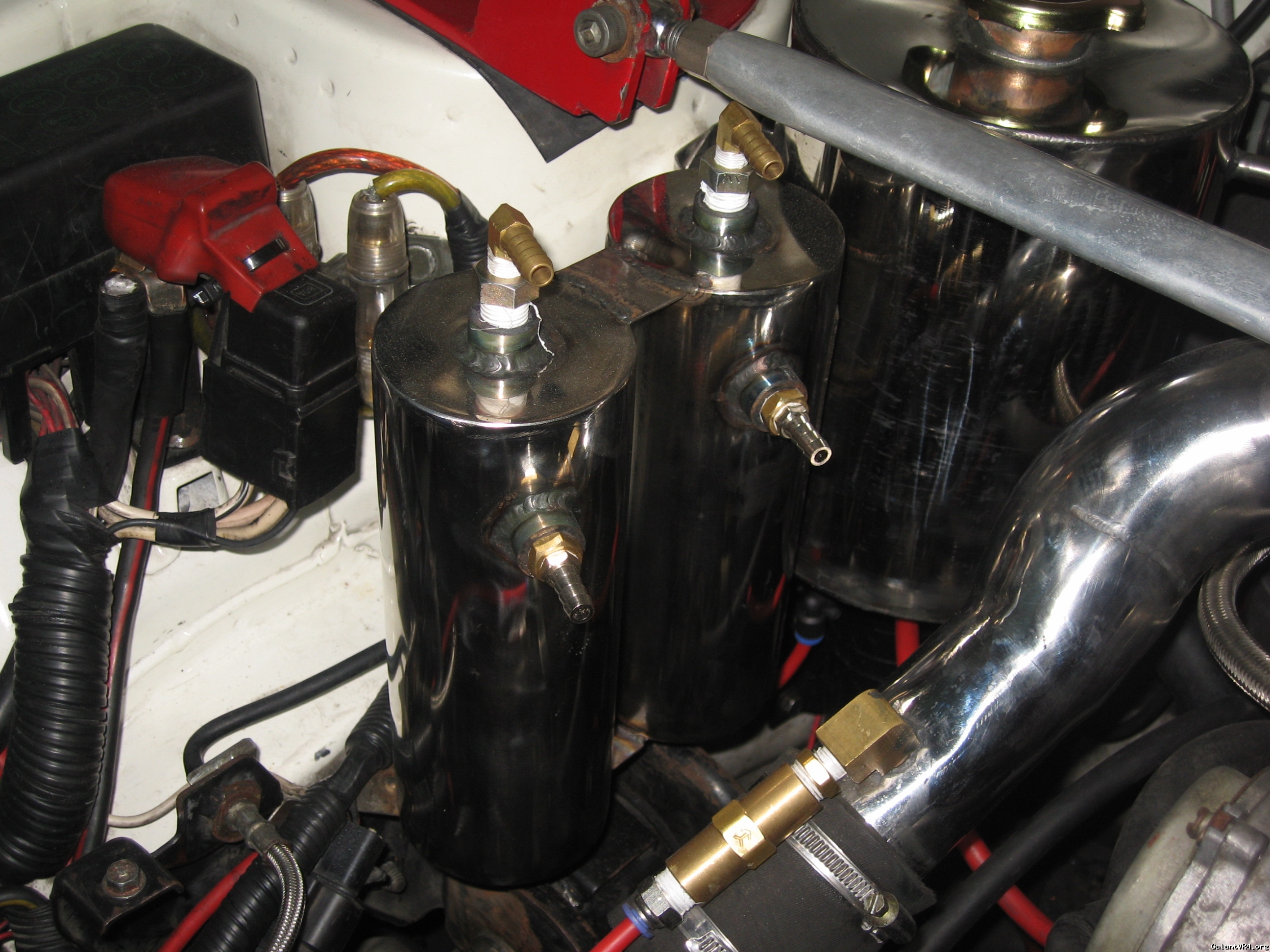

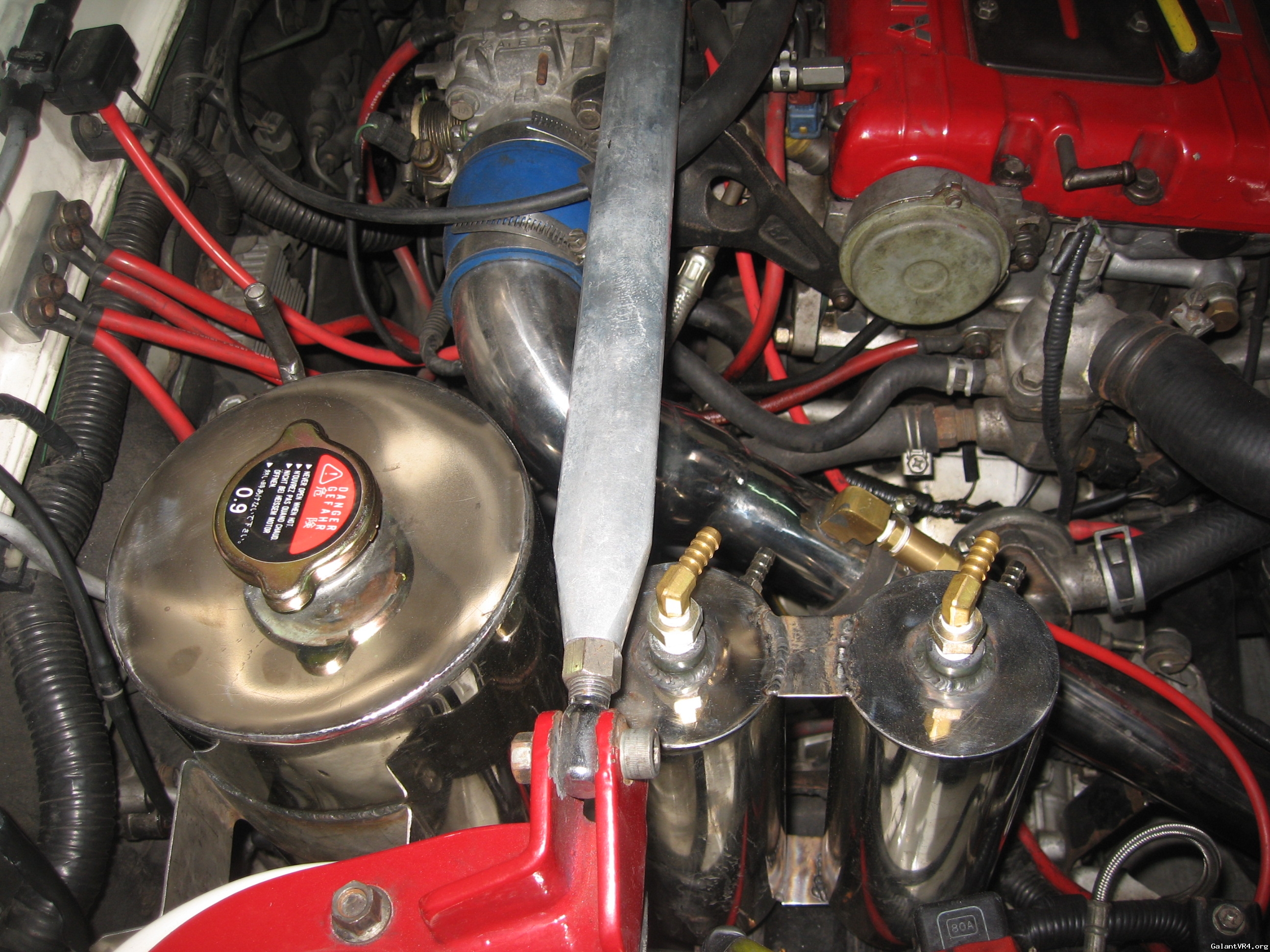

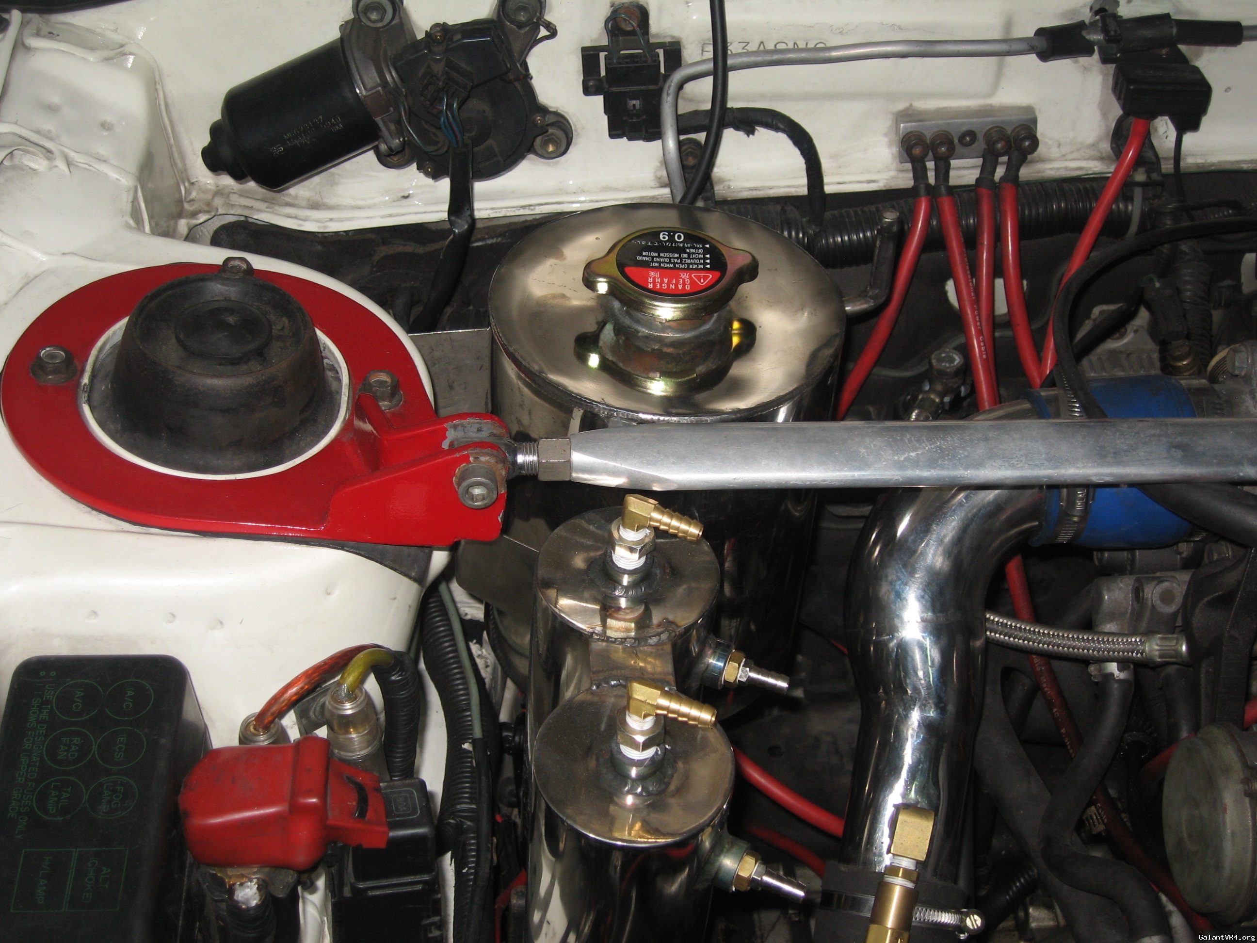

ok im almost done with my dual catch can set up /ubbthreads/images/graemlins/smile.gif all i need to do now is to buy silicone hoses so that i can hook them up!
here are some pics to share with you guys. the catch can is made out of 3" stainless steel with a drain plug underneath. the big tank you will see with the radiator cap is also a custom made 6" stainless steel methanol tank that holds a gallon of meth. fittings are 3/8 NPT's
will post again when i get the hoses and everything is connected already. /ubbthreads/images/graemlins/smile.gif
