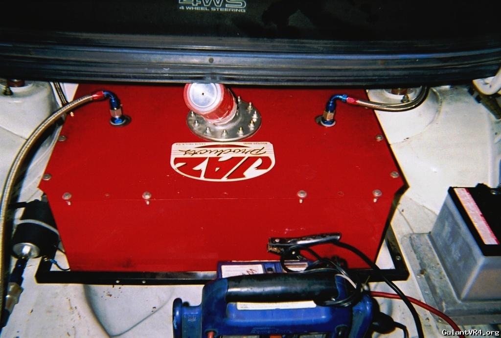

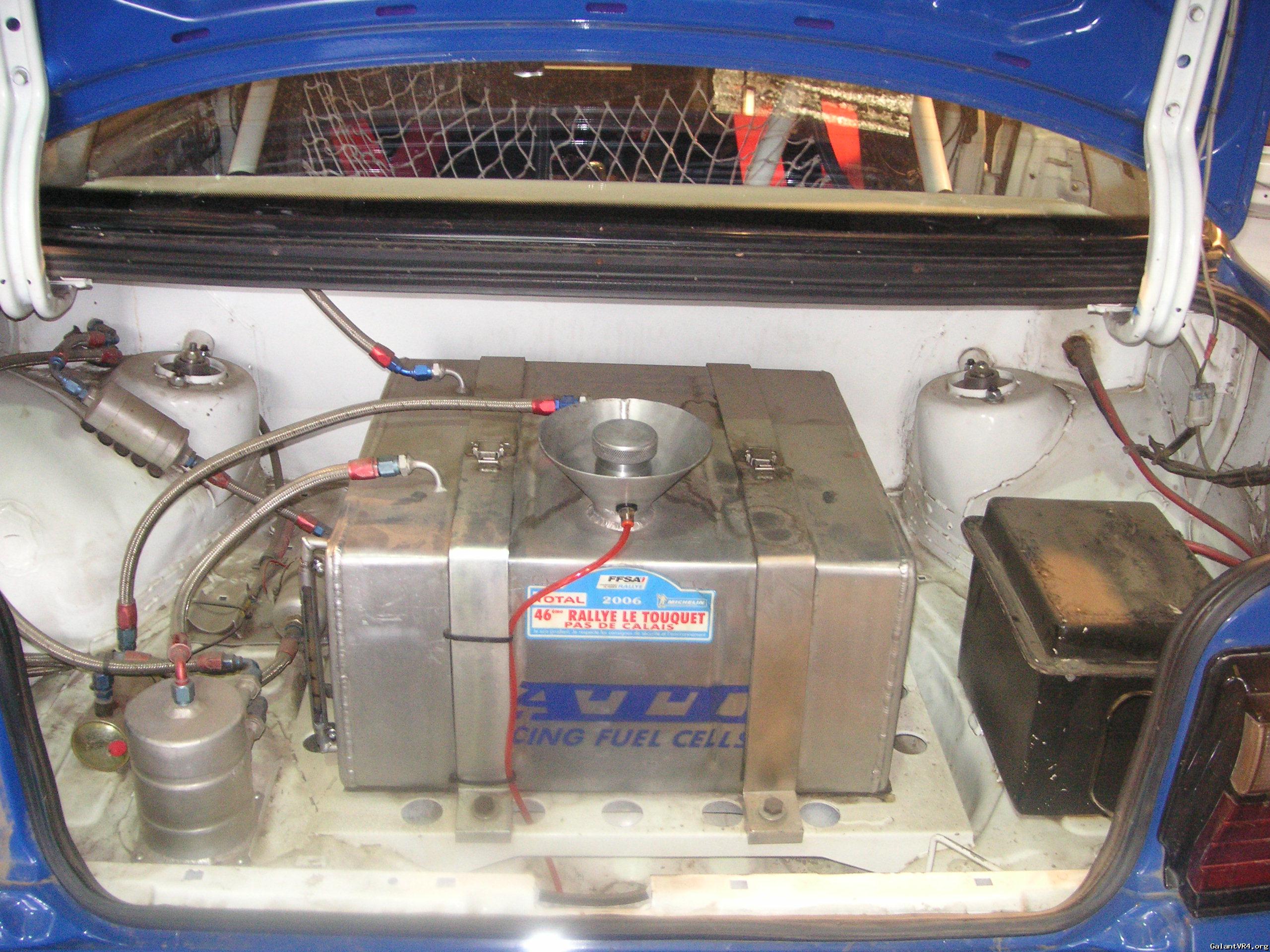

Fuel cell is not right to the works cars, nor is the cage. On the works cars its up into the trunk so rocks and stuff fying under the car can not catch it.

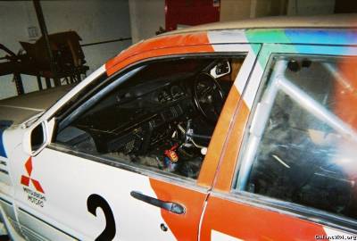

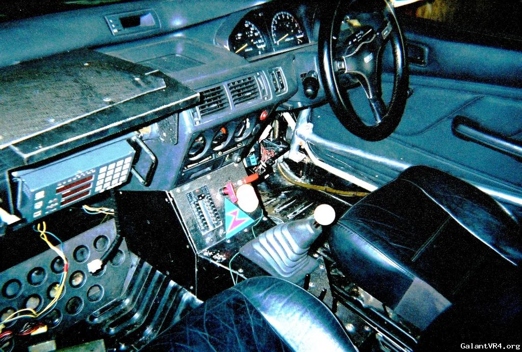

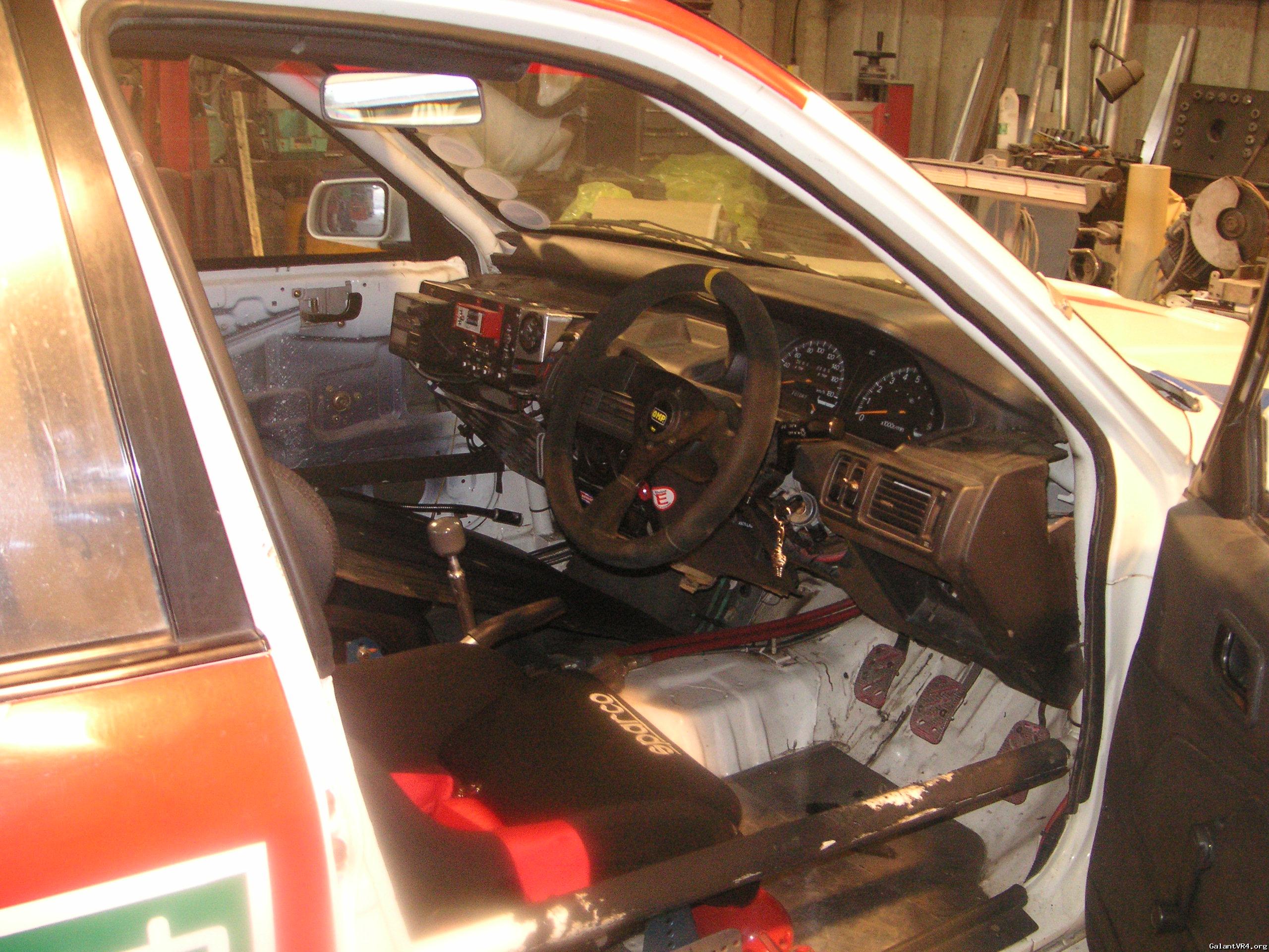

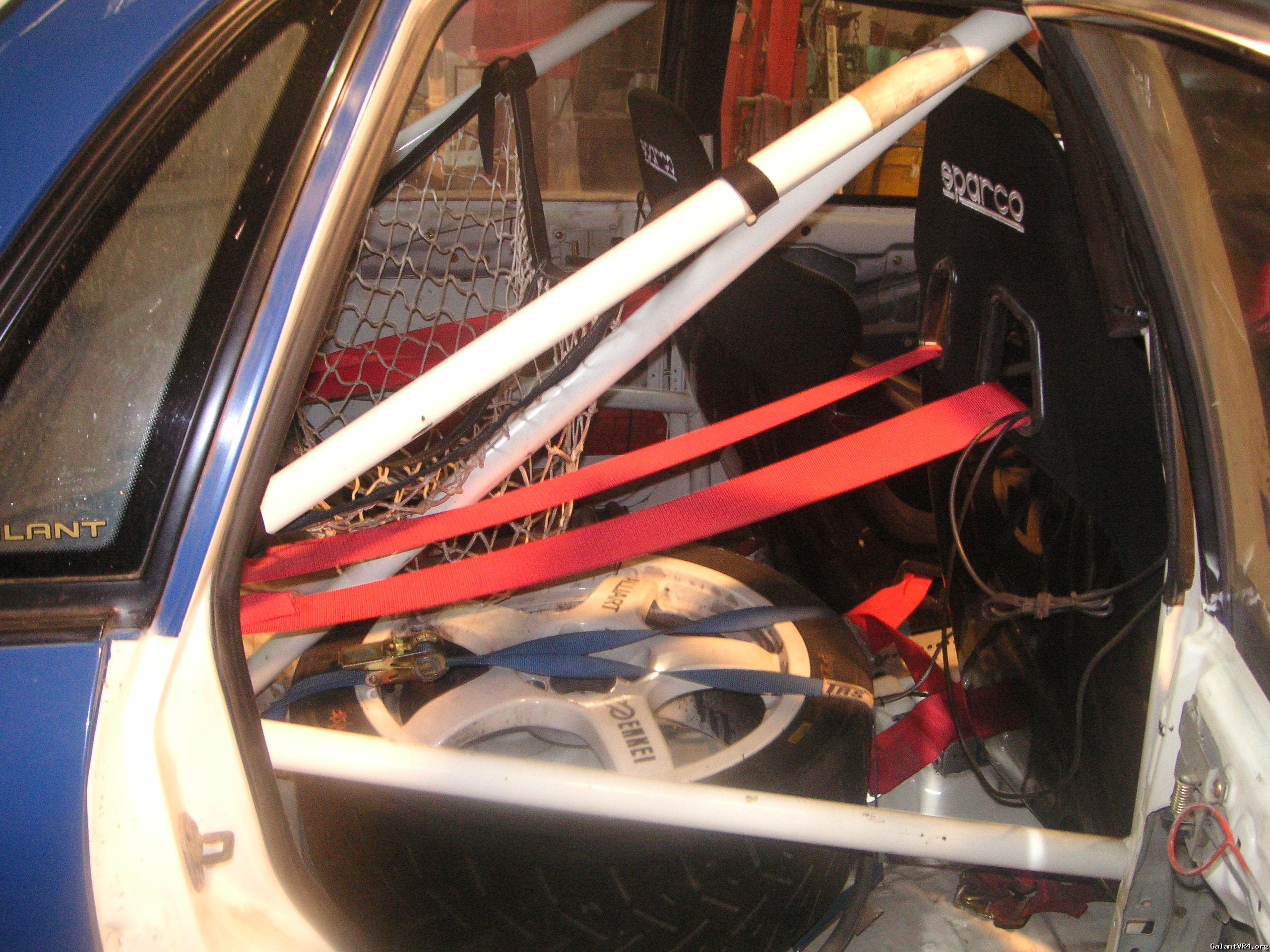

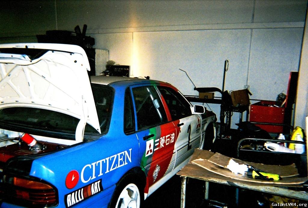

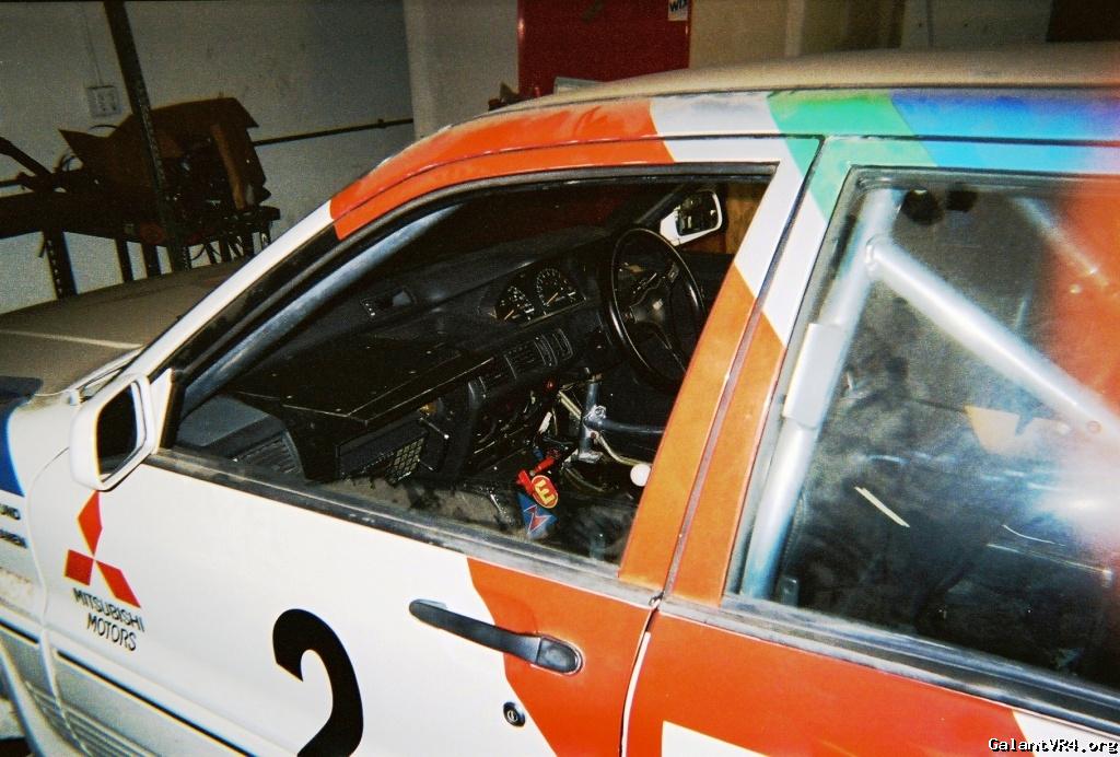

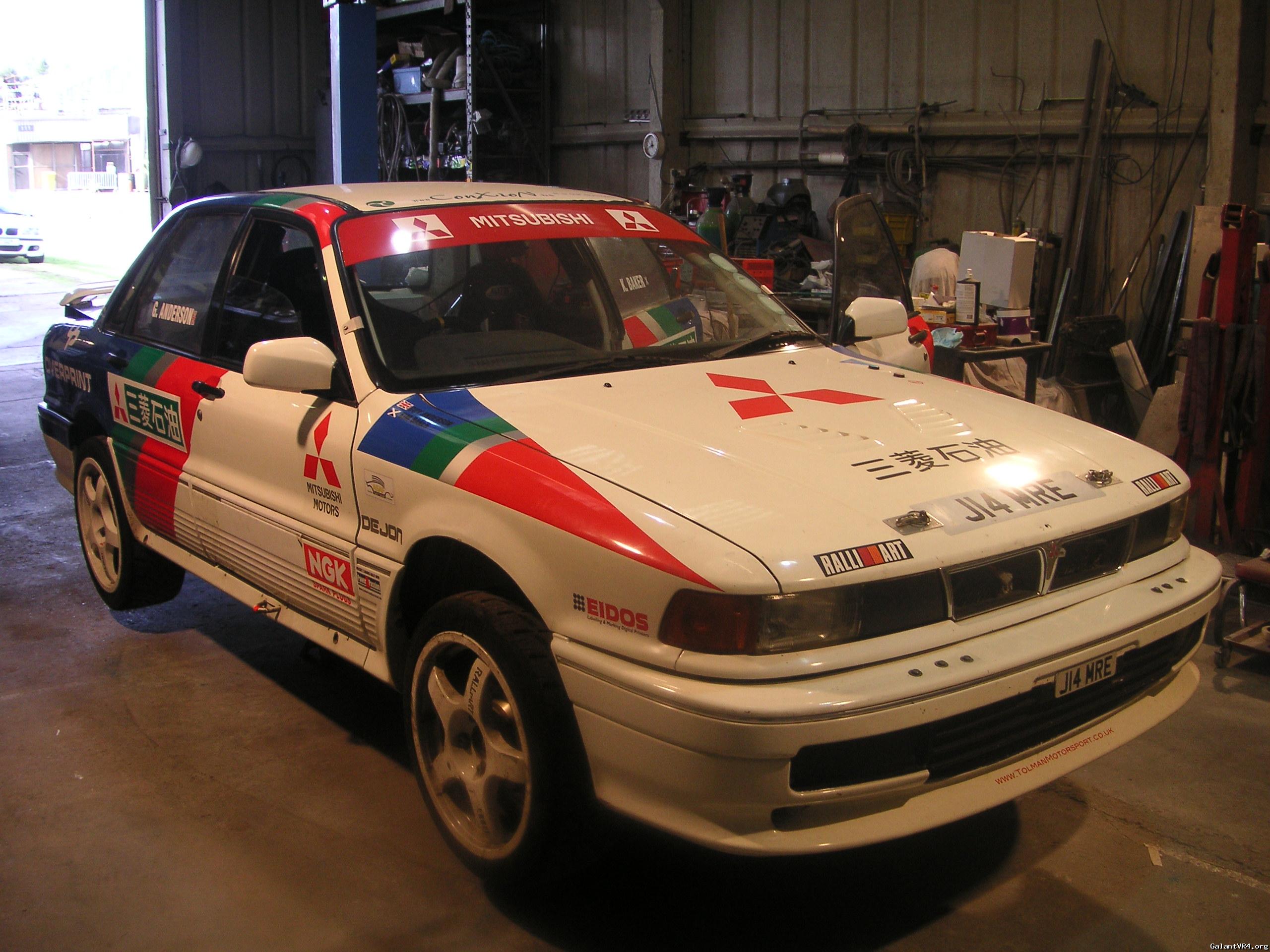

Here's a few pictures of the WRC car RRE or road race motorpsorts had in their garage when I visited sometime ago. I cannot remember the exact conversation I shared with Robert about the car other than it was a JDM model. Either way hope this helps.
RedTwo
Jul 16, 2008
1,917
New Zealand

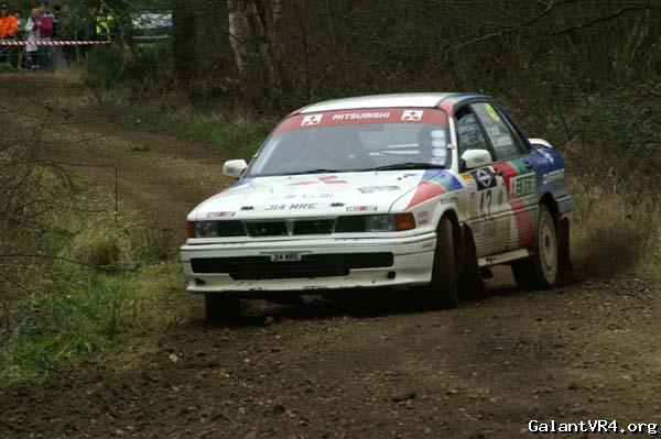

Im very lucky i actually own the real deal,to be fair you would struggle to build a works spec car but you could get fairly close,40 man hours go into welding the shell alone,then theres the double floor skin and cage to be fitted,and thats from an acid dipped bear shell,if you have time and money you can do it,or you could allways buy mine which is ready to go with history for an undisclosed sum /ubbthreads/images/graemlins/wink.gif

Wait. mrgravel = J14 MRE? Holy sh*t.
Small world. I've been using a shot of your car in the banner on my website for more than a year now. @fastestcat on Twitter told me about you. Heard the car was in the shop recently after an off. Sorry to hear that.

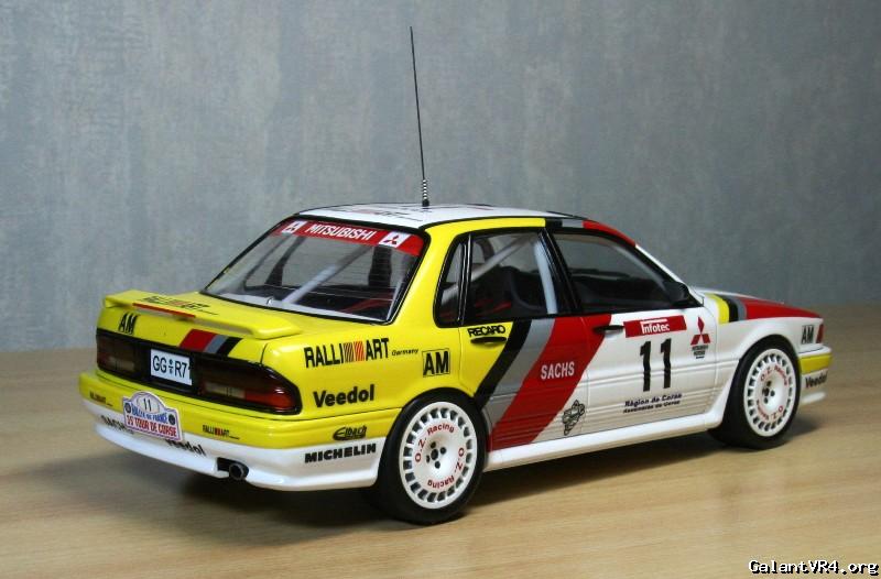

Erwin Weber won the European rally championship in a gvr4 with a similar paint scheme to the works cars, but with yellow replacing the blue (and, black instead of the green stripe) as seen in this video: link
