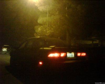

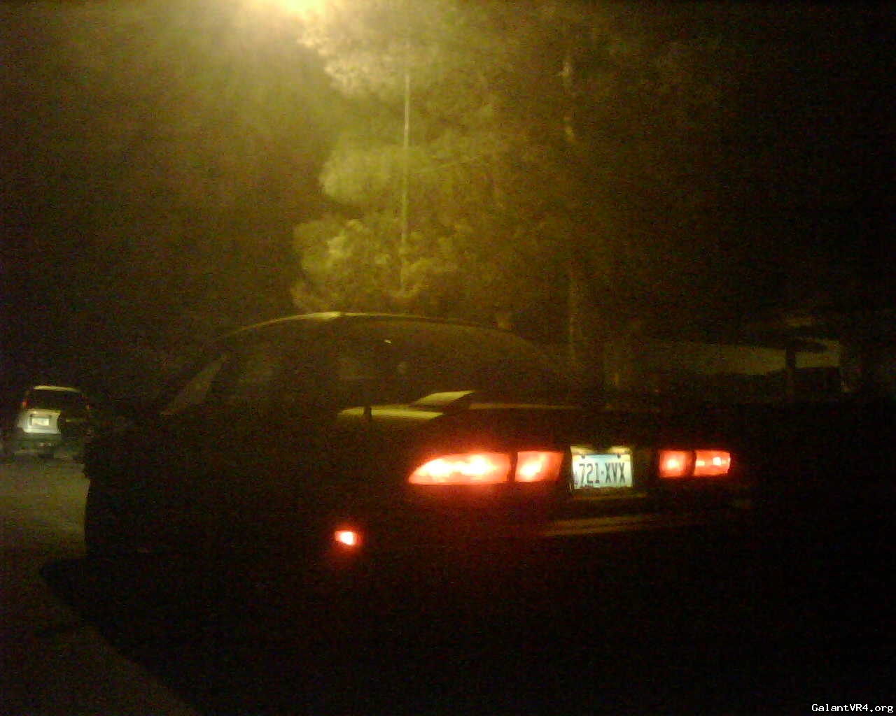

Here's a pic of the car idling on the street in front of the house after a nice little 15 minute test drive...

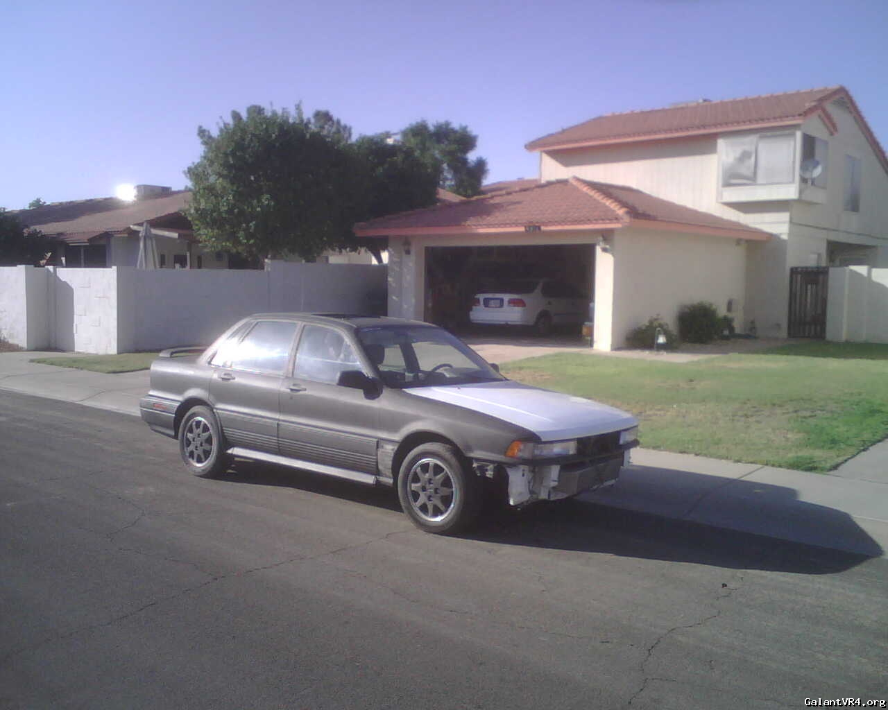

Here's 195, looking like a regular old Galant, parked out on the street in front of the neighbors' house while I move the truck in the driveway to get it back in the garage. Looks so nice. LS fenders seem to be missing the dogleg lower screw holes in addition to the lower snap-retainer hole compared to the GVR4 fenders. And yes, I will paint the hood to match. I've just got an idea I want to try first. Can we say "GalantVR4.org: The Anti-Rice" and "Can I get this old girl into Members' Showcase?" lulz

Big pimpin', that looks like a car again.
You've come a long way man.

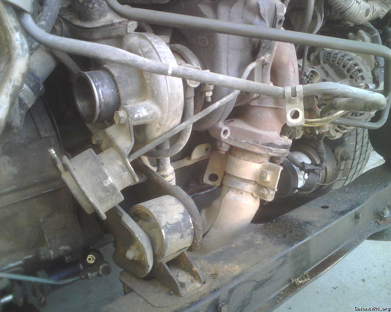

EDIT: Remember this picture? (Between the 4WS hardlines, on the hot side.)
