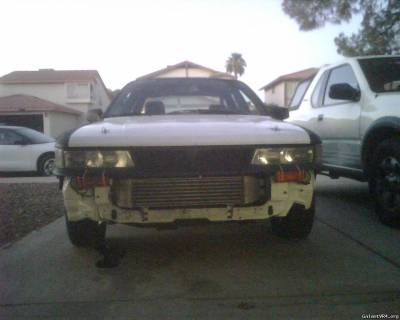

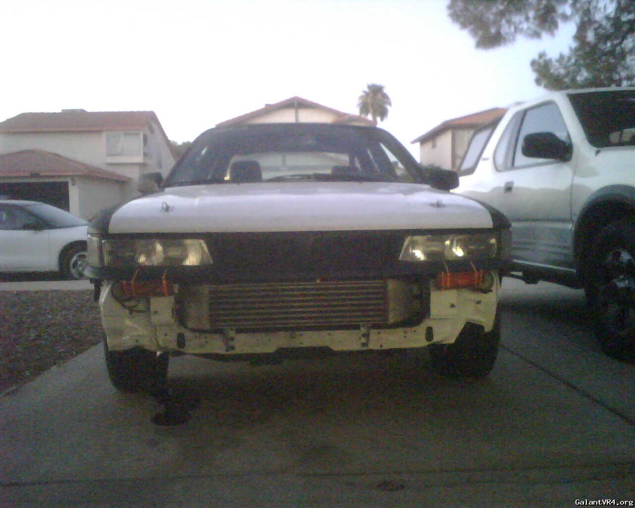

Roffles. I have always wanted to troll the streets for a few days sans bumper cover to issue a warning to the ricers a la FMIC. This is my first FMIC, so I'm going to enjoy the open airiness of things for a couple days. Tonight, however, we're ready to go to work tomorrow.
Angle brackets mounted below the fooler are bolted to the core support. I'm getting ready to mix up a batch of JB Weld to fixture the bottom of the intercooler to their tops. This should keep it level and secure.
Tomorrow is also my first night at Home Depot for the second job. Free time will be at a premium, so I'll be wrapping things up in bits from here on out, but yes, the bumper cover is definitely going back on. The level 3 inspection I have to get for the restored salvage title will test all my lights, door fitment, and safety equipment. I'll have to do a fine adjustment of the shifter to get it to activate the reverse lights, finally address that damn latch plate on the driver's front door, and - get this - troubleshoot the horn. If I unlock the driver's door from outside by reaching through the window, the damn "alarm" goes off, but the horns won't sound on the button. Might be the 1G wheel I've got in there.
In any case, it's been a long and weary road to get here, but I'm stoked to be able to drive the car to work tomorrow. I actually drove it over to my inlaws' house this afternoon to use the drill press for finalizing the intercooler mounts. There's still a lot of work to do on 195, but I think it's safe to say this GVR4 has returned. (Even if only unofficially at this point.)

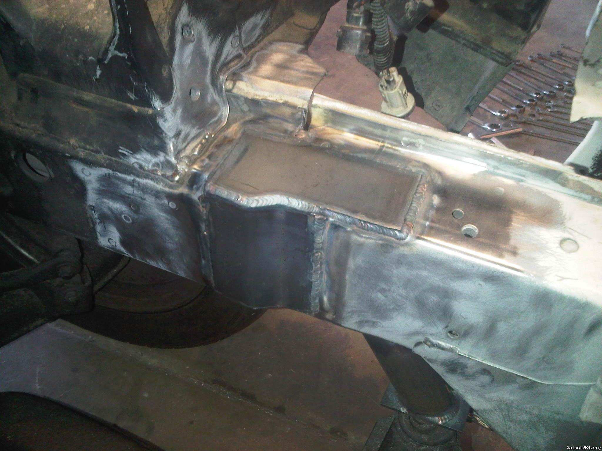

LOU: Long Overdue Update

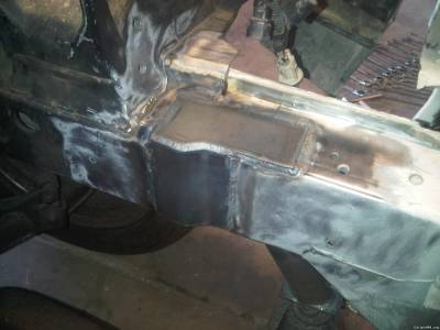

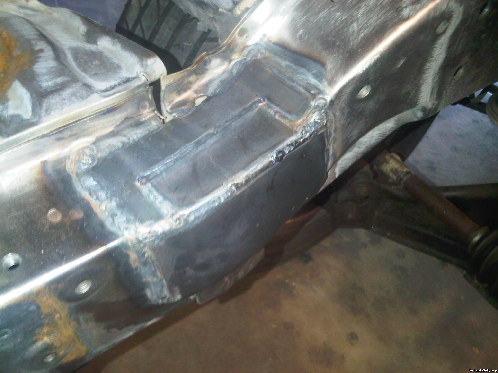

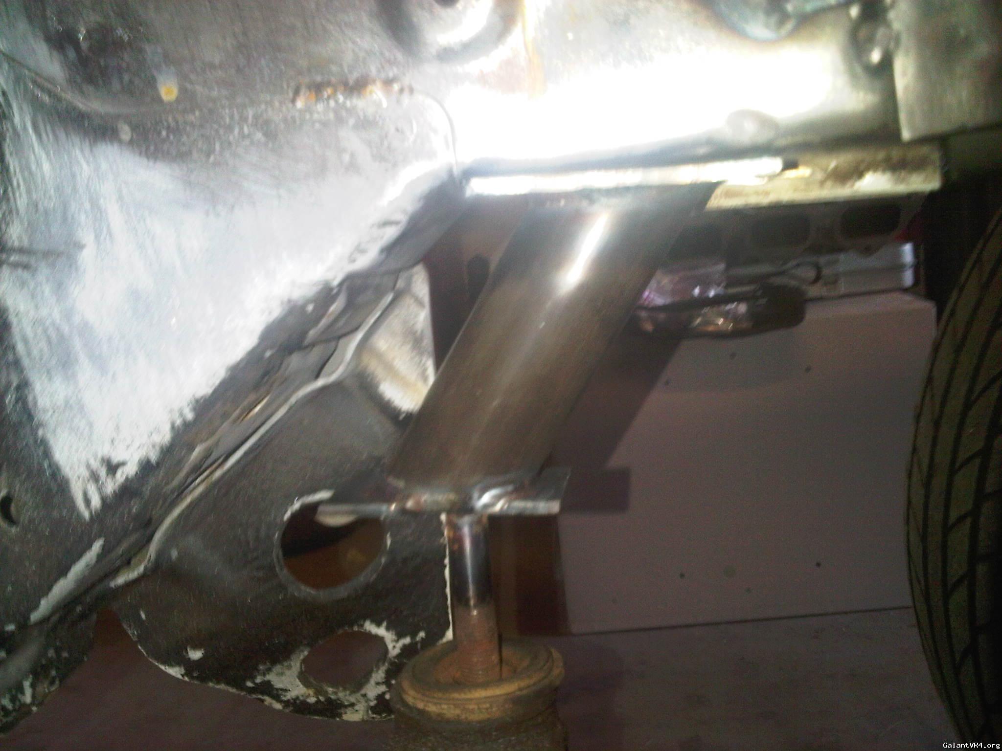

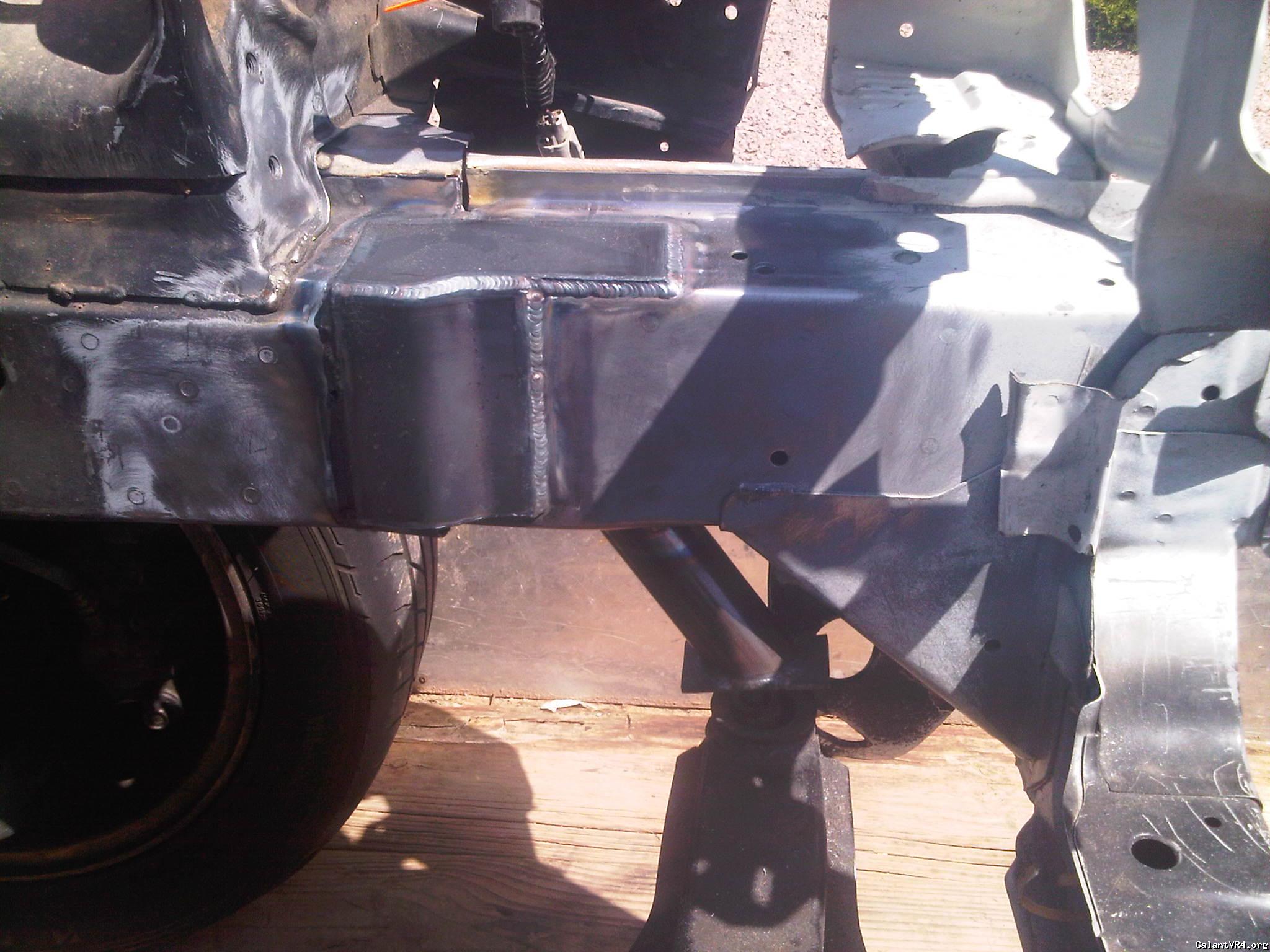

I stripped the front end down again, pulled the engine, and took the car to AMM's house so he could take his time doing FINAL, final front end repairs. 195/2000 is OFFICIALLY back to Square One of the rally car build. This was supposed to happen at Kent's shop, but I was able to help out two friends by letting Mike do it. We still need to lay down a couple Mig beads on those CrMo crossmember mounts, but otherwise, the front end is solid.
In the last picture, you can see how it's a bit too tight to get the Tig in there, so that's where we're going to use the Mig. The stamped steel unibody is a real PITA to weld up. Super thin in some places, gooey adhesive between layers in others. Getting a non-contaminated bead can be tricky. Regardless, I'm very happy with the way this has turned out.
I've sourced a Cyclone manifold and will be controlling it via EPROM as part of a speed density conversion. I'm also going to be running some hard piping for the SRT4 FMIC. First, though, I'm going to clean out the engine bay and paint it white. White makes it a whole lot easier to spot trouble imo. After that, I think there's time before MOD to get the car over to Kent for the front and main hoops.
