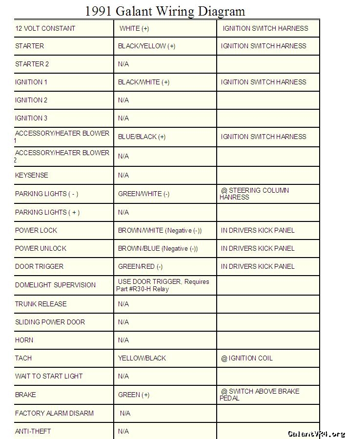

I have a Scytek VisionGuard 8000 two way pager alarm, I've gotten most of my wires connected except the remote start harness. I've encountered one problem so far.
Door Trigger = Green/Red (-) Driver Kick Panel
I connected this my alarm harness's Door Trigger (-Neg Wire) and when I arm, it sends a message saying tamper, door error. When I switched connection to (+Pos Wire) there's no error, but doesn't recognize door opening.
Should (-Neg Wire) be connected and (+Pos Wire) grounded?
Also has anyone connected Dome Light Supervision on whenever you unlock car? How is this hooked up? I read you need a relay, so connect before the door trigger wire also?
