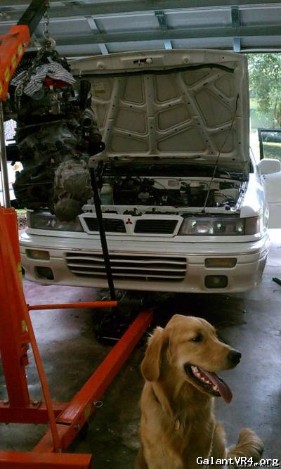

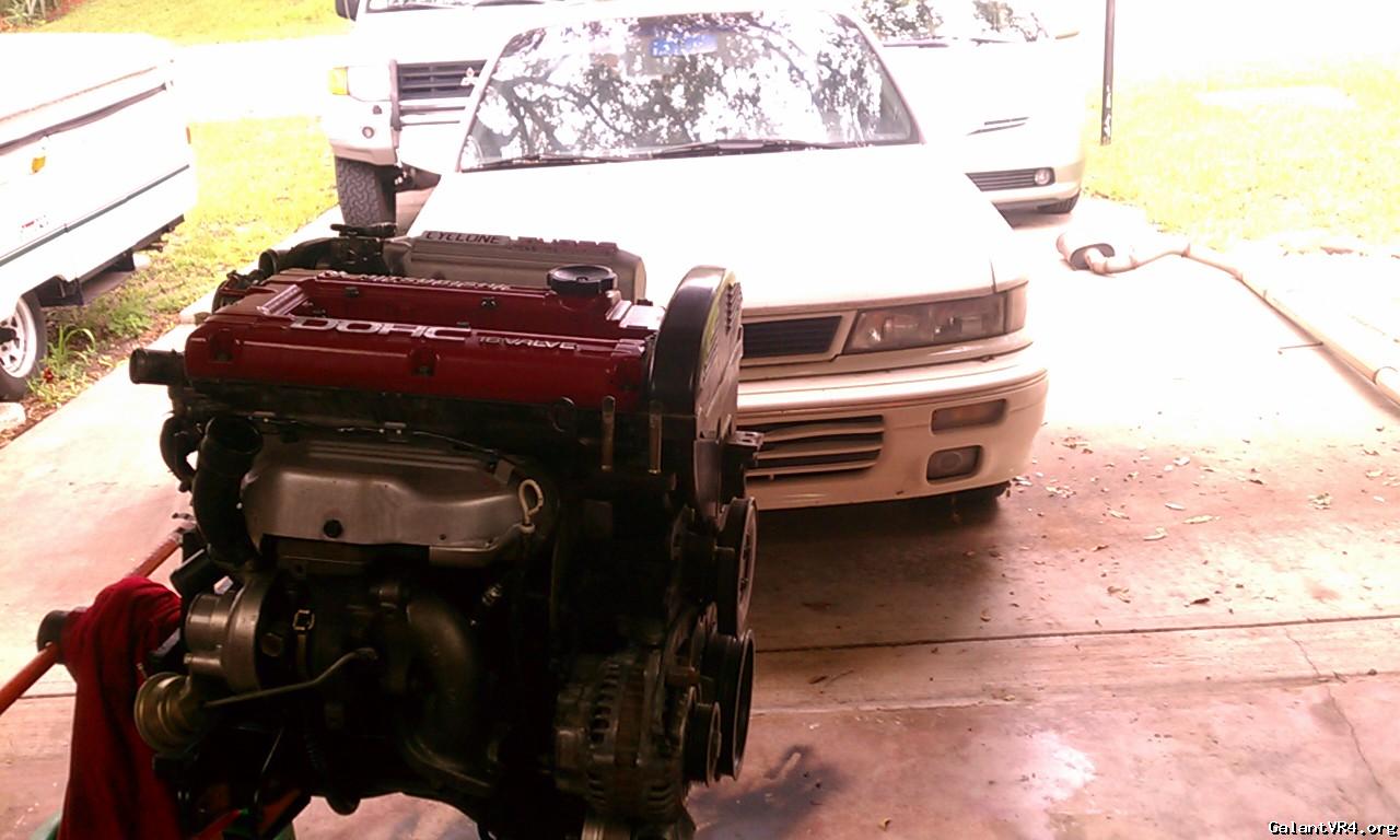

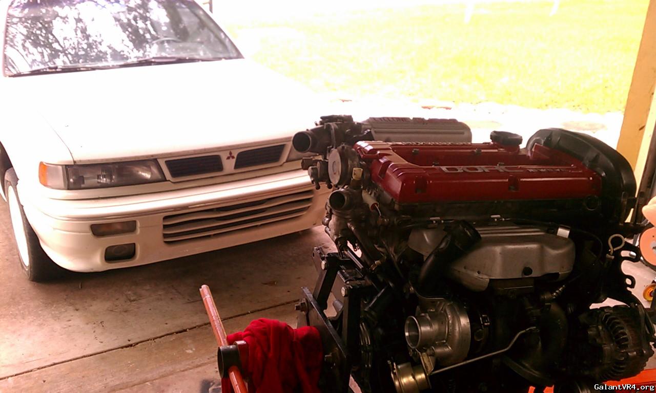

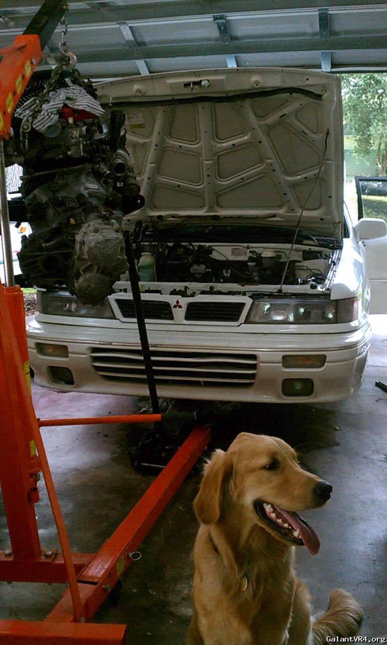

Well after a few months unexpected delays I was finally able to work on the Galant today. Round 2 beins! I'm just going to get it running again and do the SD conversion later. I need it for a DD ASAP. So I found the culprit, one rod bearing has spun. I got eagle rods, wiseco pistons, a new crank, HKS cams, evo3 16g, and a cyclone intake going back in. Here are a couple pics from today.
Owen did most of the grunt work.

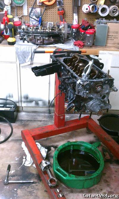

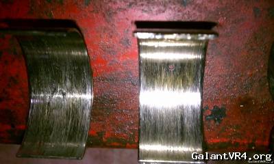

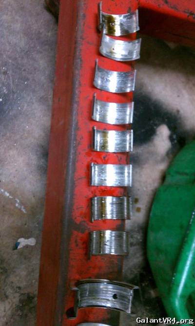

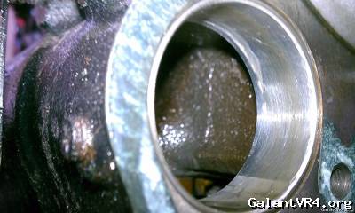

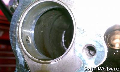

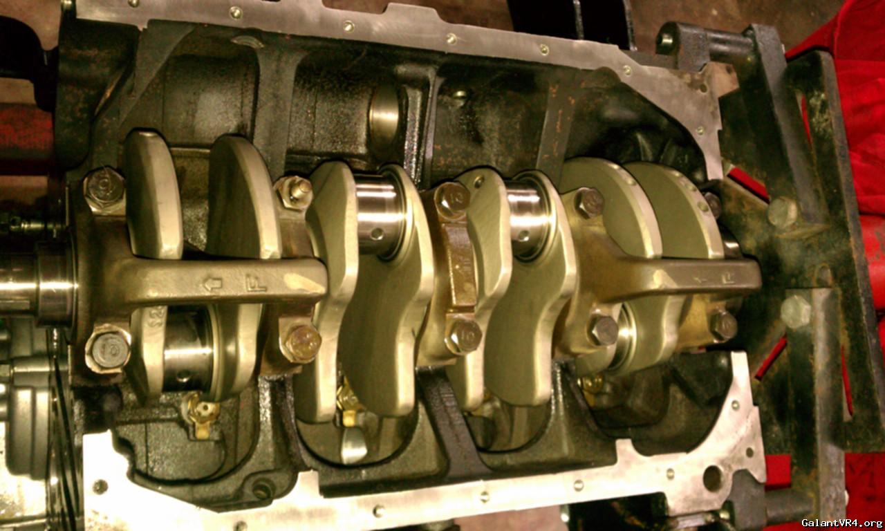

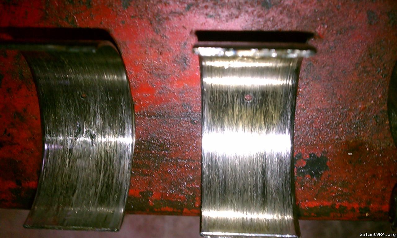

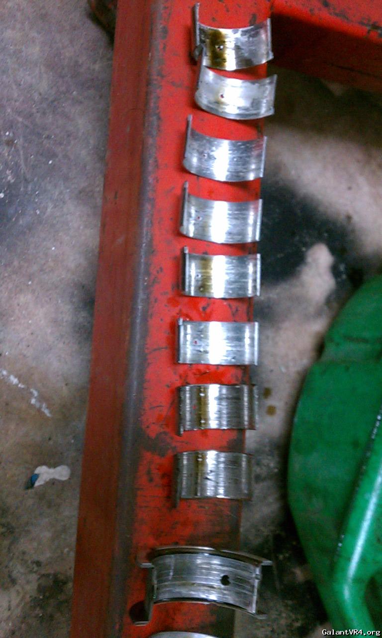

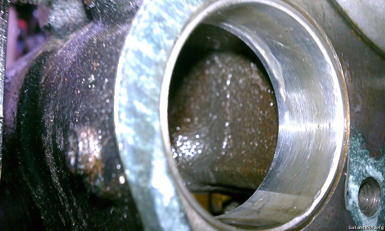

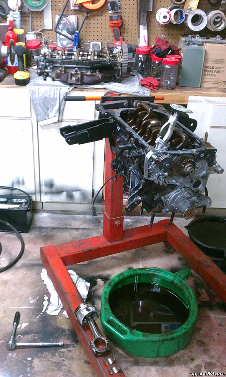

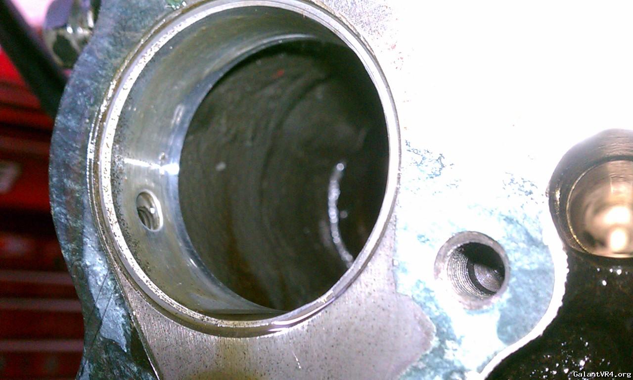

OK guys, need your help. I completely disassembled the block today and found that all of the rod bearings were wiped and the mains didn't look to hot either. I also found something strange. One of the BS delete bearing is wiped. How that that be? There is no moving parts on that bearing! The engine did not encounter a "catastrophic" event. It was still running when I parked it. I want to make sure to find the actual cause of this failure before I put all the new parts in. Have you guys ever seen damage on an used BS bearing before? Thanks for looking.

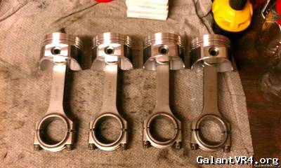

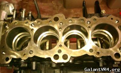

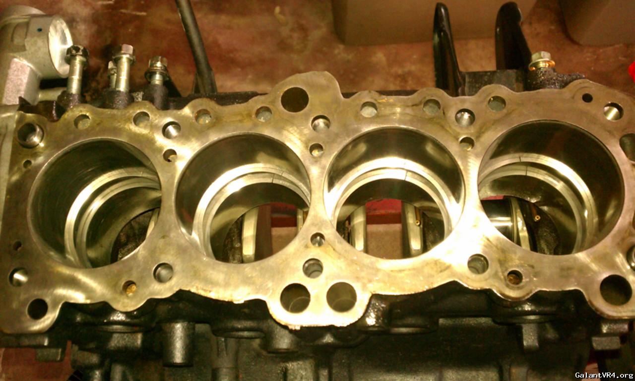

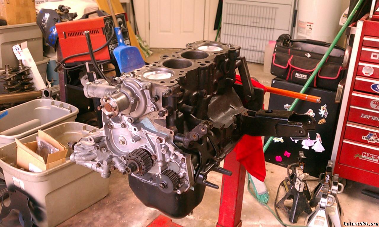

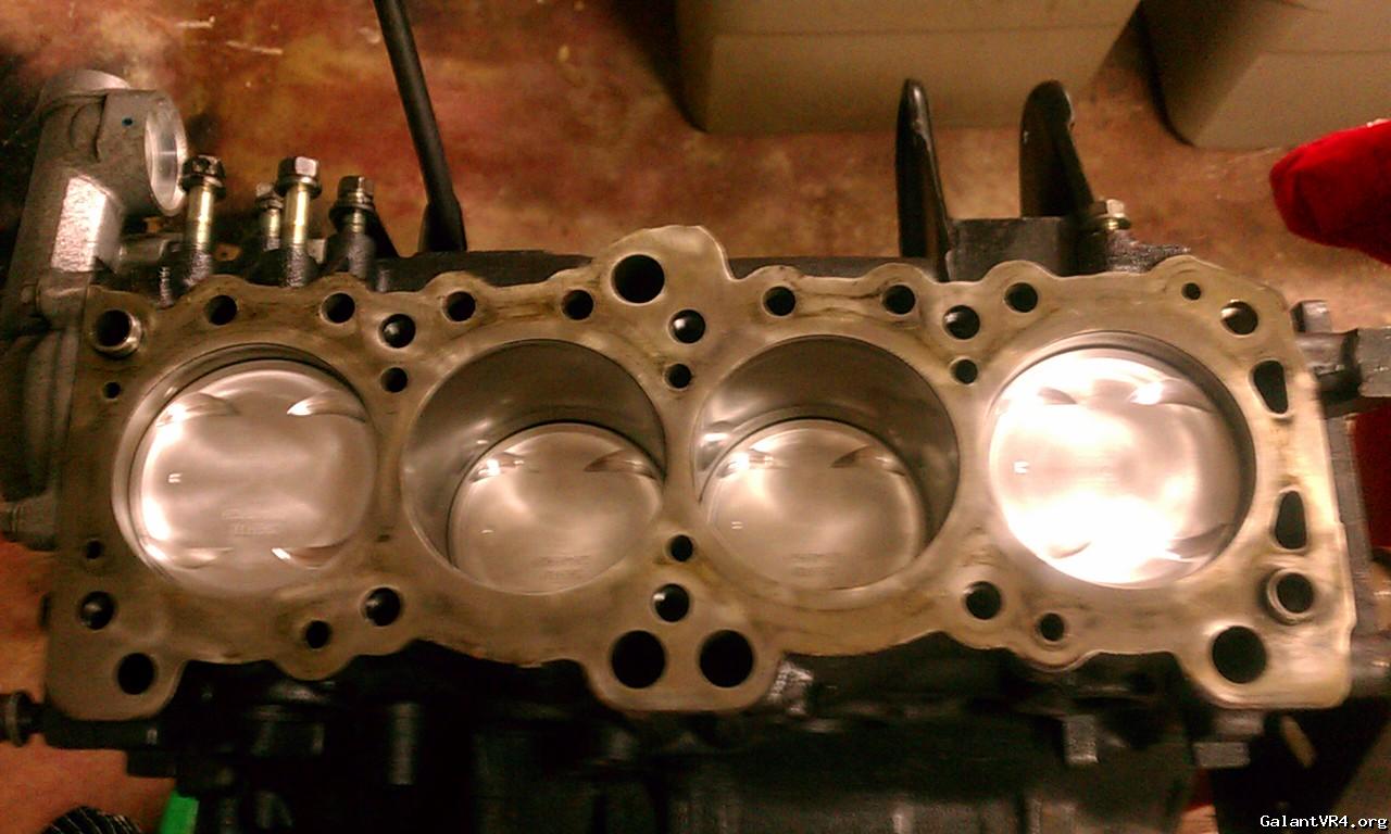

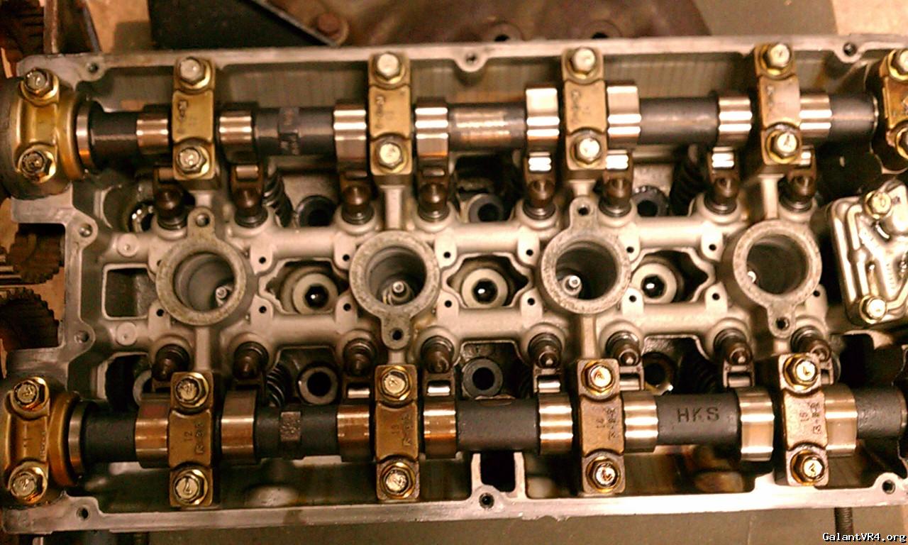

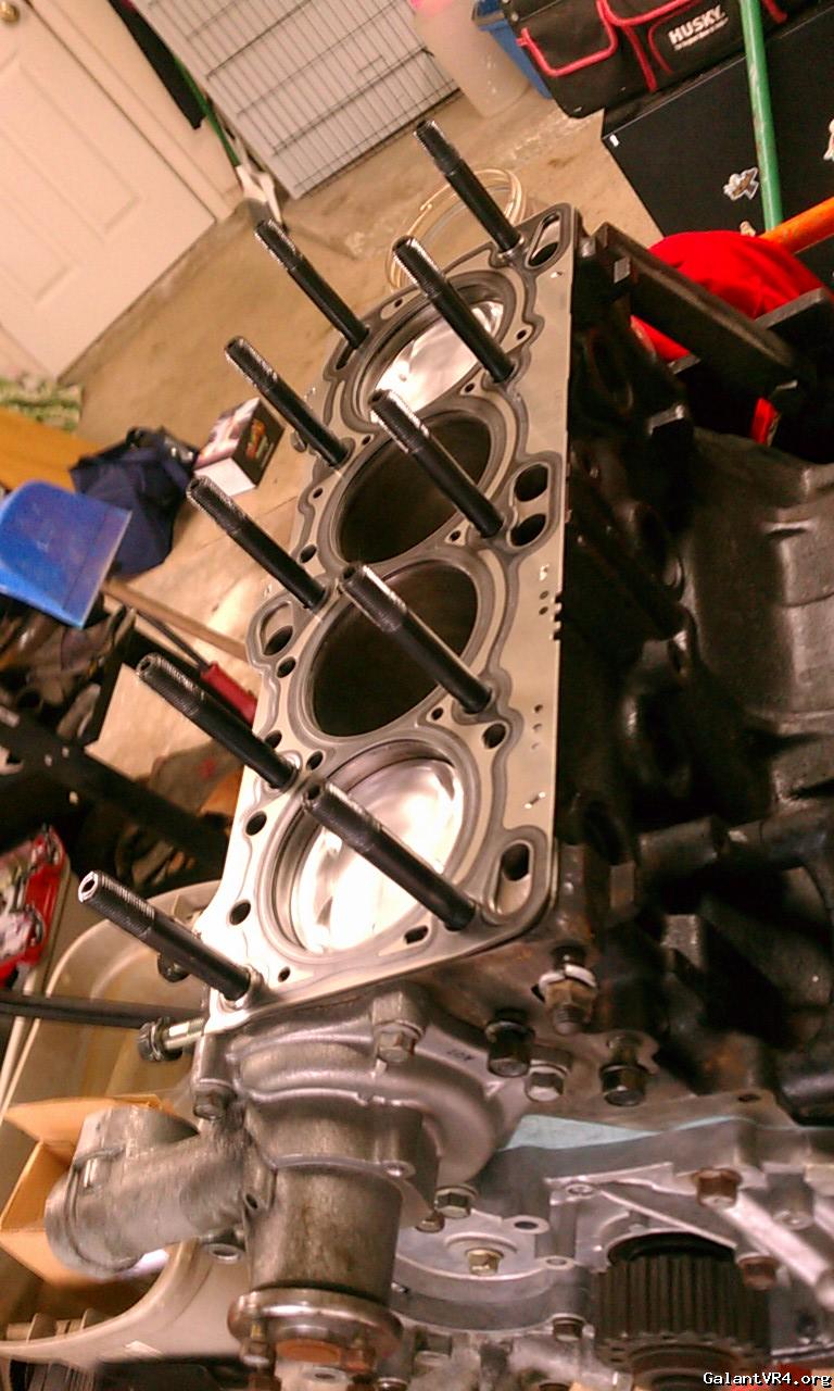

Finally finished the bathroom project so now I can focus in on the Galant. Here are a couple pics of the recent progress.

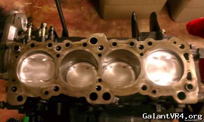

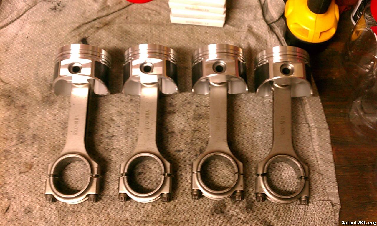

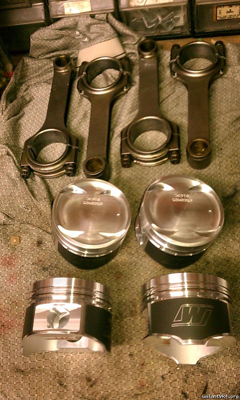

Eagle Crank installed (we'll see how she does)
Wiseco 9:1 pistons and Eagle rods
Ring gaps set at .019 and .024
Pistons hung
Pistons and Rods installed
HKS Cams installed

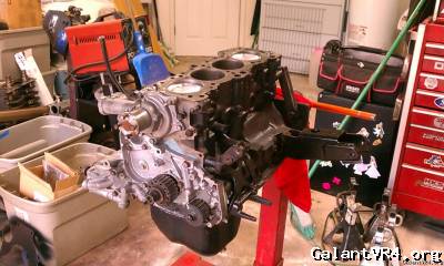

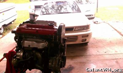

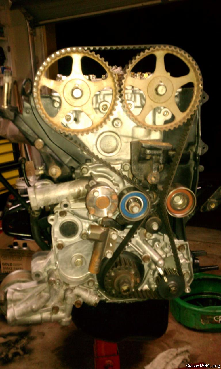

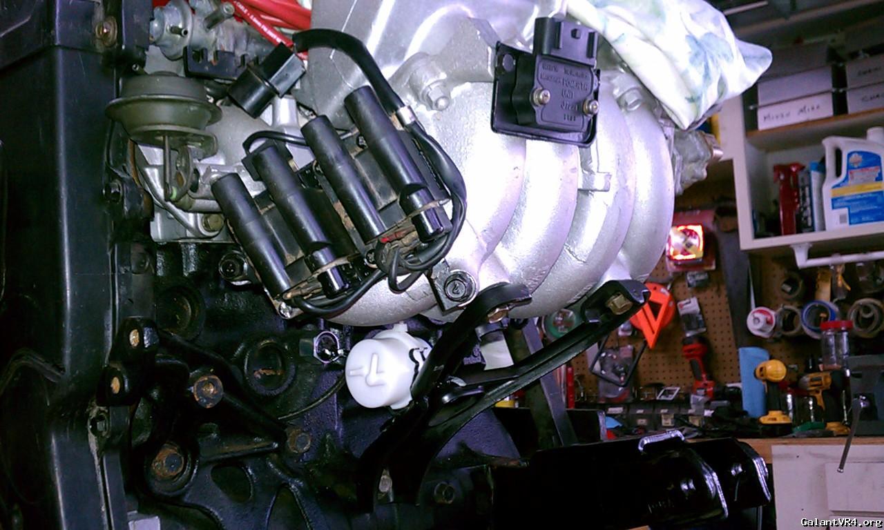

OK, got some decent work done this weekend. Not as much as I had hoped for but it rained for a while. She's all ready to drop in next weekend. Here are some pics:
Front case cleaned, primed, and installed
Head about to go on
Timing on
Nom Nom...
Nom Nom Nom...
Nom Nom Nom Nom...
Big brother looking on...
matt92vr4
Oct 3, 2010
676
Venice, FL

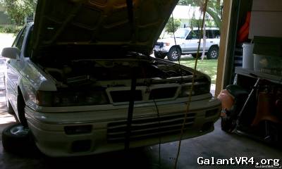

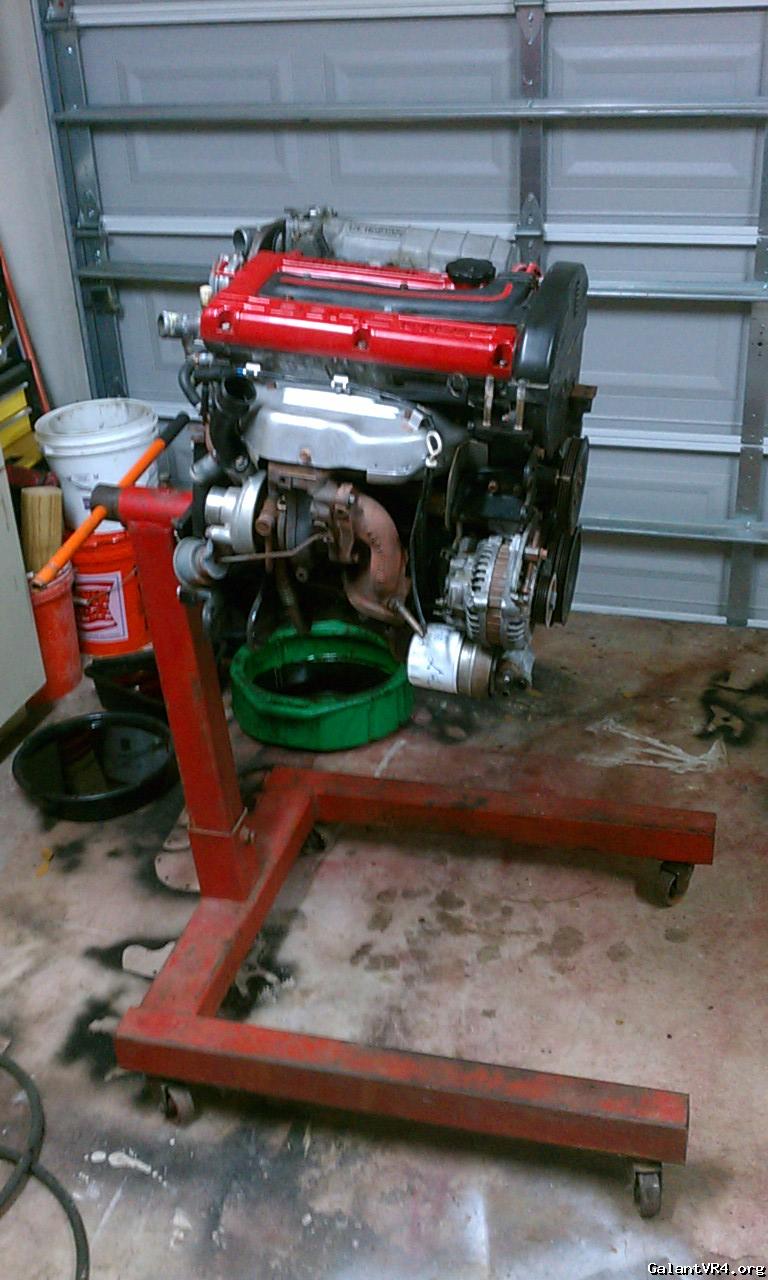

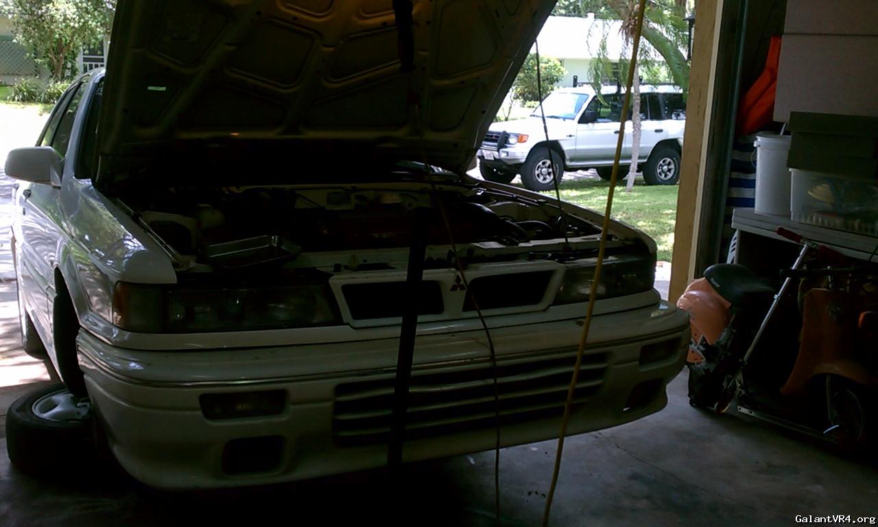

Fired her up today. She purred like a kitten. Cams sounds great. Brought her up to temp, no leaks. Tomorrow I will change the oil and I have to modify the downpipe a little to mate up to the EVO3 o2 housing. w00t w00t

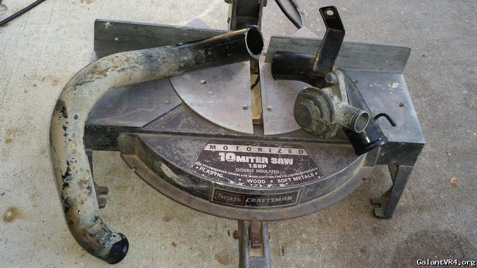

Changed the oil tonight after initial start up. Cut and welded the downpipe to mate up with the EVO3 o2 housing. Welded a new exhaust tip on that looks much better than the old one. Drove to the gas station and car wash. She is running like a champ. I think I'm going to modify the exhaust a little. It bumps a little on start up. It's nice being back in the drivers seat. Man it's hard not to go WOT when I hear the turbo spooling.

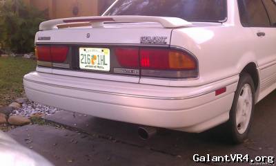

I ended up going with a ACT 2100 kit:
We'll see if it holds. It feels like stock, so I'm really happy about that. I'll be driving this 200+ miles per week and my wife drives it on occasion too so I thought I'd give the 2100 a shot.

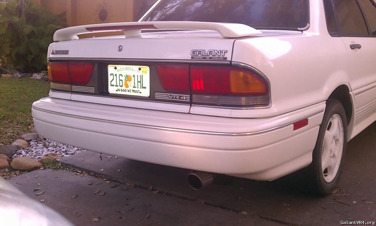

Here is a pic of the exhaust. Much better with the tip and fixed the off-center issue.

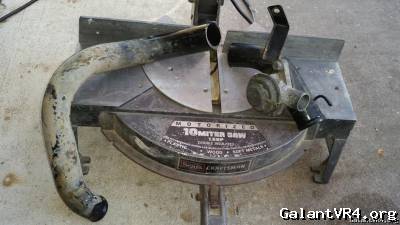

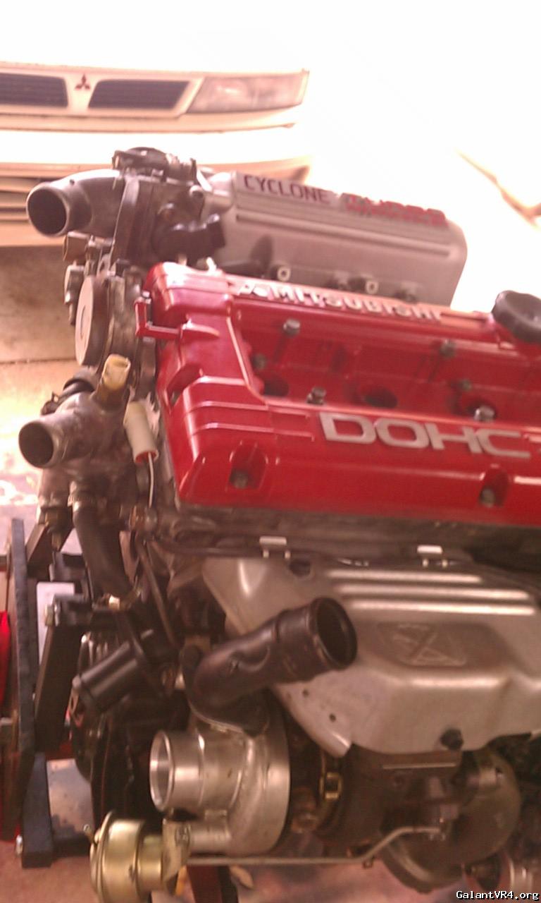

I forgot to add the Cyclone pics to this thread. Here is the link:
I could not seem to find Cyclone brackets for sale so I modified the three USA brackets to work. Info at the link above and pic below.

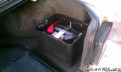

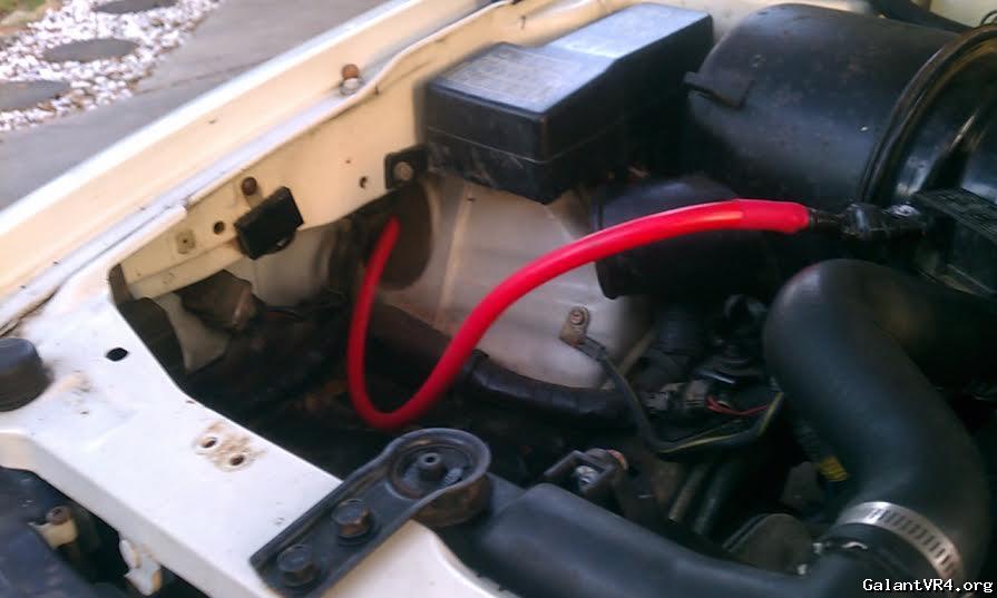

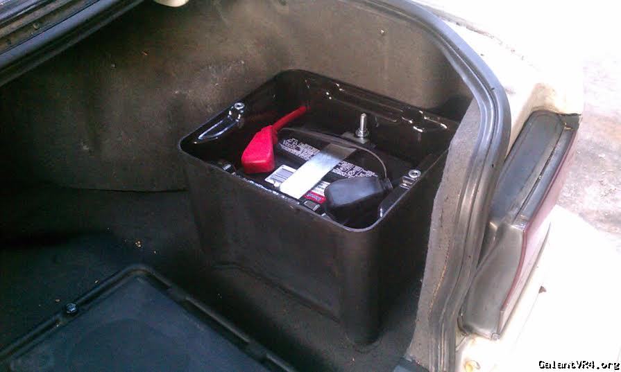

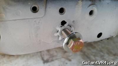

I've been working the last couple nights on getting the battery to the trunk. Finished it up today. It turned out really nice. I bought this kit from Summit:
I should have taken better pictures of the process, but I was welding out in my driveway late at night and didn't think the neighbors would like me stopping for pictures. I welded a couple nuts and a bracket to the rear passenger trunk area to mount the box flat. It's very stable. Then I ran the cables through the trunk fabric sides. I grounded it to the bumper bolt which I have since read doesn't work. I checked grounding continuity from that bolt to a number of different places around the car and everything was OK. Car starts fine. I guess I'll check the voltage at the battery with the car running tomorrow.
I originally planned on running the power cable under the car but when I got to that point it was late and I didn't feel like crawling under it. This turned out to be a good choice because running it inside along the passenger side is very easy. It's almost like Mitsu wanted me to put it there 20 years ago. I took out the rear seats and passenger seat (I could have left the passenger seat in). This was the first time the carpet was ever up. I found a bunch of things from the old owner. The best was a gas receipt from 1994 for $1.40/gallon.

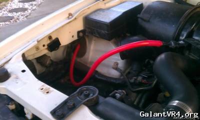

Anyways, again I didn't take enough pics. I removed the front passenger wheel and plastic wheel well trim. Ton of room in there to run the cable right beside the ABS sensor wires. Here are the only two pics I took. I'm loving all the new found space in the engine bay!

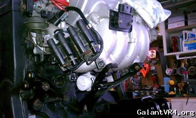

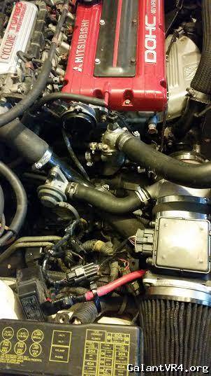

Had some time to monkey around on the Galant today. I wanted to get the ECMLINK installed so I put the FP pipe and 2g MAF on. I'm still running the stock IC for now so I had to reroute BOV to recirculate. I ended up cutting the stock lower IC pipe and moving the BOV closer to the TB. It turned out nice. Hopefully soon I'll have time to install the EVO8 IC and 2.5" piping I've collected.
Got the ECMLINK in. Car is running great. I forgot how awesome LINK is lol. Thanks for looking.

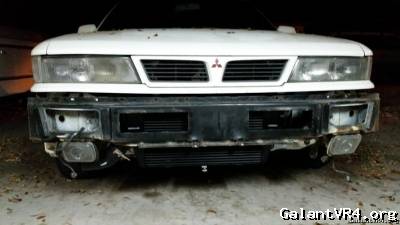

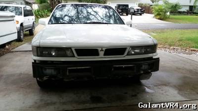

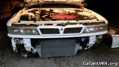

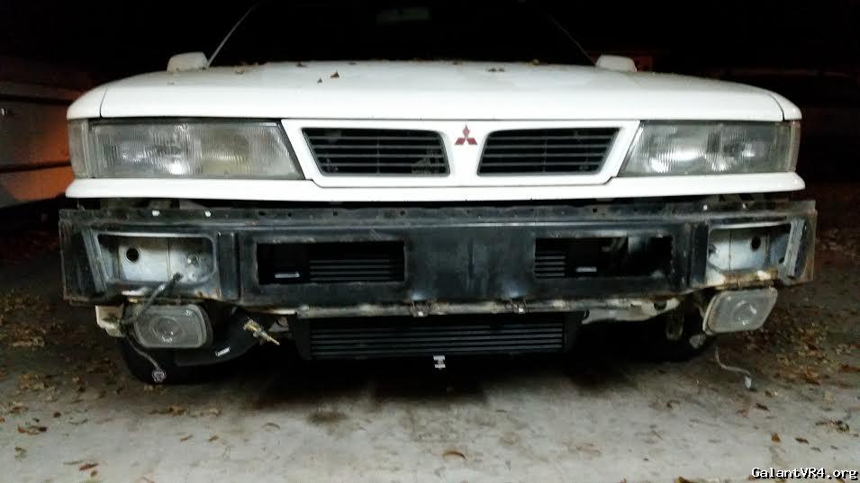

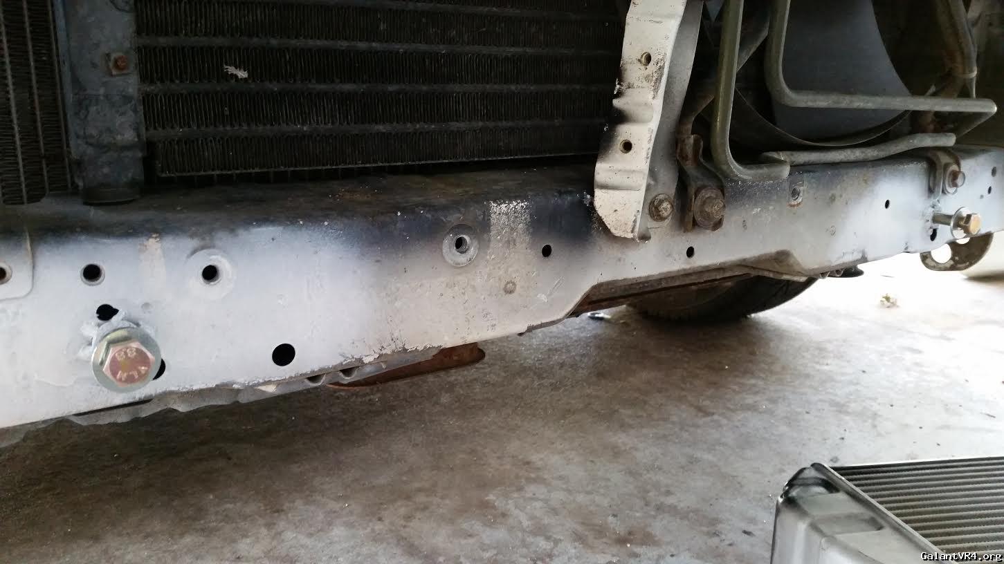

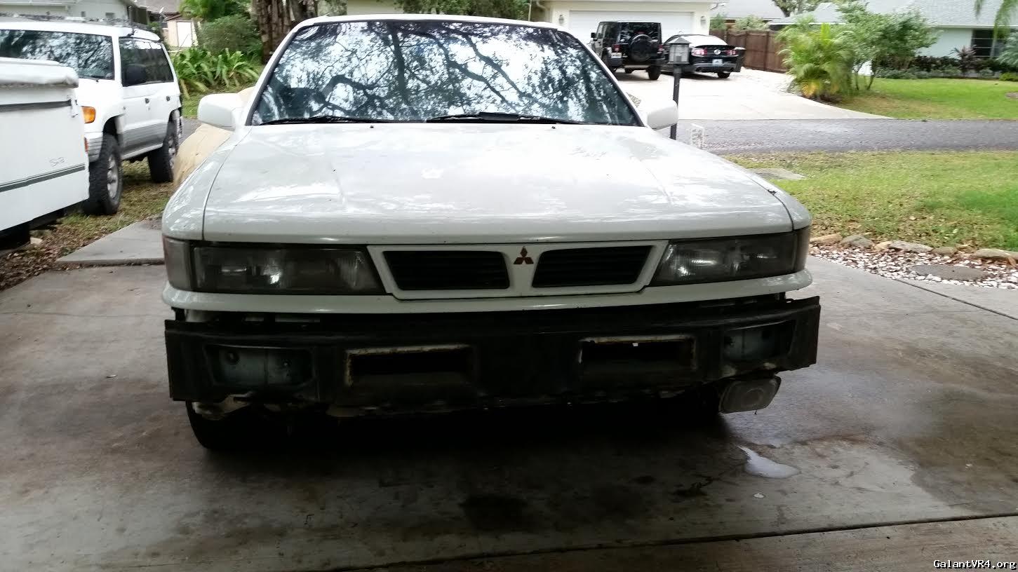

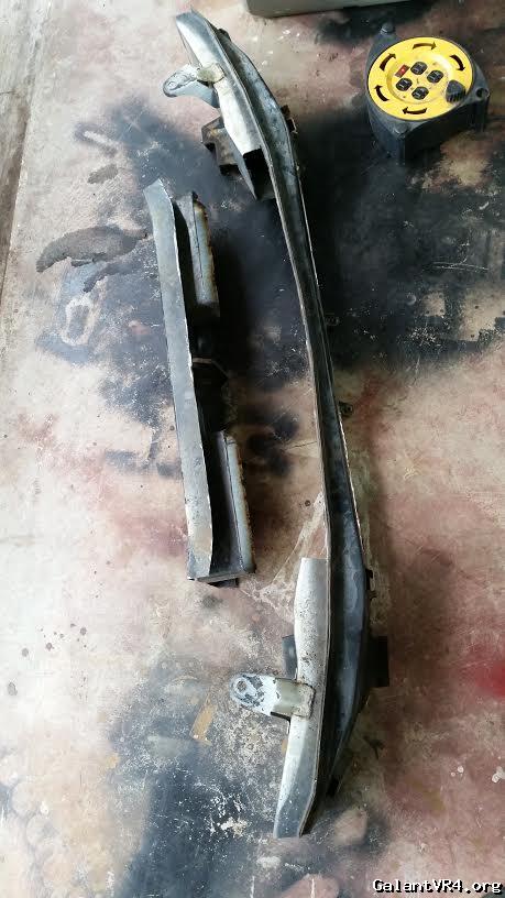

It's been over a month so I guess I'll post an update. I'm about half way done with the EVO8 IC and 2.5" piping install. It's going well and I'm really happy with how everything has turned out so far. I'll post more when I'm done, but here are a few pics. Uncut bumper cover, fogs, and I painted the IC black last night. Going for the stock sleeper look /ubbthreads/images/graemlins/smile.gif. Thanks for looking.
This is what it looks like with the bumper cover off. I didn't see any pics of this online so maybe this will help someone in the future. I'm replacing the passenger side fog, so it was removed during this pic.
This pic shows how much (or little) of the bumper that I had to cut off.

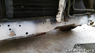

This pic shows moving the power steering line back a little and a hammered back core support beam. It was easy and only took a minute. No worries there.

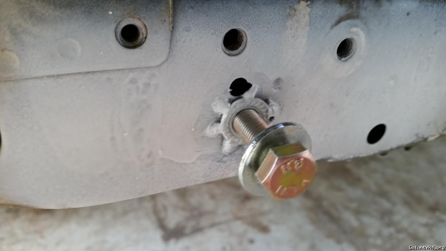

I welded two nuts into the car so I can bolt up the EVO8 IC using it's standard lower hangers.
This is how it looks so far. Since it will be hidden and black, it is conveniently not centered. Pushing it over a little to the passenger side gave me more room to run the hot side through.
The passenger side pipe will not sag that much when it's finished. I did cut way too much of the metal away though. No need for that. You can also see in this pic that the hot side of the IC has been cut off and rotated. I just got it back from the weld shop. I hope to have it all completed in the next two weeks.

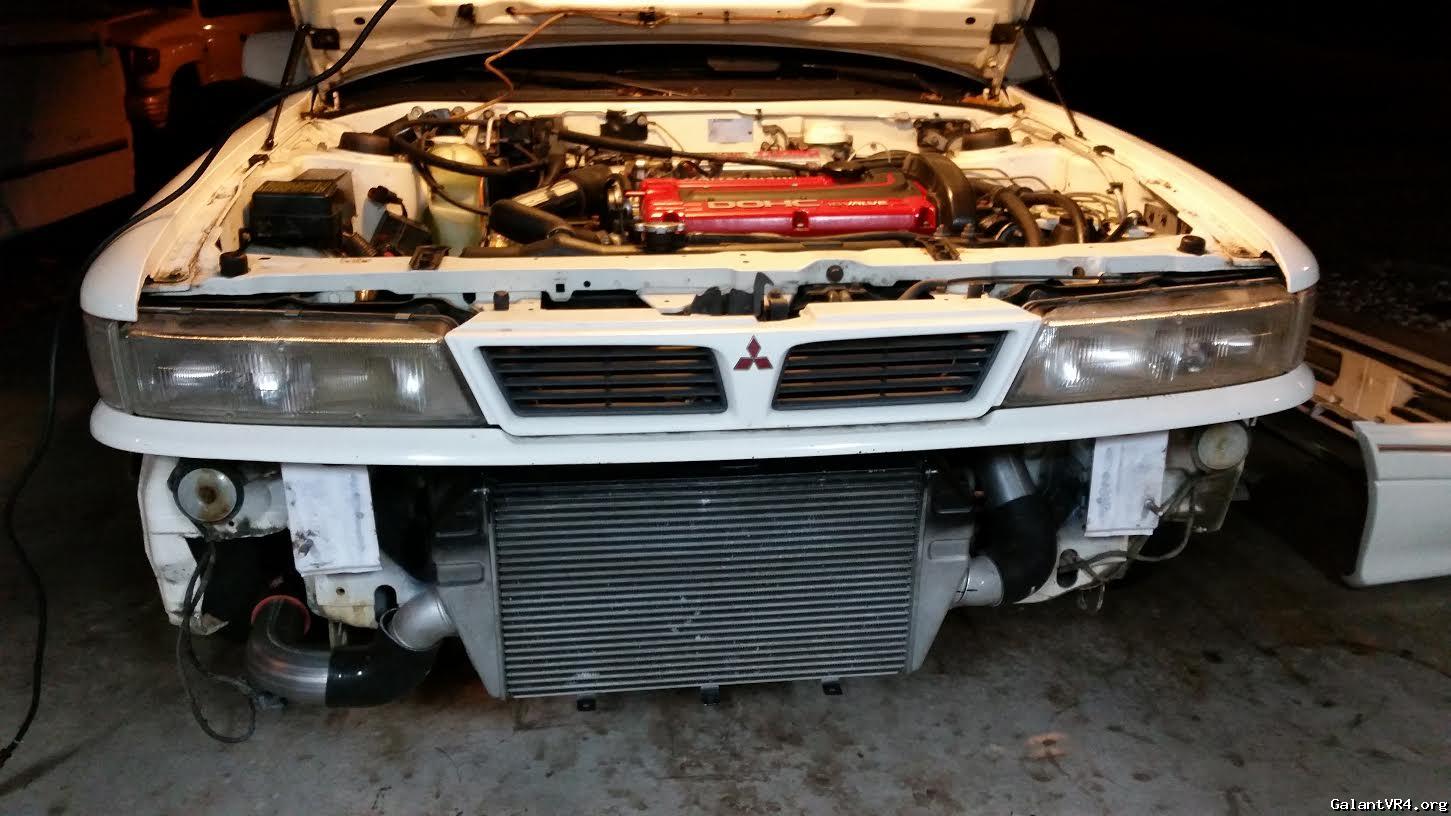

Thanks! Just like yours! (totally kidding)

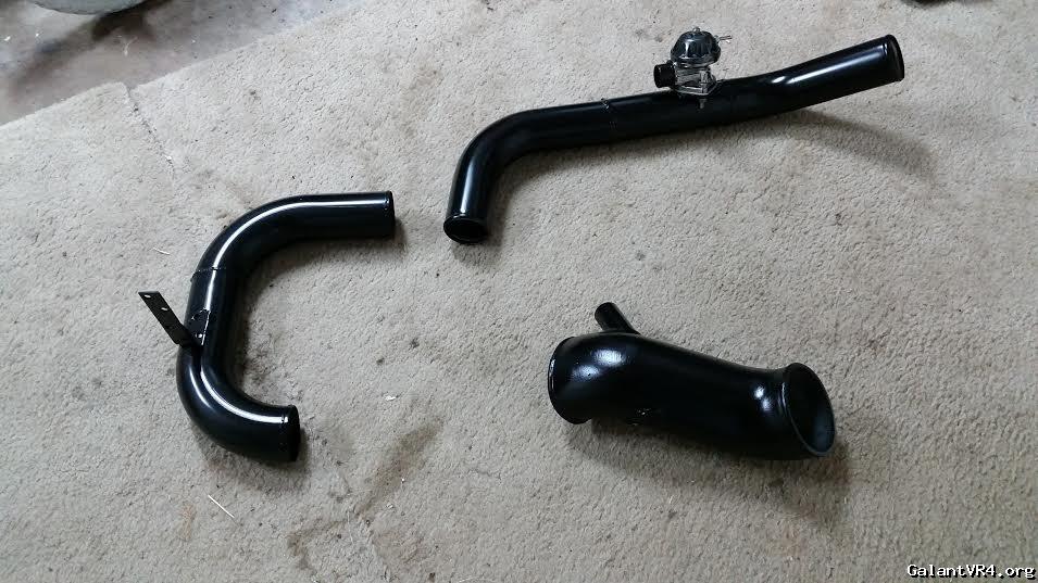

Made a little progress today. I have the two cold side pipes finished and painted. Painted the IC and permanently mounted it. Also decided to paint the FP MAF pipe black. turned out nice. Thanks for looking!
