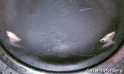

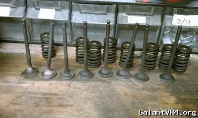

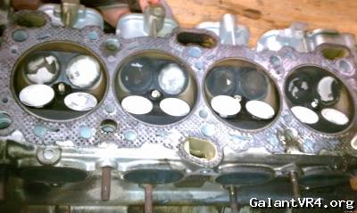

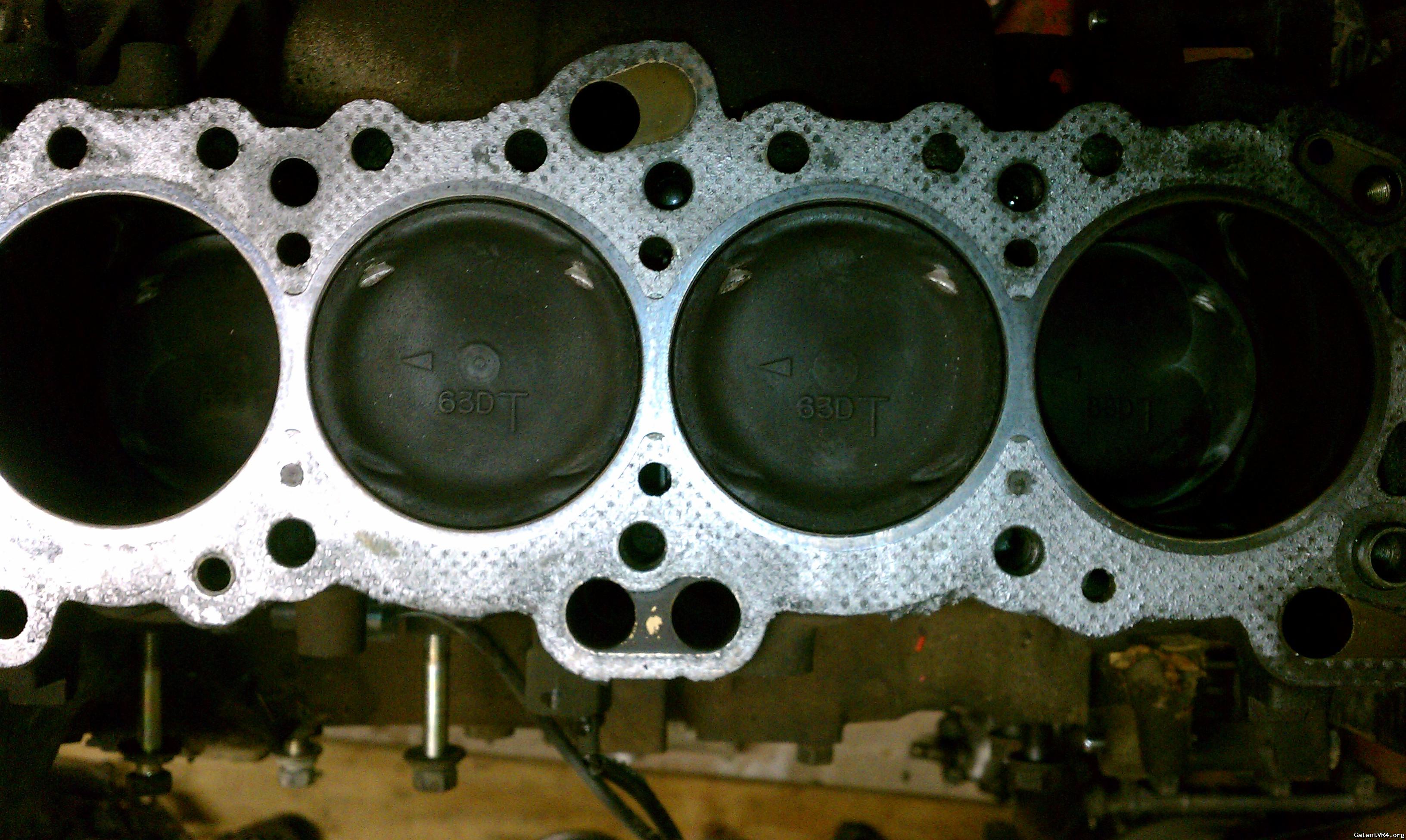

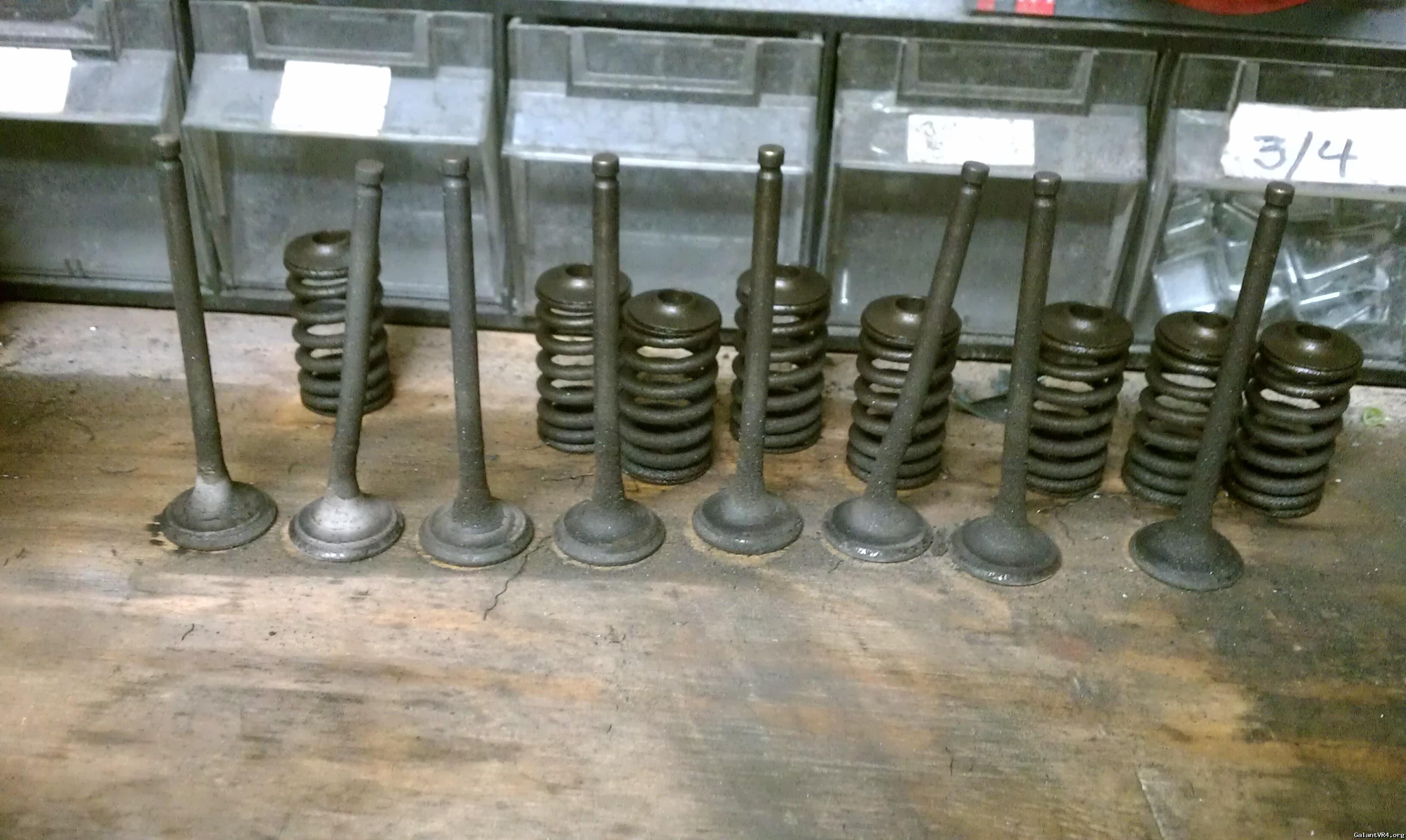

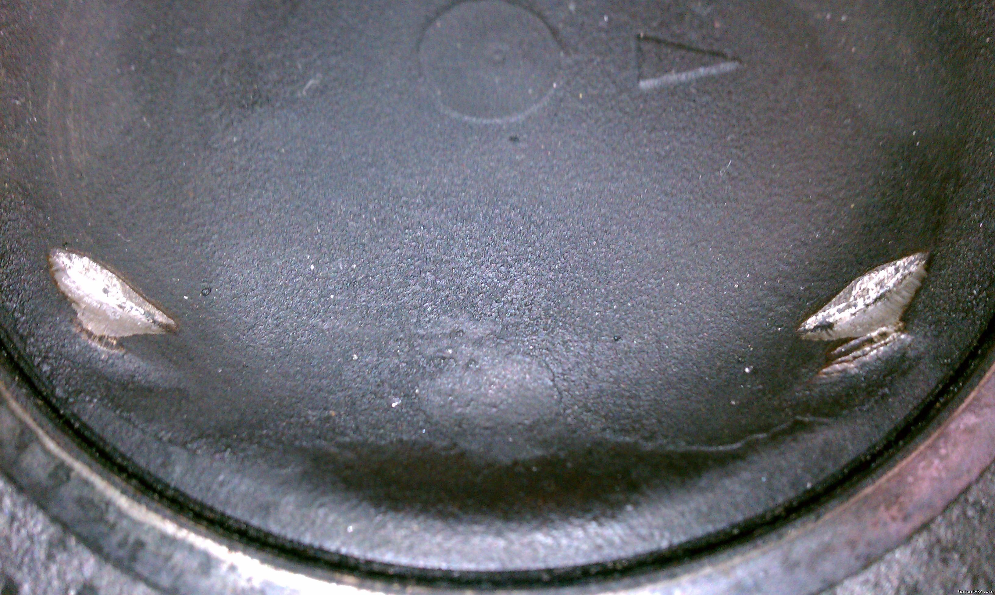

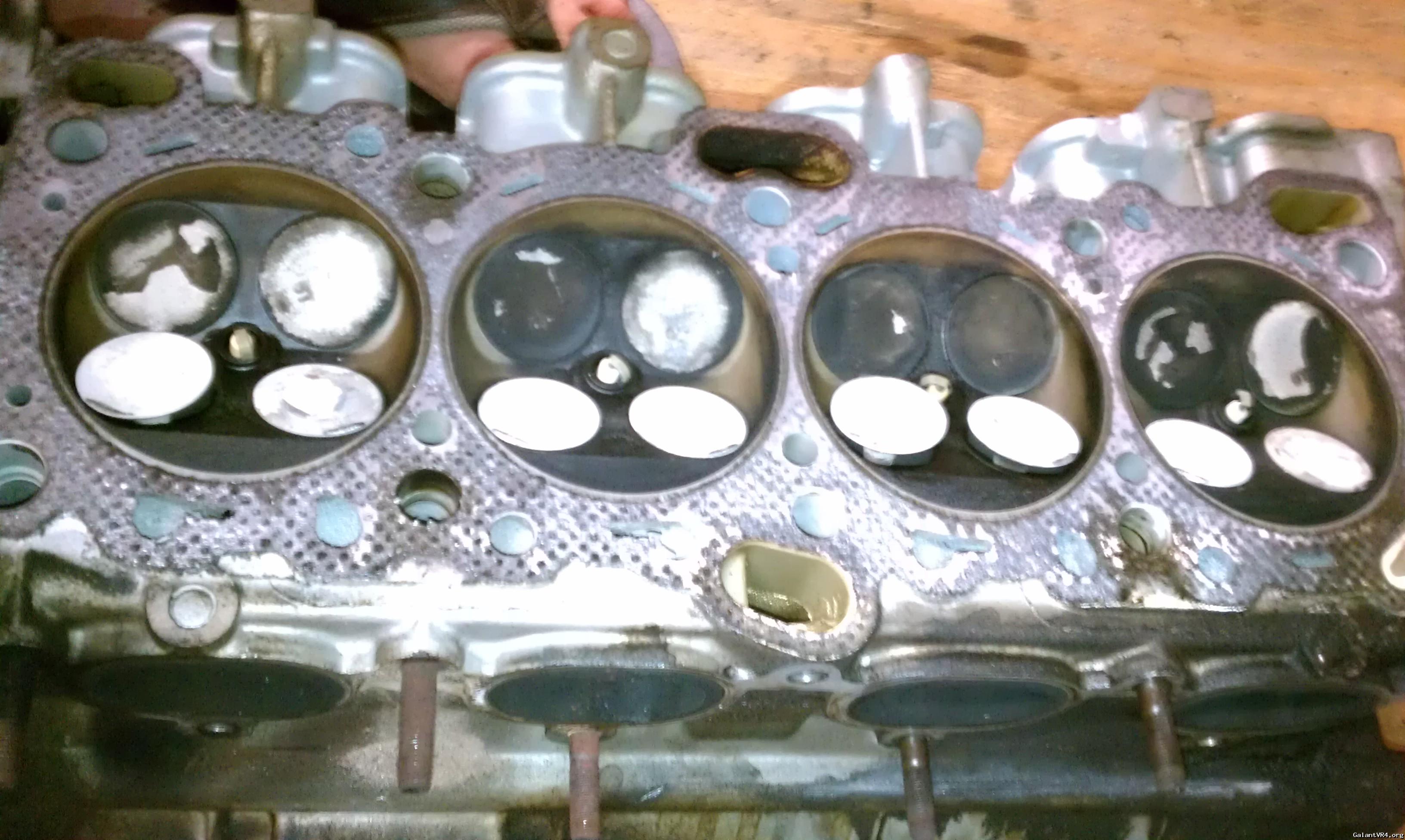

Got a chance to mess with the engine tonight. All 8 exhaust valves hit. 3 are bent pretty good. I have all new EVO stuff going in. I'm not thrilled about the piston tops. I'm going to clean them and see how they work. What do you guys think about the pistons? This is my fist "budget build". Normally I would just buy new pistons lol but those are not in the budget until 2015. Thanks for looking!
11,993
Pistons will be fine. Just smooth out the spots where the valves hit. I've seen waaaaay worse than that.
11,009
Second that. Just make sure no sharp edges or burrs are left to create ignition hot spots.
You can also check for any cracks in the pistons, but unless they have been smacked really hard, probably not too likely.

Awesome news guys, thanks. The belt stripped at 800 rpm while sitting at a stop light so the smacking was "minimal". I have reused forged pistons in this condition before but never the stockers. I'll clean them down nice and smooth and call it a day!

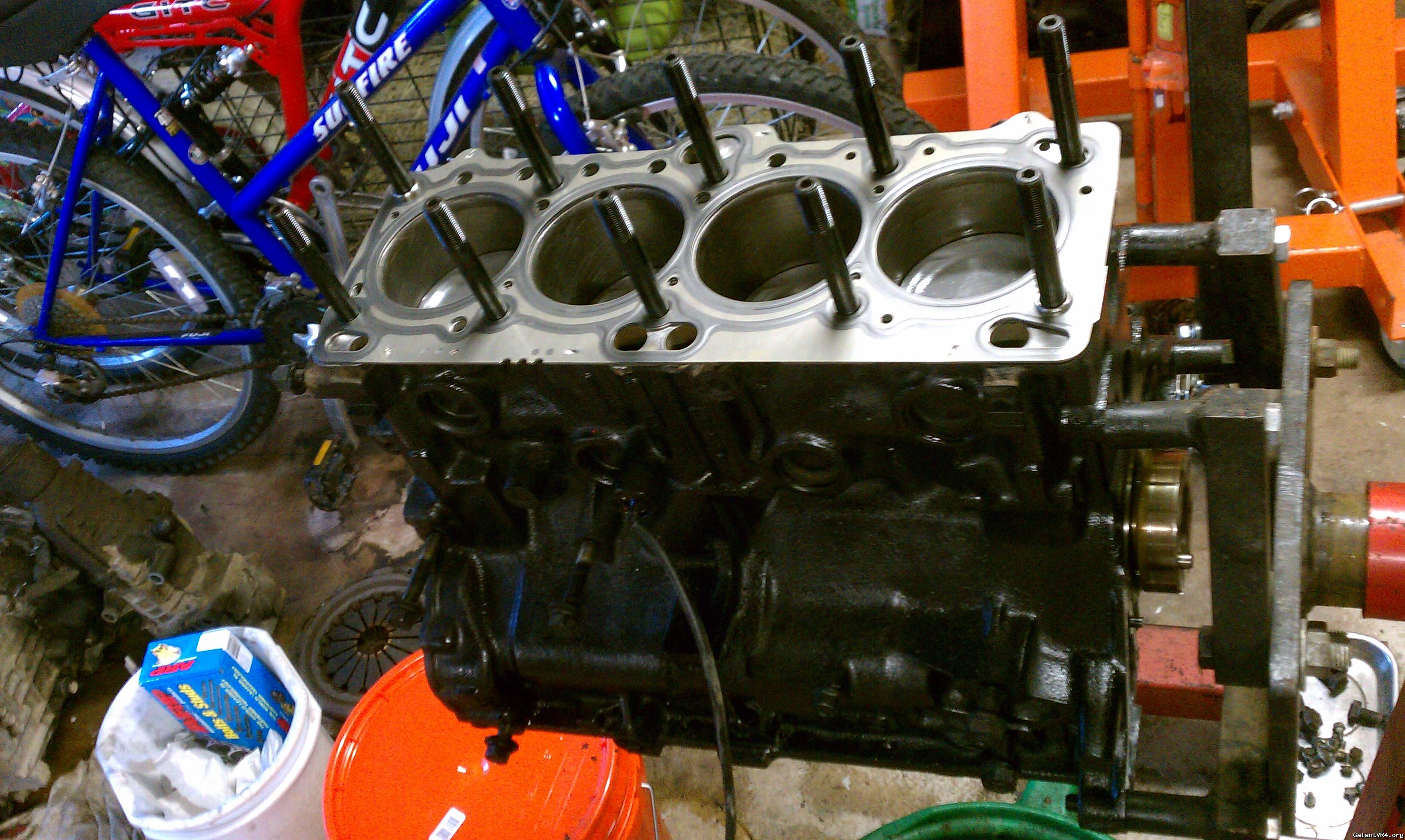

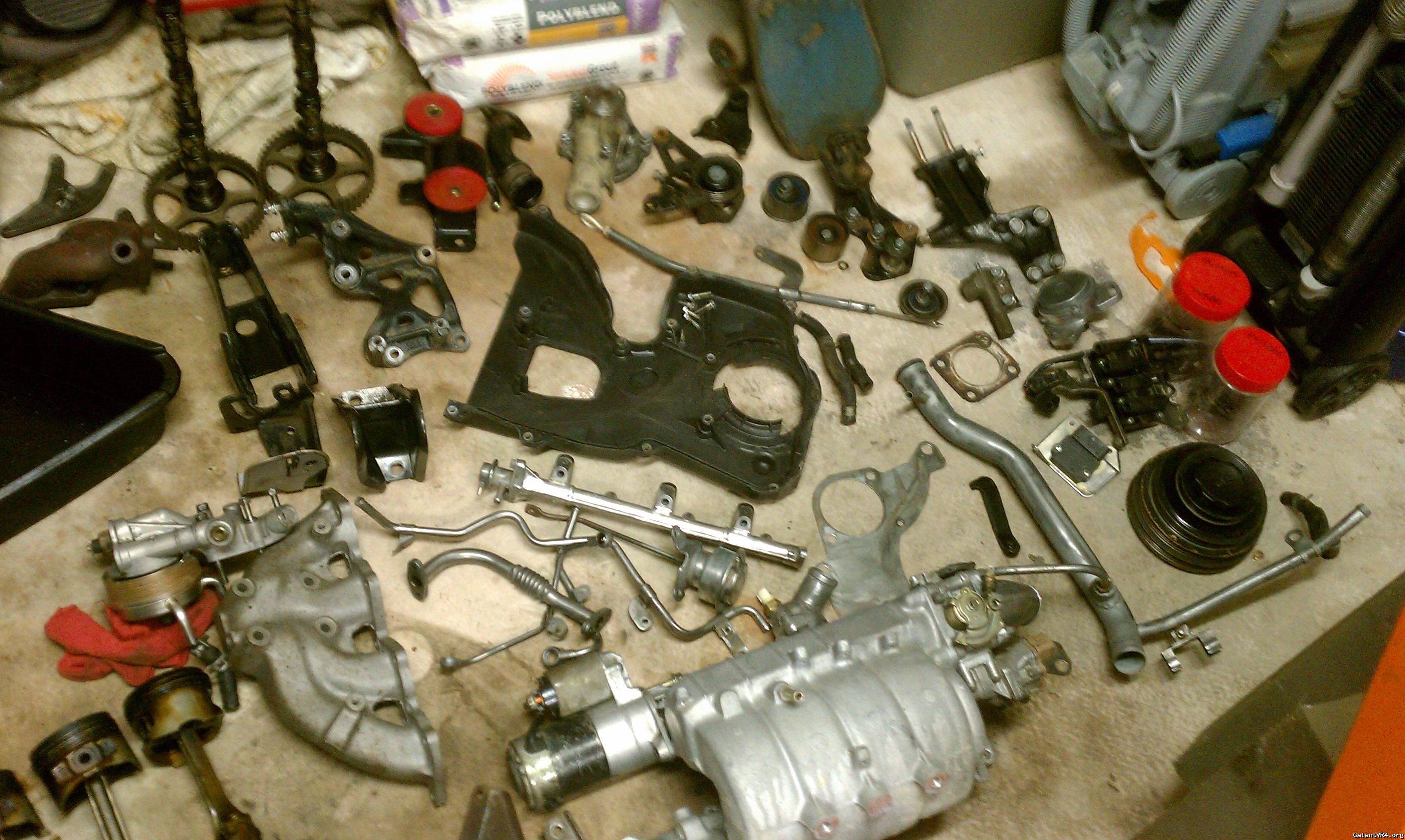

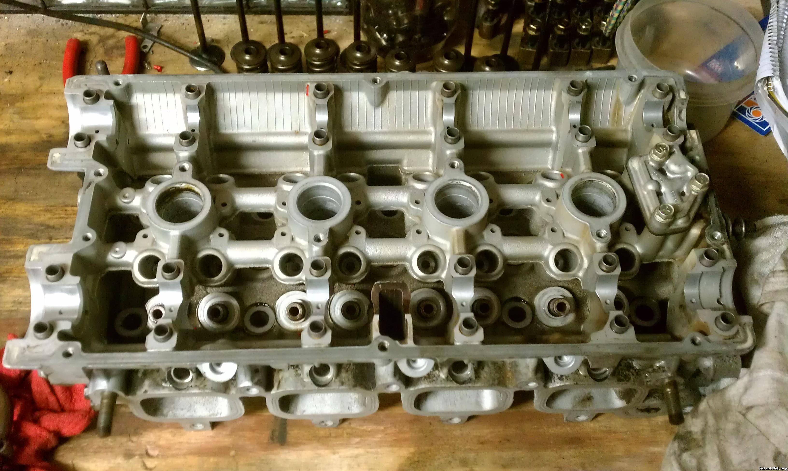

Here are a few pics:

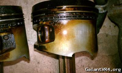

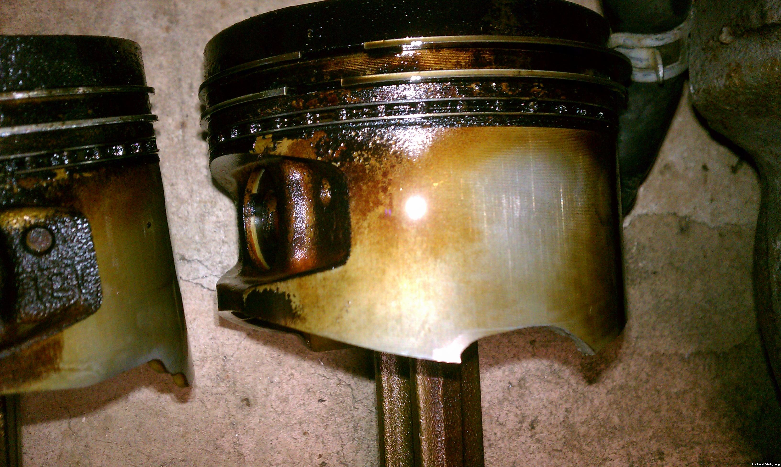

Broken piston. I'm kinda glad I broke it because after I pulled it out I noticed that the ring gaps were lined up. No bueno.
oops~

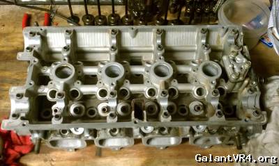

Cleaned up head
Other clean parts
So now I have to decide on the brand of pistons and rods. Looks like I can get rods for $300ish and pistons for $500ish. What do you guys think?

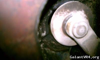

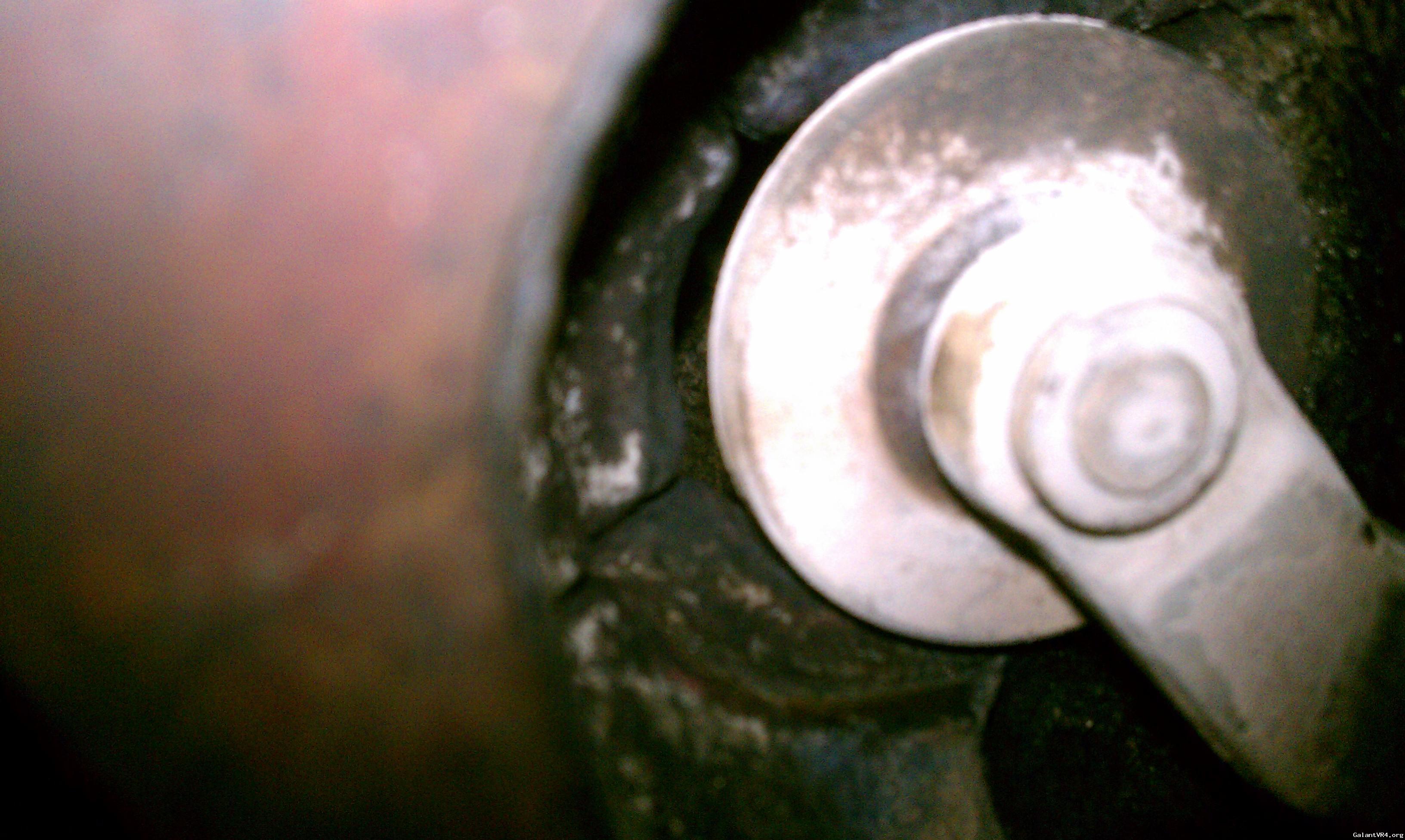

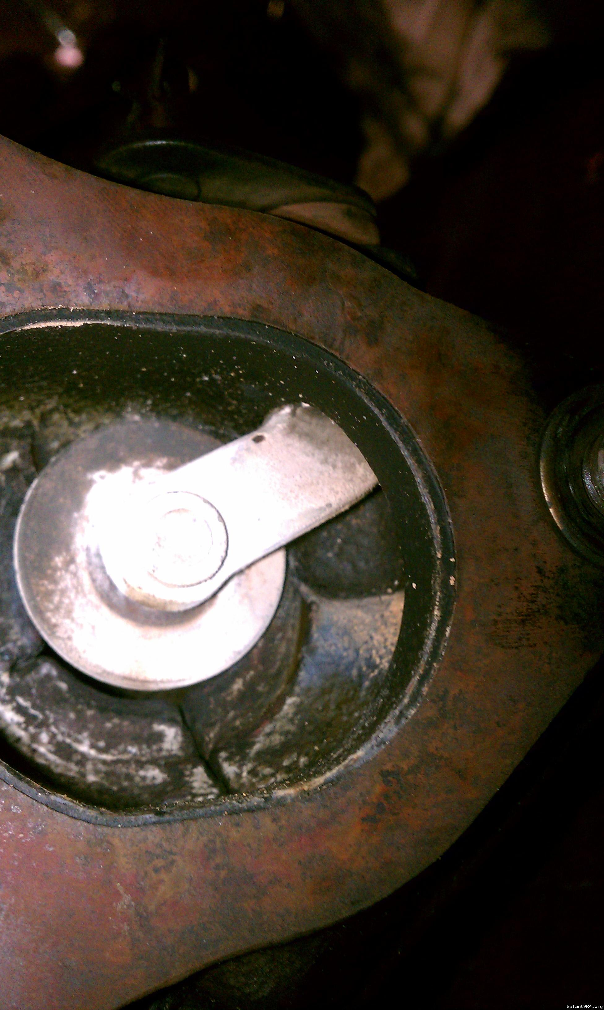

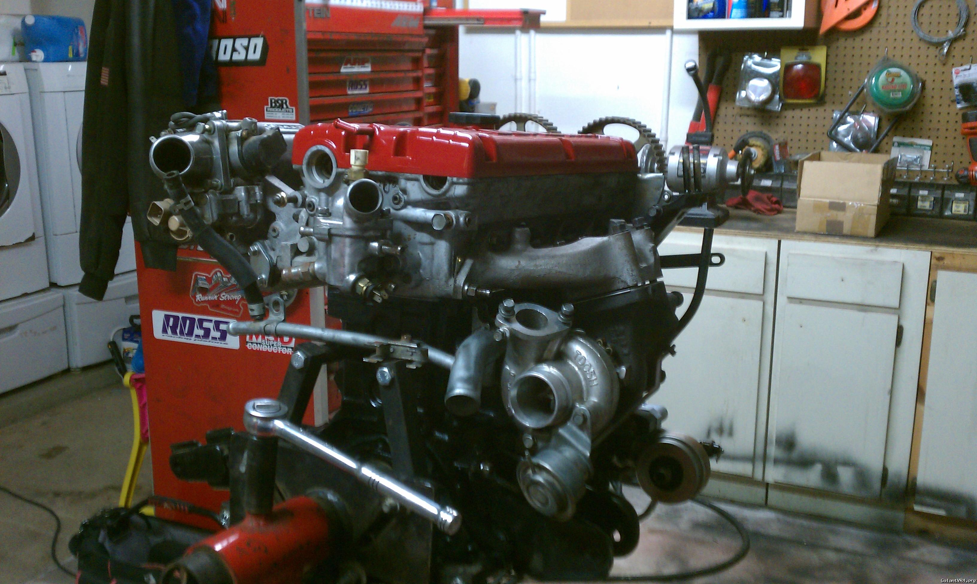

OK, I decided on a 2G/1G combo. I'm pretty excited about the increased c/r. I always thought that my car was a little laggy for the stock turbo. Tonight I got my new BS bearings installed and was messing around a little. I took a closer look at my stock turbo and found out another reason why my turbo was so laggy! These pics are with the flapper all the way closed.
Now I'm supper stoked to get my new pistons and 16g! I think this thing is going to run very nice in a few months! Thanks for looking.

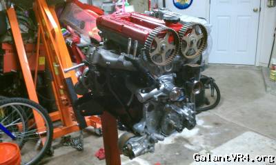

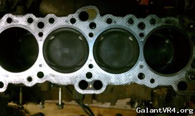

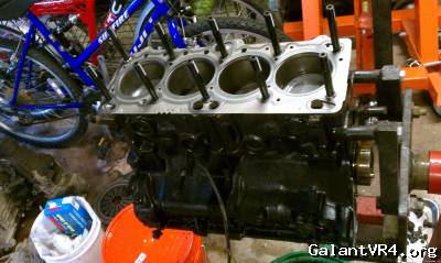

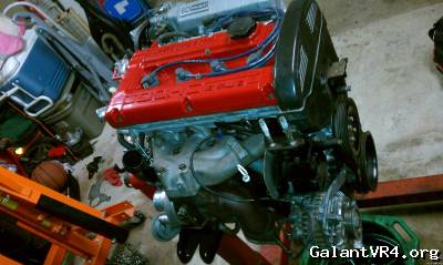

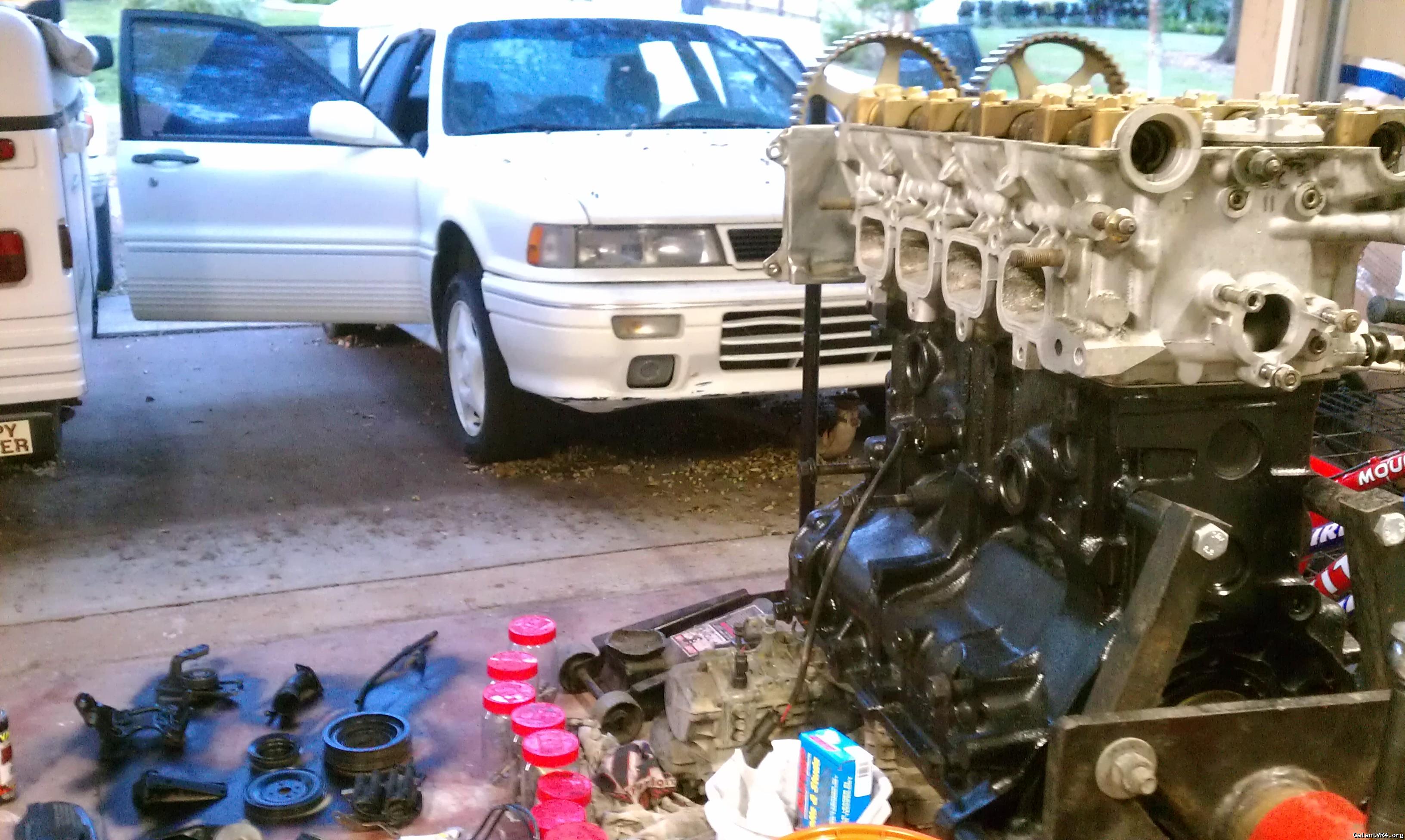

Was able to turn some wrenches this weekend. I swapped out the mains, gapped the rings, installed the new pistons and rods. Got the ARP's in and the head. Started on the timing components. I think the next update with have the cams turning WITH the crank! Some pics!
Gunit is looking on, getting excited!

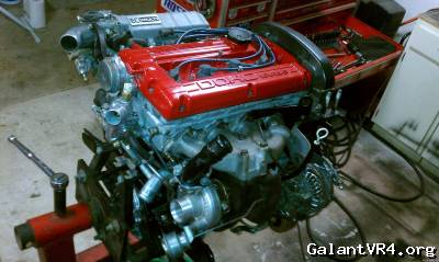

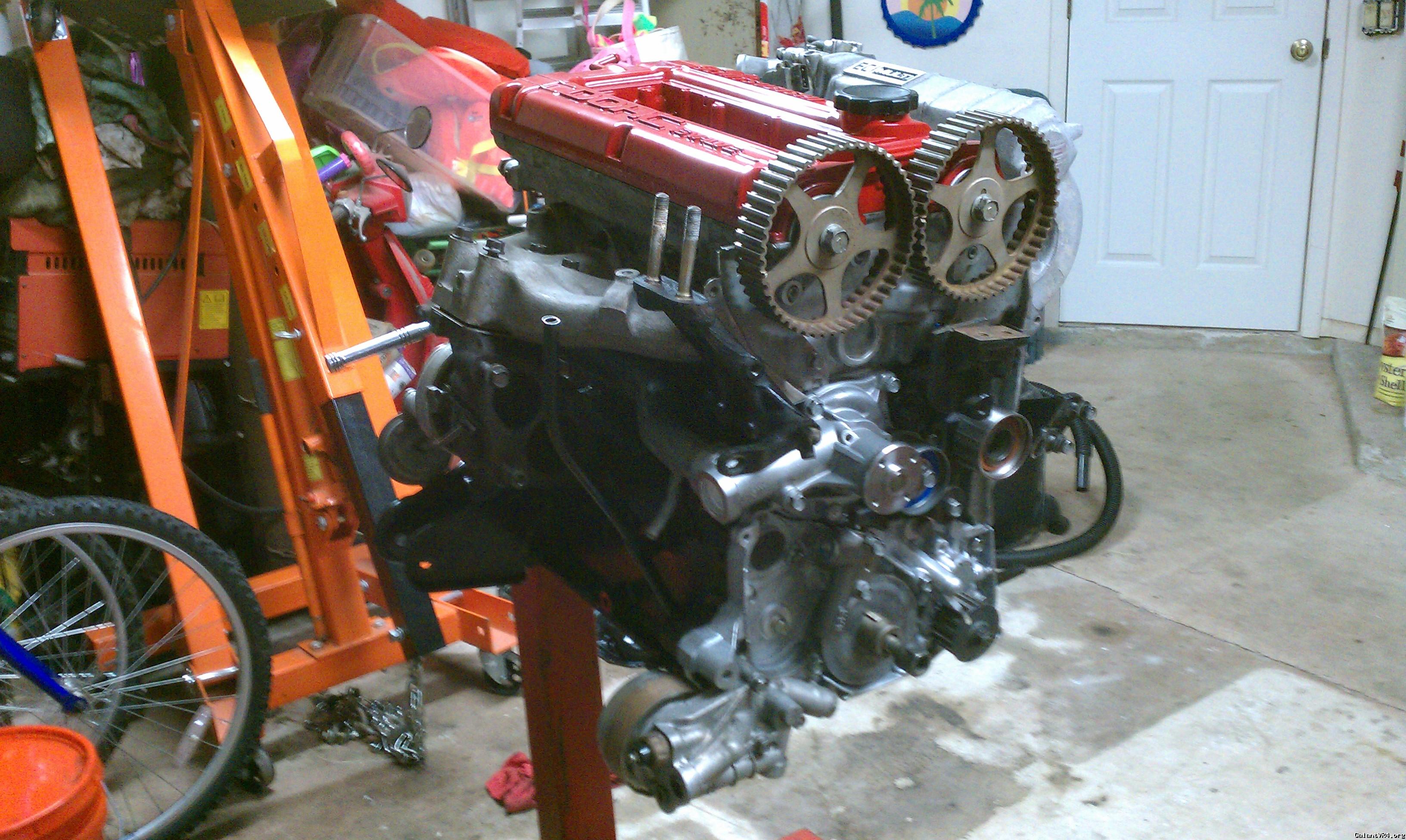

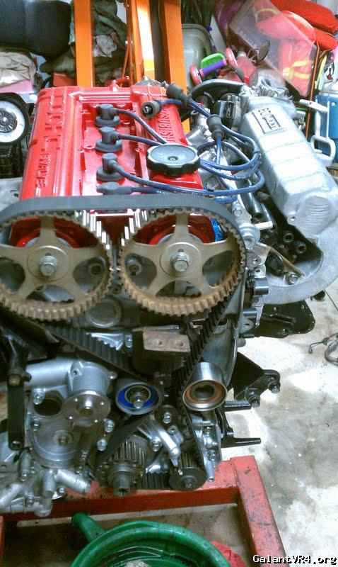

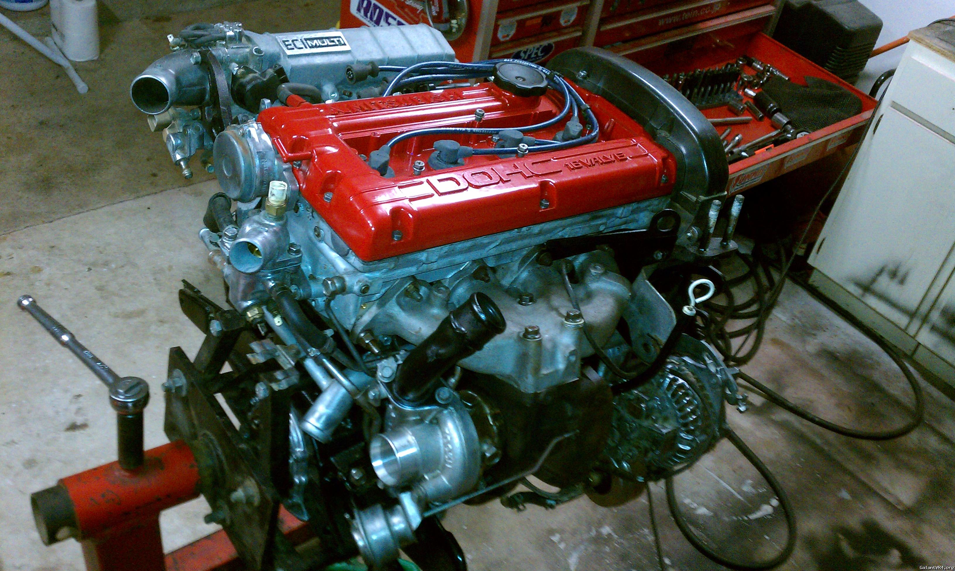

Got a few more things done tonight. The pile of parts on the floor is getting small!
Best part is that the cams and crank are finally turning together again! I guess the thread title is now obsolete /ubbthreads/images/graemlins/smile.gif

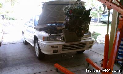

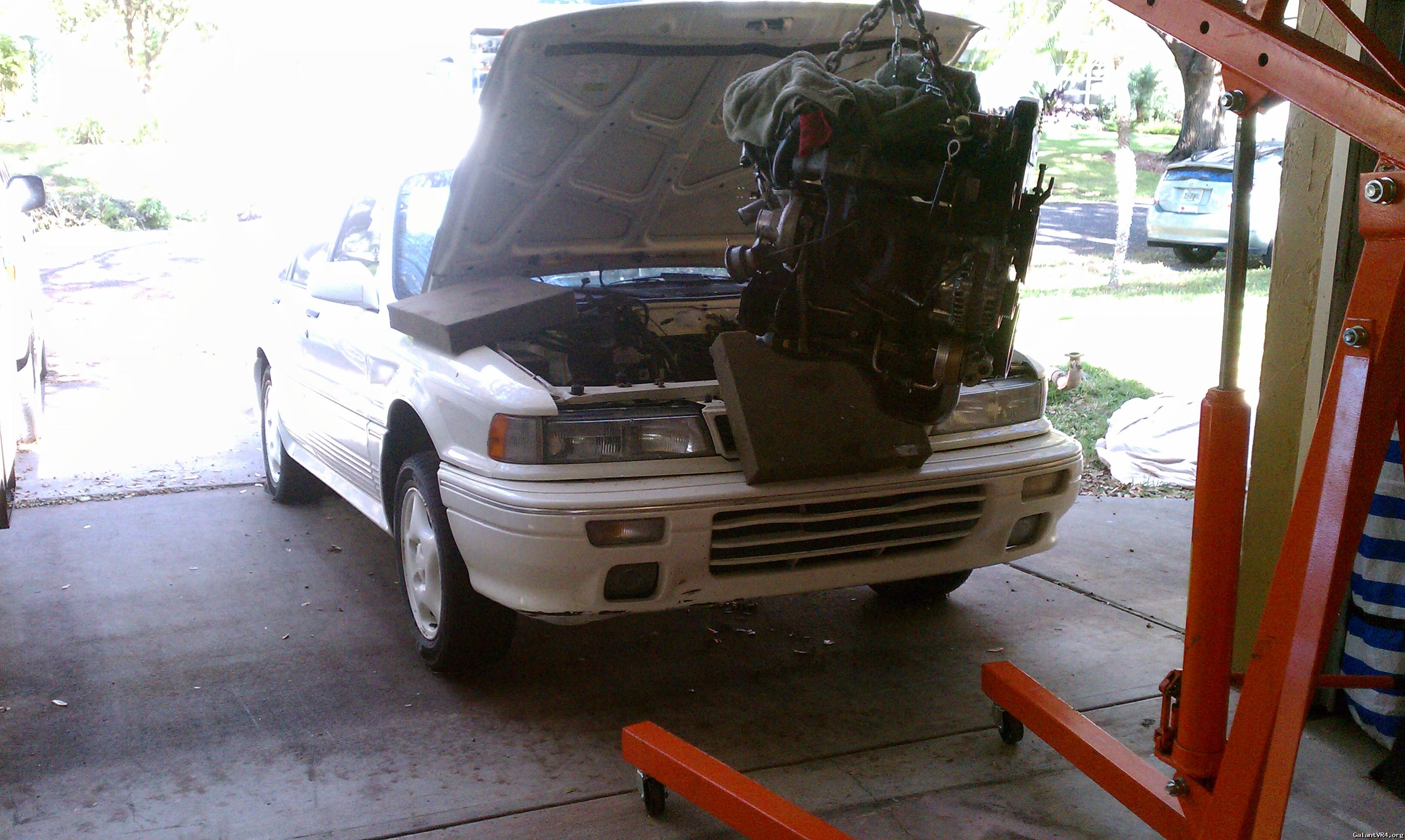

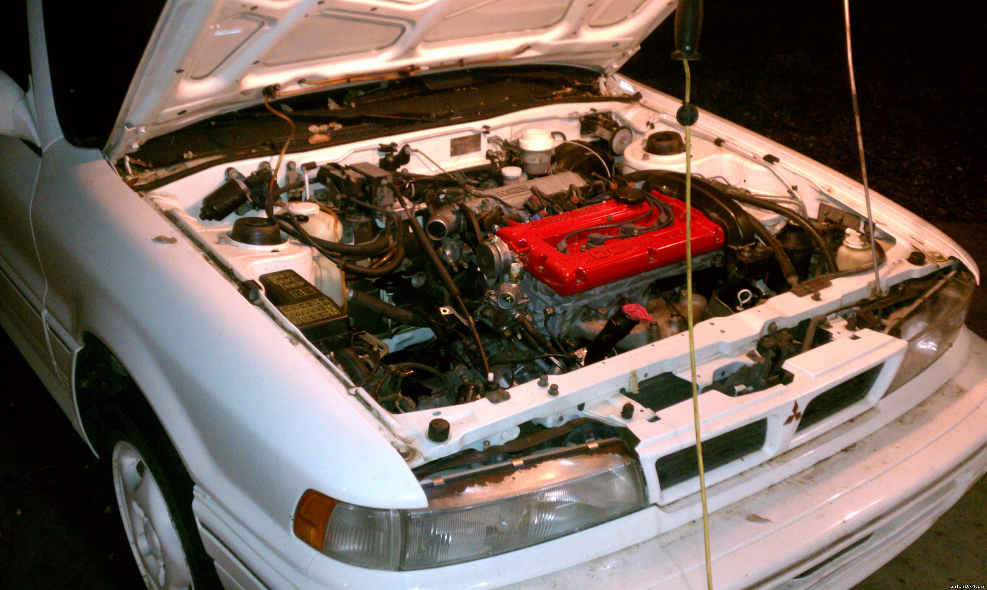

I was able to work on the Galant almost all weekend. Going in I thought for sure I'd be driving it by today, but no such luck. I wasted about 5 hours on two Galant Rookie mistakes. My first mistake was installing the rear motor mount bracket upside down. I sanded and repainted everything so I could not see any old marks. The bracket is able to bolt up in both directions and I picked the wrong one. After wrestling with the motor mounts for 3.5 hours I took it back out and noticed the error.
My second mistake was during the tranny install. I took the engine and tranny combo out of the top on the way out but putting it back in I decided to put the motor in first and then bolt the tranny back on later. I decided to do this because I'm using new aftermarket mounts and because I'm installing it by myself on a steep driveway.
Putting the tranny back in from the bottom I neglected to remove the small plate on the bottom held in by 5 14mm bolts. I wrestled with the tranny for 1.5 hours before I noticed this could be removed. I caulk both of these errors up to working on 3S's for so long. Their rear motor mount bracket can only go on one way and they do not have the removable plate. I actually cut slots in my 3S's in that area for easy tranny installation. It's nice that the Galant has a removable plate.

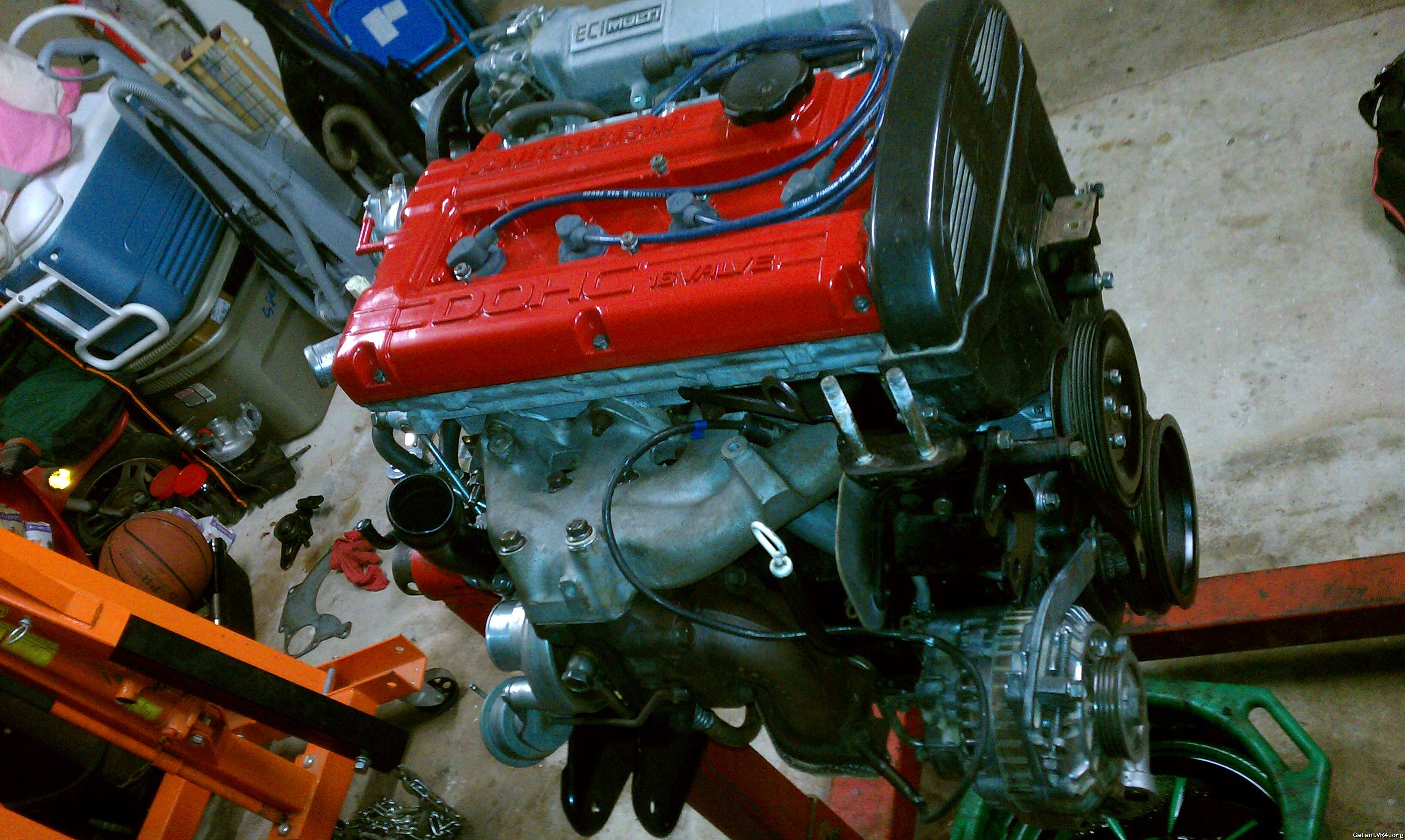

Anyways, after wrestling with the motor and tranny for most of the day on Saturday I feel like I've been hit by a Mack truck. I did make a lot of good progress though and I should have it running next weekend. Here are some pics:

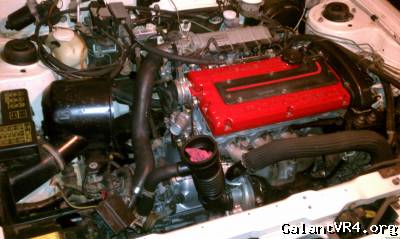

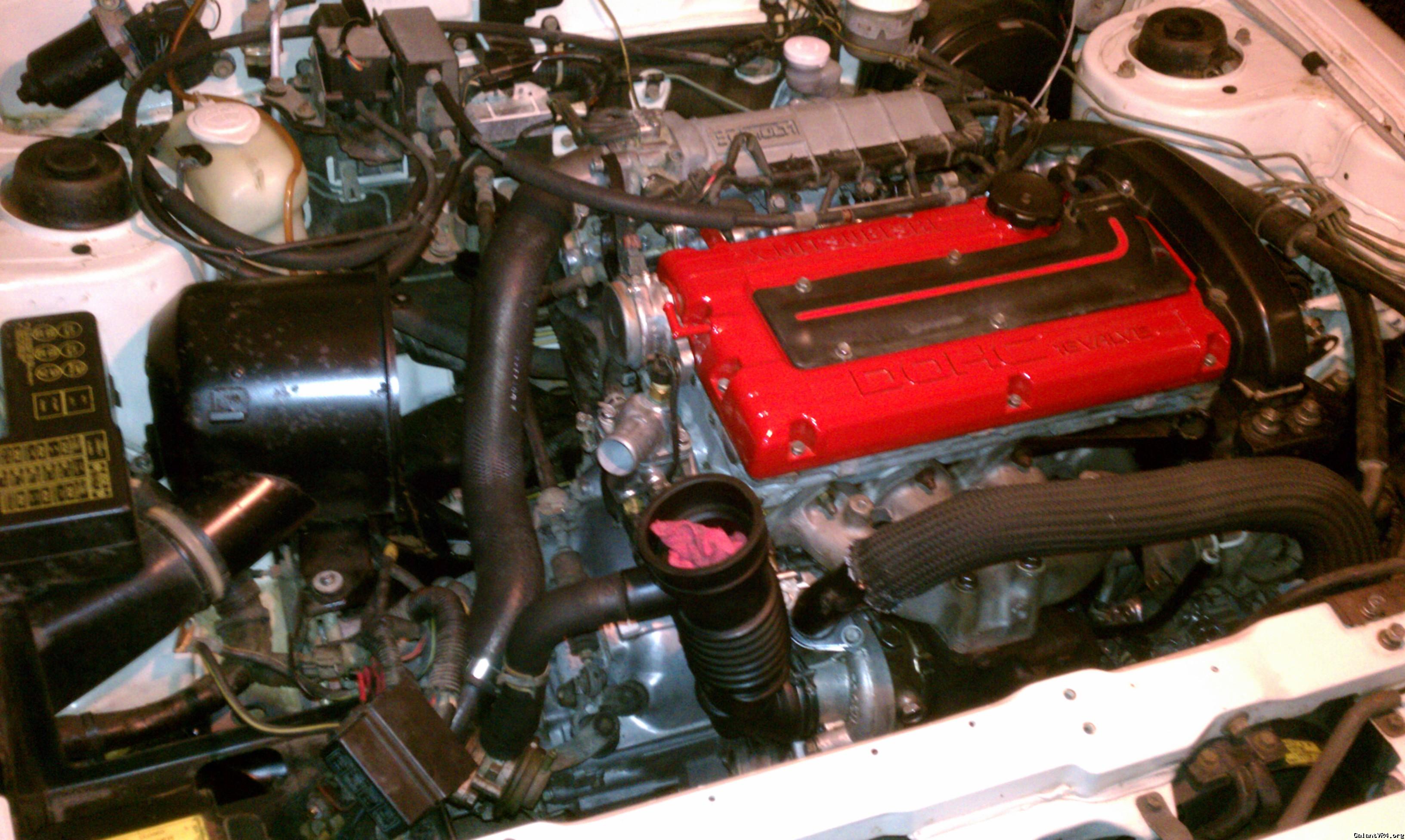

She's alive and purring /ubbthreads/images/graemlins/smile.gif
I've been waiting on a a/c idler pulley for the past week. I got it and it was the wrong part. My own fault as I ordered one for a 1G and the GVR4 is different. I'm going to make a new post for a DIY repair. I started her up without coolant to check for oil leaks. No leaks, everything sounded great. later this week I'll put the radiator back in and drive it around a little. Almost there!
