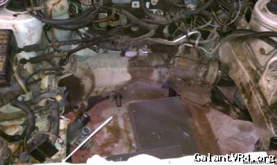

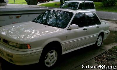

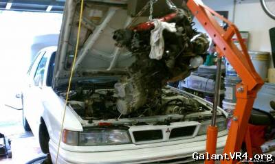

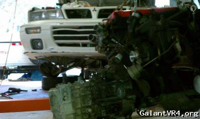

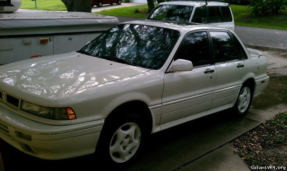

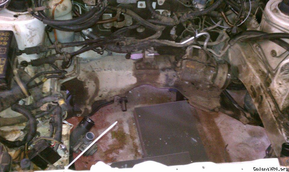

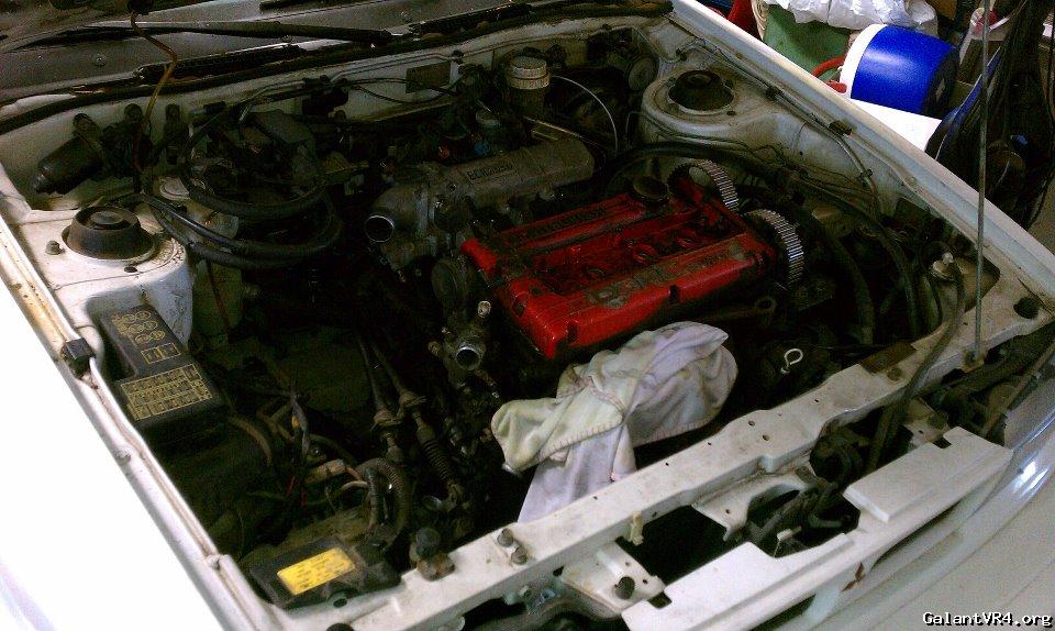

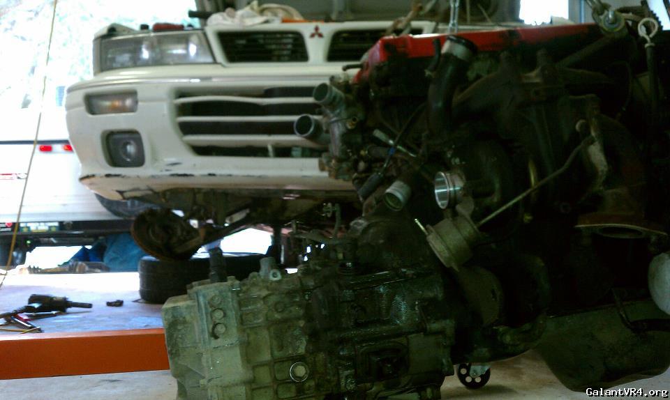

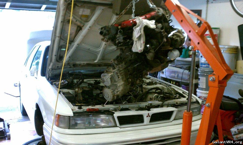

Finally took some vacation days so I could work on the car. I was able to pull the engine and roll the car outside for a much needed bath. Tomorrow is deep cleaning the engine bay and tearing down the motor. Here are some pics.
Just getting started after lunch.
Out she comes
Very nappy
What a dirty girl! I can't wait to scrub all of this grime off!
Wheels back on and a nice bath! 7pm
matt92vr4
Oct 3, 2010
676
Venice, FL
Yeah the last picture is my fav too. She cleans up very nice! I should have some nice pics to add by the end of today. The teeth on the belt stripped off by the crank gear. The belt was severely compromised by the grove but honestly it looks like the stripped teeth issue is not related.
