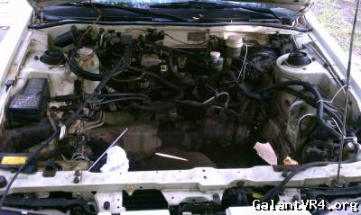

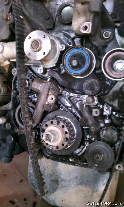

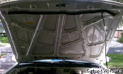

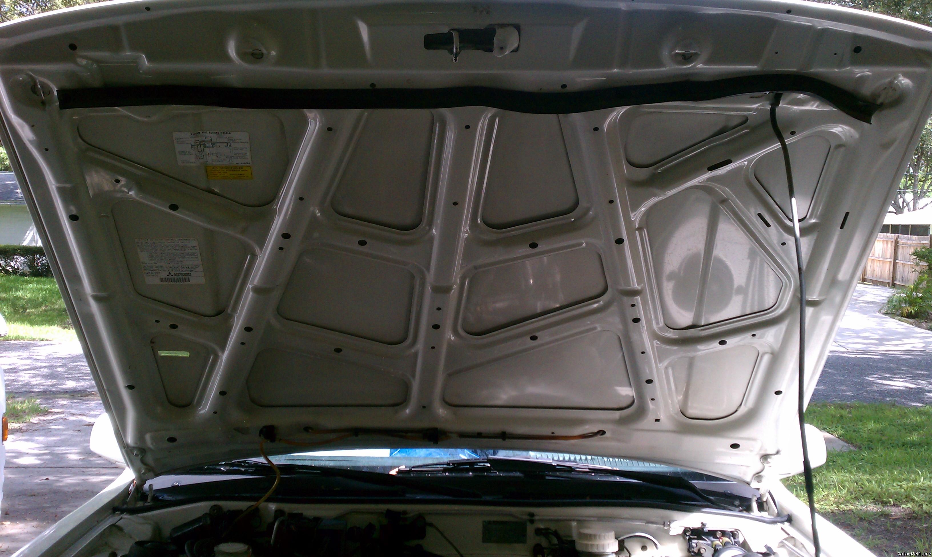

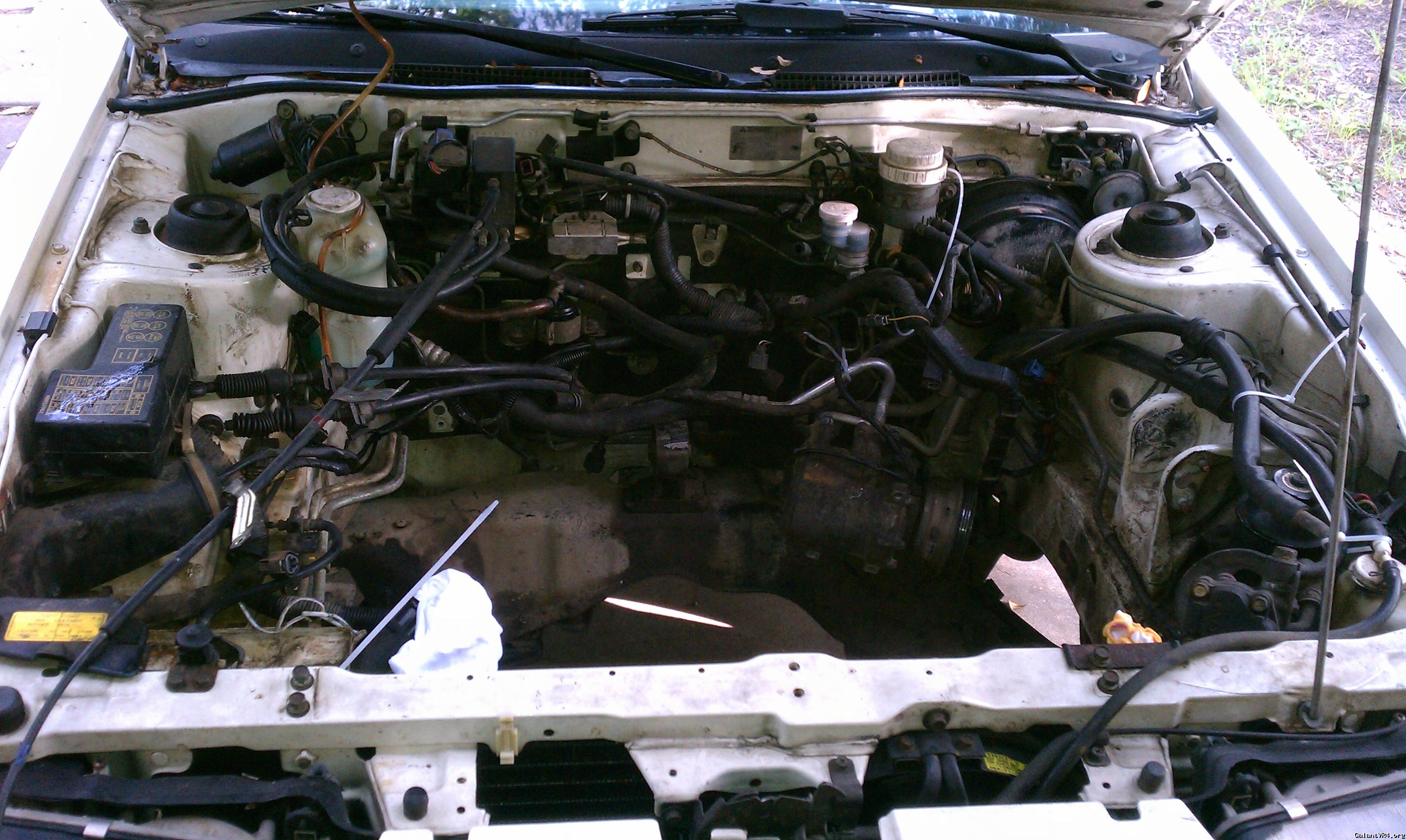

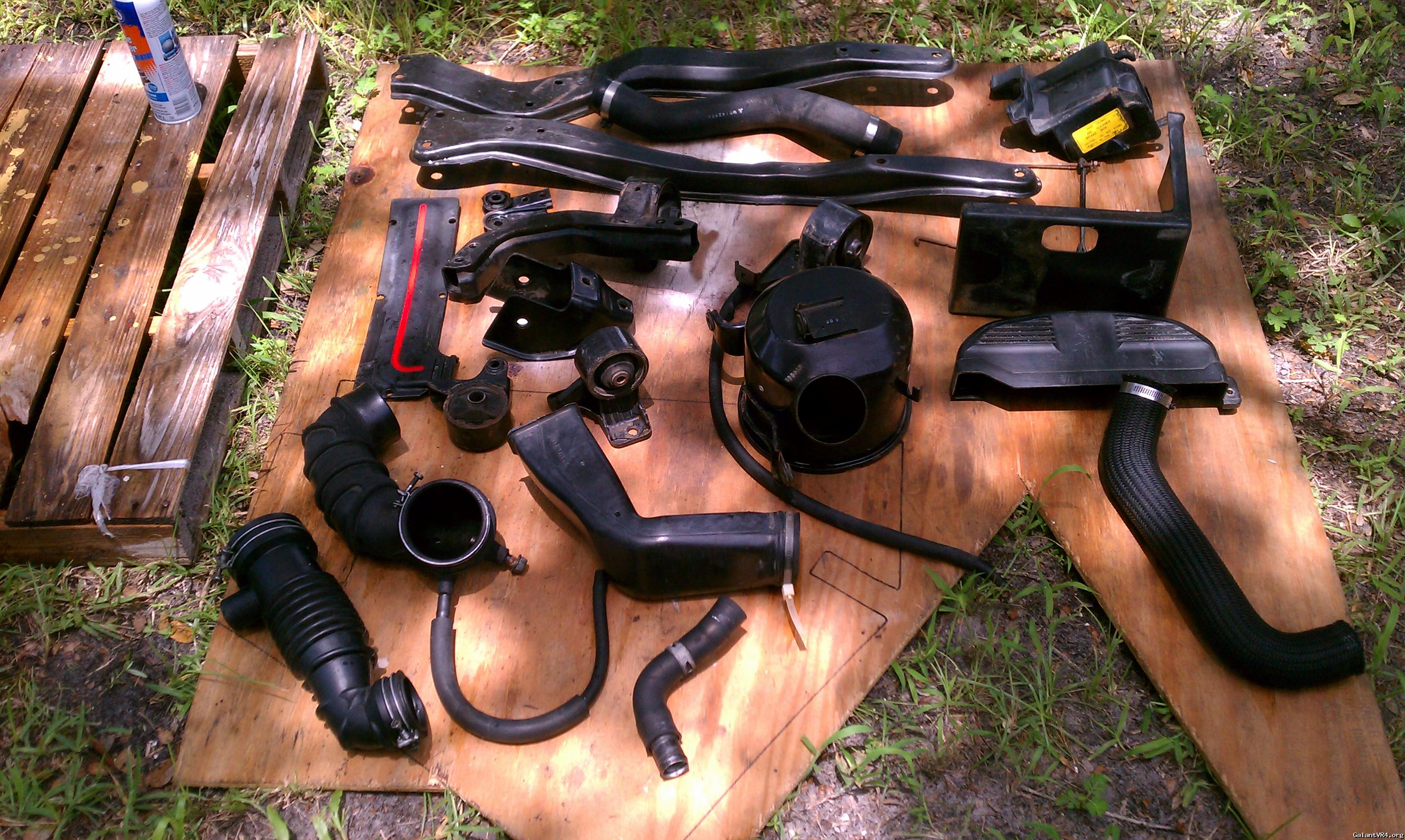

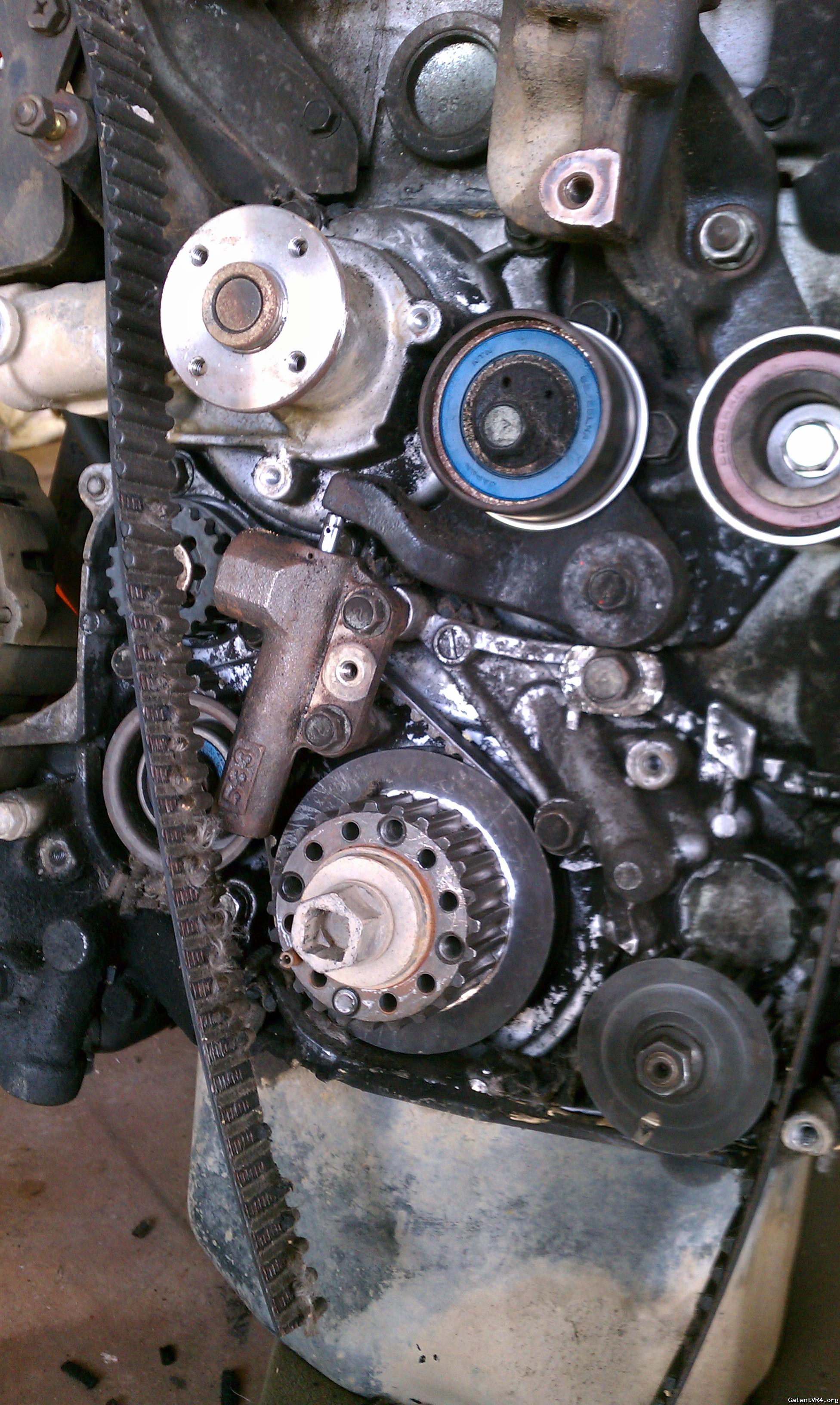

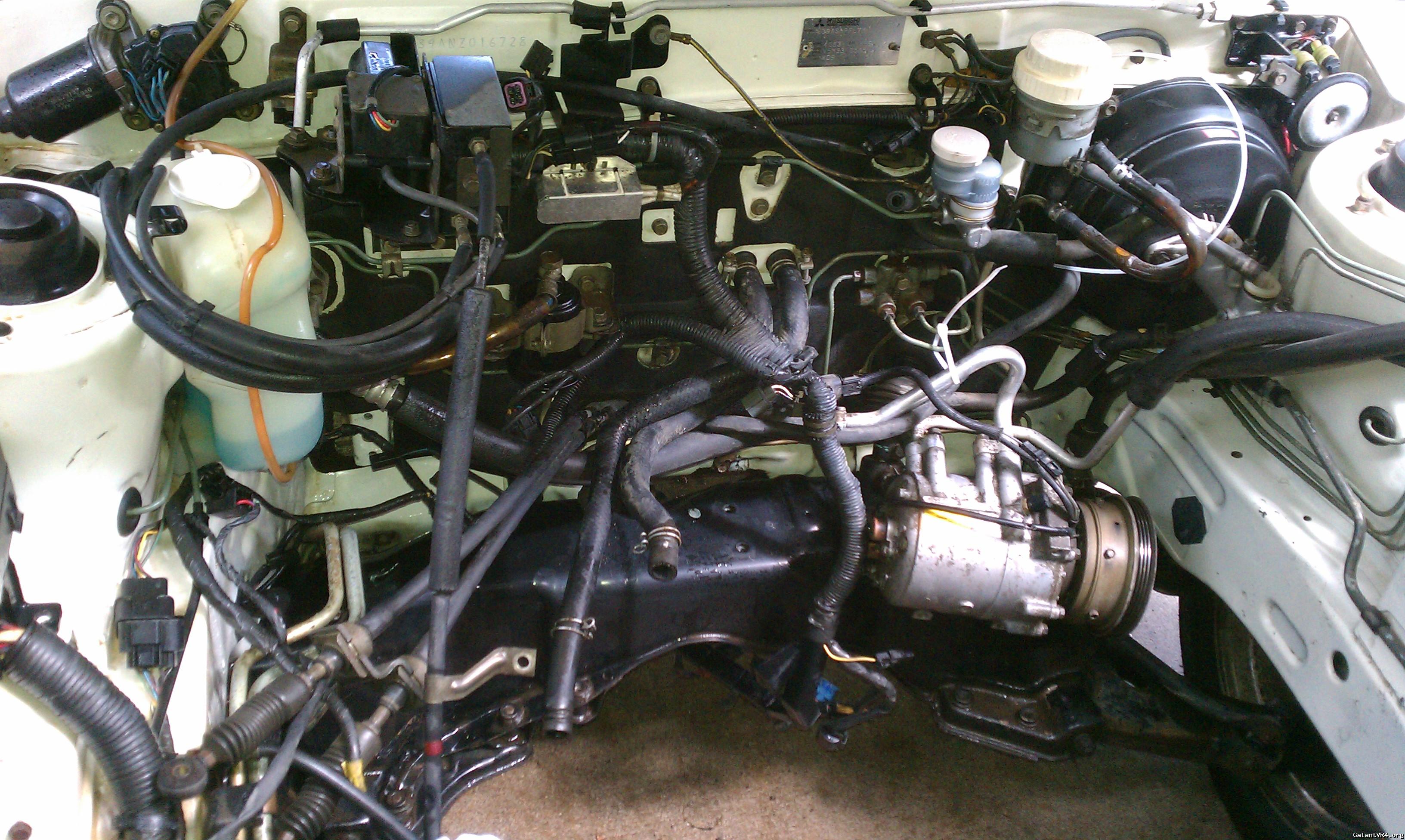

It looks like the belt has dry rot. I think this is what caused the teeth to strip. It only has 30k miles but the original owner had it sitting under a tree for the past 7 years. When I got it home for the first time I turned on the A/C and the crank pulley separated. Probably from the same dry rot issue. Here are some pics from this morning. Engine bay is done. Lunch break and then back to cleaning accessories/brackets etc.
Before:
After:

The belt only has 30k miles, or the entire car?
Make sure and check your pulleys, and the oil pump sprocket. Make sure they all spin freely. If an engine is running, teeth shouldn't just strip off at the crank, even if the belt is really shitty. I would think that something had to have bound up the belt, at least momentarily, for it to stop and allow the crank pulley to strip the teeth off of it.

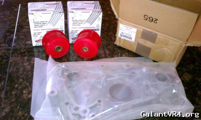

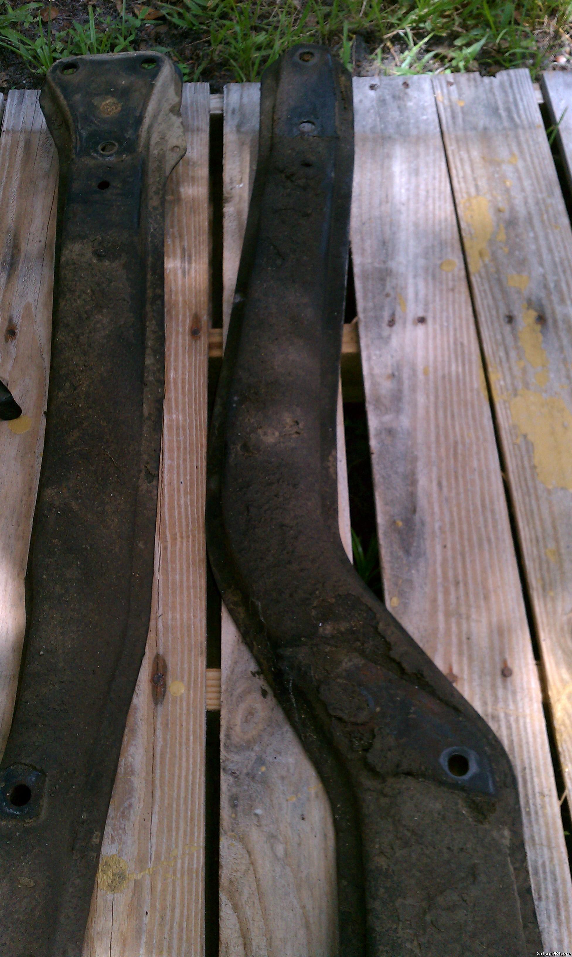

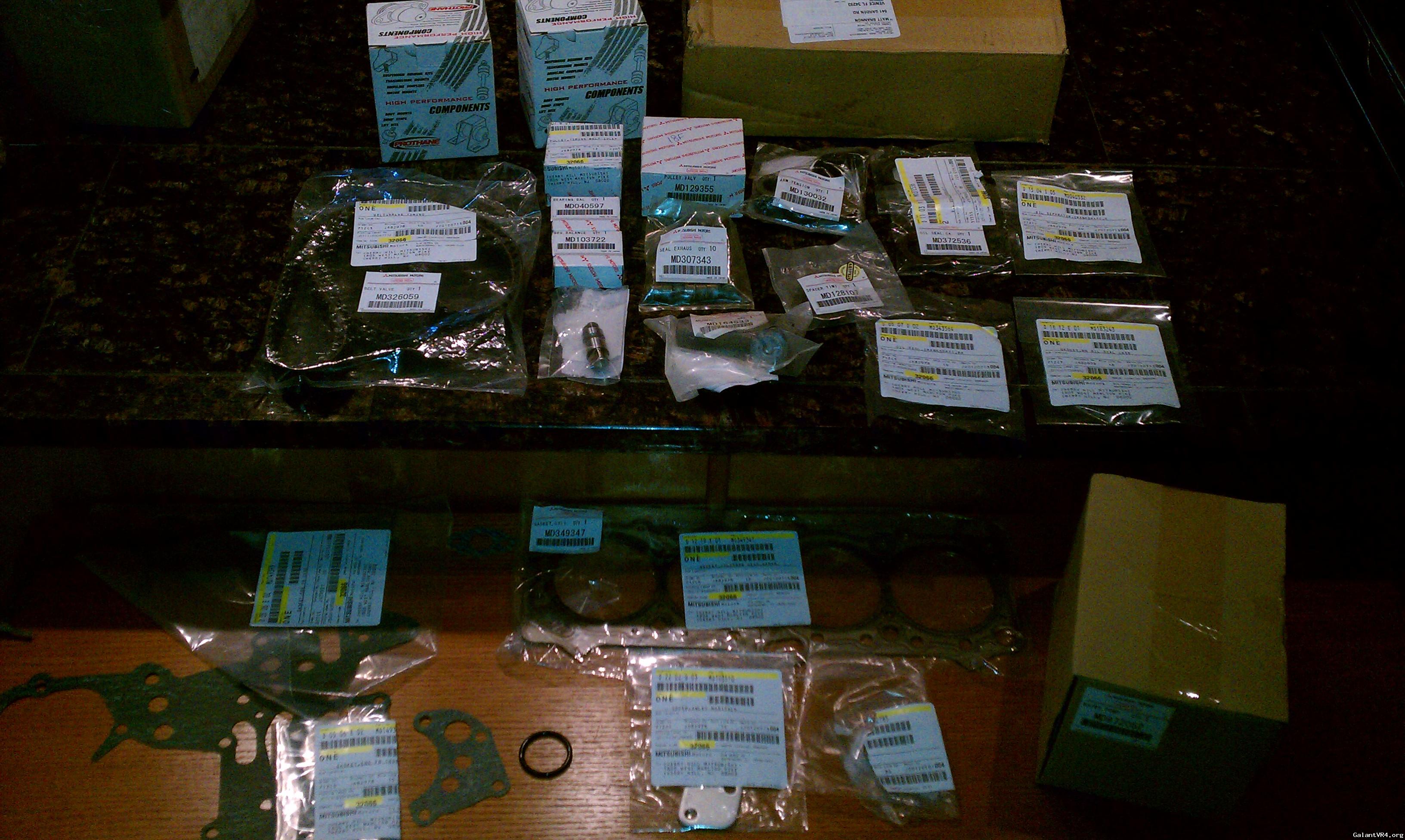

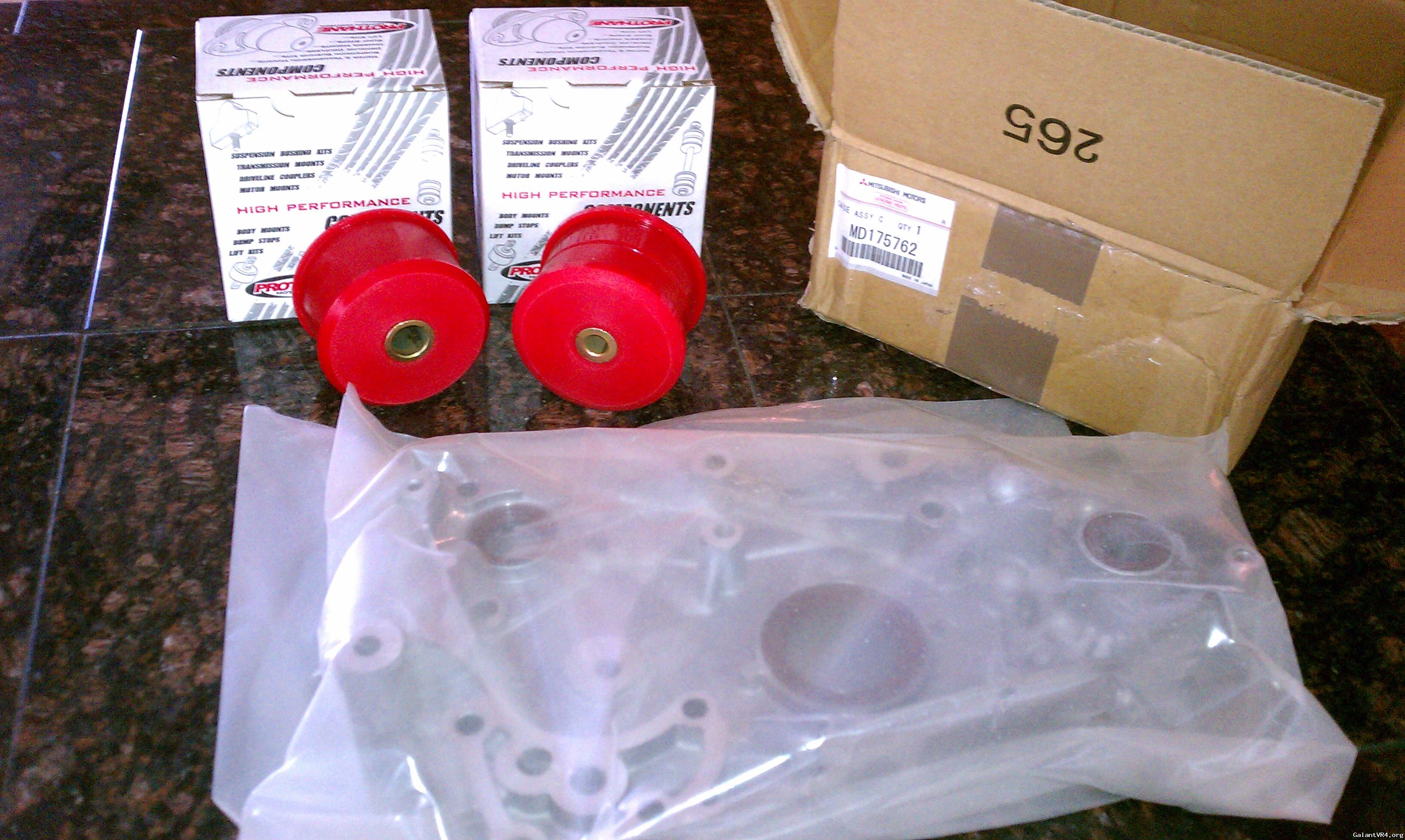

The belt has 30k to the best of my knowledge. The car has 160k. I bought it from the original owner who was a very nice older man and described every little detail of the cars life lol. Thats a great point about something being froze. I just got finished with stage 1 of cleaning so my next step is to tear down the engine. The crank and cams turn fine but I have not been able to look at the BS's or other pulleys. Fortunately FEDEX just arrived with my first round of goodies. Still have a lot more coming. Here are a few more pics (including a new OEM oil pump!)
Yuck!
That's a little better!
Goodies!

Wouldn't worry about the teeth stripping of at the crank, that is where most do it. Think about it, the crank gear is where the power to turn the belt comes from. Valvetrain, compression, etc keep the belt from turning, so the crank gear has to force the belt around, so naturally the first failure point.
With the belt off, turn everything by hand and look for unusual tightness or seizure. Otherwise, belt just got old and failed. One of mine did it 20 miles from the shootou, stripped the teeth at the crank. Had it back up and running in 20 minutes with 2 slightly bent intake valves. Still ran, just misfired until it got under boost. Drove it around for the whole event (was hoping to race it) and back to Ft. Wayne. Then we changed the bent valves, and drove the other 800 miles back home.

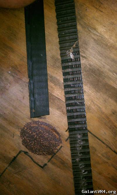

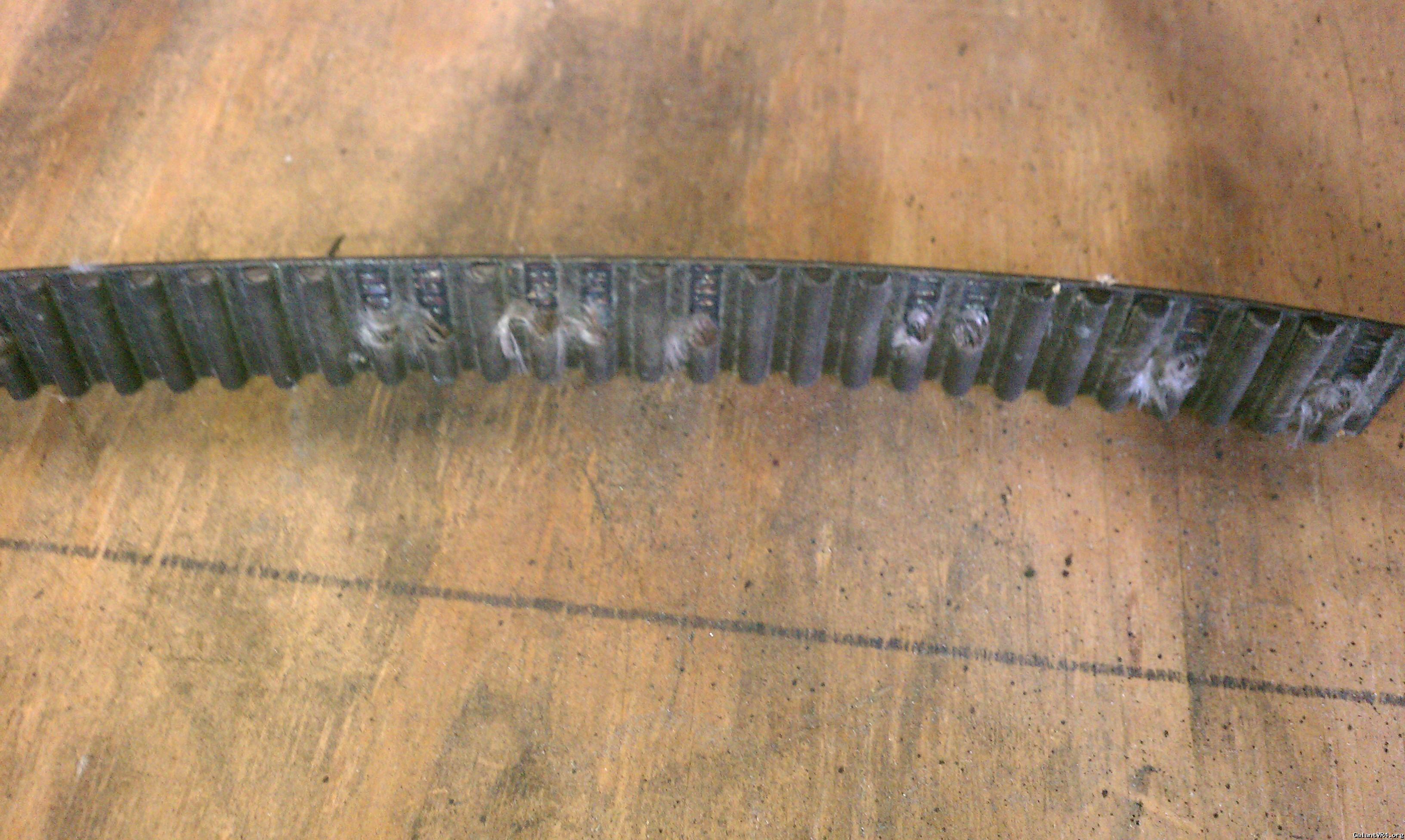

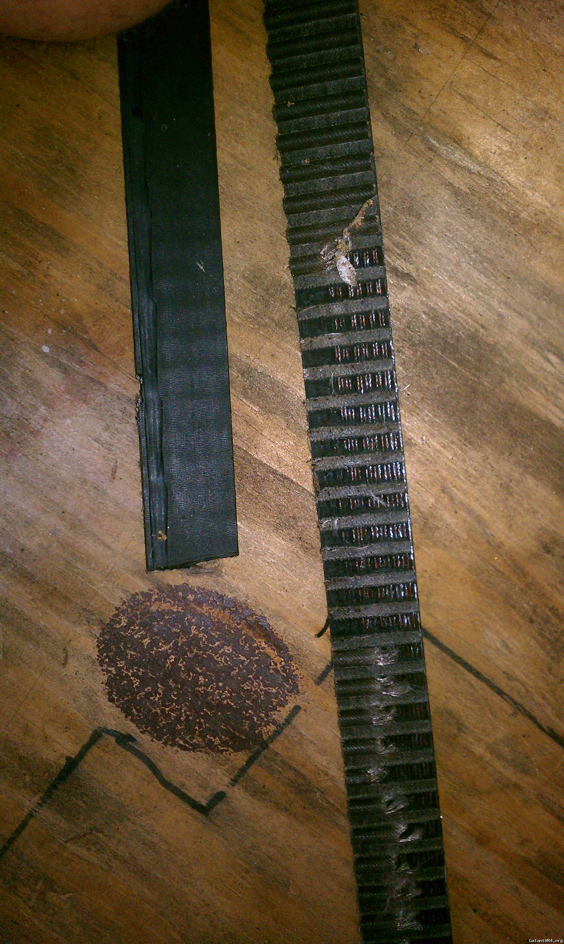

I have not been very productive this evening. I got the timing cover off to take a look. Everything spins freely as it should. It was just an old, compromised belt. I did notice something interesting that may or may not have caused a bad belt fail sooner than later. You can see from the pictures below that almost all of the teeth were starting to fall off on the side of the belt that did not have the groove over it. I think the groove potentially put more stress on the other part of the belt that was not grooved. Combined with the dry rot it was toast. Something I learned though was to take a better look at the teeth. I had been inspecting the top of the belt where the groove was and it never got any worse. Oh well, perfect excuse for cleaning and upgrades. I also have the ECMLINKv3 sitting here /ubbthreads/images/graemlins/smile.gif

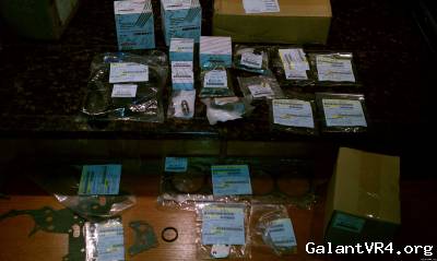

Fedex came back with more stuff!
Bad belt
You can see all the teeth sitting down there lol

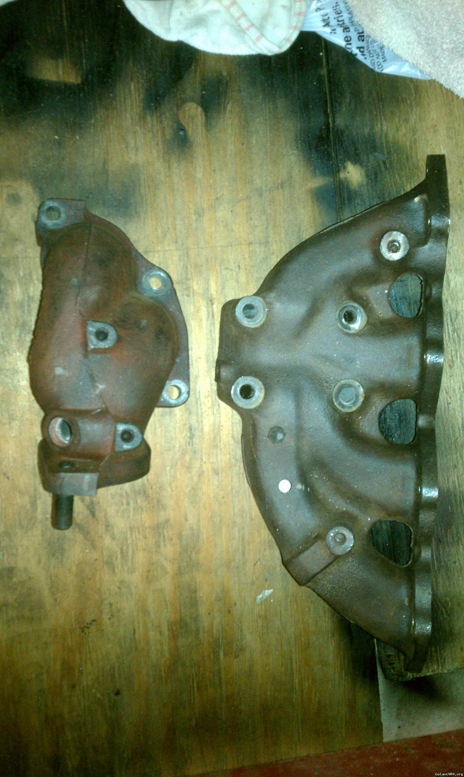

Been sick for the past week. Still not good enough to work on the car. If I don't feel any better soon I'm doing to the doctor. Anyways, I got a couple more goodies and a question.
Goodies:
2G Exhaust mani and o2 housing

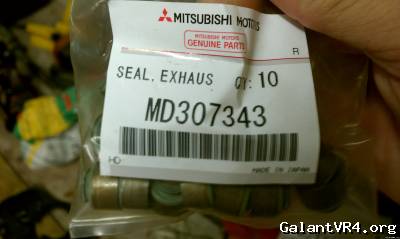

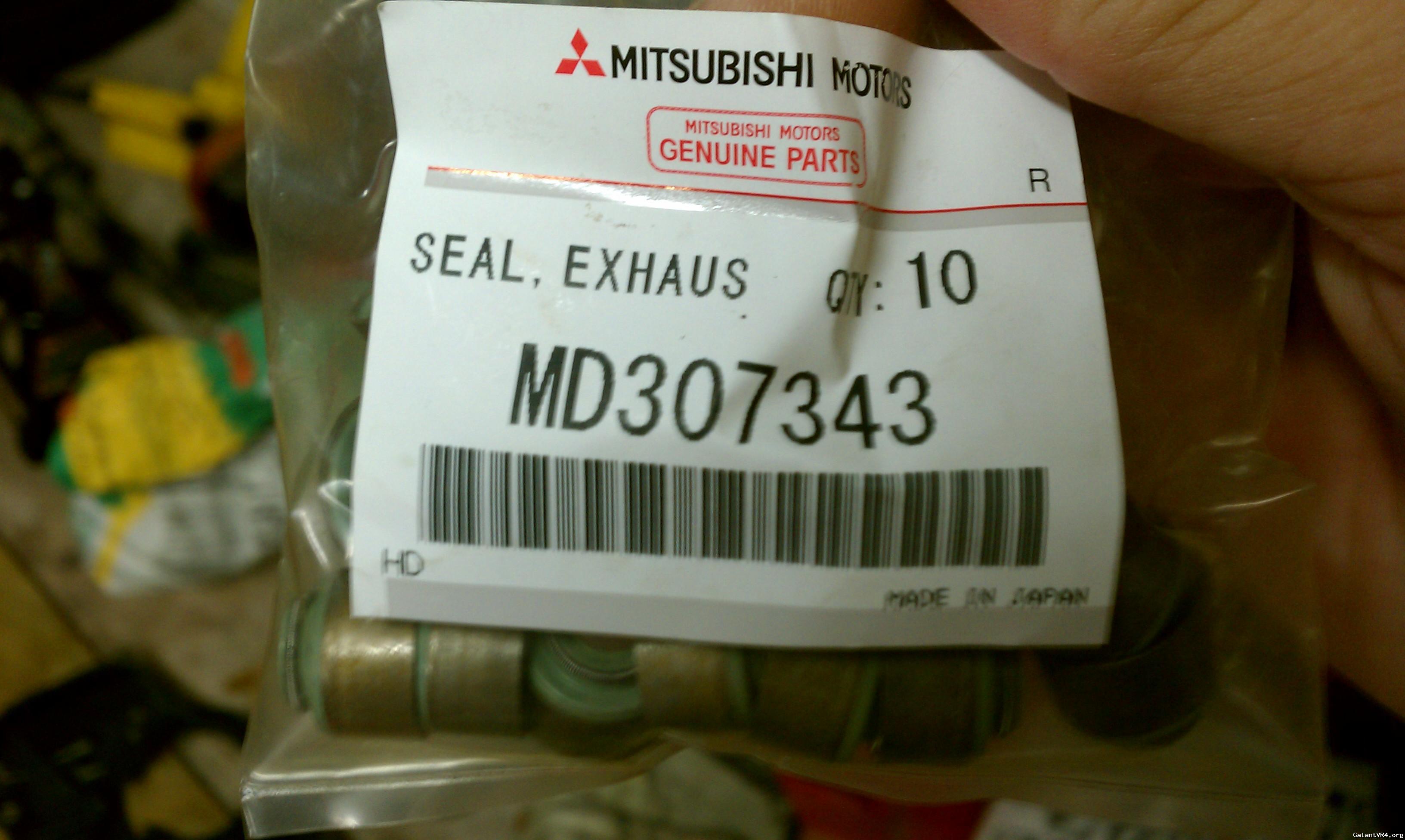

My question is regarding valve stem seals. My order came in from Mitsu with 16 exhaust seals. Can I use all the same seals for both intake and exhaust or did Mitsu screw up? Thanks!

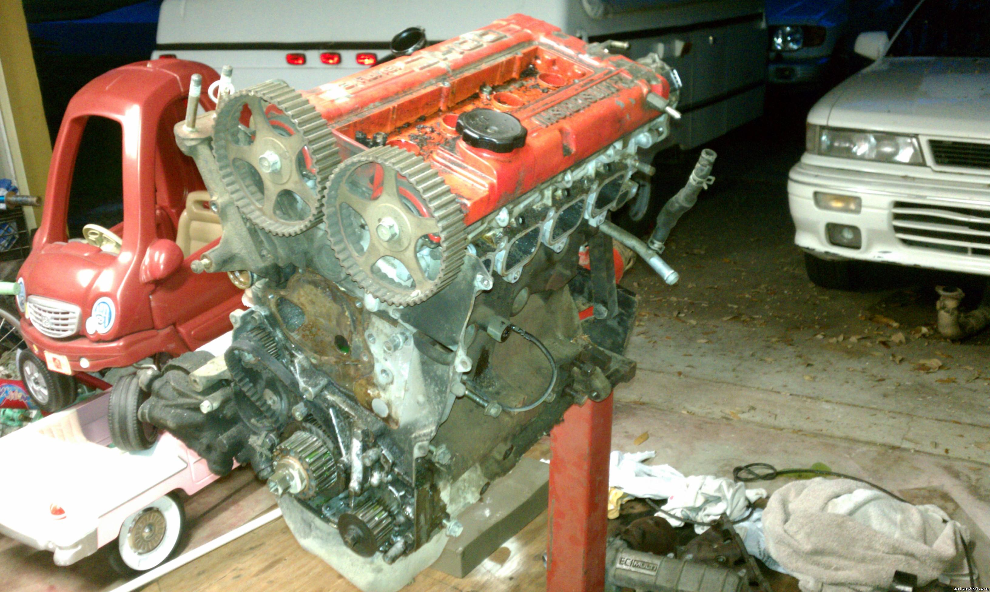

Went to the doctors today. Walking pneumonia. Got my meds and headed out to the garage for a little work. Got tired pretty fast so i didn't get much done. Got the engine on the stand and removed a few accessories. From a quick glance I see what looks to be two bent intake valves so far. I got all new EVO valves ready to go in /ubbthreads/images/graemlins/smile.gif

Man, what did you use to clean your engine bay? Mine will not clean up like that, I've tried multiple times lol
Terence
Quoting matt92vr4:
Before:
After:
matt92vr4
Oct 3, 2010
676
Venice, FL
I used dish soap with grease cutter in it, and about 5 scouring pads from the kitchen...and a lot of elbow grease. You could also try purple power. That stuff works good.
