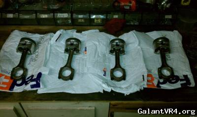

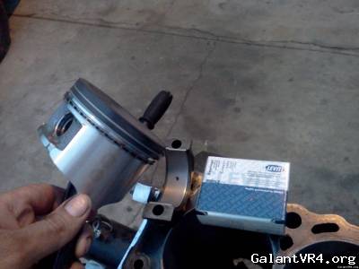

Hey check this link out click it has some pics of the 2g pistons I ordered but did yours come with some grey coating on the pistons. I’m just wondering because i ordered a set of pistons for a different car and the pistons came in a yellow NPR box not like the one I ordered which say Nippon Racing and pistons look totally different.
Did the ones you order look like this.
matt92vr4
Oct 3, 2010
676
Venice, FL
No mine didn't look like that. Mine looked like stock Mitsu pistons.
When I asked Josh from DSMgraveyard why it was taking so long he said they just received a bad batch of pistons and I didn't want the ones they had. I asked him exactly what was wrong with them and he said something about cracked skirts. He was kinda fumbling around a little so I don't really think he knew what he was talking about or he was making up a story. After looking at your link, I bet they are having knockoffs made in China and they got a bad batch. They probably come in the white boxes. Can you tell if that writing is Chinese or Japanese? That was back in February, how are those pistons working out for you?

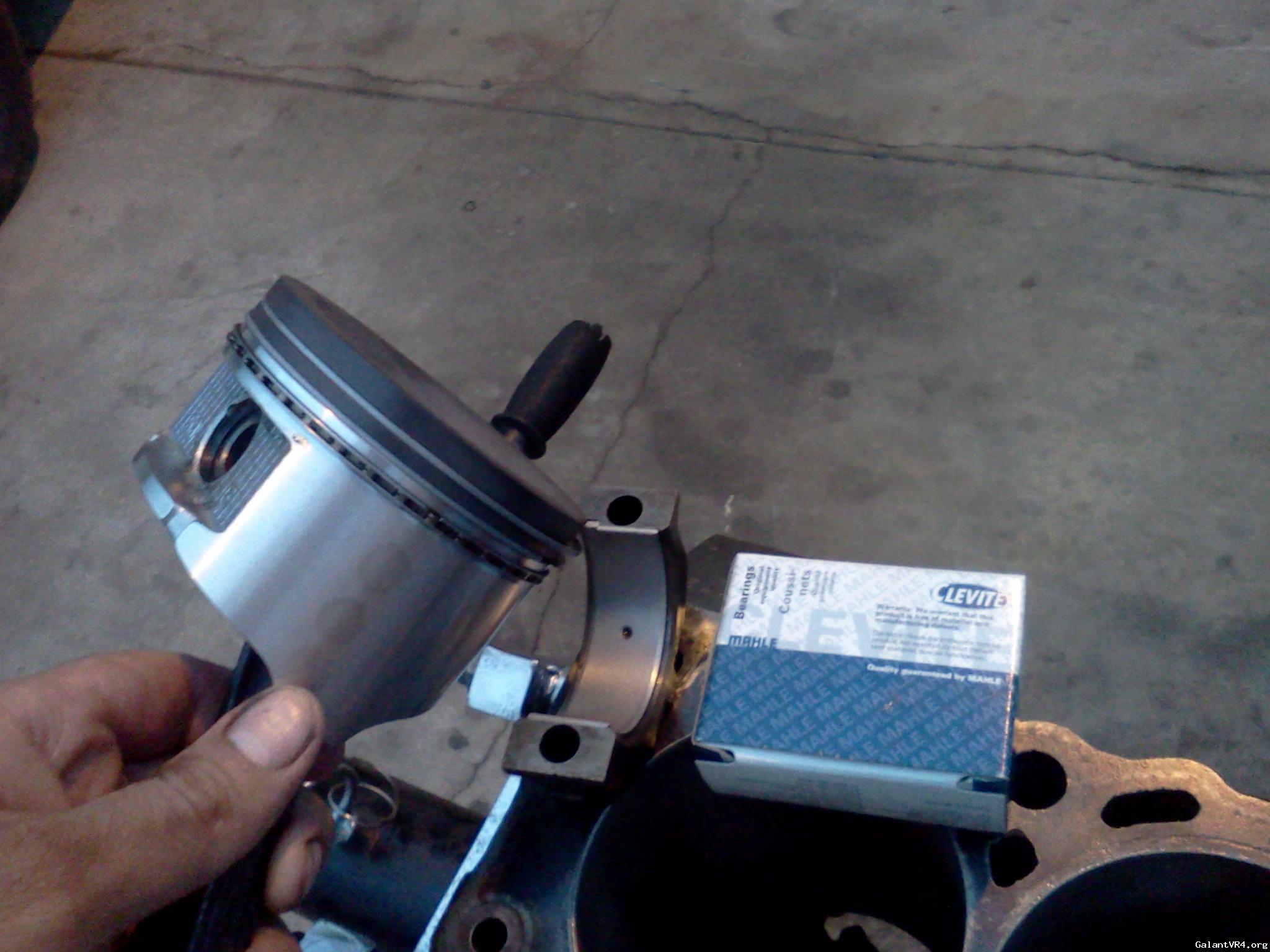

My pistons were already pressed onto the rods when I got them so I didn't get to see the boxes. They were wrapped in FEDEX bags. Keeping my fingers crossed...

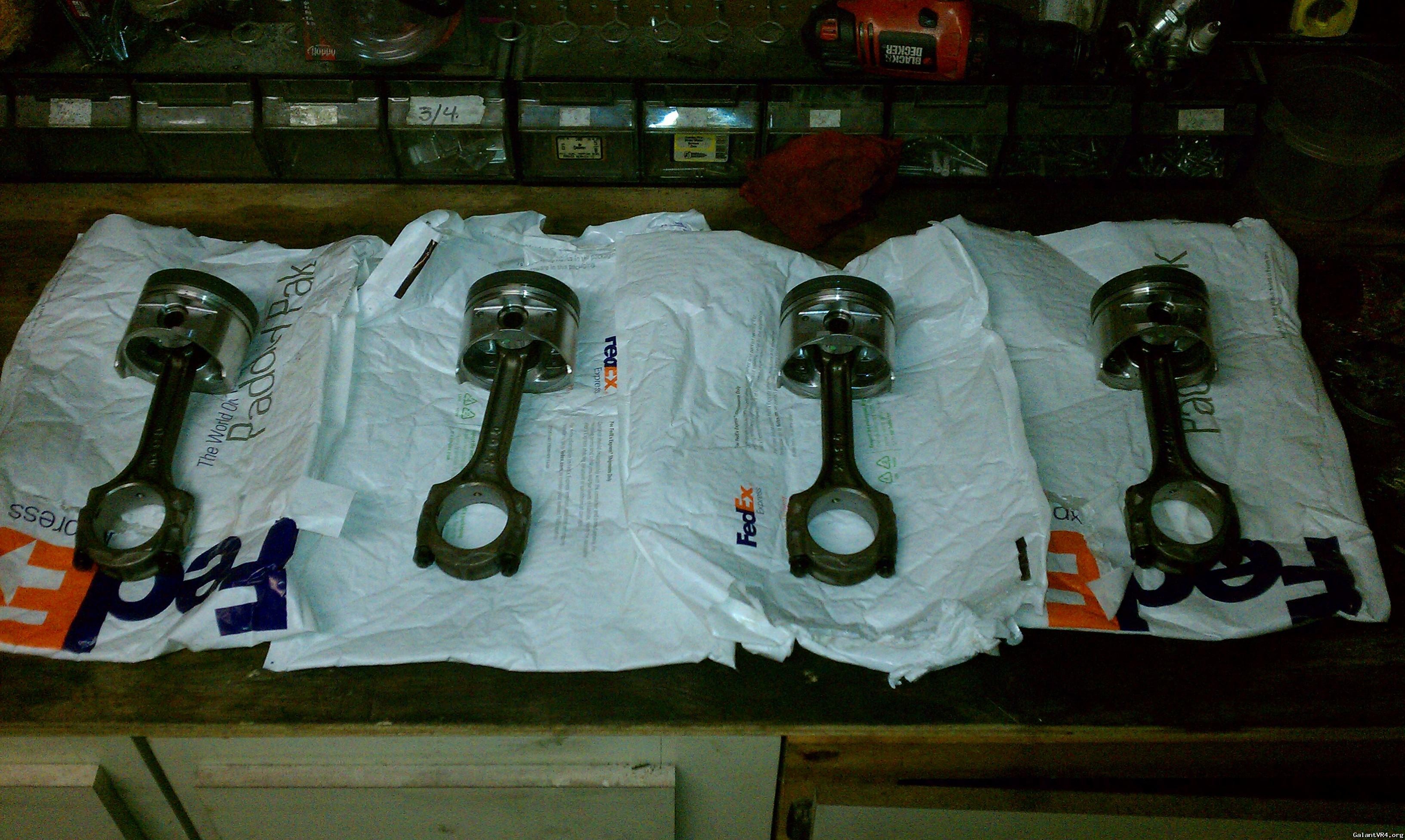

This is the link where I purchased my set. Honestly it's a bit confusing. The title says NPR 2G piston. The picture shows Mitsu emblems on the pistons but reminds you that they are not OEM parts. I kinda wish I went with the EVO9 pistons instead. Oh well...
Here is the only pic I can find of my pistons. This is after I removed them from the FEDEX bags that they were wrapped in.

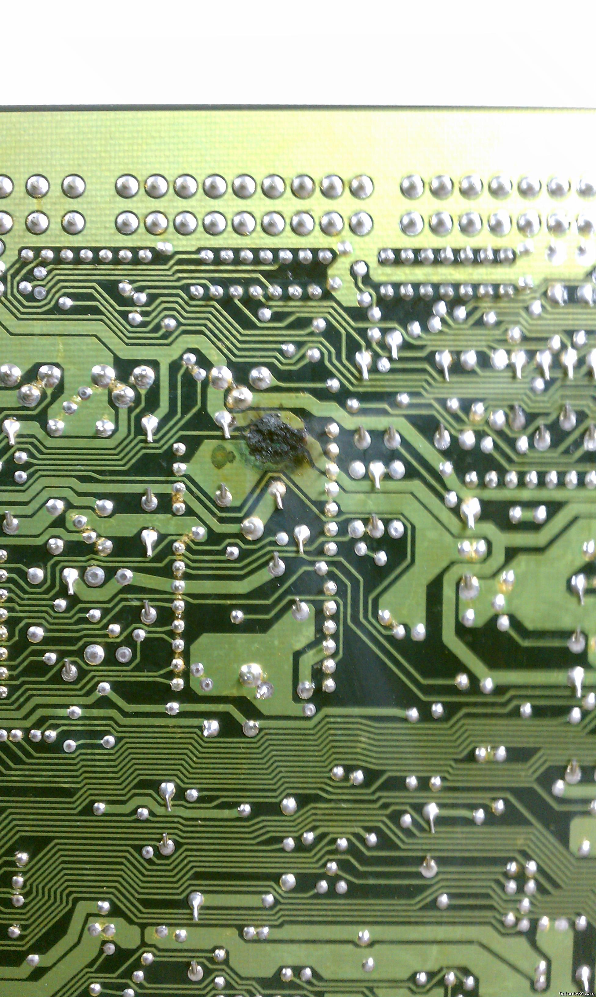

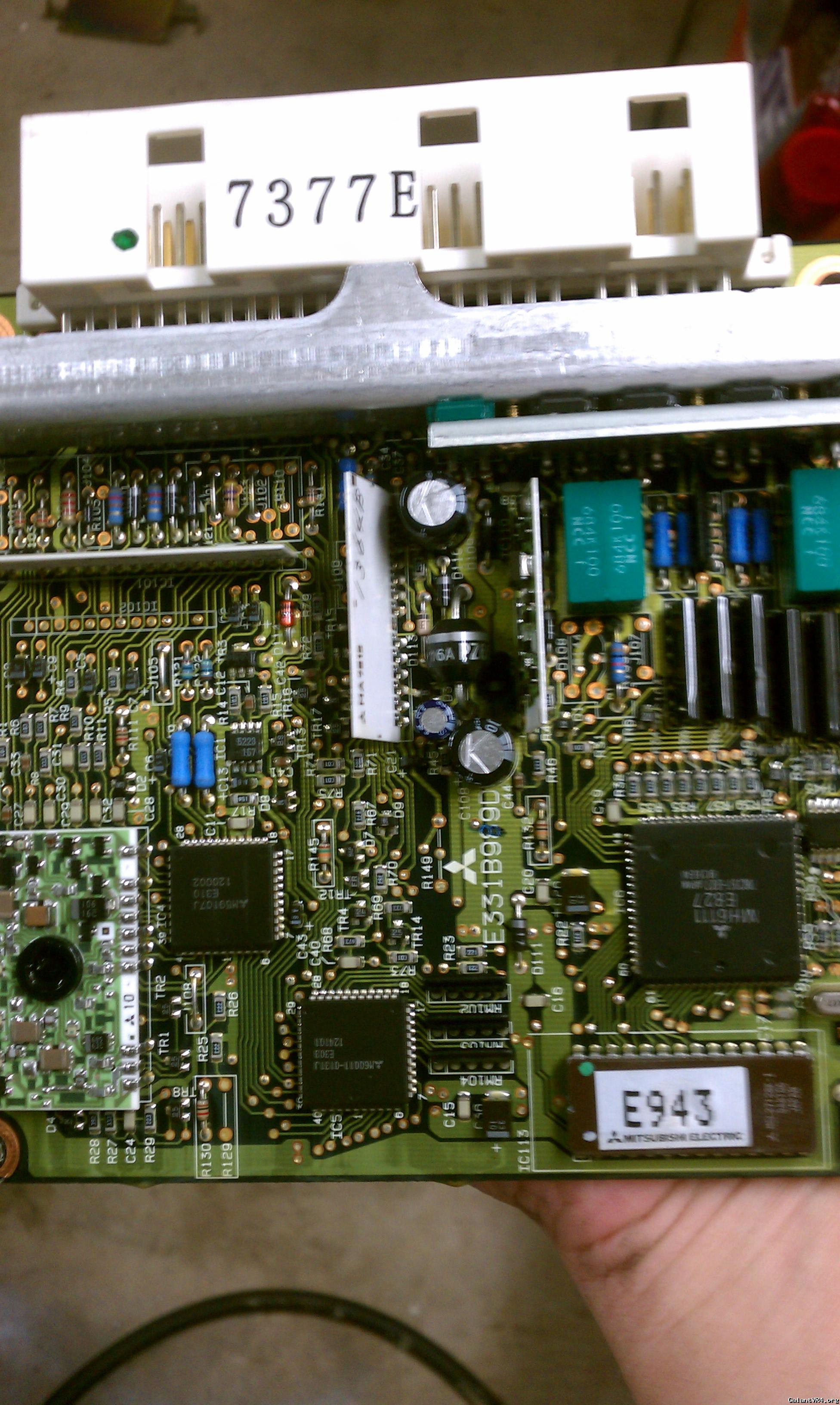

1000 mile update. Everything is going great. I'm running 10psi wastegate pressure. I have ECMLINKv3 waiting to install but I probably won't have time for that until late this year or 2014. So I decided to temporarily buy a eprom ecu with a chip burnt to my specs. The car ran perfect with the stock ecu and injectors and I was a little scared to install my 1000cc injectors and the chip. I decided to go ahead and do it two days ago. With the new ECU the car runs even better! Absolutely perfect! I can't believe how well it runs with the larger injectors. I opened up the stock computer and found a bad spot (see pics). Maybe this was a problem!
Thanks to Big D for the chip and new ECU. My plans are to run this until I have time to install and tune the ECMLINK. Then I will compare the 1/4 times of the 1G MAF and speed density.

That's great Matt!. Send me that ECU and have it repaired with some new caps. /ubbthreads/images/graemlins/cool.gif

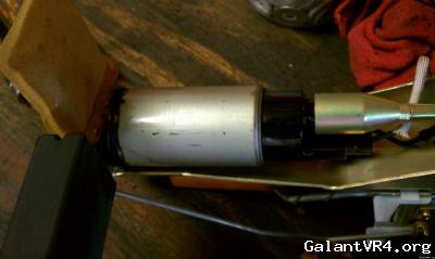

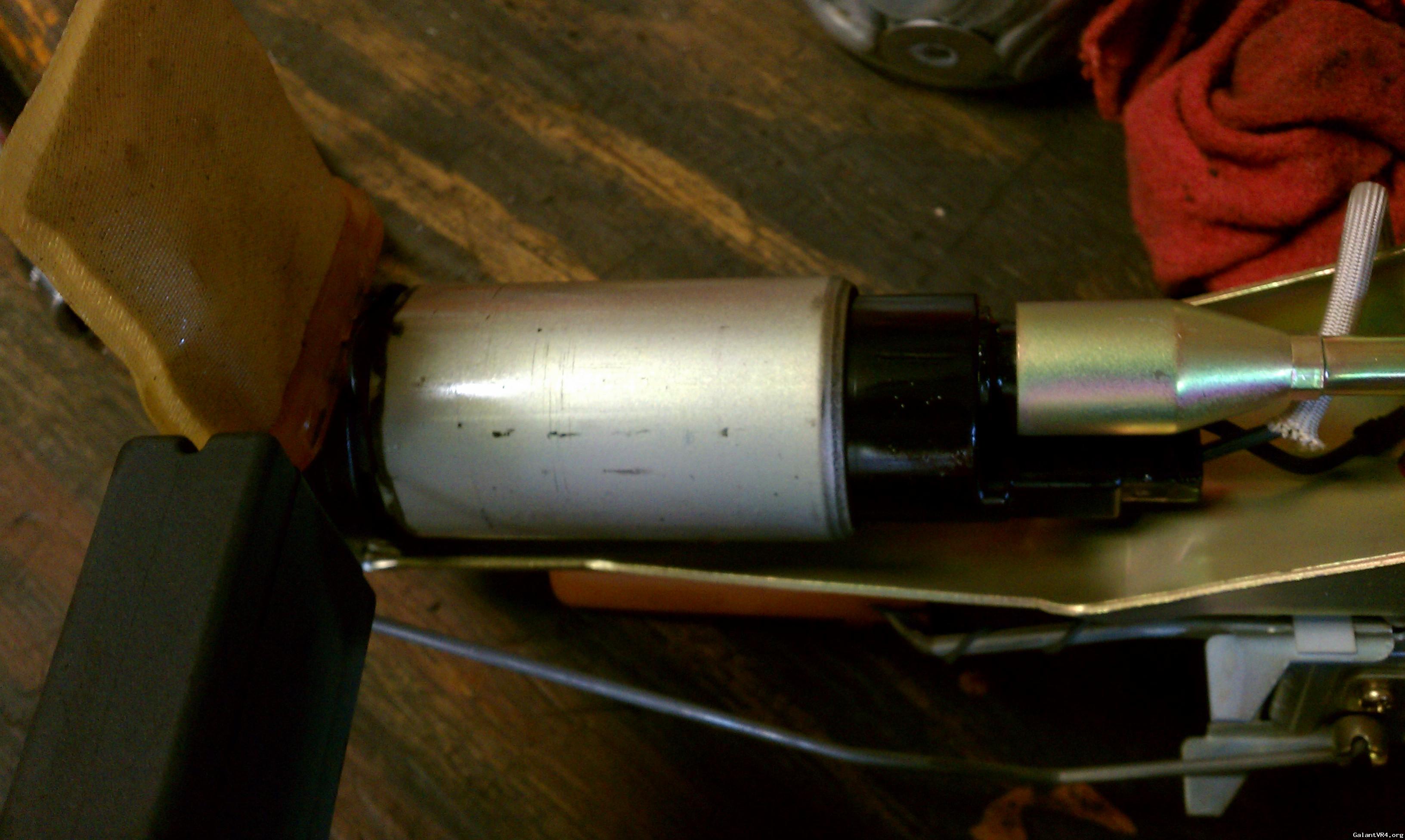

I tried to install my walbro fuel pump about a year ago with no luck. At that time I was unable to loosen the gas line under the car. I've been shooting PB Blaster on it occasionally for the last year. Today I tried again and it loosened right up! Awesome!
So after breaking 3 of the 6 8mm studs off of the tank I removed the pump assembly. Denso 195130-2020. Best I can tell it's a non-turbo 3000GT pump. Does anyone have any additional info on this? The flow rates are terrible for this pump! Fortunately I've only been running 10psi!
I bought the car from the original owner who is now an older guy. The best i can tell the stock pump must have died at some point and his mechanic dropped in this POS.
Going back out to install the Walbro. I'm gonna have to drill out the broken studs on the gas tank. Not looking forward to that.
Old pump...

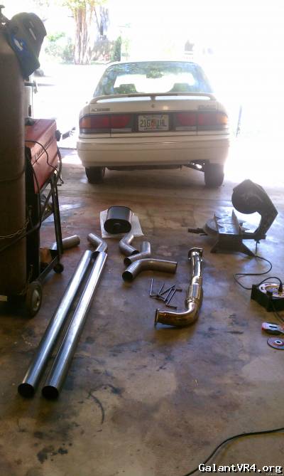

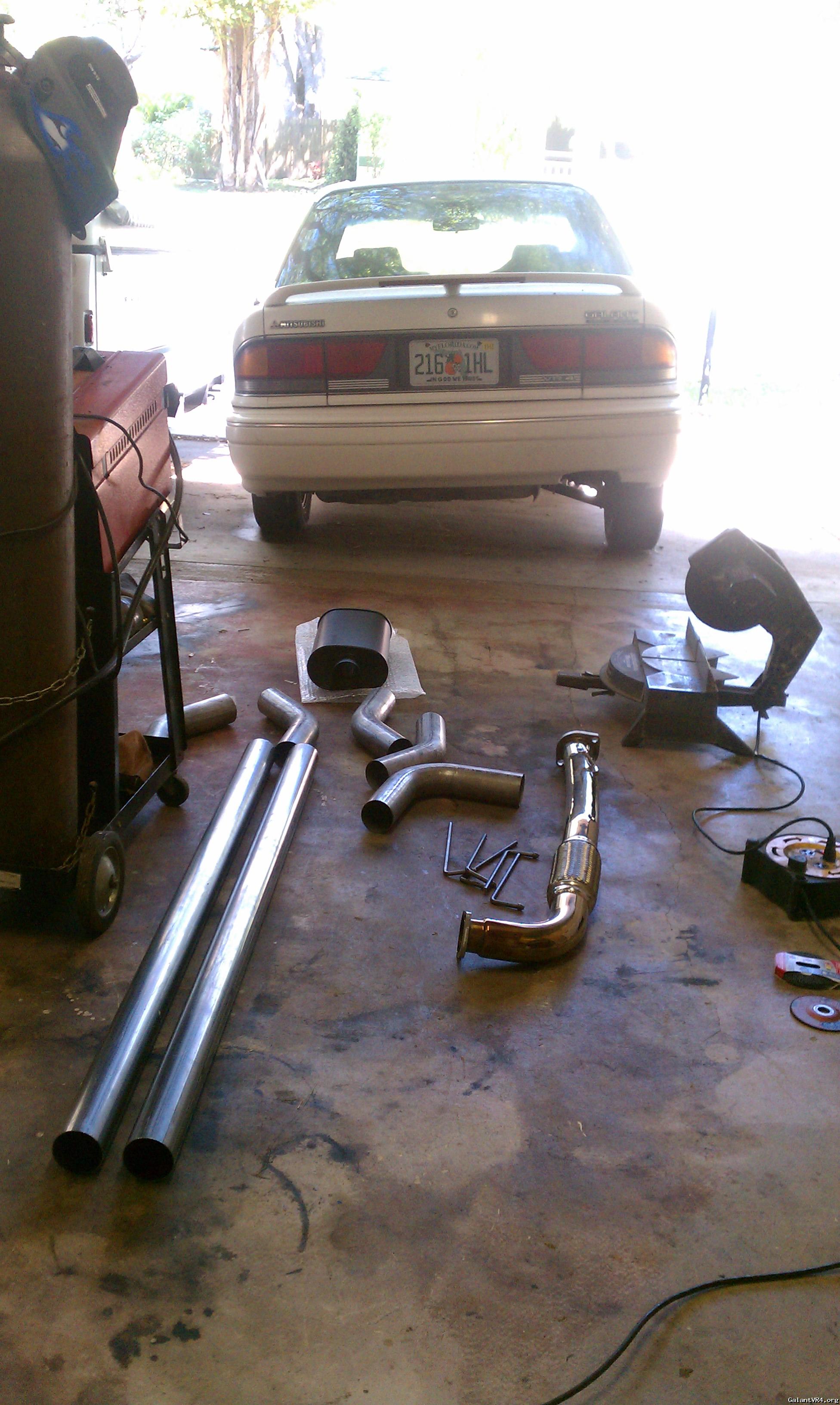

Headed out to build the exhaust. I'm really bad with geometry so this might take awhile lol. Measured the DB's in the car with downpipe only, windows up. All measurements in neutral because I'm too old to drive around like this anymore.
engine off: 30db
engine idle 1000rpm: 60db
engine steady 3000rpm: 55db
two step 5500rpm: 62db
When I'm done (hopefully today) I'll post the results and also exactly what I used, how many, how much$, and where I bought it. Maybe this info will be helpful to someone in the future.

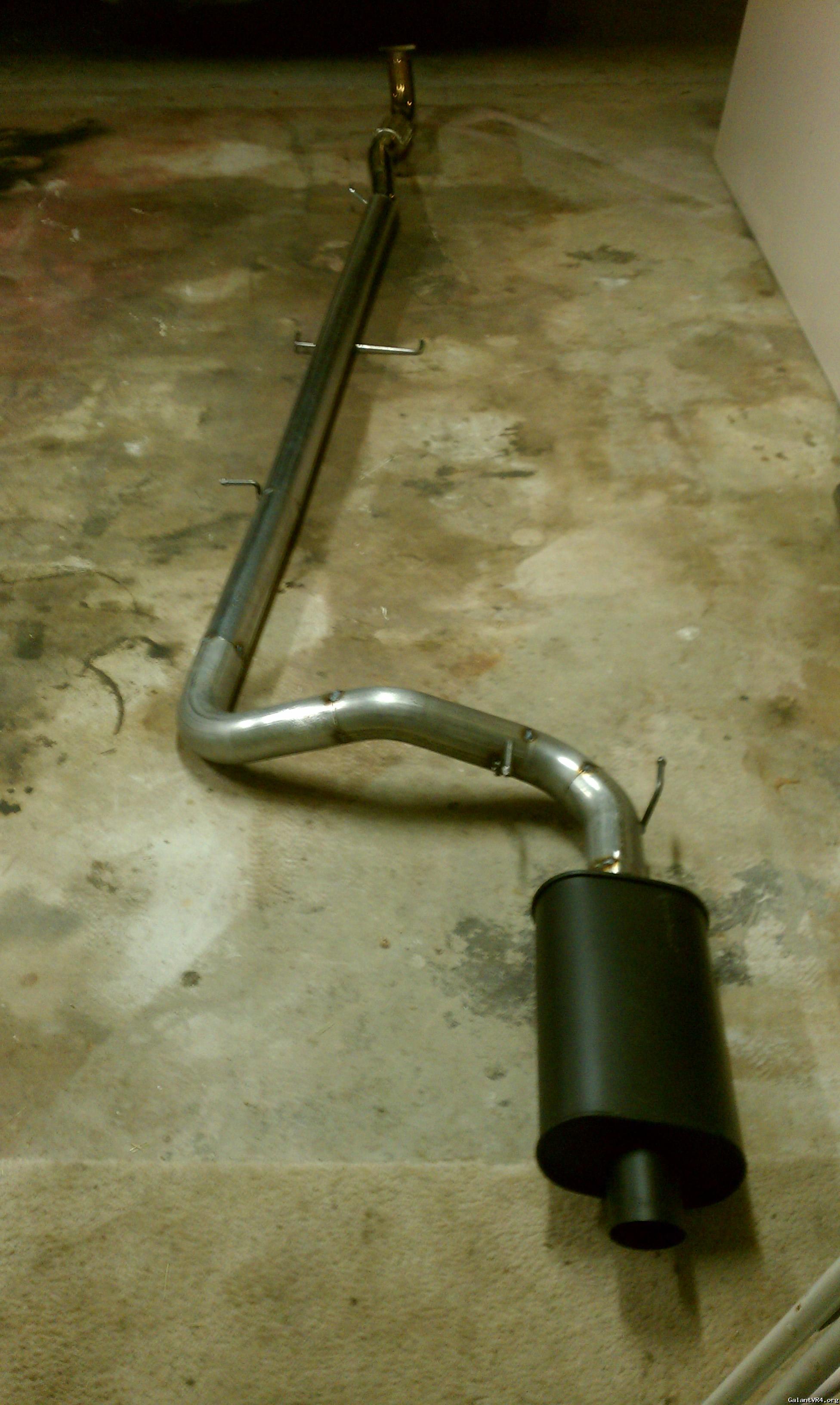

UPDATE: Well I ran out of welding gas so I'm done probably until next weekend. I got her all tacked up. So far I'm really happy with the outcome.
matt92vr4
Oct 3, 2010
676
Venice, FL

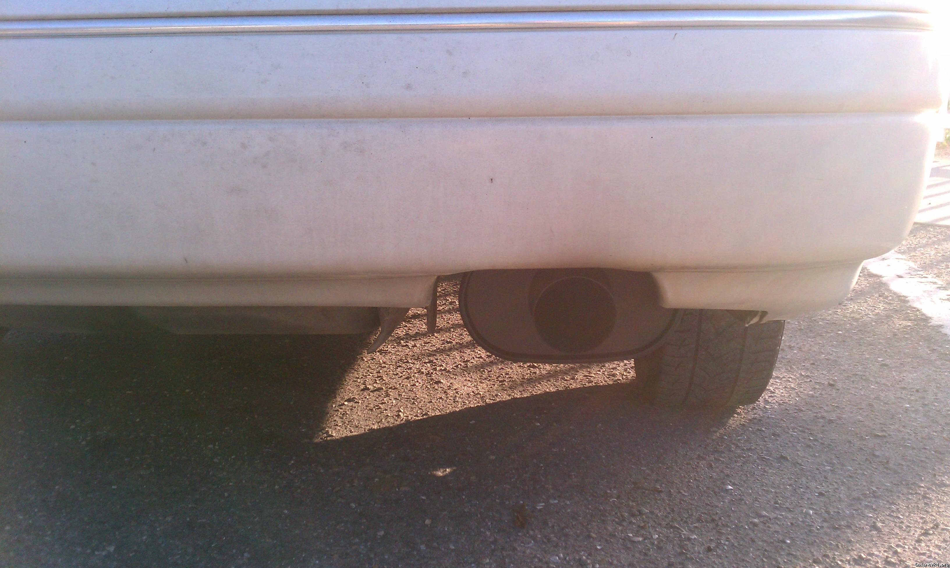

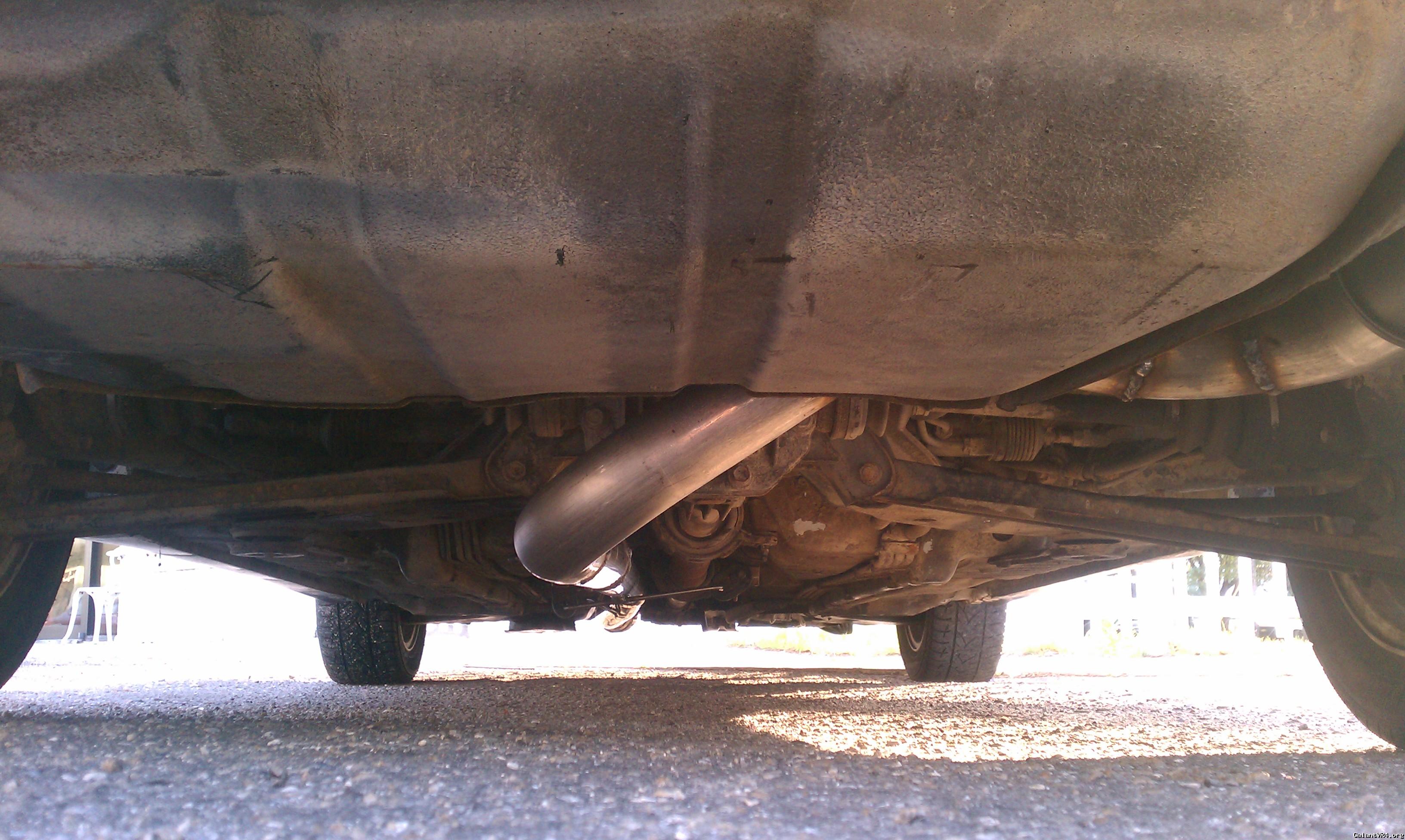

Finished the exhaust last night. I'm really happy with it. It's much quieter than I expected, which is nice. There does not seem to be any annoying drones. I can still hear my kids talking in the backseat lol.
Please excuse my less-than-perfect welds and the dirty undercarriage.
