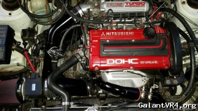

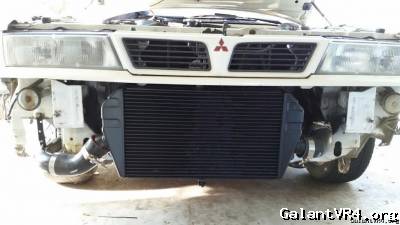

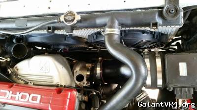

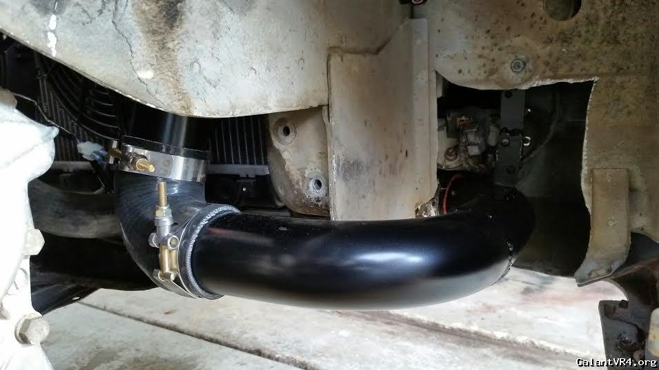

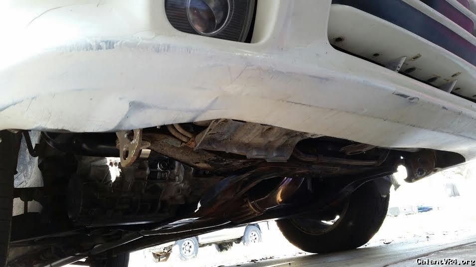

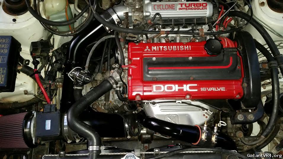

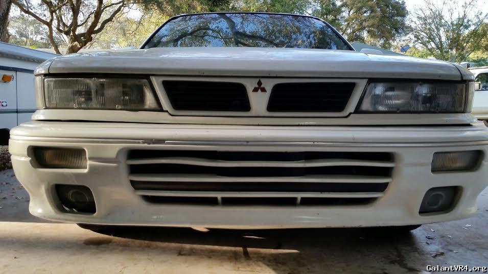

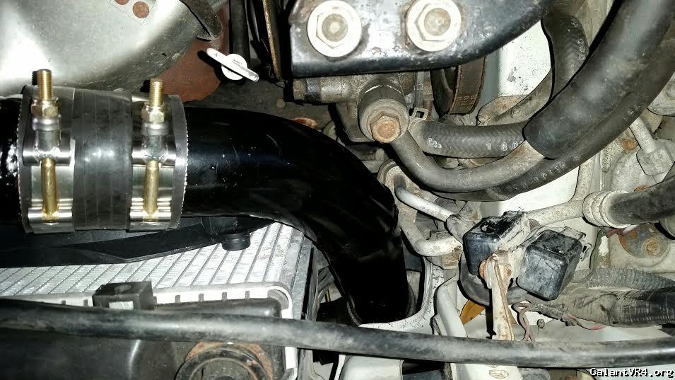

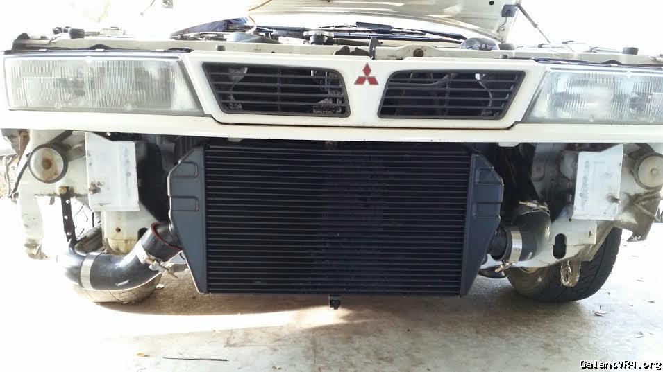

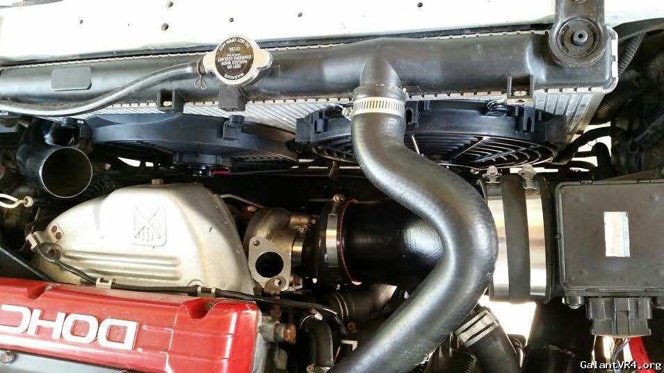

Anyways, I finished up the install today and added a second slim fan. I'm really happy with the outcome. Butt dyno approves /ubbthreads/images/graemlins/smile.gif Here are some pics.
Slim Fans

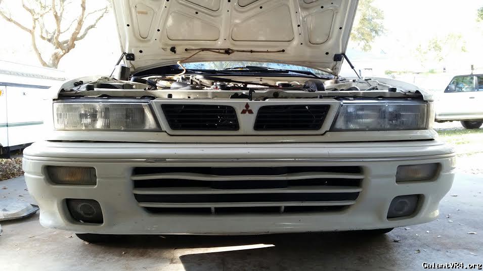

IC complete with the bumper off.
Bumper on.
Nothing hanging out of the bottom.
Passenger side tucked up close to the foglight. This is where I cut too much metal in the previous step. Plastic panels hide all of this.
Hot side pipes.
Engine bay etc.

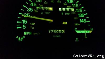

Been DD'ing it for the past 3 months. Hit a small milestone yesterday. 175,000. Still running at 10-11psi. Last week I had a frozen left rear brake caliper. Found a replacement at Advance Auto. List of mods I hope to install soon:

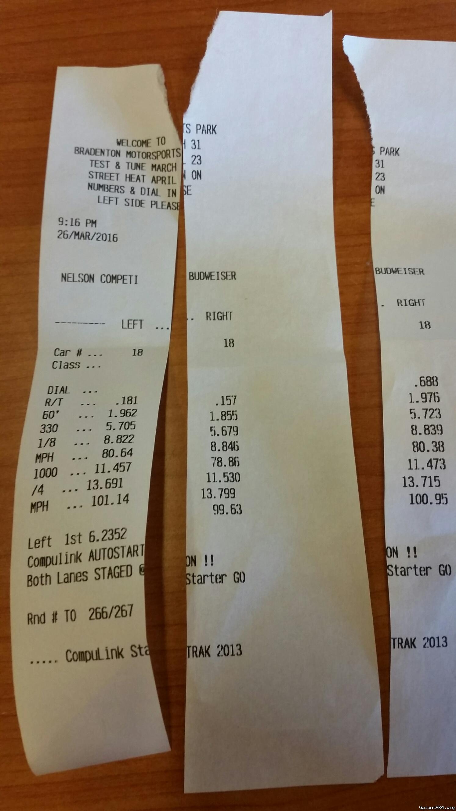

Went to the track on Saturday to check out some EcoBoosts. Thinking about getting in to them so I thought I'd go take a look at what was available. It was the same price to watch or race so I figured the Galant would be upset just sitting in the parking lot. Not looking to break any records, just have some fun.
Got 3 runs in before it was time to go home. Ran like a champ but pretty darn slow. 19psi and a ton of timing pulled out. I think I have 12 degrees pulled at some places just to be safe. Two step at 4500. The slowest run had a passenger riding shotgun. All three pretty consistent. I don't have the wideband installed yet. I suspect I could pull a little fuel out and add timing when I have time to tune better. Best run was 13.6@101 and two 13.7's. I beat a 80's Monte Carlo and a gutted Civic. Lost to a c5 in the very last few feet after pulling 5+cars on him at the tree. He complimented the car later in the night.
