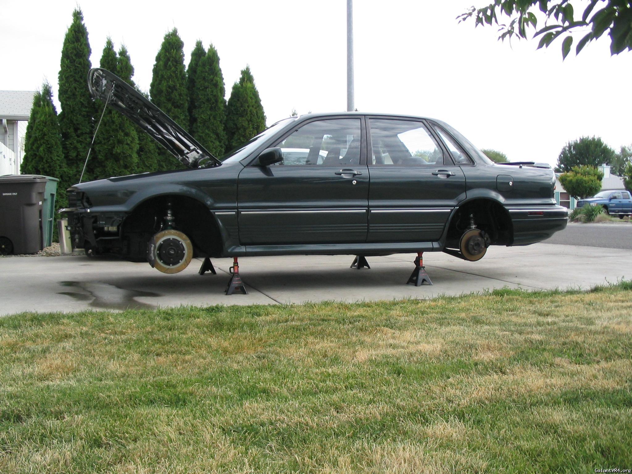

All I use is DIY pressure washer booths. You still can't get to everything unless you jack up the car or get down on your hands and knees to spray down the underneath and hit all the nooks and crannies that the salt likes to hide in and start corrosion. I don't get down on my hand and knees at the local carwash in the summer, let alone the winter. When I do underbody and engine cleanings on 1051, I use my SnapOn pressure washer at home in the driveway. That way I can spray the motor down while it's still cold and I can put the car up on jackstands. Like so:
The Teins on 1051 look almost as good as the day I bought them, but that car doesn't get driven in the snow. We'll see how the AGX/GC combo on 503 fares this winter. They haven't used salt in the PNW for decades, but last year I remember seeing a white film all over the car after the drive home from a day of skiing. Is that indicative of salt use?
