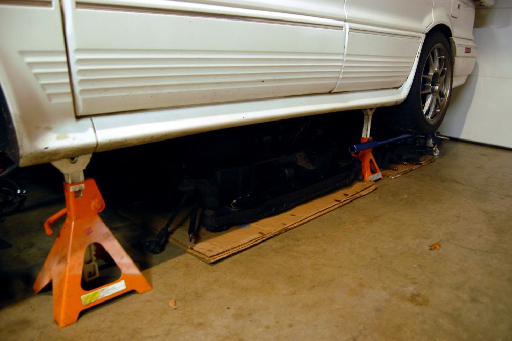

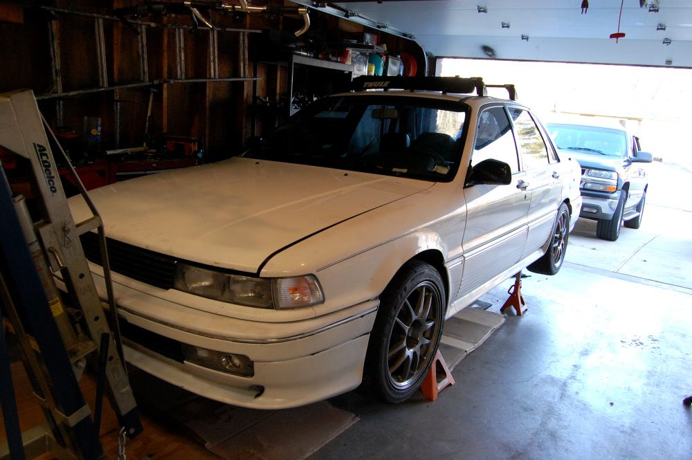

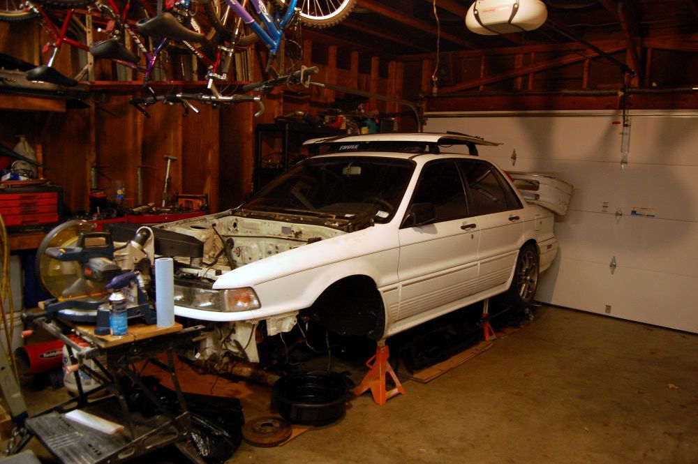

Well, after a hardship of broken parts and bad rod bearings I had to put the VR away for the winter and I'm going to keep a tab on everything I do with it from the time it enters the garage to the time I drive it out. Here is how she sits so far:
Just a little representation

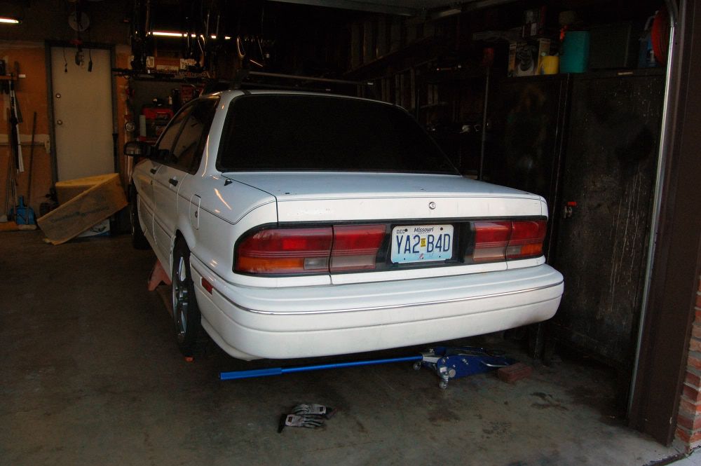

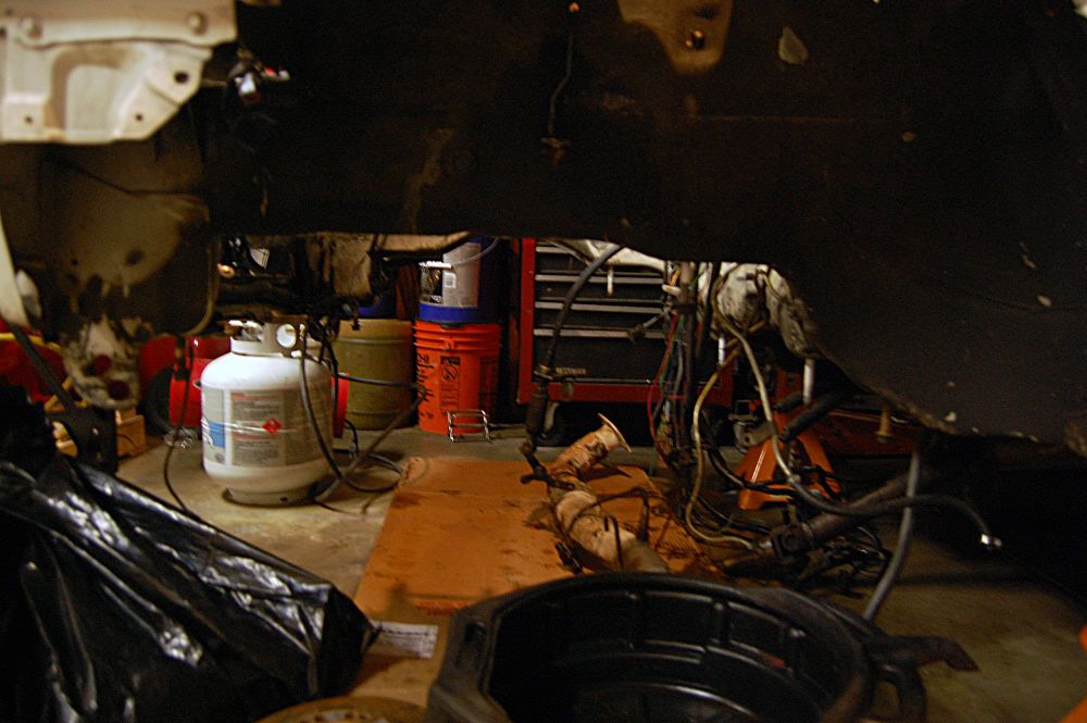

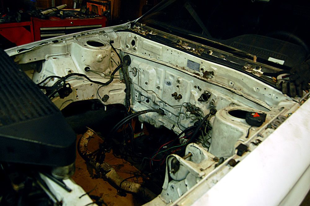

Pulled the front subframe and motor mount brace. Everything is going smooth as glass and I hope it stays that way throughout the rest of the build!

Finally worked up enough motivation to continue in progressing through this build. We spent last night pulling the subframe but it got too late to dismantle all of the individual pieces. I'll have pictures once I begin ripping it apart tonight.
