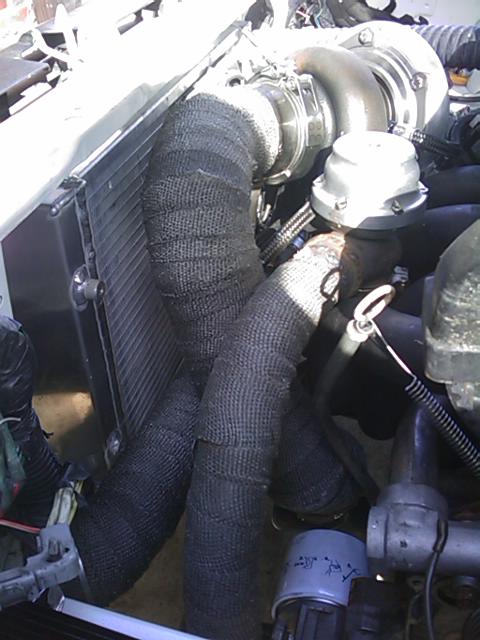

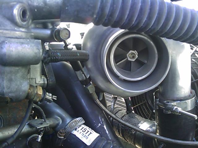

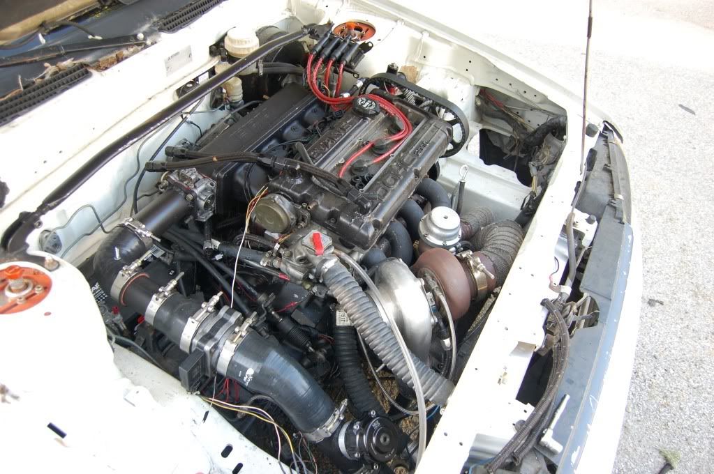

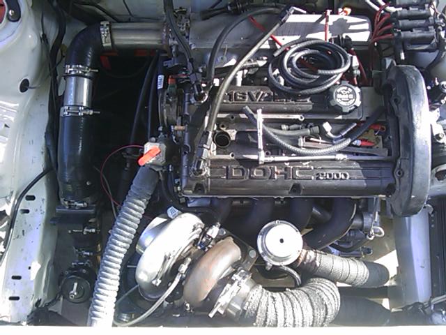

Water lines are done, turbo is 100% bolted down (compressor housing, center cartridge, and exhaust housing), lower intercooler piping has been heat wrapped, tapped for a boost pressure source and installed 100%, radiator hoses are completed and bolted down, heater hoses are done and whatnot. I have 3 tracking numbers to keep my eye on and I'll let you guys know when everything is in and done!

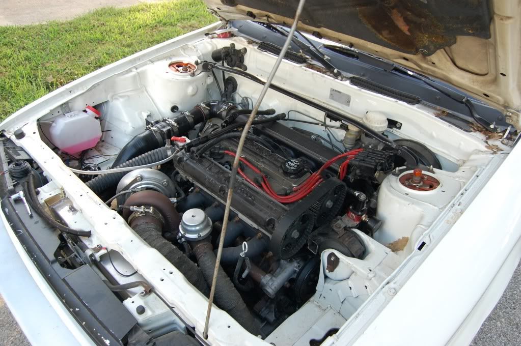

Thanks GW....aside from the apparent exhaust leak and running on 2 cylinders she sounds great. I hope to get the other two cylinders running and possibly fix whatever exhaust leak I have tomorrow morning. I'm awaiting a plug and wires from a member on Link who generously donated it to me so I can fix that issue and wire in the TPS as well so I can give it throttle and drive.

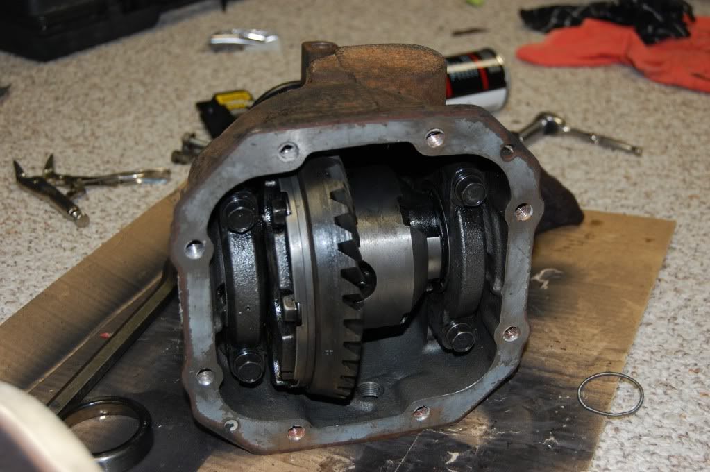

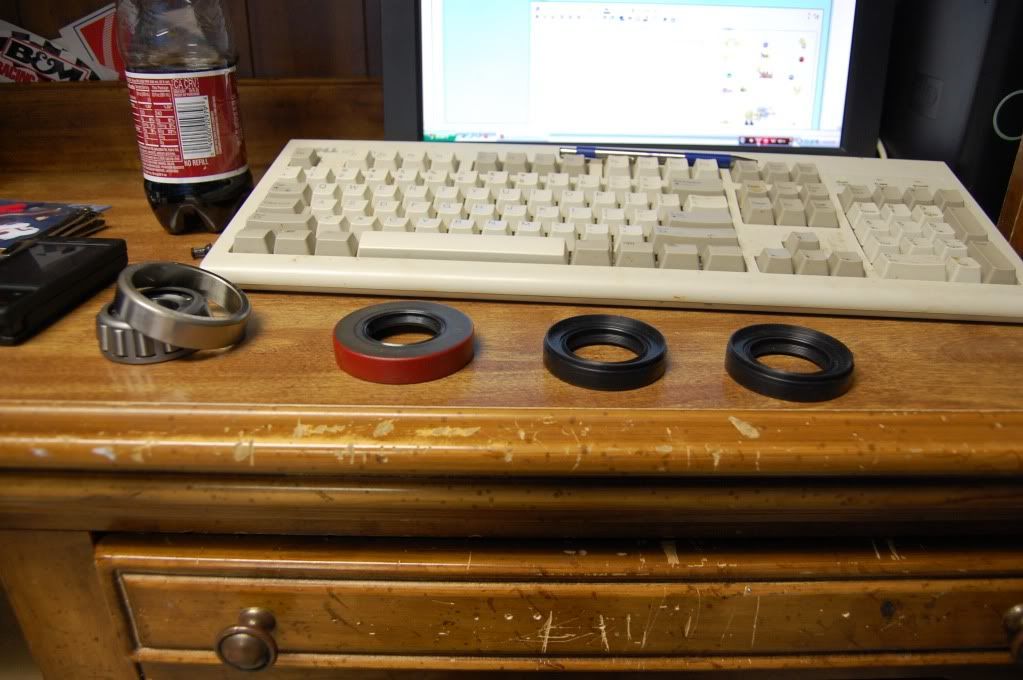

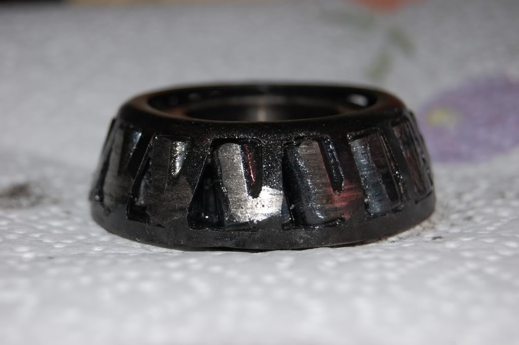

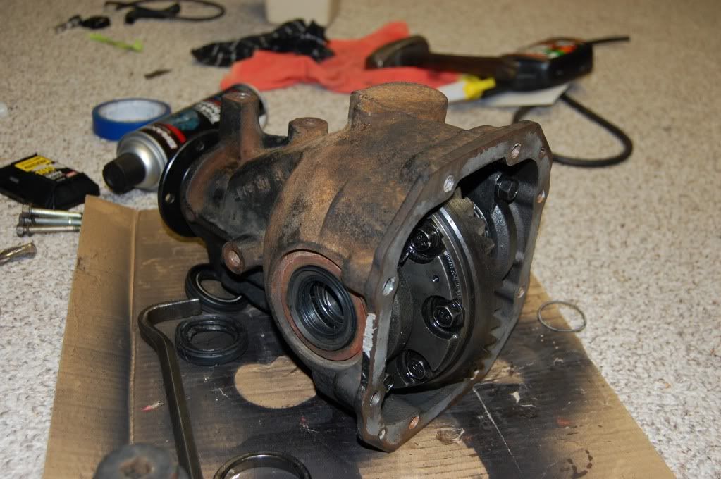

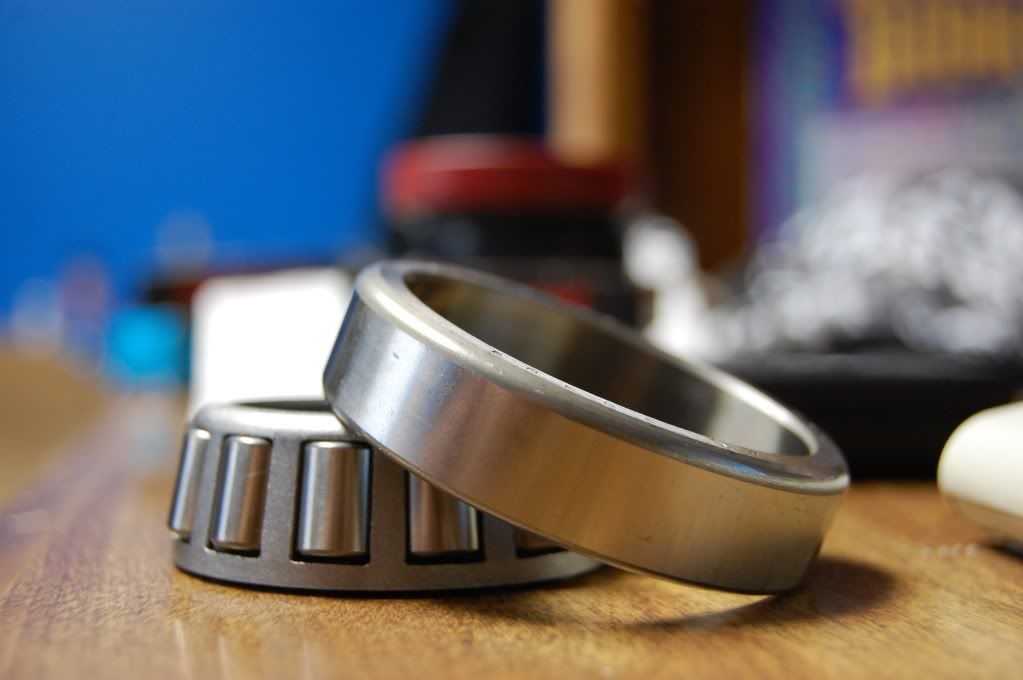

Quick update, rear end was causing some trouble and I expected the worst but ended up finding this bad boy to be the problem -
It's the outer bearing on the pinion shaft, apparently it had some side-side play that it didn't like.
If anyone has a spare mustache brace that I can have I'd greatly appreciate it!

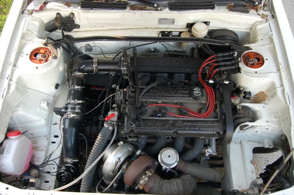

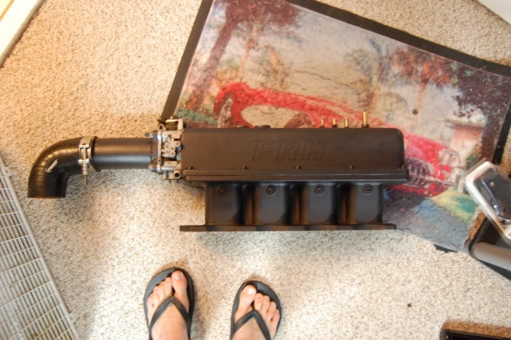

Decided while the rear end was out of commission I'd go ahead and paint/clean up a few things....Intake and intercooler piping are all the same color now, VHT 1500* flat black....looks pretty good personally but I'm biased.
