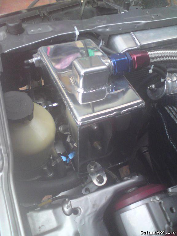

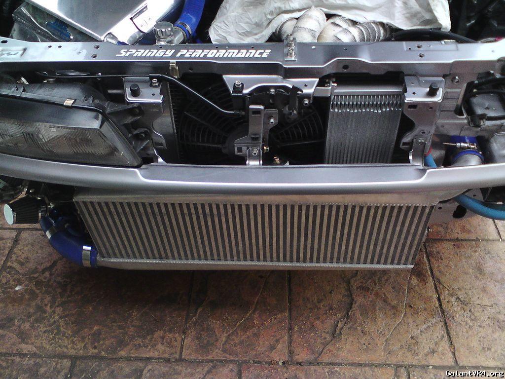

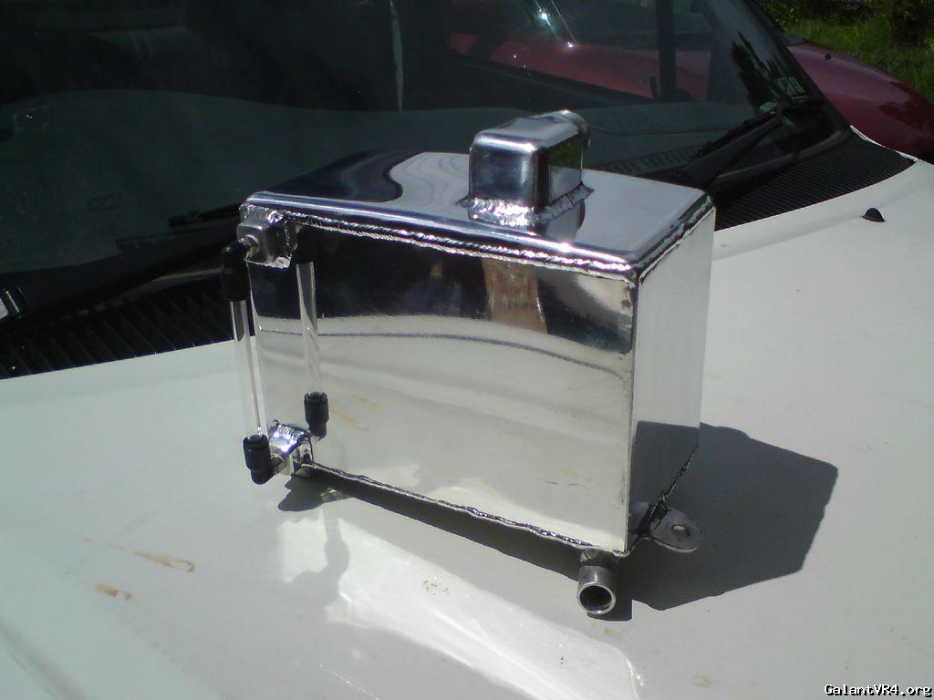

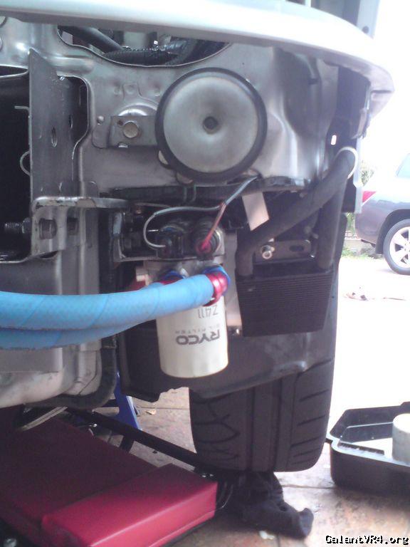

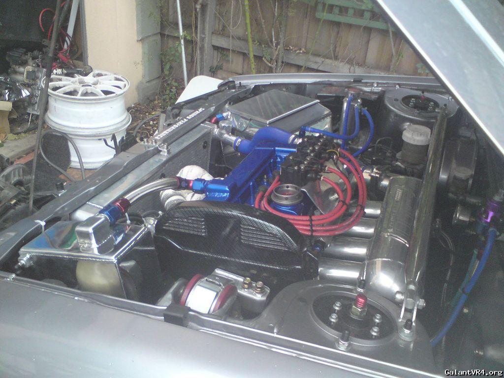

I've installed the ENG OIL cooler (EARLS) with the MOCAL OIL STAT and power steering cooler.
Everything worked out well!

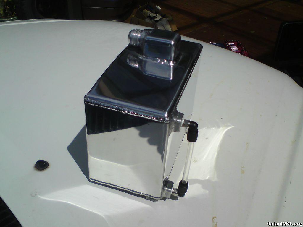

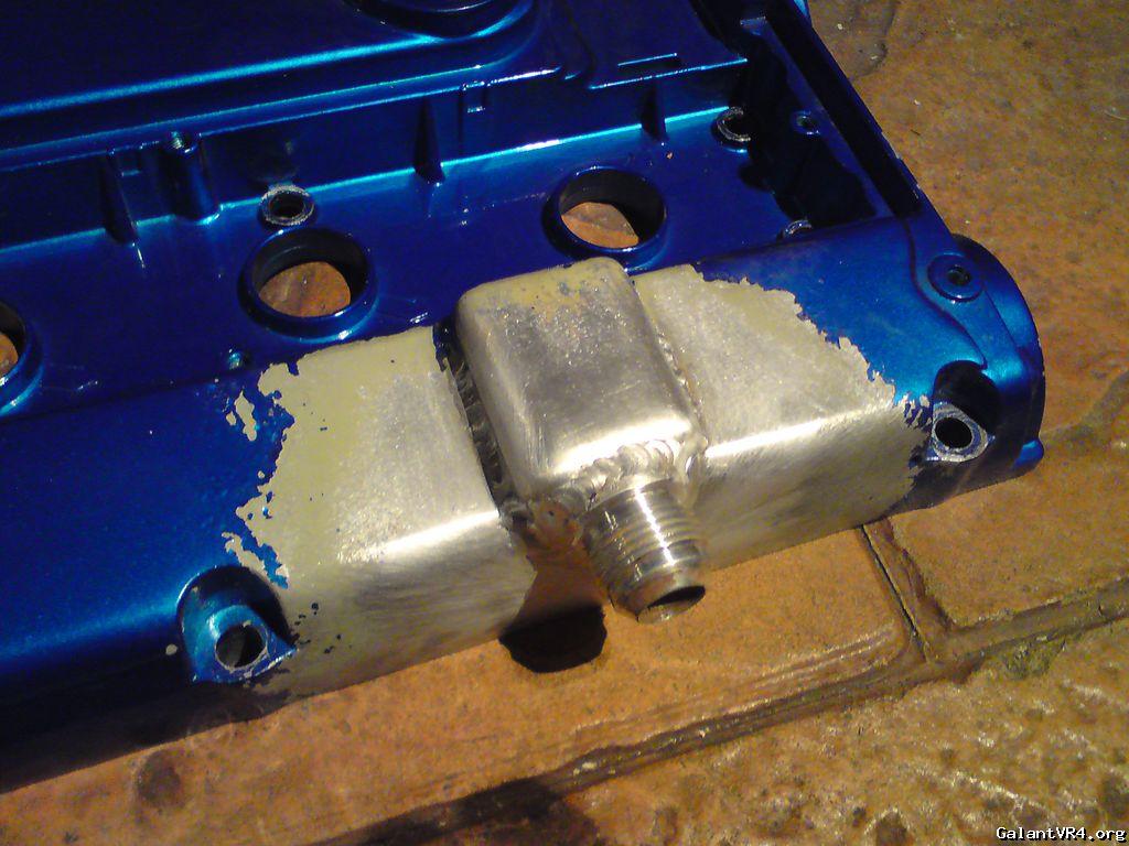

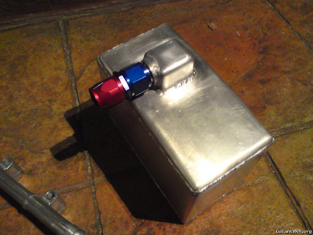

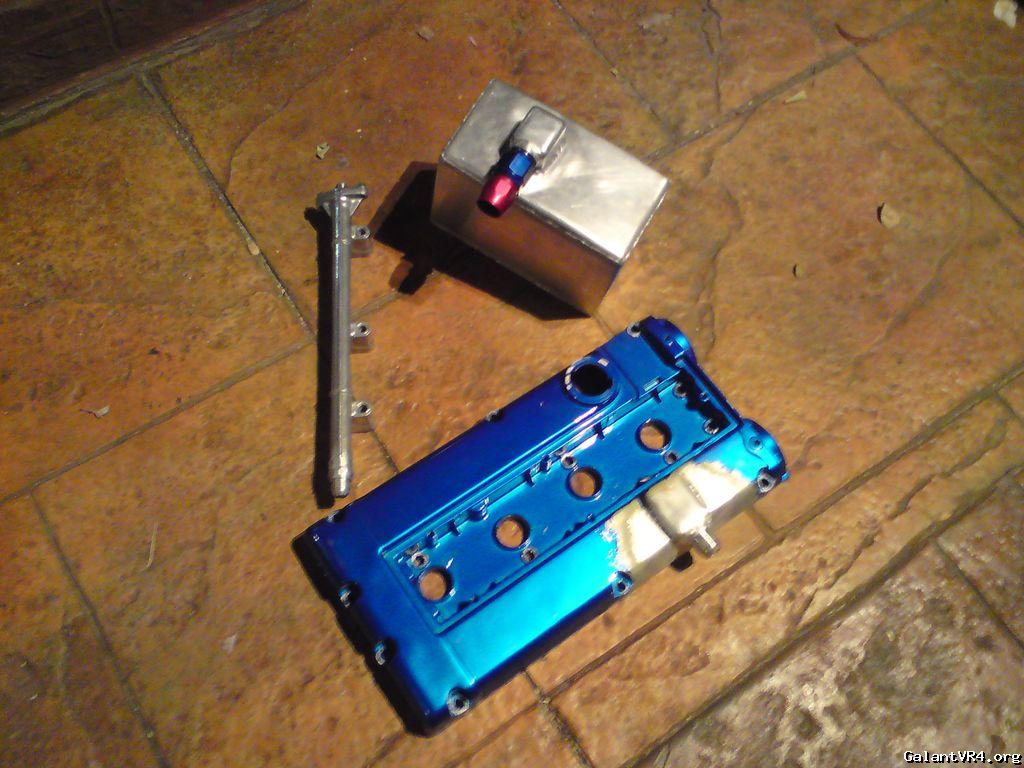

I also installed the new catch can.

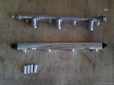

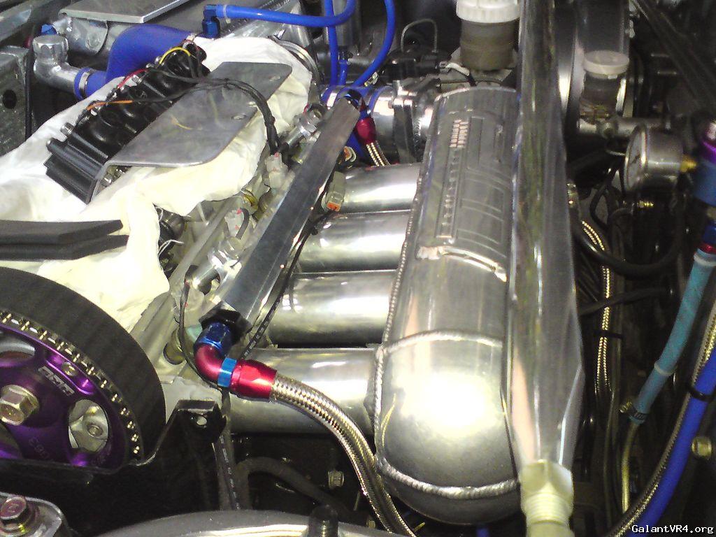

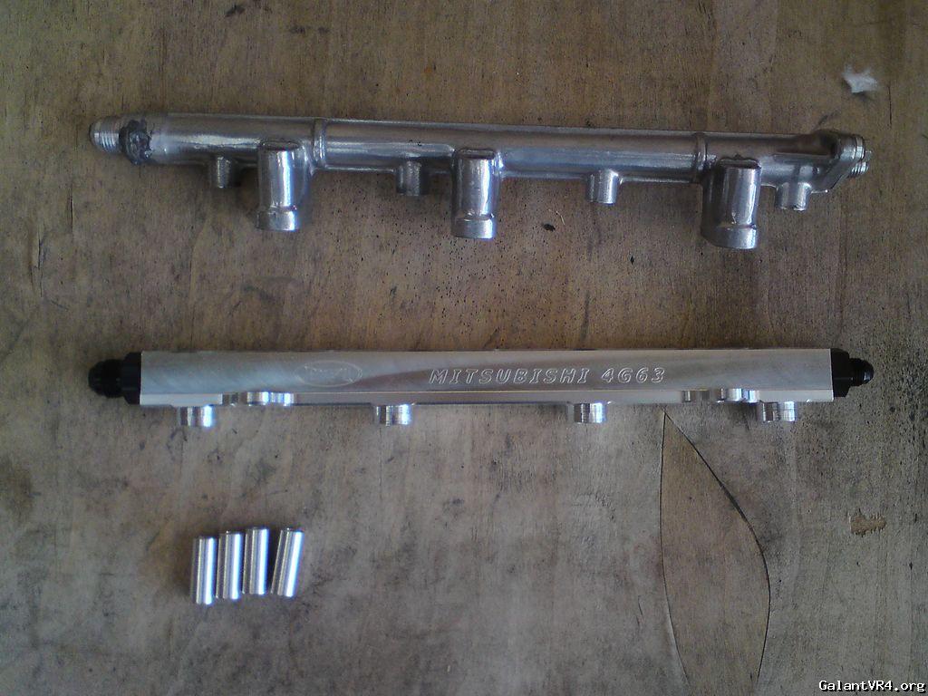

I also decided to swap out the standard modified fuel rail with a billet item simply because of the tiny pin hole fuel leak that i had. Due to the poor casting, welding the fitting was rather difficult (kept blowing due to impurities). Some custom mounts and the rail bolted on without any issues. The rail is from POWERFLOW injection Australia. I wanted the AEM one but I couldn't be bothered waiting for it.

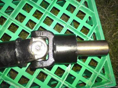

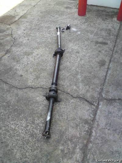

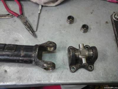

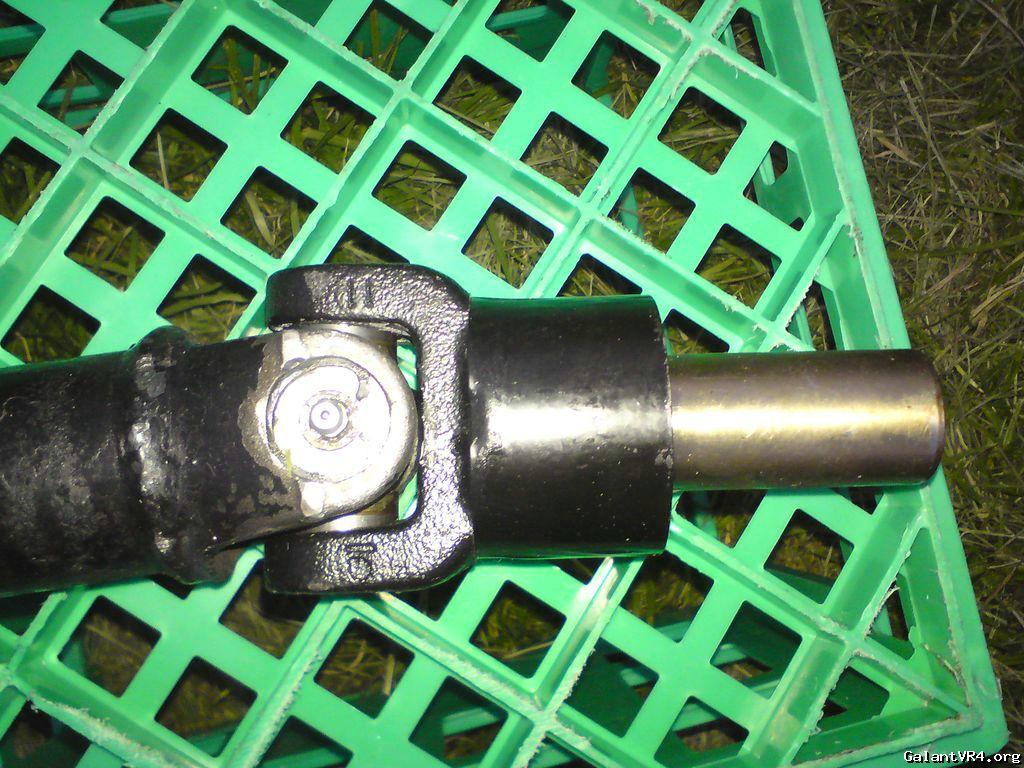

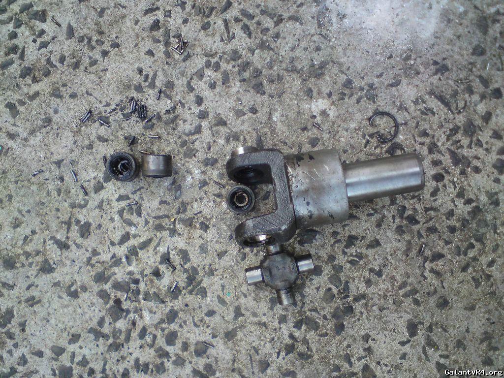

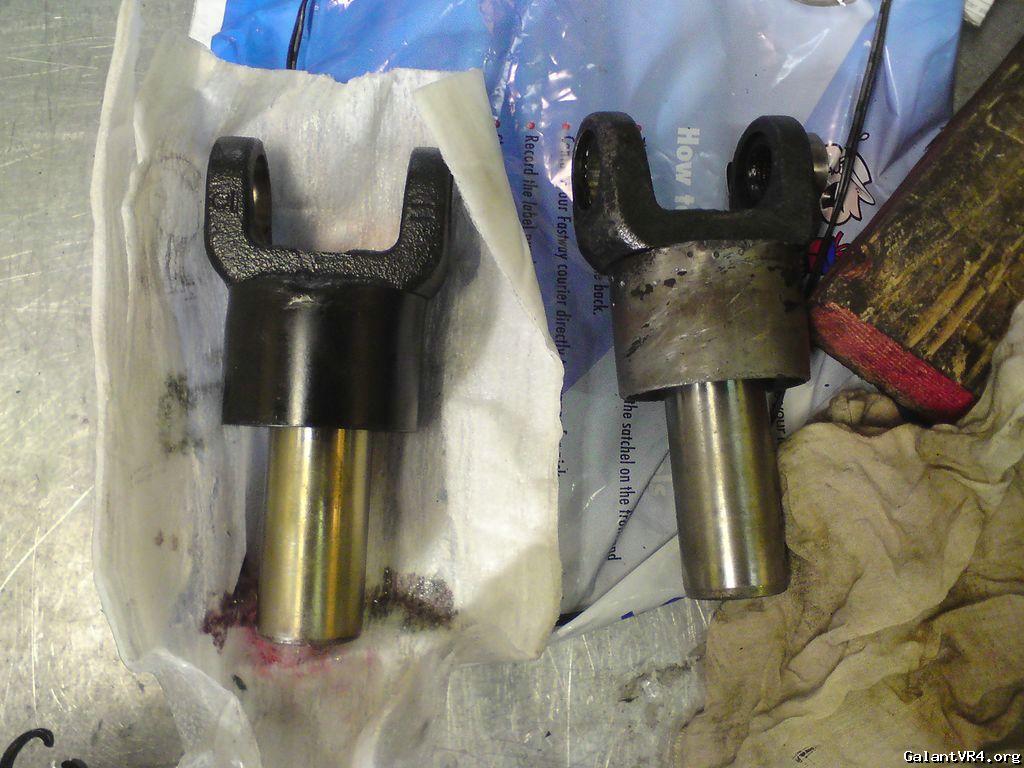

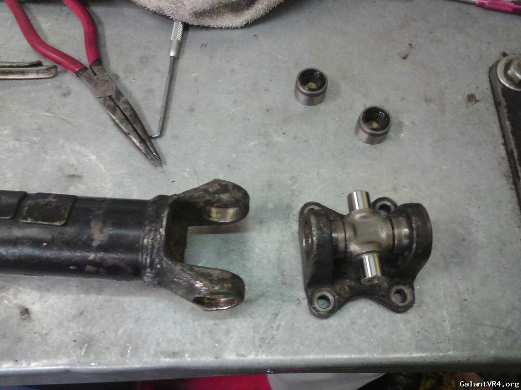

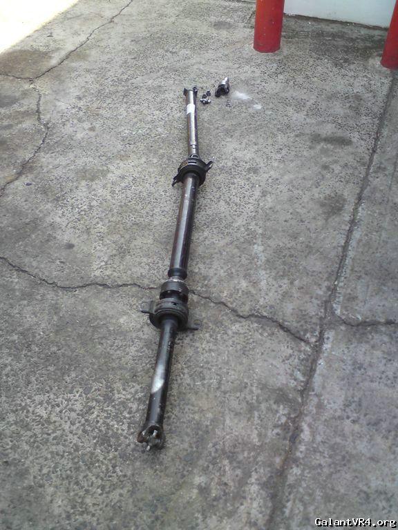

But wait theres MORE!!.... I changed the uni's on the tail shaft (you guys call them drive shaft) and also changed over to the revised yoke. I was sick of the leaky xfer case leak even after the VFAQ seal trick. Hopefully this fixes it!!
Plus the dust seal on the yoke was loose and was making an awful rattle on decel. This will get rid of most of the decel noise... hopefully!

Beautiful work! With that front lip that will complete the look. Love that IC core and all the thought that went into everything.
