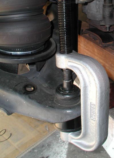

Stupid question... trying to remove all my ball joints for replacement, so I bought
. Can't figure out the proper way to put it all together to pop them out. The instructions might as well be in Chinese. Any advice?

Big spacer on the bottom, small spacer on the top, and push the ball joint out the bottom.
You did remove the c-clip from the ball joint base, right? /ubbthreads/images/graemlins/wink.gif

When I did this, I had a hard time getting the arm up high enough to use that tool when the long threaded part was on the bottom (removal stage). Worked great for re-installation though.

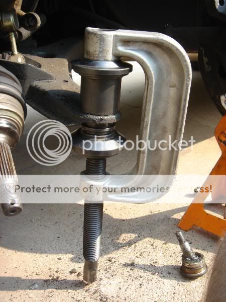

Quoting Romanova:
So S_Firestone sold you his press? Maybe you should ask him. /ubbthreads/images/graemlins/smile.gif
If you scroll up, does that picture help ("Press Assembled")?

The clip is removed (huge pain in the ass by itself). I douched the hell out of it with PB plaster. Just having a hell of a time lining up this press to get the damn ball joint out. It's a rear arm and I have it C-clamped to the table... just trying to get the right combination of parts... ugh.
Tried beating it out with a hammer... that got me no where.
