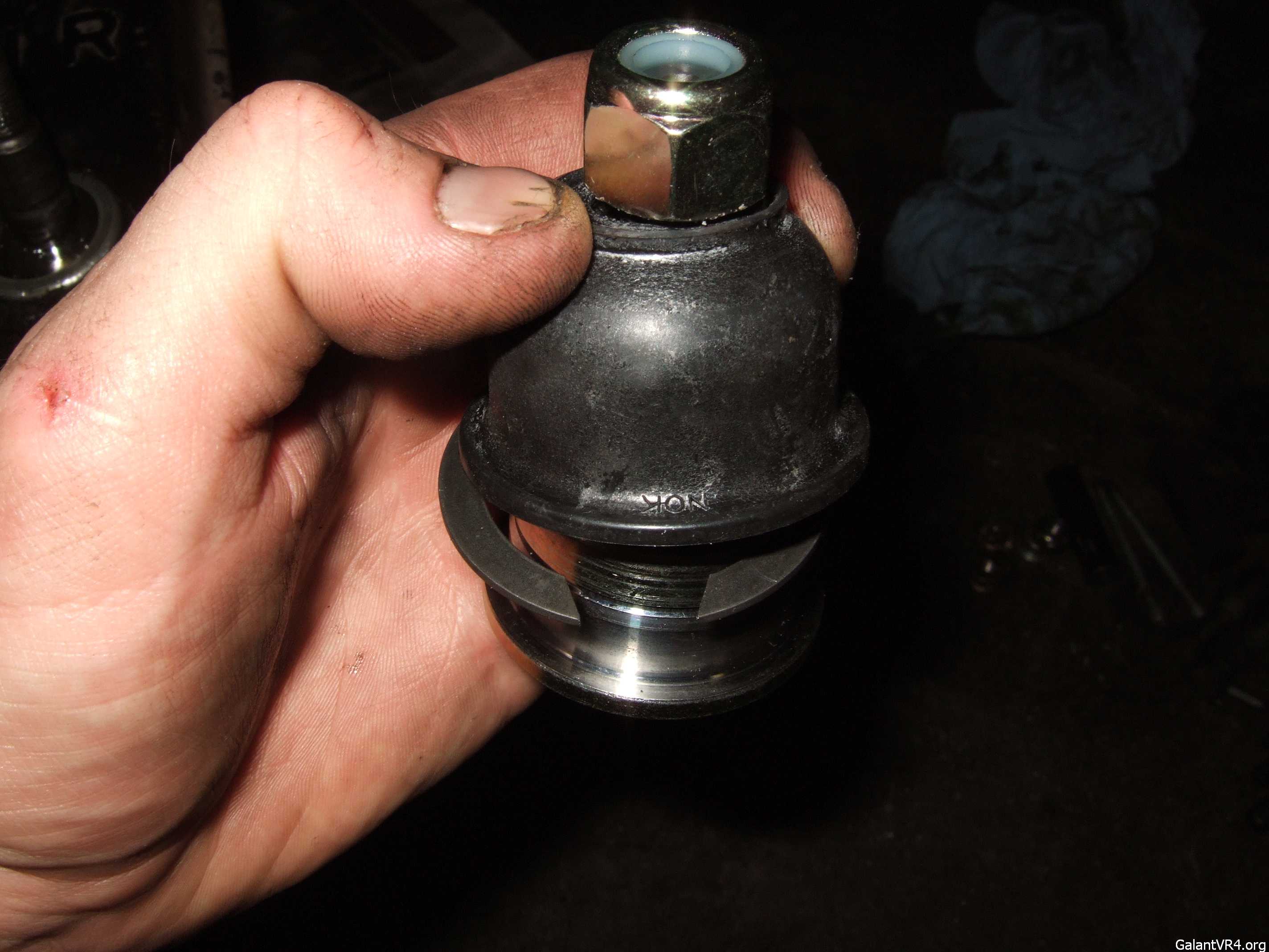

The circlip doesn't have any holes in it to stick a tool into, so I assume I should just pry it open to slip over the ball joint once it's installed in the control arm?

The circlip is a one use item, they make a pair of pliers specifically for them but you can use whatever works. You should be able to accomplish everything with the press kit(you may not even need the fork). As with all high torque screw based presses, clamps, pullers, etc I recommend greasing the screw with axle grease(especially if you ever use an impact wrench or hammer).

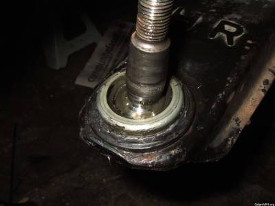

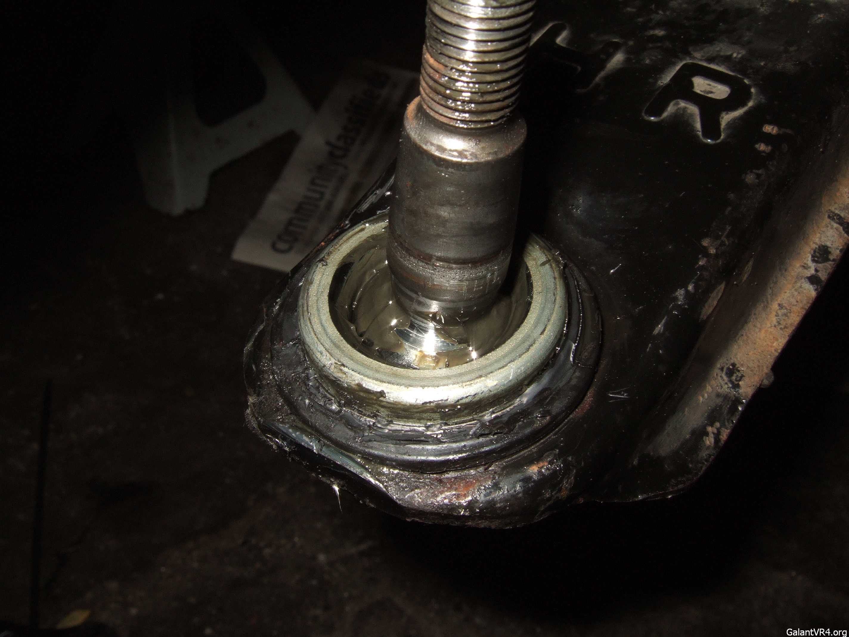

How do I access the circlip on top of the ball joint so that I can take it off? The bottom of the boot (which I have cut off) seems to have a metal base to it.
Here's the OEM replacement. I'm having doubts about getting the thing pressed in and then the snapring placed around it. I've got both the Harbor Freight ball joint press kit and pickle forks, but have never done this before.

you need to clean all the crap out from around the circlip. snap ring pliers are the best way to get at it, but if it's seized, you can get the edge up with something flat(medium screwdriver) and pry it up enough to get a grip on it. once you get that out of the way, press it out, and press the new one in, the new clip will be much easier to install than the old one was to get out.

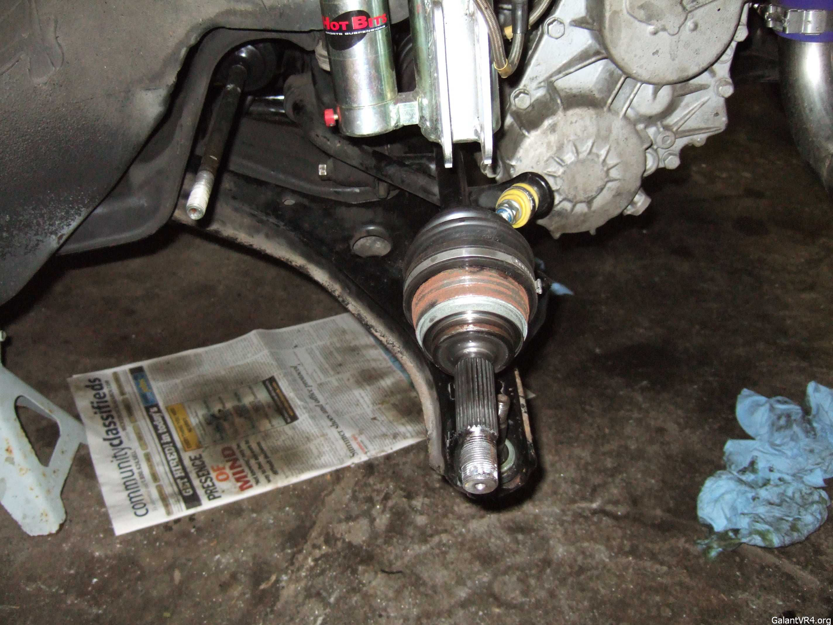

I'm in the middle of doing a ball joint too. I had to quit for the day because I lost sunlight but I wrestled with it for a few hours. How do you get the damn ball joint bolt out of the hub. I was able to get the 19mm nut off the ball joint but I can't seem to get the ball joint end of the arm to drop to save my life. I am using a harbor freight pickle fork and I am torquing on that bitch until the steel handle starts to bend. I've pounded on the side of the arm near the ball joint with a hammer and I still can't get the effer loose. I don't have a socket to pull the axle so I can pound downward on it. Maybe I'll have to go get one tomorrow if no one else has any ideas. Does anyone know what size the axle nut is? Looks like a 31 or 32mm.
The rest of the arm came off the car relatively easily. Oh, and the boot on the old ball joint is now really messed up (most of it gone). I have new bushings and a new ball joint and I'm stuck.

it's a 32mm for the axle nut. are you trying to get the hub seperated from the ball joint? hose it down with some PB blaster, and let it sit. it's probably seized up. just remember to get the circlip out before trying to get teh ball joint out of the arm. /ubbthreads/images//graemlins/wink.gif
if the arm is still connected, you can use a jack on the hub and raise it up a bunch, slide the fork in there, and pound down on the fork, as close to the joint as possible.
Thanks for the size info. I did hose it with PB blaster before I stopped for the day. I think I'm gonna go get a 32mm suck-it tomorrow and pull the hub off the axle. I was trying to avoid doing that but I don't think I have a choice.
Yeah, every time I've done it I've ruined the boot as well. Turns out all this time I was trying to use the pickle fork as a pry bar. A friend of mine is a mechanic and he informs me the correct way is to hammer the pickle fork in around the ball joint (not too hard) and then while applying tension to the fork wail away on the hub or arm with the hammer. The impact should break it loose enough that the tension supplied by the fork will pop it out. I seem to think he said to use a normal hammer, not a dead blow. An air hammer would also work, but don't use to small of a tip or you'll ruin the thing you're trying to get the balljoint out of.

You did remove the swaybar endlink right? /ubbthreads/images//graemlins/uhh.gif
Yes. I finally got it out yesterday, I will post a pic or two of what it took tomorrow.
