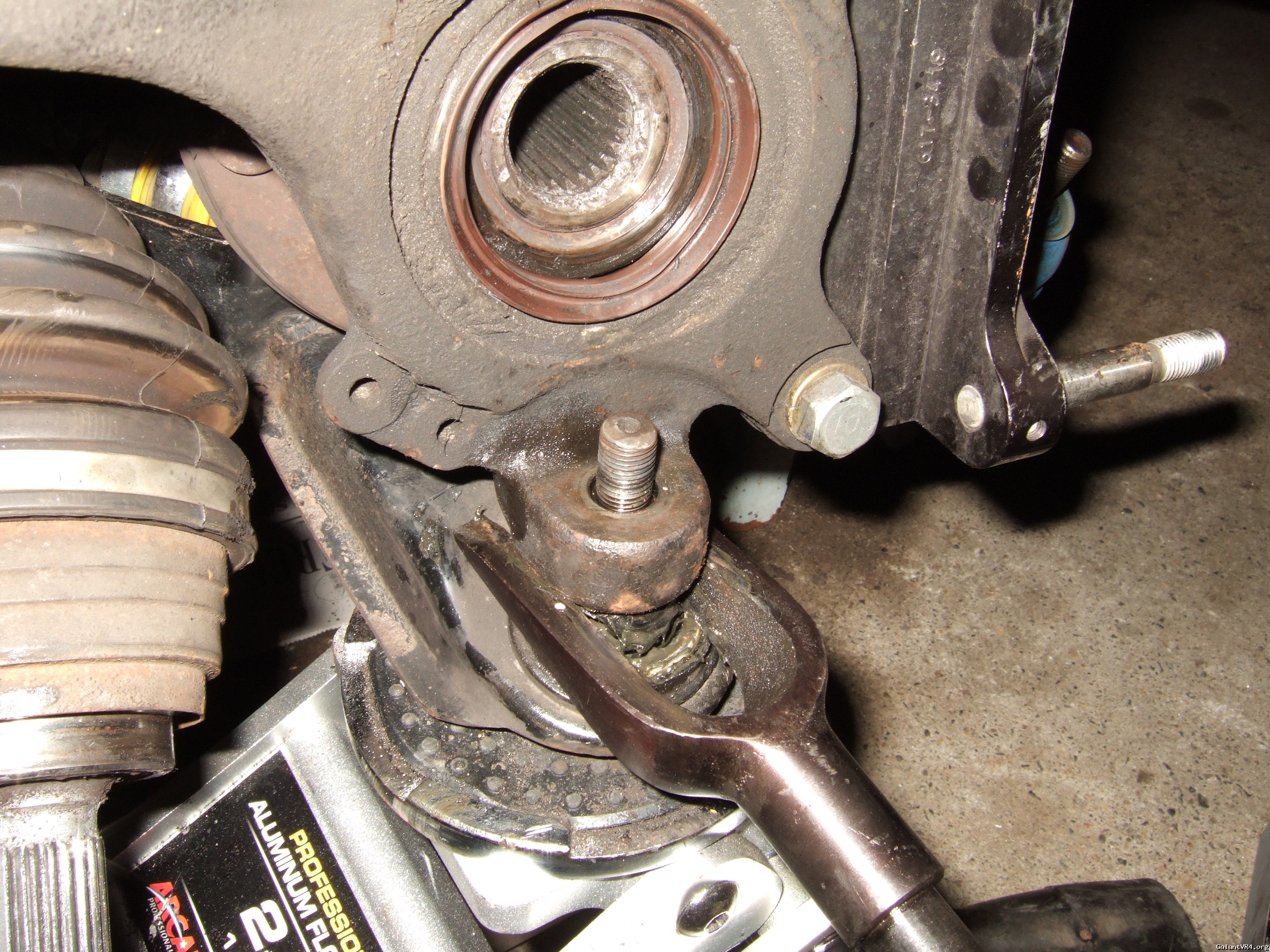

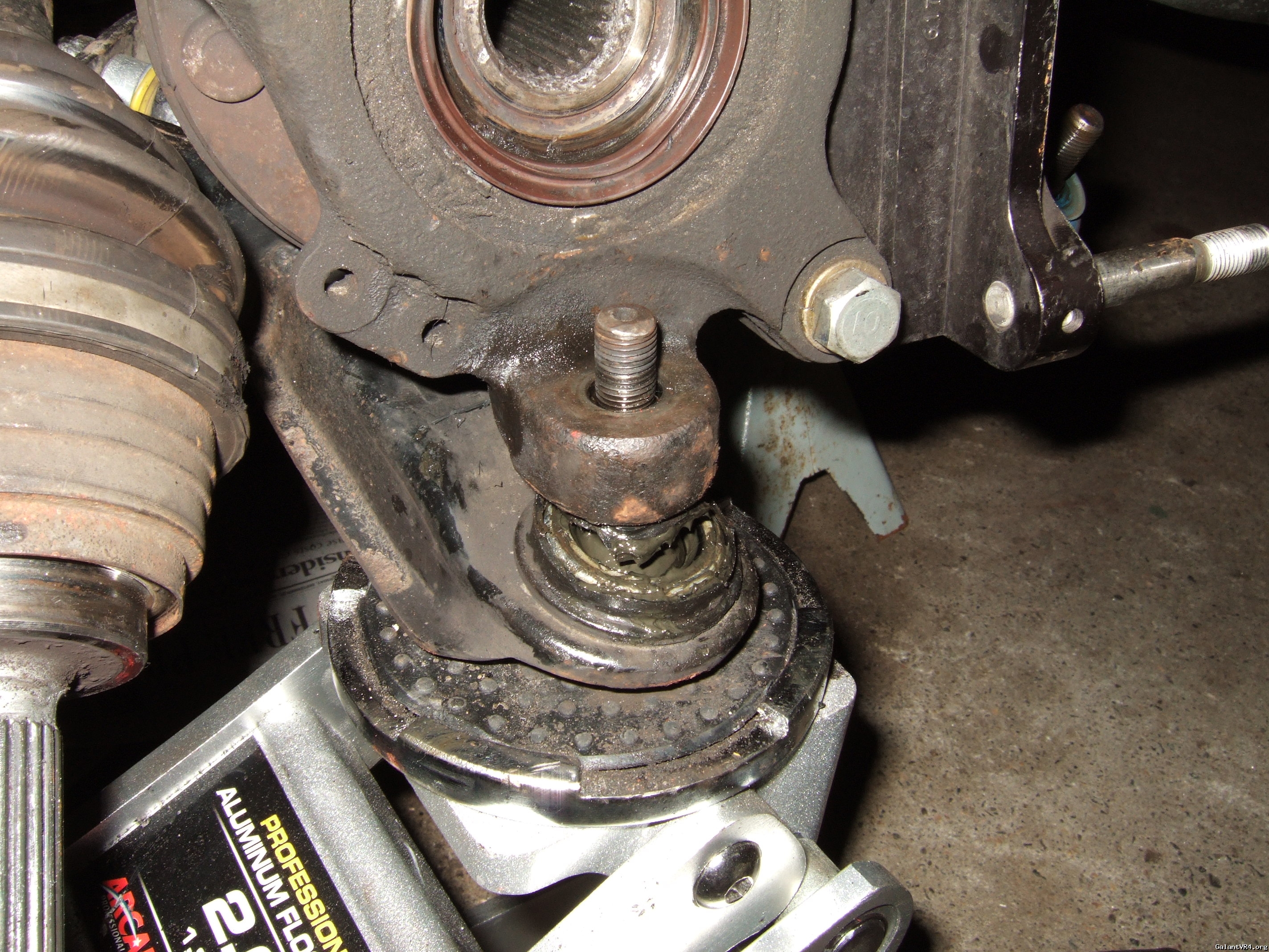

Hammer did not work. I had to use my Harbor Freight ball joint press. The "ball" part of the joint was cut off with a grindwheel. Then, I cut a piece of steel tube just big enough to fit what was left of the bottom have of the bolt. I then used a steel plate on either end to cover the holes on the tool. The ball joint press was held in place by a vice while I used a breaker bar to really wrench down on that sucker. One of the steel plates has a significant dent from the bolt!!! It didn't pop out under all that pressure so I took a hammer and tapped the knuckle a little and it popped loose. I can't believe it took so much monkey business to get that thing off of there. I've never had this much trouble doing a ball joint.

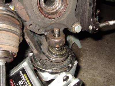

Trying to do the other side right now and I can't get the hub off the balljoint...

Get the jack under the hub, and off the control arm, jack it up enough that it pulls the control arm up a bit, put the castle nut back on the ball joint so it's almost flush, and whack that thing with a BFH.

I beat the hub for a few minutes with a 3# sledge all around where the shaft of the ball joint goes through it. No go. It's soaking in PB right now.

Remove the jack, screw a nut down flush with surface of the ball joint stud and wack the heck out of it with a sledge.
Or use your pickle fork (if the fork is deep enough) and go all Thor on the end.
With ball joints, brute force wins the day.

Whacked the sh*t out of the hub while applying pressure to the pickle sniffer. That got the hub off the control arm. Then I used my Harbor Freight ball joint kit thingy to get the ball joint out, and the new one in. That corner should be back together tonight, and then I'll start on the rears.

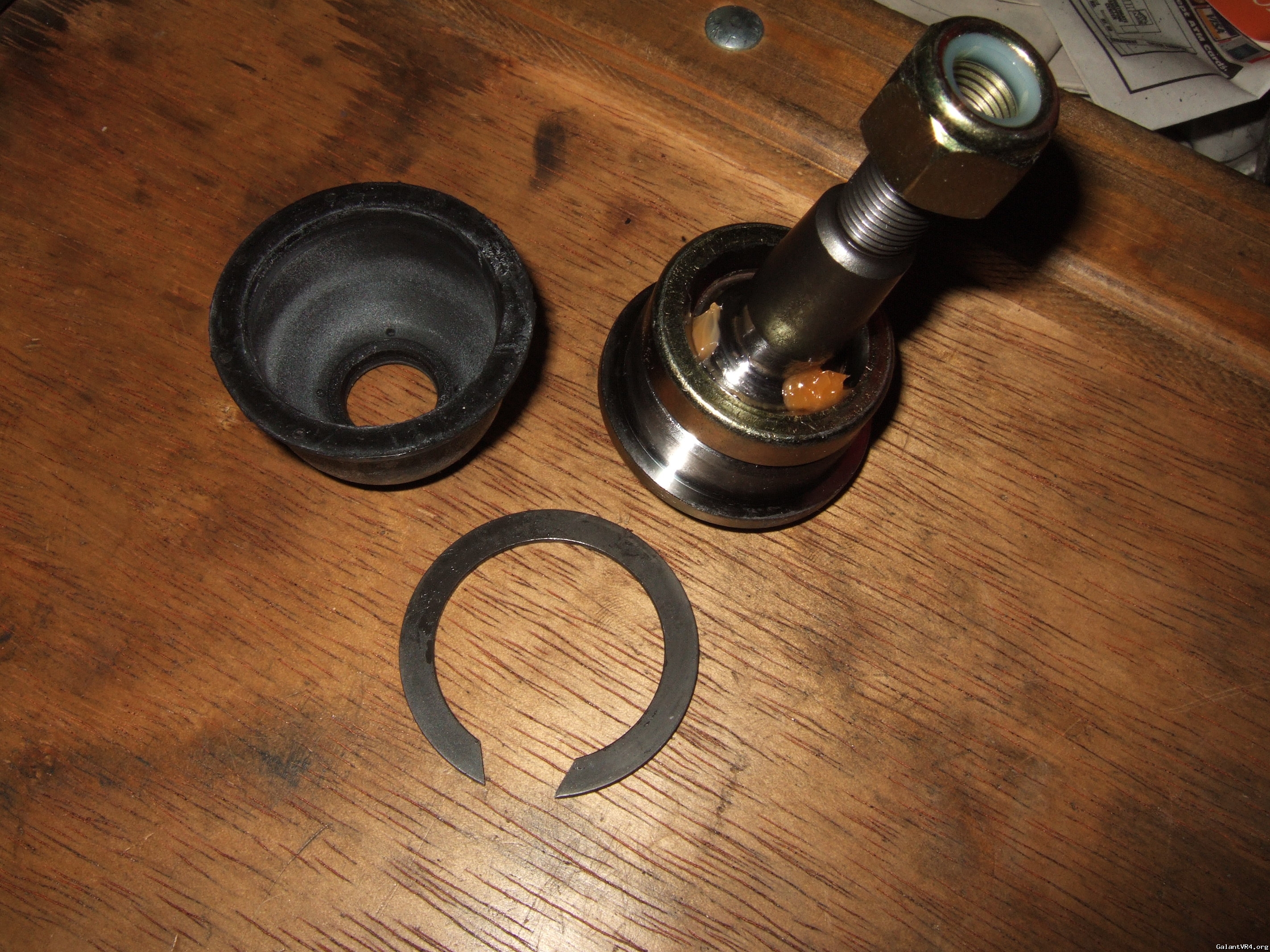

Resurrection: Seems like a good thread on ball joints in general, so I'll just add a question to it.
I'm replacing the ball joint boots while doing the front right half-shaft. I ordered the ball joint boot from jnz (part no: MB176047), and I'm wondering if I can lube the joint with standard blue multi-purpose grease, or if I should buy something else. /ubbthreads/images/graemlins/dunno.gif
