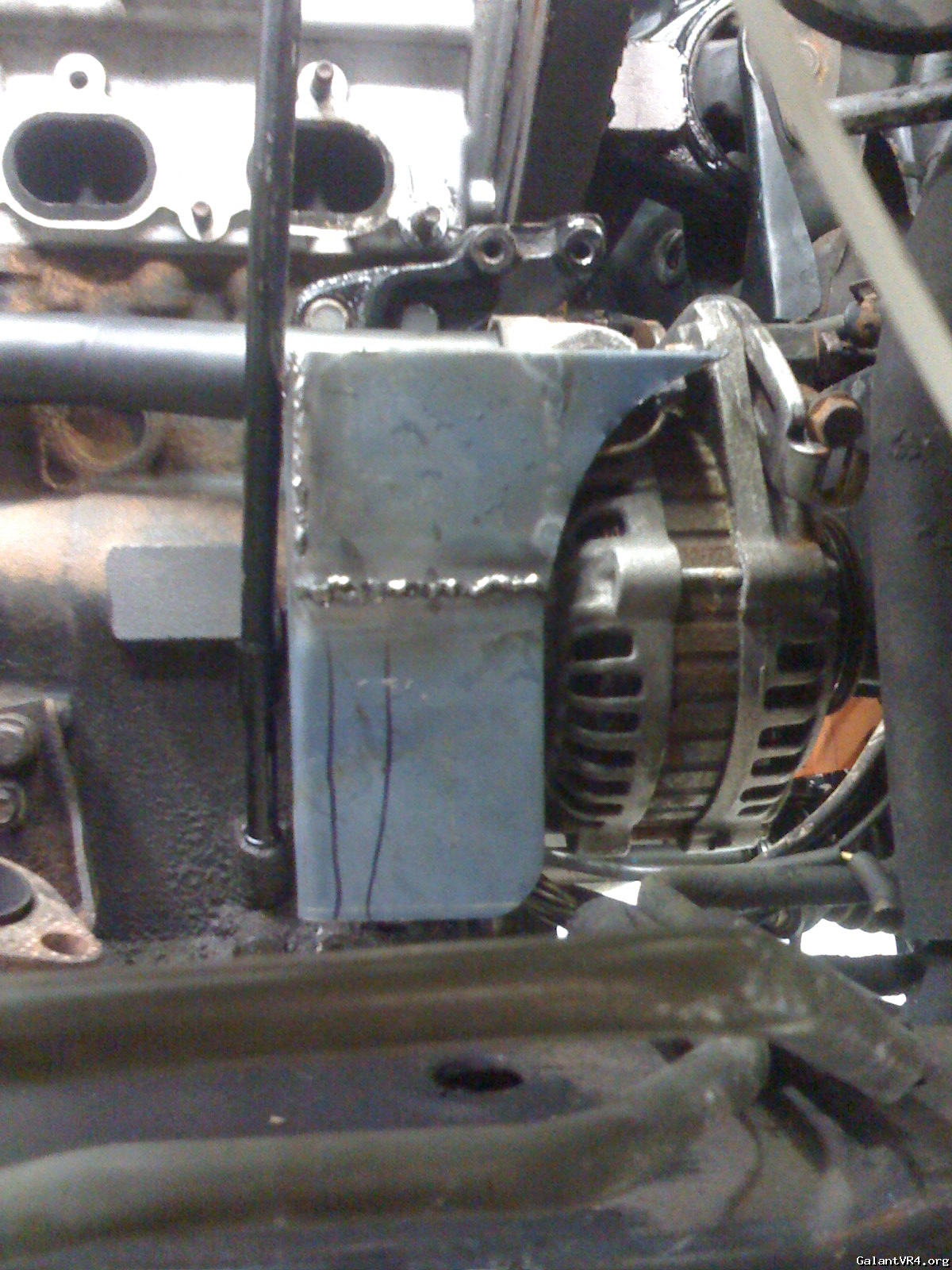

I made a heat shield for the alternator today. One caveat on anyone who wants to copy it, the belt wasn't mounted. Future trimming may be needed.
I'll post pics when I get home.

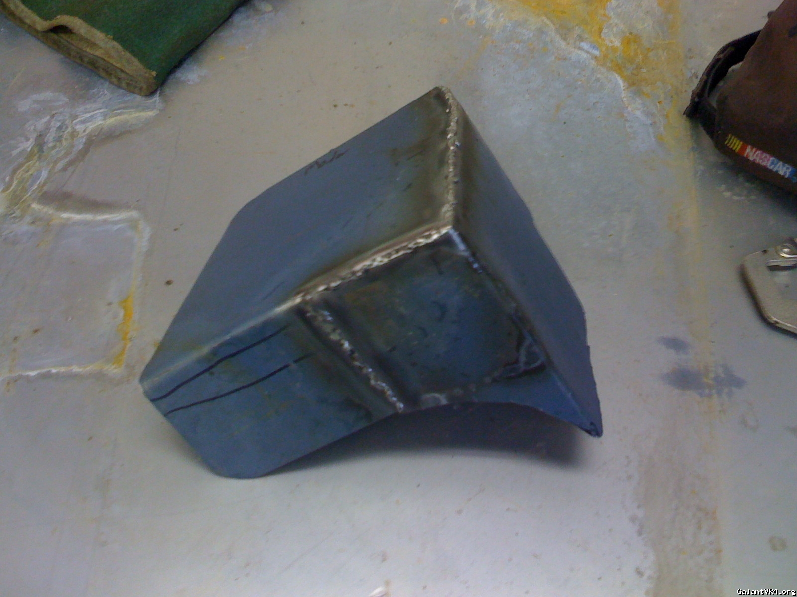

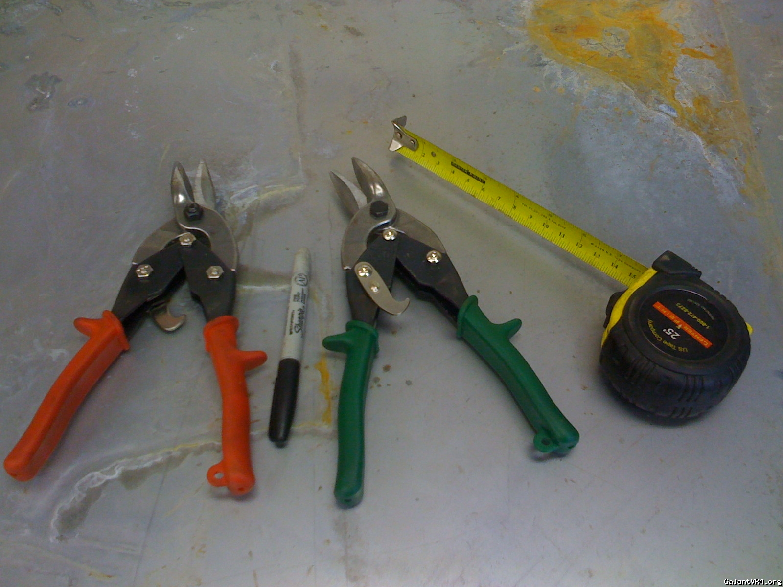

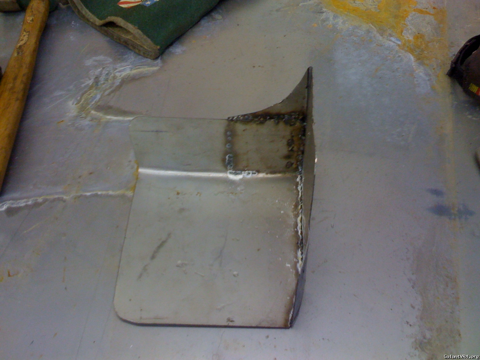

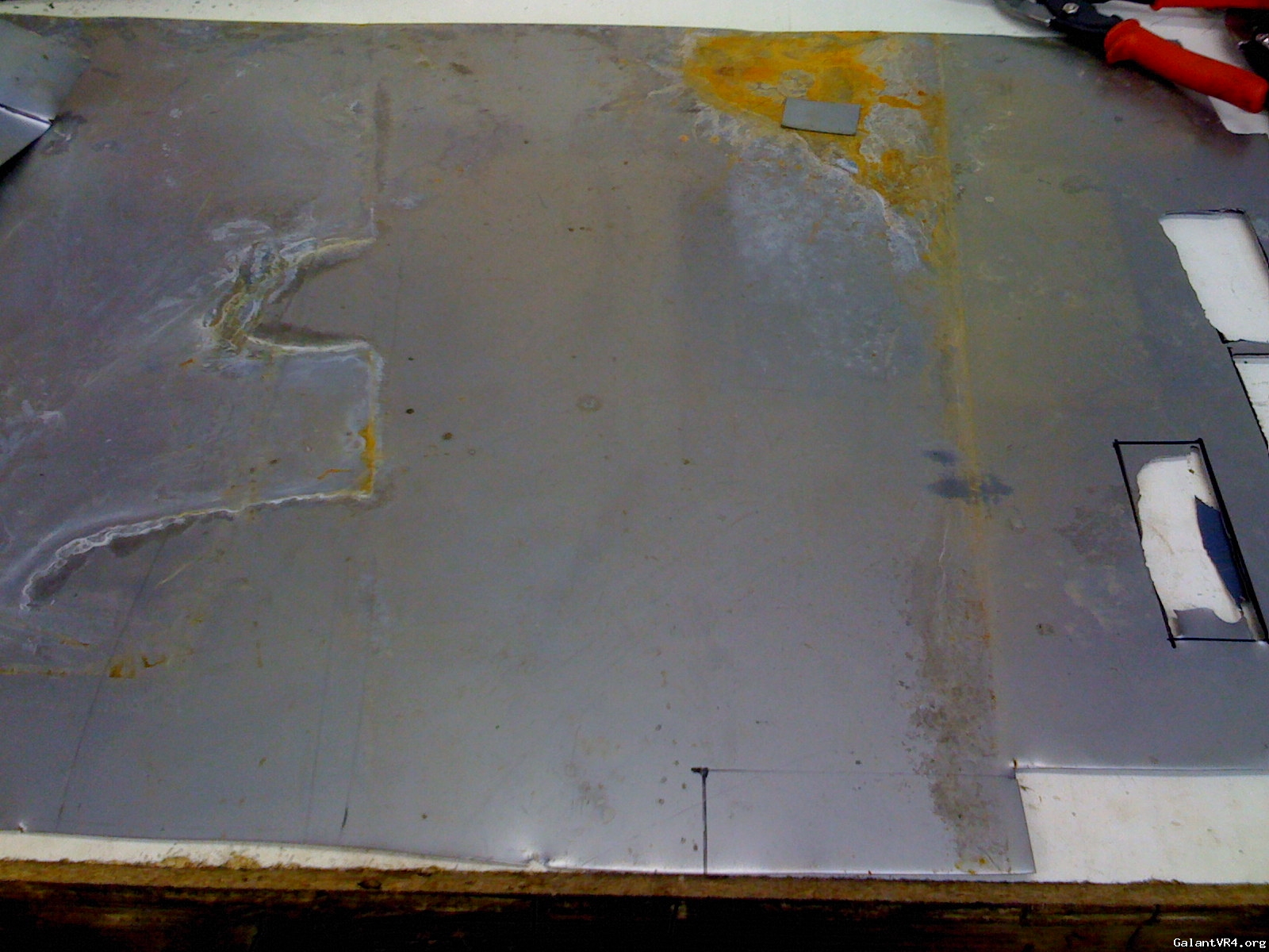

The tools I used were pretty simple, left and right tinsnips, sharpie, hammer, tape measure, and a welder.

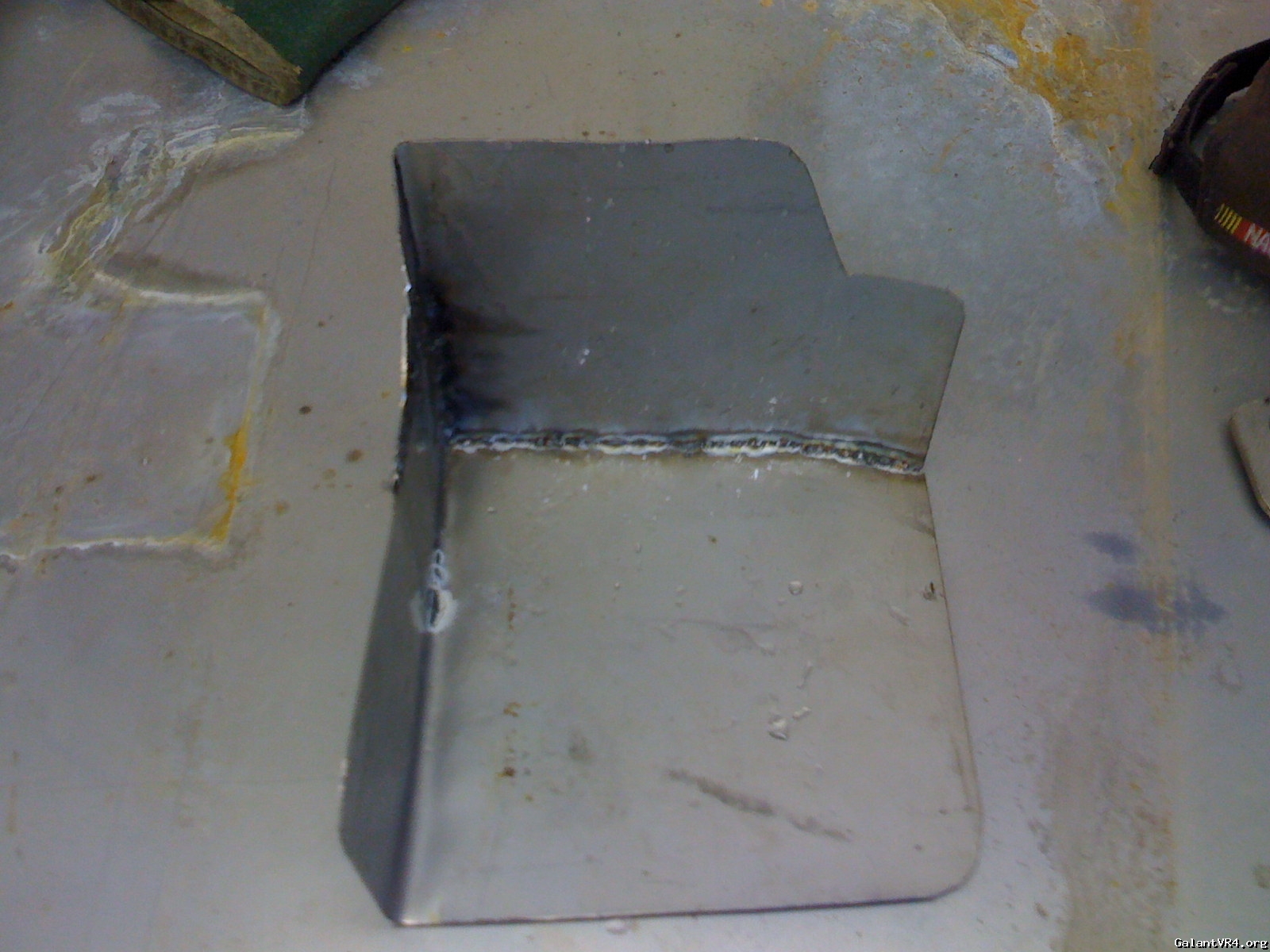

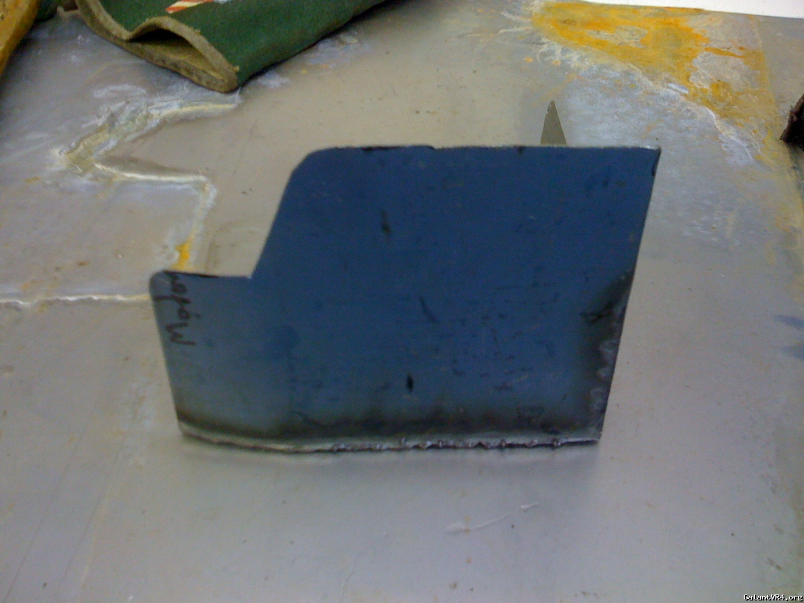

Here's the shield. I made it out of flat stock steel. I think the stamping was .020. It reasonable thick and resists flexing.

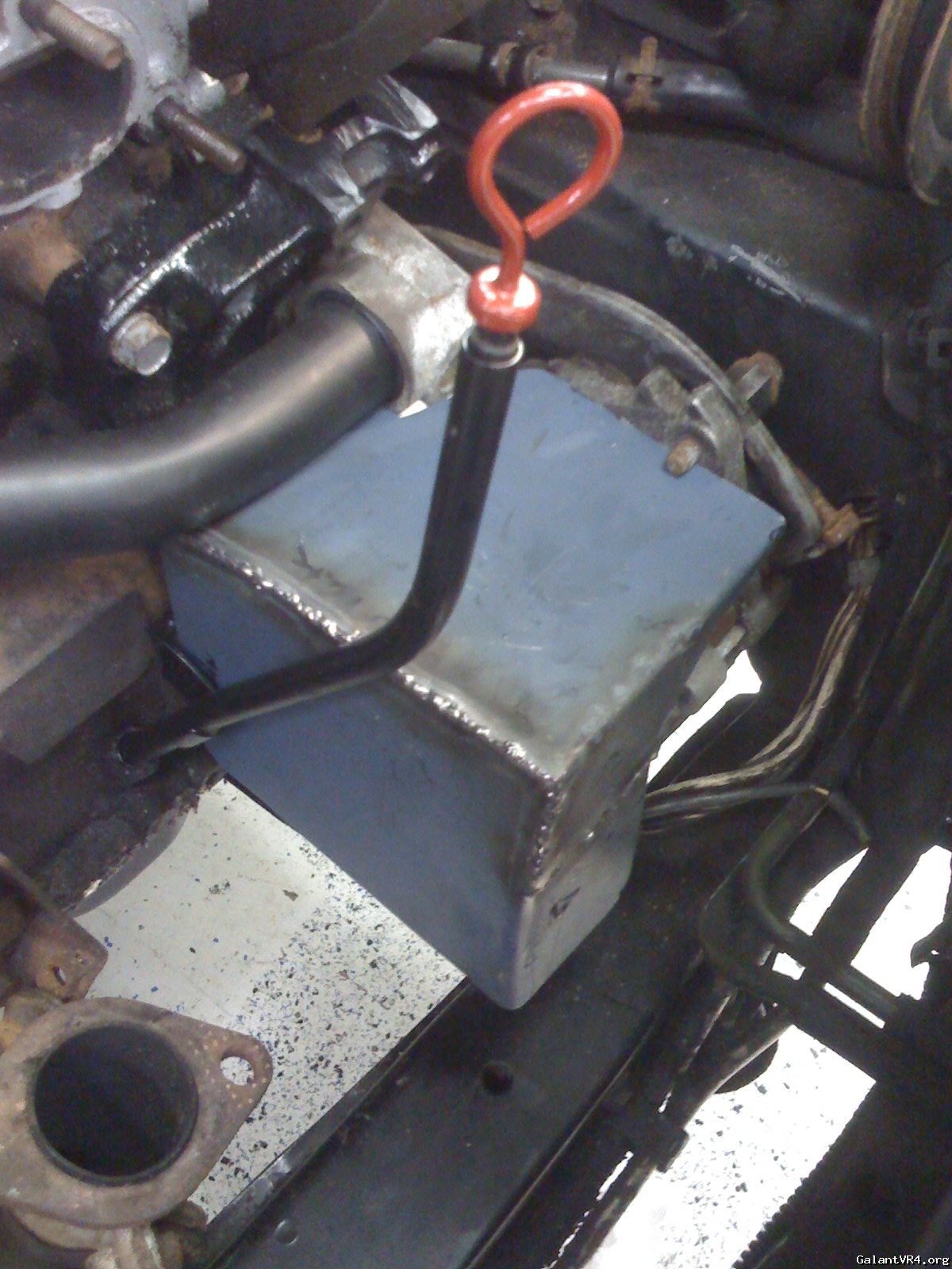

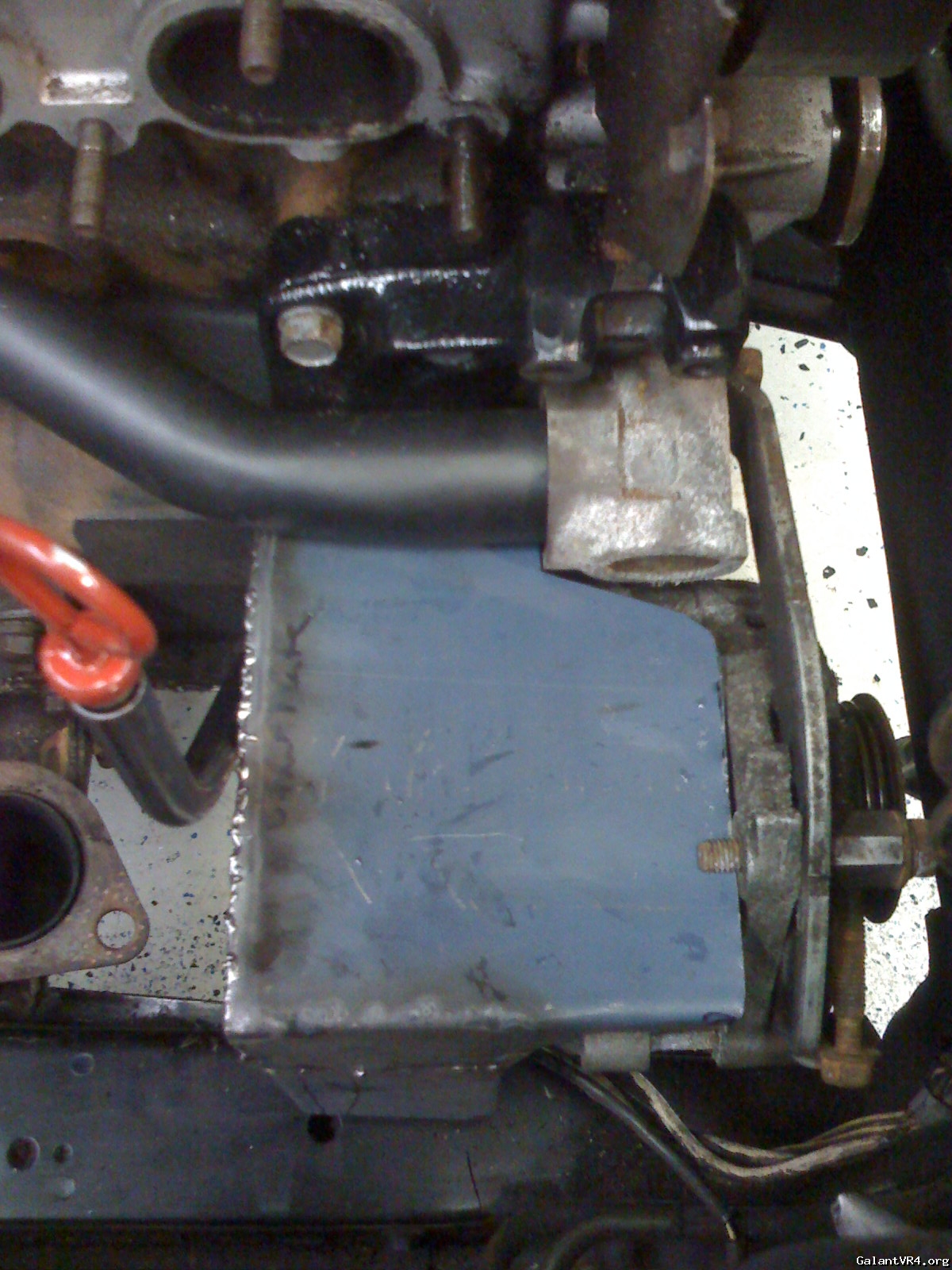

I'm going to bolt it or pop rivet it to the dip stick mounting tab. I don't think that will hold it without letting it rattle around. I'm going to wait to find another mounting point until the belt is mounted and the alternator is in position.

Yeah, I only had time to mock it up before bible study tonight. I'm going to spray it with semi gloss black engine paint.

Mike R.
Keep in mind that the alternator needs air moving across it to cool as well. I'm wondering if blockage in the front/top will actually be worse for the alt...
Good point about cooling but..
Having dissasembled several alternators, I really doubt it would cause a problem the way he has it setup.
Yeah, just a thought. I do know that a lot of German alternators have cooling inlets with ducting routed to the front of the car, so...
CarRacer
Jun 28, 2007
4,372
Shakopee, MN
Yeah, I figured blocking the exhaust heat was the greater of 2 evils.
There's also an airgap between the shield and alternator. So I don't believe it will block off the air completely.
I'll definetly take more constructive critiscm though. Thanks Jeff.
That's a thought. You might consider knocking some holes in the panel that faces toward the front of the car. That keeps the "L" shape intact for rigidity while the large panel between the alt and the exhaust will do most of the heat shielding.
