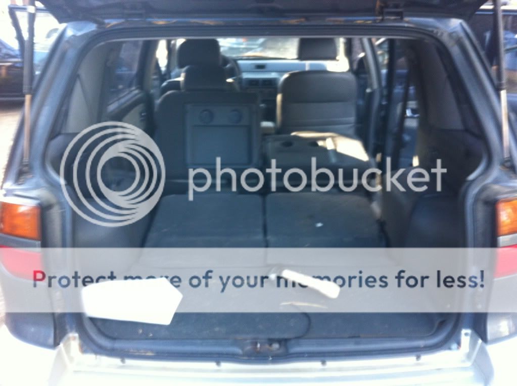

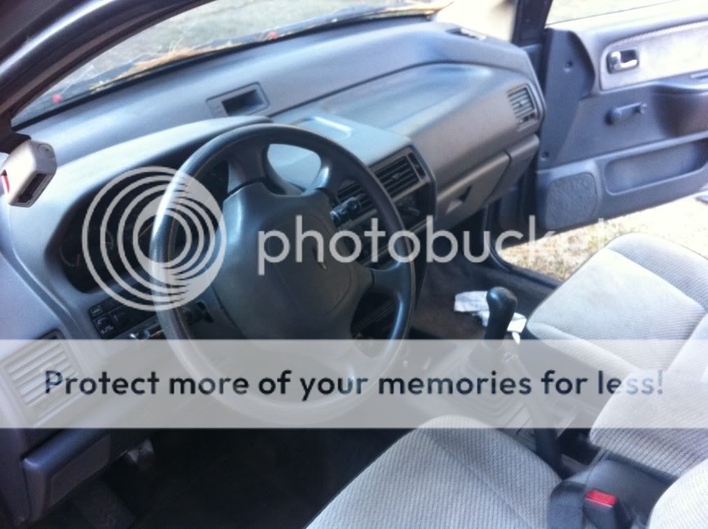

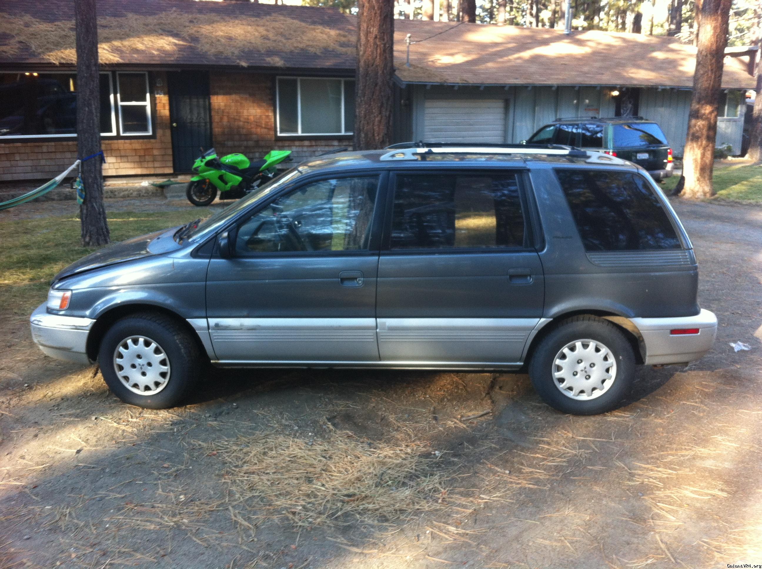

gvr4 picture uploading was lagging hard, here she is, 92 expo sp, awd manual, she is a basic model with really no options, has no abs,no sunroof,no power windows. im gonna keep the ac hopefully but well see once i get into wires.

It looks like it's in great shape and mine's twin! Great candidate for a swap!
