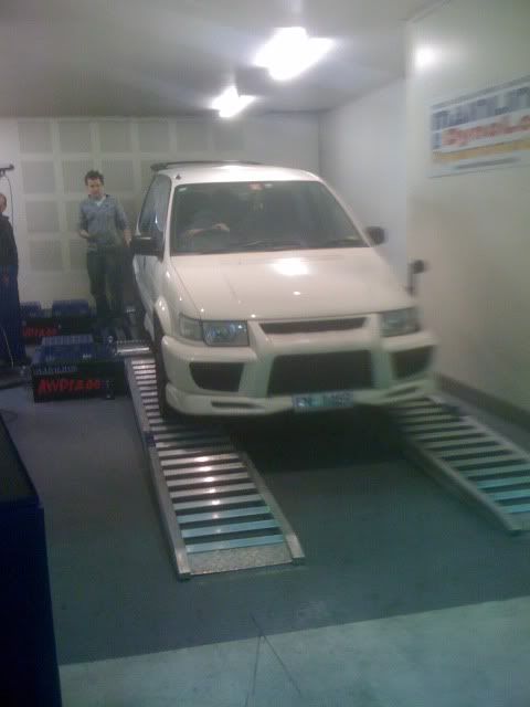

You mean to tell me, you wouldn't want this front end?
To go along with hood?
/ubbthreads/images/graemlins/smile.gif
fuel
Feb 23, 2009
2,167
Toronto, ON, Canada
that's the '96-97 RVR Hyper Sports Gear which has a factory FMIC (evo1-3 size) and the obvious front bumper difference. They don't have the hood with the scoop like the '93-96 Super Sports Gear which has the top mounted intercooler. The Hyper Sports Gear also has the larger side skirts and rear wing, while the Super Sports Gear resembles the standard Sports Gear with alloy side steps and a smaller sized wing.

Oh, and a non-functional hood scoop is better? /ubbthreads/images/graemlins/wink.gif
I like things that are OEM! Plus, it is very functional if you have a proper sized FMIC!
I'd rather have the bumper then the hood myself. I could stick and hide a HUGE IC in that sucker.
I looked in having the Hyper RVR bumper shipped, it was going to cost almost as much in shipping as a used bumper itself.
