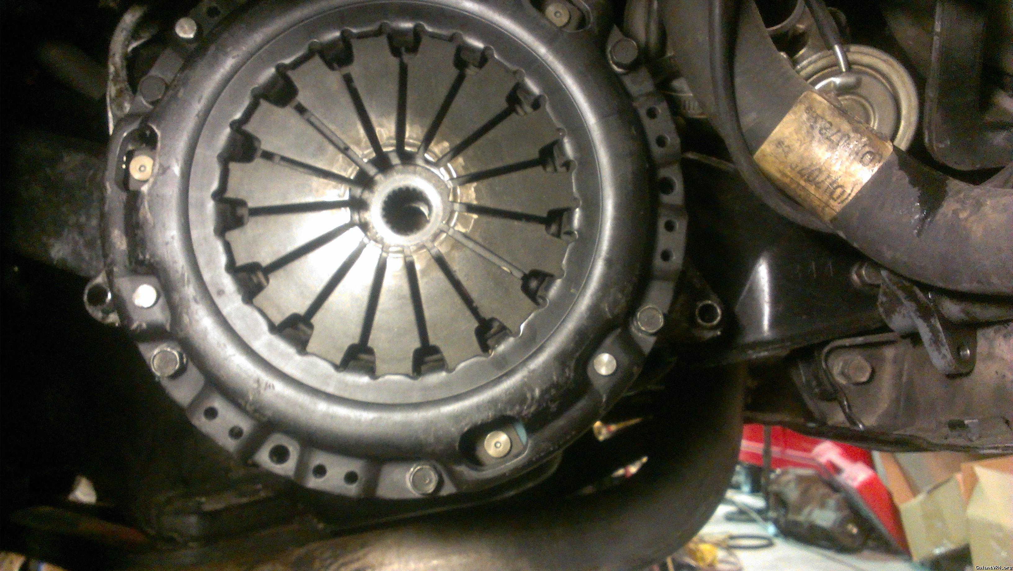

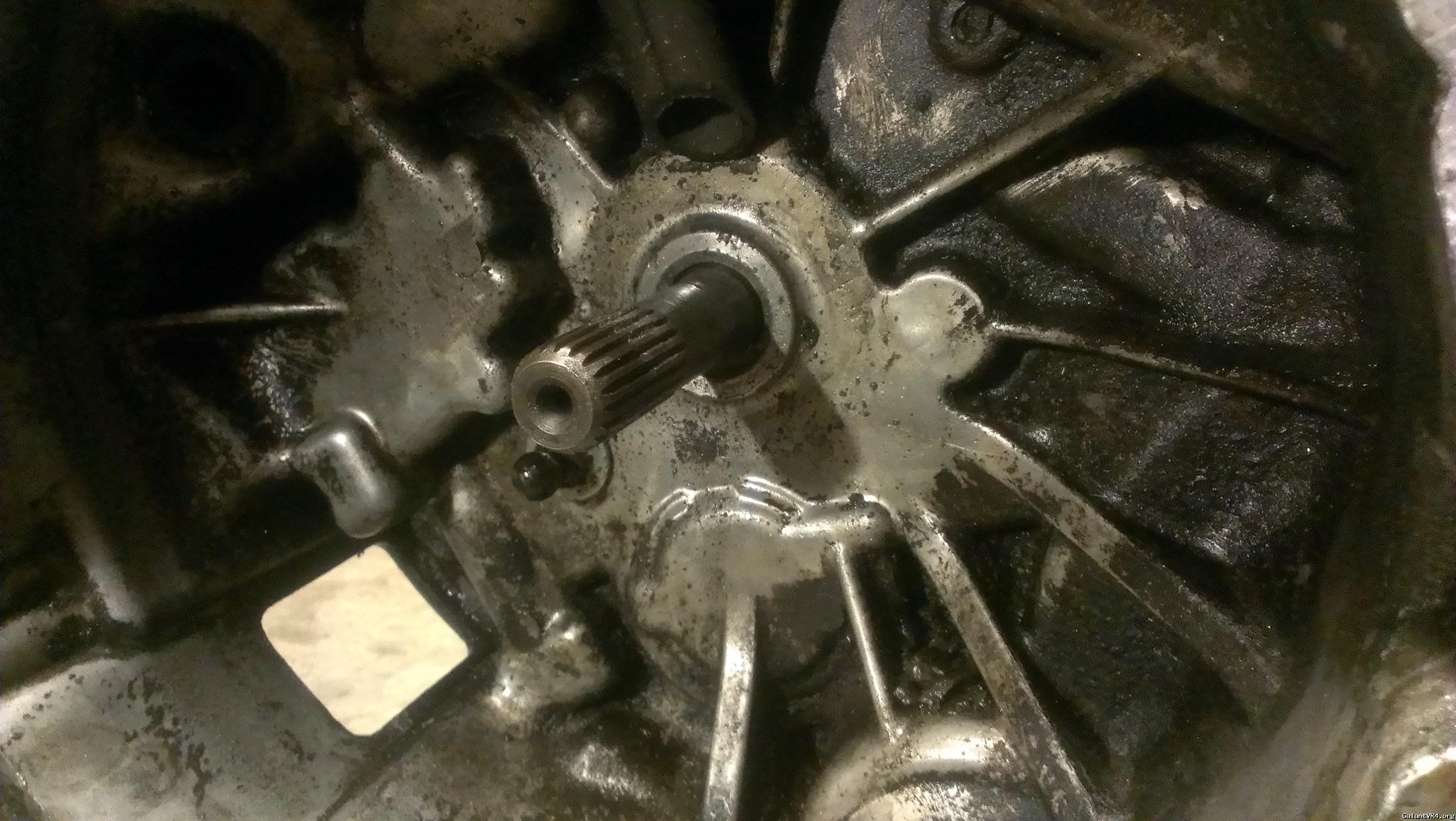

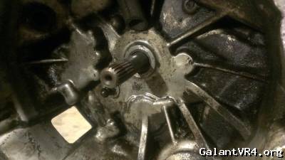

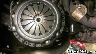

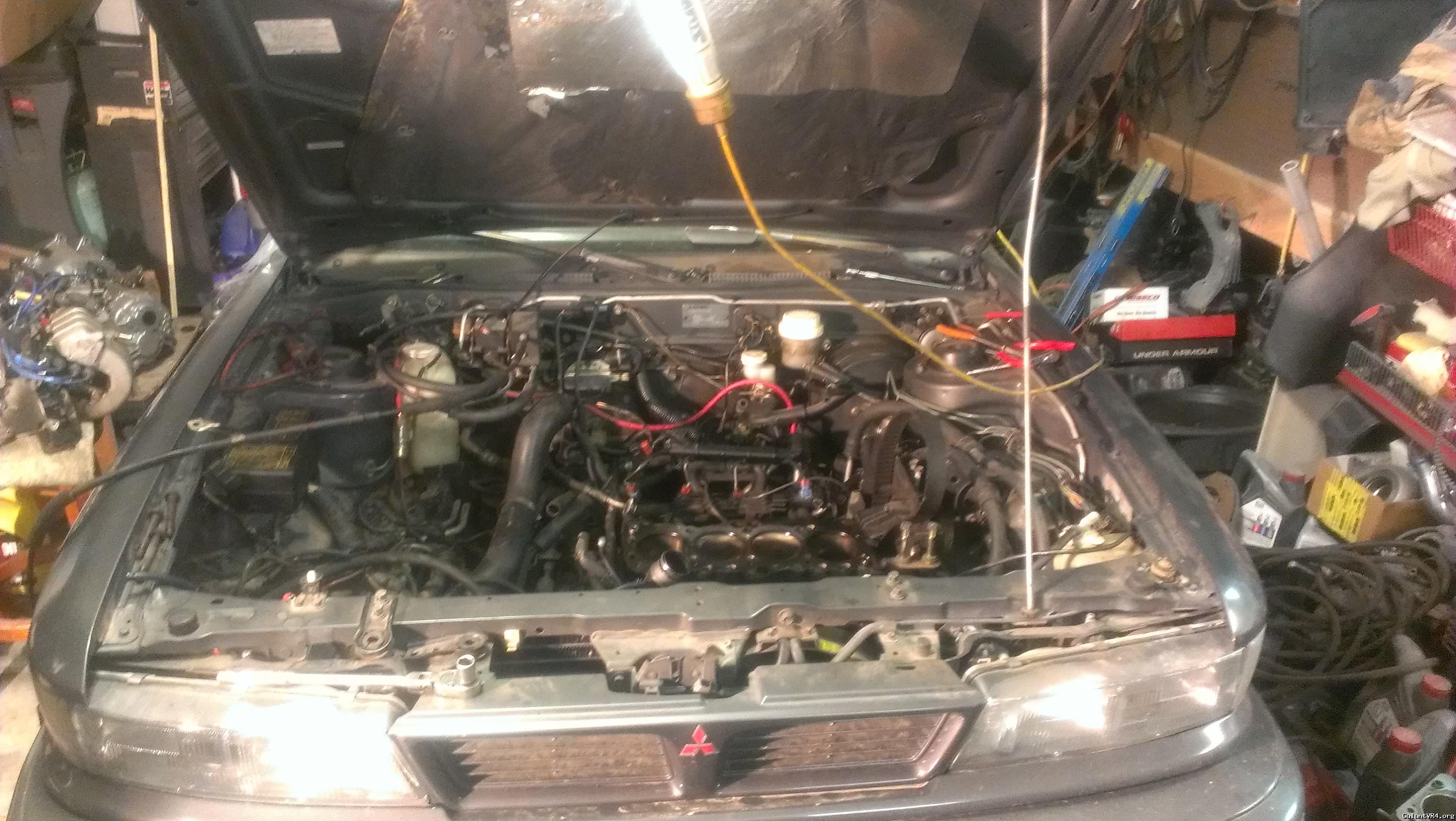

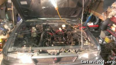

Hey, some of you know I bought 666 about 2 weeks ago not running. I received it head disassembled and parts in the trunk. I would like to say that after only 24 hours at Bond Speedworks in San Tan Valley, AZ the motor was rebuilt and is now running. The amount that was wrong was extensive including lowering springs that look like they were for a dsm, a downpipe connected with only 1 home depot bolt and nut, a valve in the motor when some one was attempting a head on valve seal replacement and dropped it, broken ring lands, dirt in the motor from sitting with out a valve cover on, missing spark plugs, many blown or non existent gaskets, stuck injector, boost leaks, missing bolts and nuts, a few cut wires, and general grime all over the bottom. Kristen and I rebuilt most of the block and thanks to his Warehouse amount of spare parts we were able to replace almost everything needed to make her run.
/ubbthreads/images/graemlins/applause.gif A SPECIAL THANKS TO ALAMO AUTOSPORTS FOR PROVIDING All AFTERMARKET PARTS FOR THIS REBUILD! /ubbthreads/images/graemlins/applause.gif
She is now on dsmlink v3 full, has a refreshed block, new oem pistons, new mls head gasket, H&R springs, ACL race bearings, OEM gaskets, EVO9 timing belt, arp hardware and tomorrow a bath. I will be heading back to texas tomorrow in my first gvr4...LIKE A BOSS! /ubbthreads/images/graemlins/cool.gif
p.s. I didn't take as many pics as I would have liked but they will be coming later.
