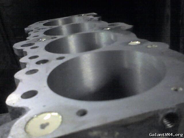

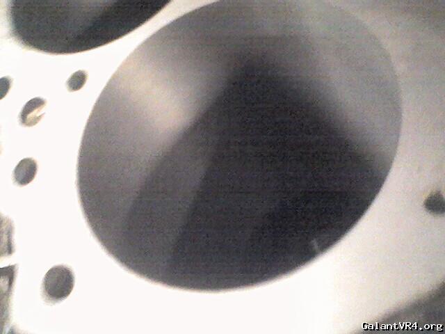

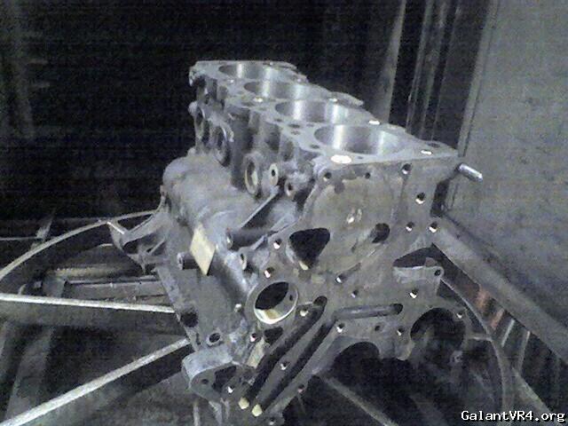

hey guys just wanted to see what you guys think of my build list for 637
TOP HEAD:
Topline Gasket kit
OEM MLS Head gasket
ARP hardware
BC 272 cams
BC valve springs and retainers
BC intake and exhaust valves
BOTTOM BLOCK:
Topline Gasket kit
ROSS pistons
EAGLE rods
ARP hardware
polished crank
thats all i can think of on the top of my head.... pics coming soon.... /ubbthreads/images/graemlins/smile.gif
