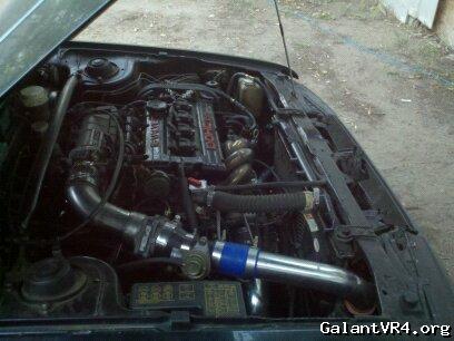

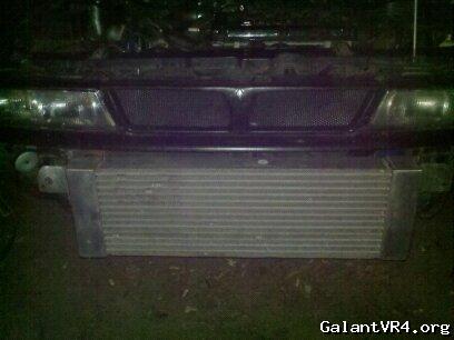

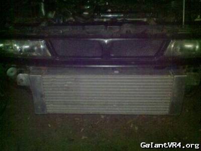

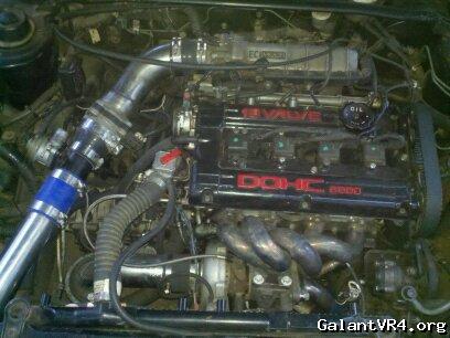

Well this past weekend I installed new xtd stg 4 clutch kit and a massive griffin custom vr4 made intercooler. Both pita. Well I will start by saying I love the clutch but something was missed from the factory, because there were some nubs that were on the pressure plate that were hitting my bell housing. Other than that clutch install went pretty good, took a long time. The massive front mount I installed I had to do alot of cutting stuff away so piping wouldnt rub on anything.

Thats what being a member from this forum is all about. Kudos to Diego and Co. Now, how about some pictures of that "Massive" Griffin core and pictures of your setup.

The core is f'n huge and I mean huge. Think goes from foglight to foglight.

Well he has a decent GodSpeed core that did fine would see a flutter of a 3rd bar(stock boost gauge was turned to knock gauge) before shifting hard into 4th now after changing cores it barely lights one bar on the dash.

The main reason I got the core was for trade for a paint job on a 90 300zc tt and I wanted an intercooler big enough to grow with power and fill the middle section of the gvr4 bumper. Im running a dual bb precision 50 trim on 750 fic's, eprom chip, pump gas on 19 to 20 lbs. Im gonna turn my boost up when I go to bandimere because they have 104 octane fuel. I only have picture on my phone I will upload very soon.

Nice nice, looks almost as big as a spearco 2-216
