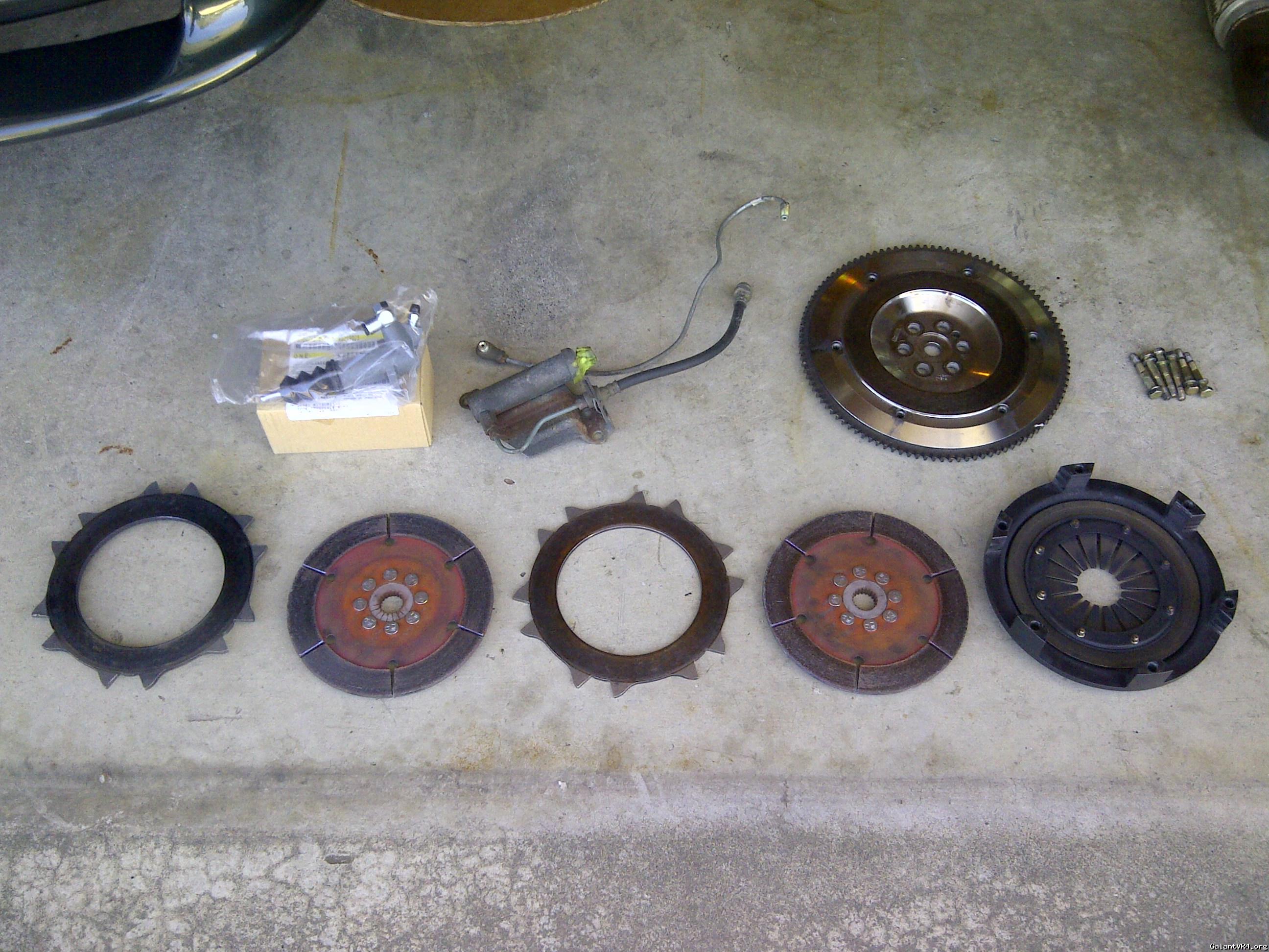

11,992
And out she comes:
I already have an interested buyer, but if that falls through, I'll post this in the forsale section. It's in amazing shape.
I'm still waiting on my new ACT flywheel to show up on Tuesday, so the car is on JSB duty until sometime this week.
