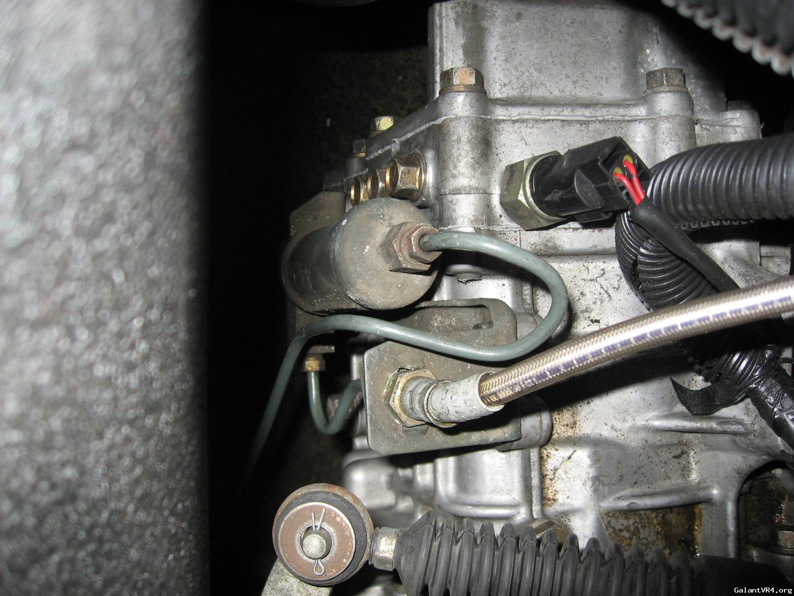

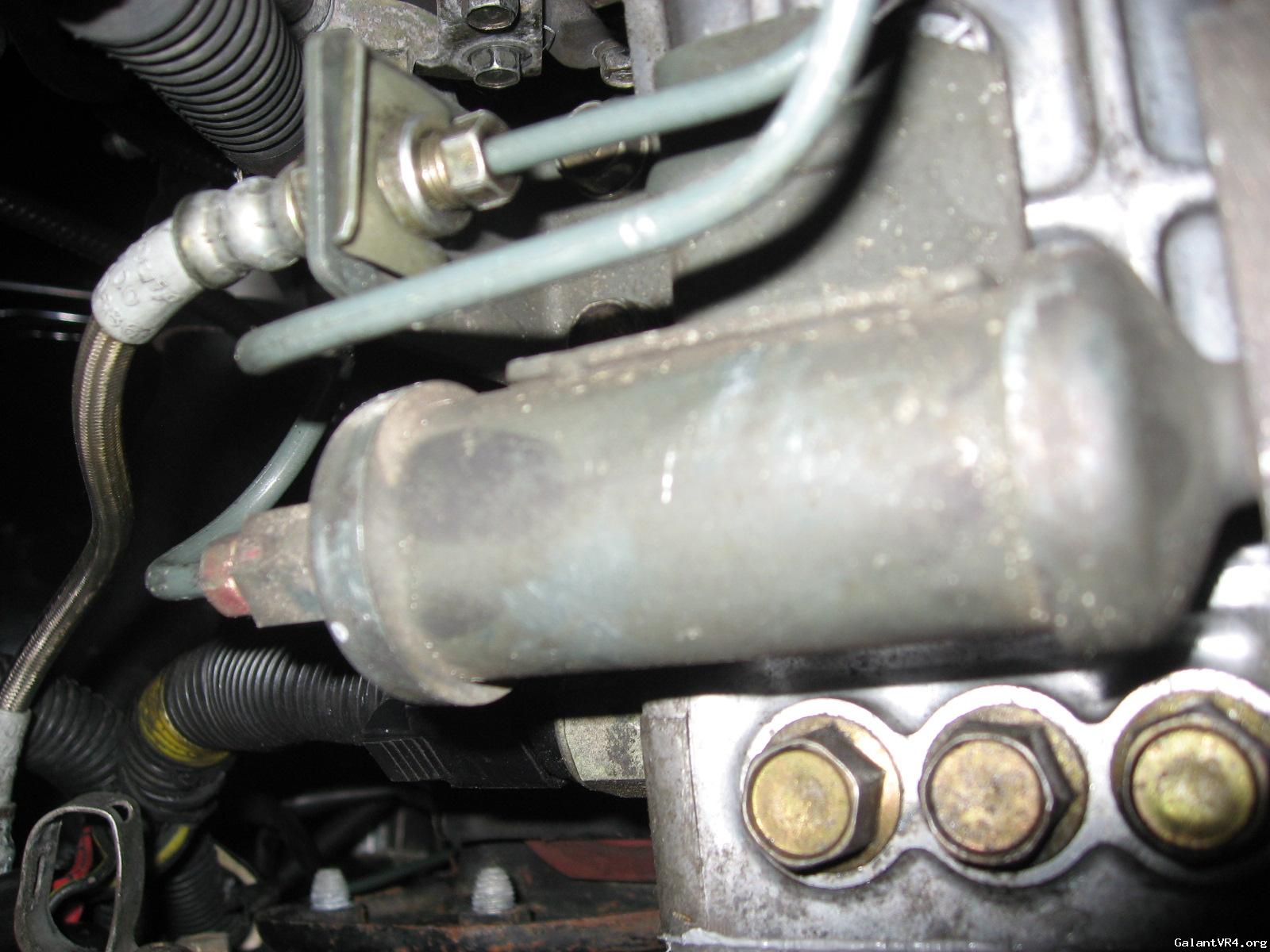

Like Mark said its not really a mod but kinda is for the twin disc guys. On the 95+DSM they had a accumulator and a slave that had a bigger bore with less travel. So when you put it on a car with a twin disc it slows down the clutch engage meant making for a twin that is supper easy to slip. Make the twin feel more like a single disc clutch.
This is what it looks like

Sorry for the stupid questions but is there a provision for it in the 1g clutch line? I have my twin up for sale because I hat it so much, but this might change my mind.

Yes you can run it on a 1g. It bolts up the same as it did on my car. When you buy one you need the accumulator and the 2 hard lines that go with it. One goes from the factory rubber line to the bottom of the accumulator and the other goes from the top of the accumulator to the slave.
