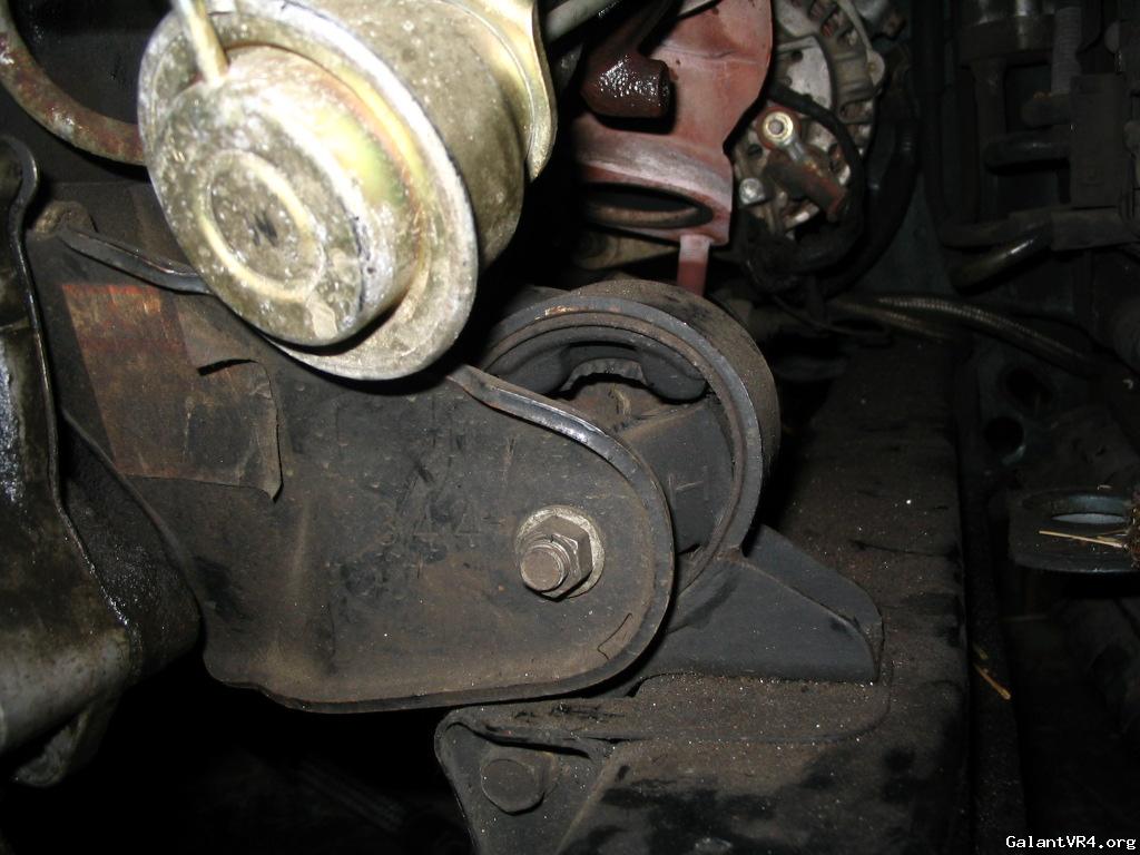

Check your front motor mount (roll stop). If the clutch is chattering, the engine will be rocking back and forth accordingly as the load is fluctuating through the driveline. If the rubber in the mount is old and tired like mine was, it can stretch or tear to the point that the engine bracket will make contact with the front crossmember.
