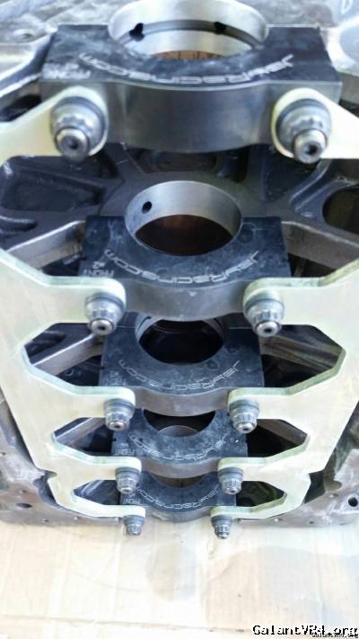

Here is a run down of the engine.
2.4L G4CS
Eagle Crank
K-1 Rods w/22mm wristpins
Wiseco 87 mm 10:1 HD pistons
Kiggly girdle
Billet Main caps
ARP Main and Head Studs
Ported 2G head
GSC +1mm SS Valves
GSC Hi Rev Beehive springs with Ti retainers
GSC Valve guides
GSC Vitton Seals
FP3 cams
AEM true time cam gears
Fluidampr balancer
EVO Rocker Arms
3G Lifters
Evo 9 Timing Belt
New OEM front case, Water pump and timing components

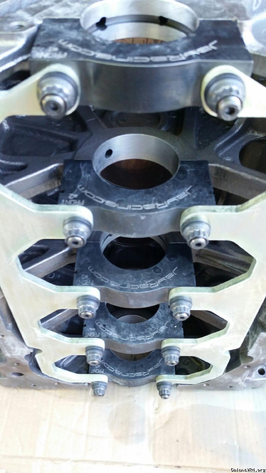

Teaser pic of the mains.
