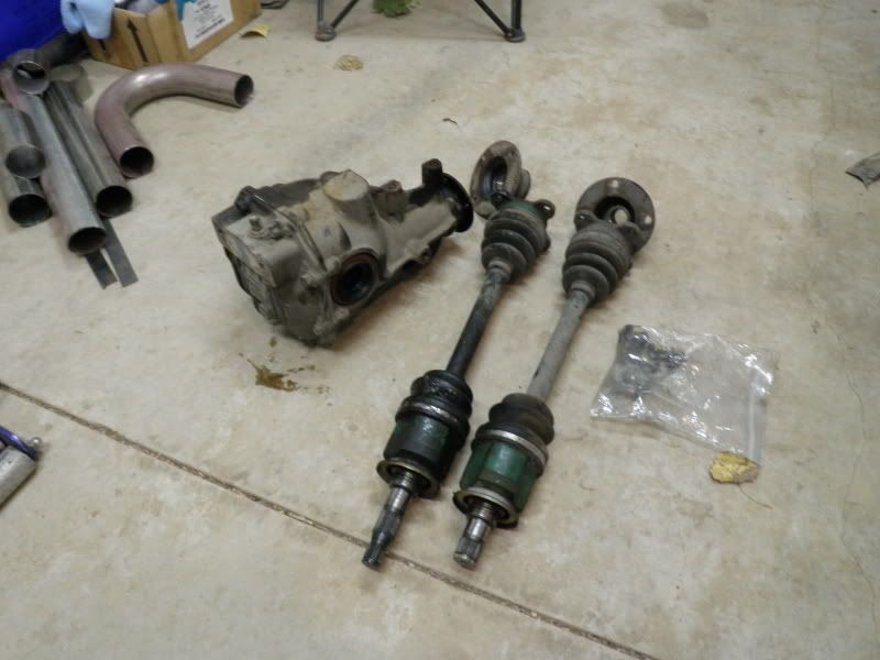

went to a race in lubbock tx and broke my rear axle.
pulled my transfer case and driveshaft on the side of the track and kept racing FWD /ubbthreads/images/graemlins/smile.gif

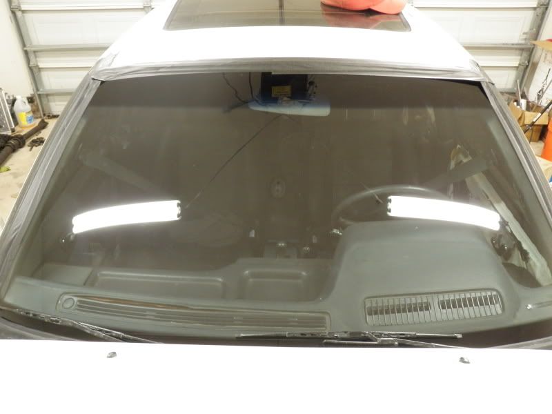

finally got a new windshield

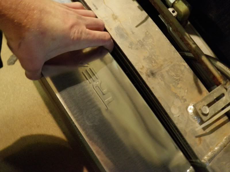

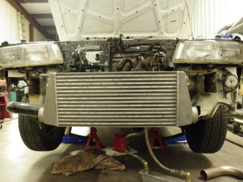

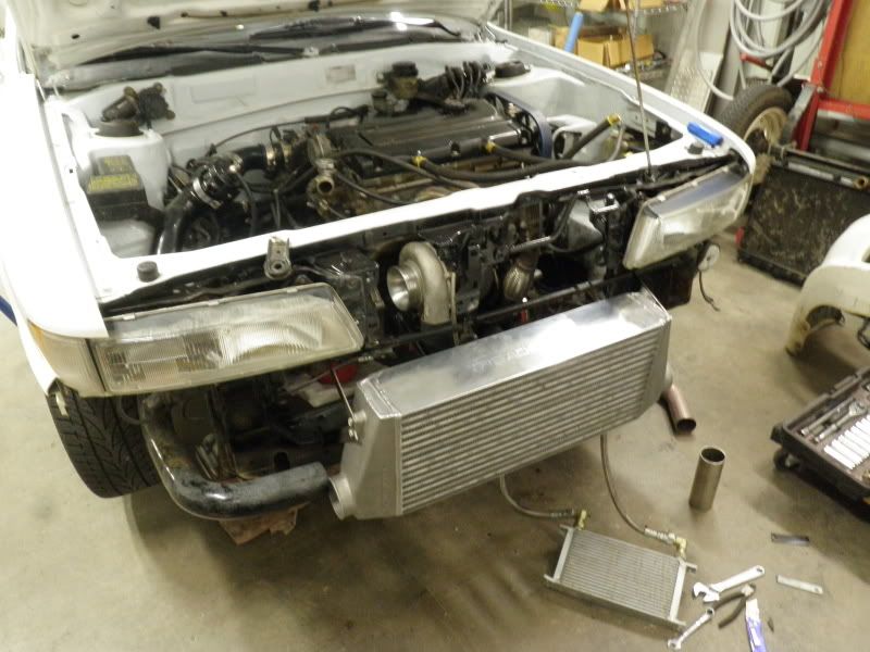

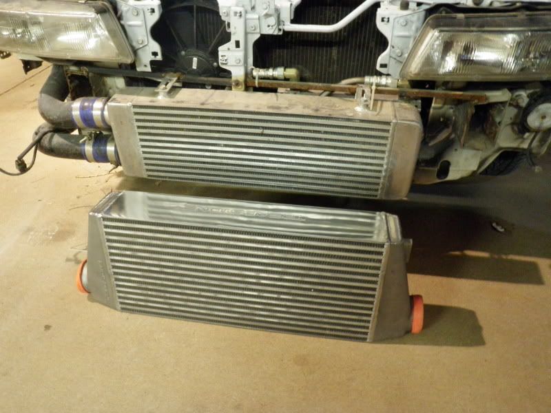

decided to go to a big boy grown up intercooler.
a lot thicker as well

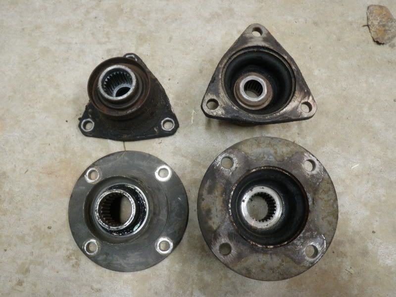

all the stuff i removed putting in the 4 bolt.

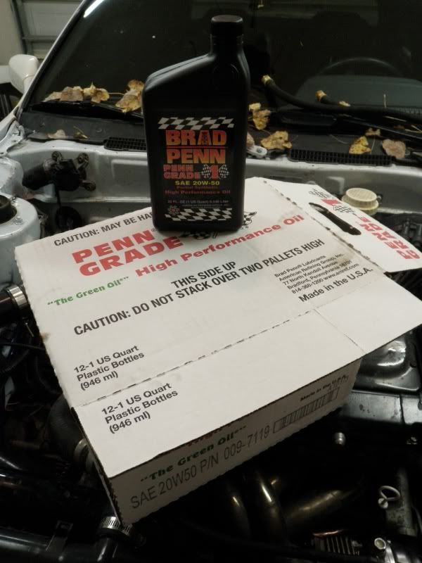

switched over to some brad penn... LOVE IT

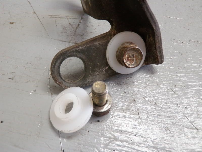

made some solid mounts for my shift linkage.

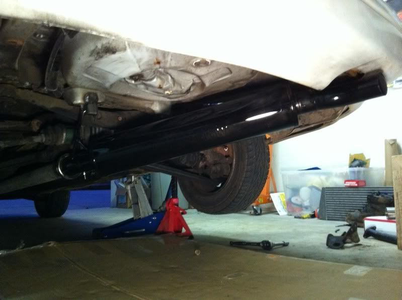

made some solid mounts for my carrier bearings for the driveshaft

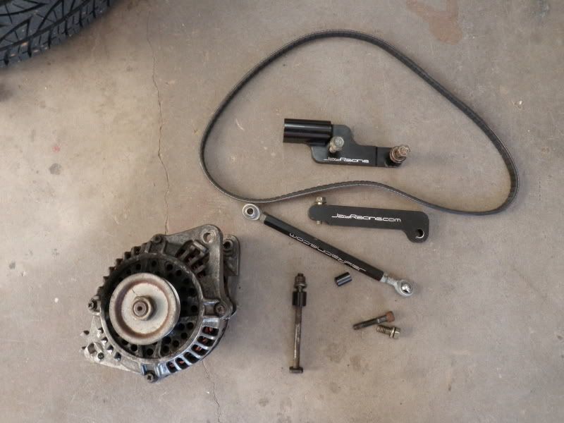

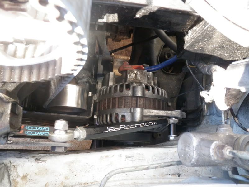

alternator relocation kit...

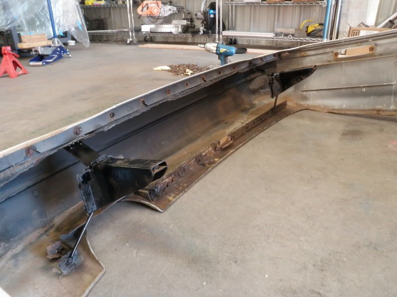

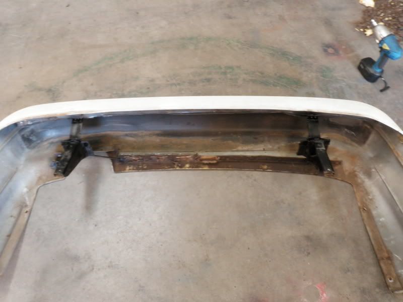

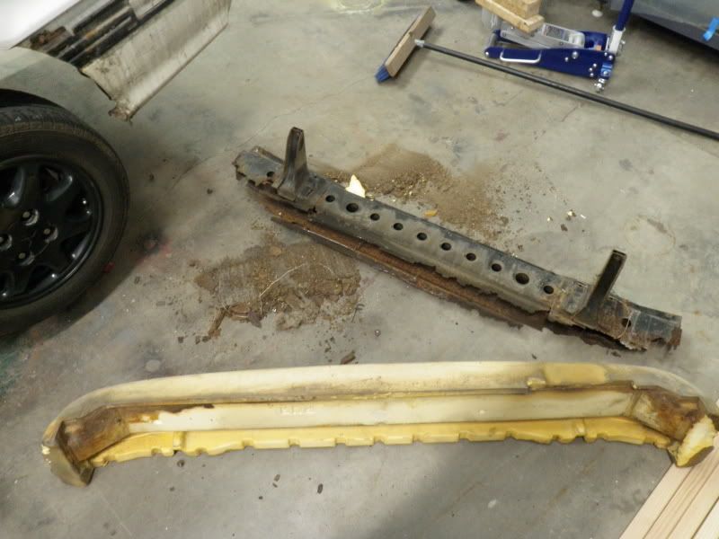

deleted the massive rear bumper, yeah gettin rid of more weight.

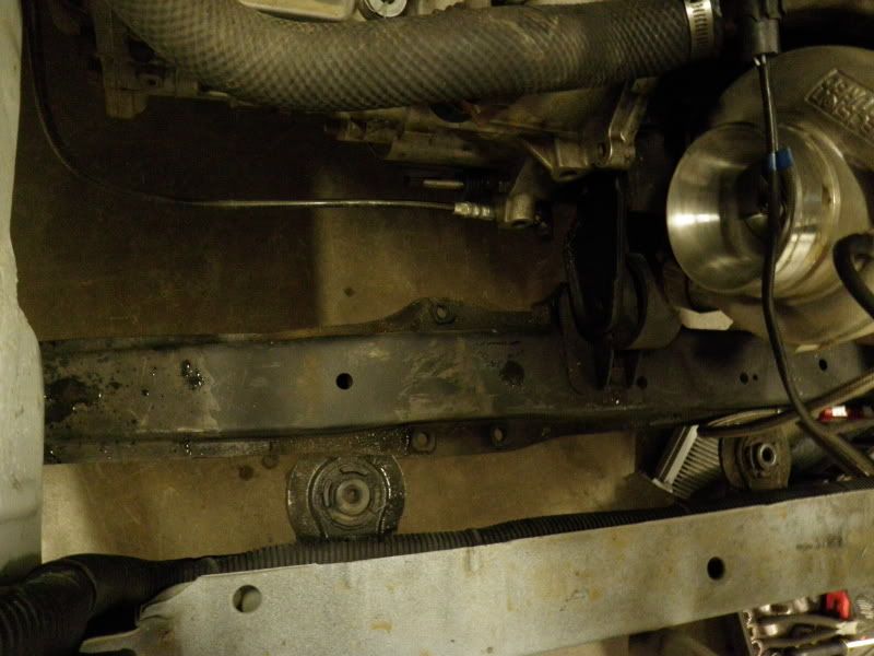

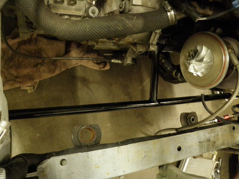

deleted teh front motor mount bar...
with a lightweigt solid motor mount versian i fabbed up.
got my new front mount mounted..

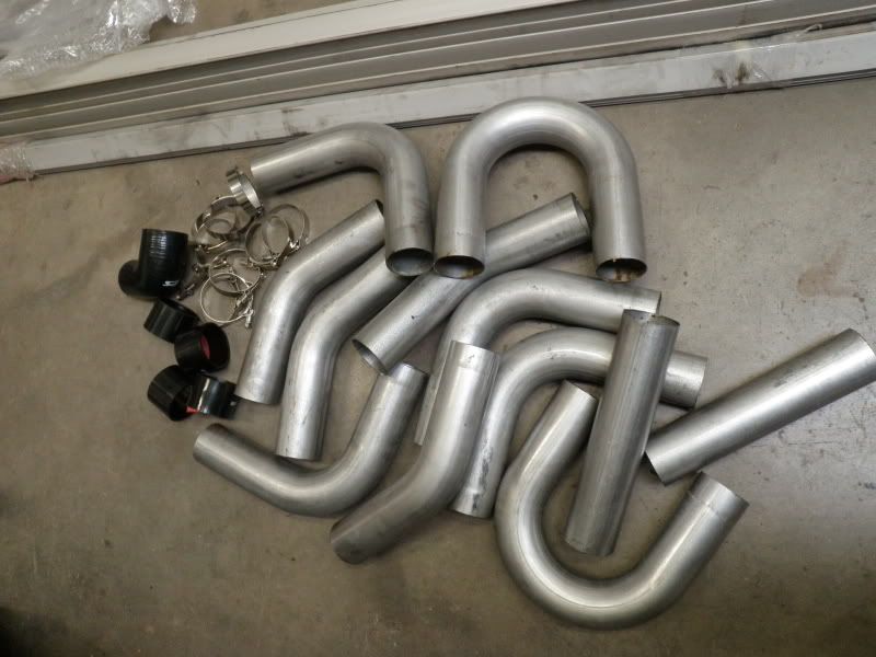

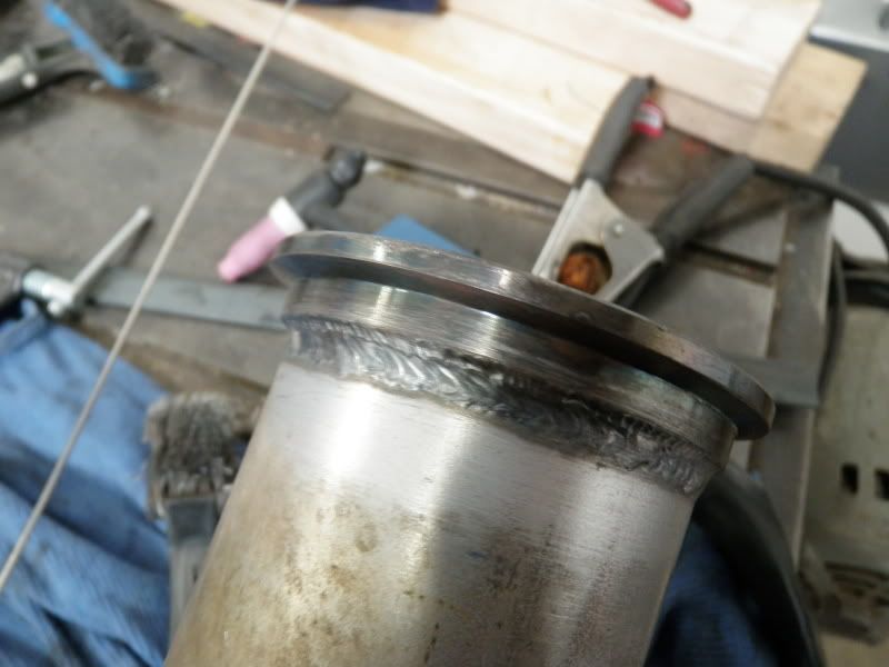

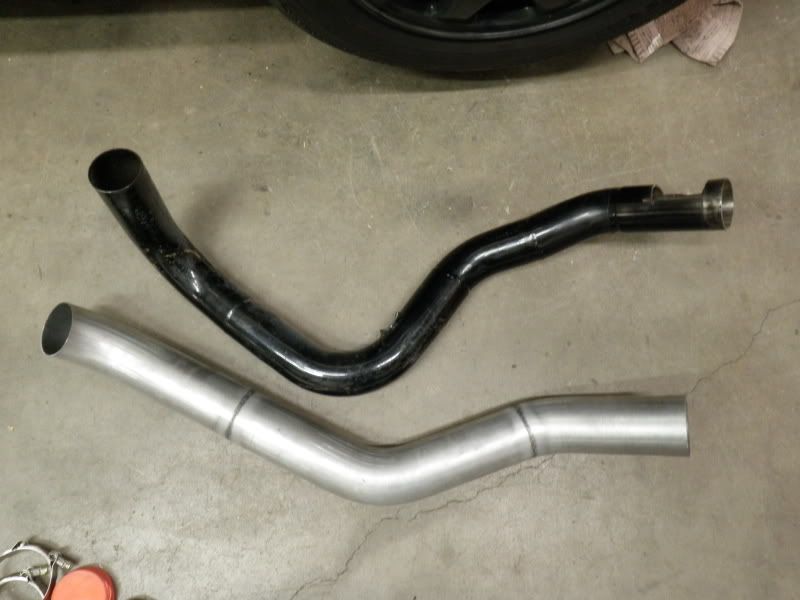

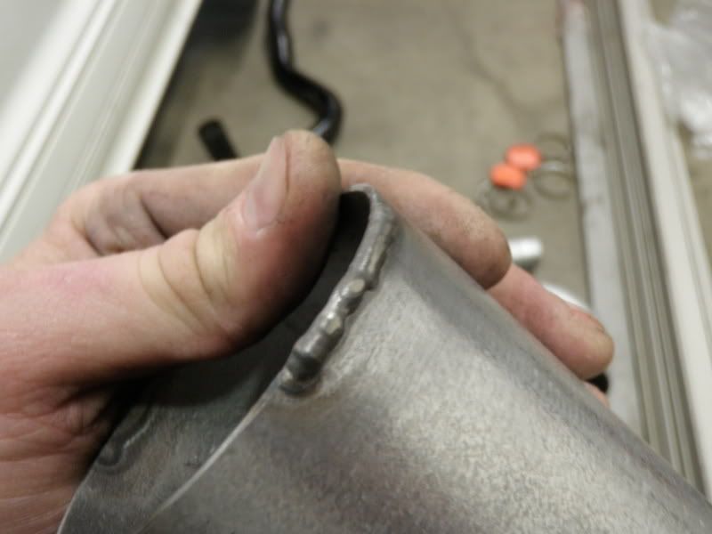

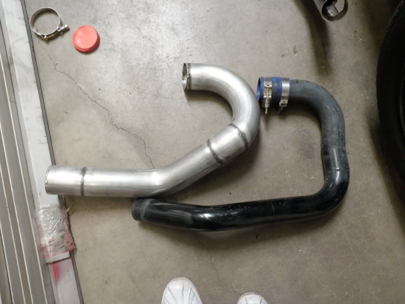

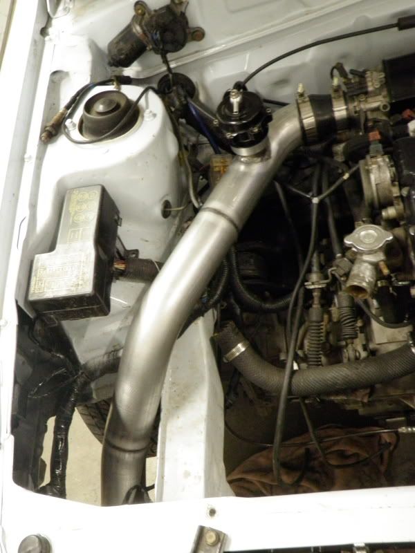

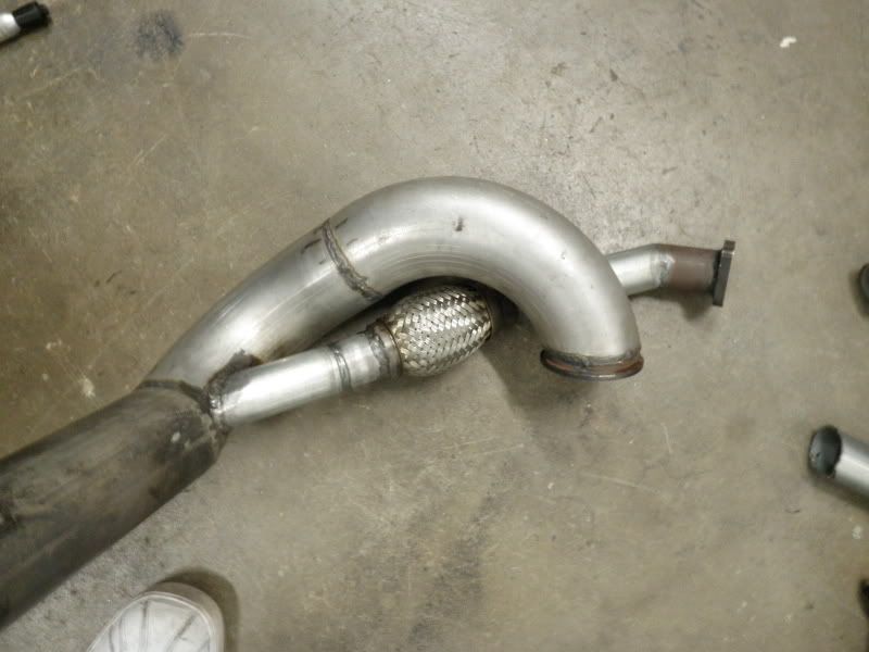

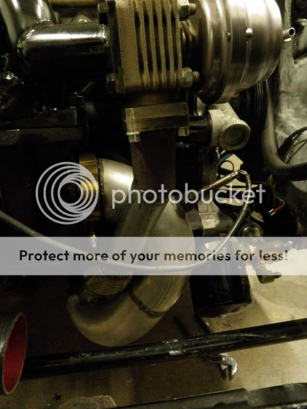

all my new mandrel 3" pipe for my boost system

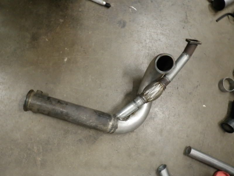

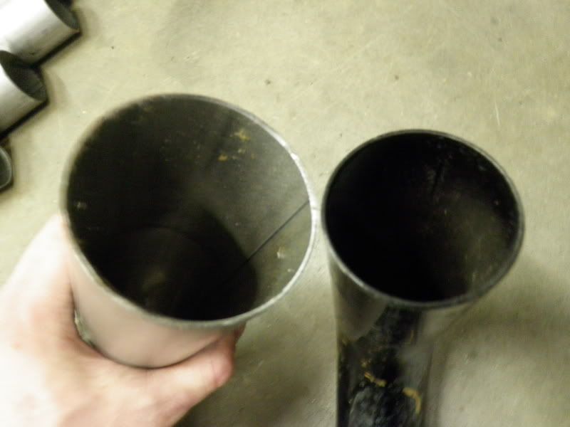

new vs old. was able to straighten out some of the bends for better flow.
2.5 to 3" really makes a diff.

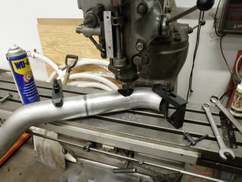

cut out a hole for the BOV
other side pipe... straightened out as well.

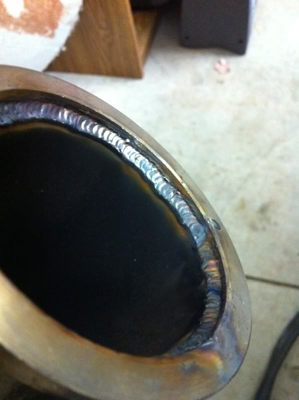

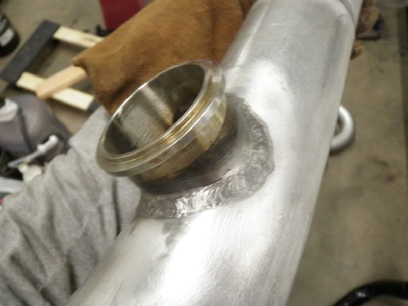

its a little ghetto i know but im not cool with blowing of boost pipes. so i made ridges to keep it all together.

IC piping route with that massive IC. The compressor outlet is only a few inches away from that front lower subframe with the compressor outlet clocked down. I have the same turbo, and was going to do the exact same thing, but then I found an IC setup on here that doesn't require all that. I just have to take a gamble with a Honda radiator! haha. we'll see. I have a large external oil cooler, I hope that helps.

Like the build, I had never thought about the weight of the rear bumper beam. I might have to look into that.

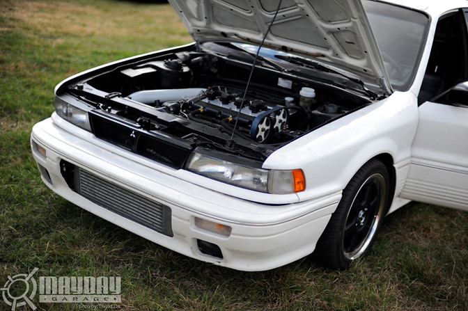

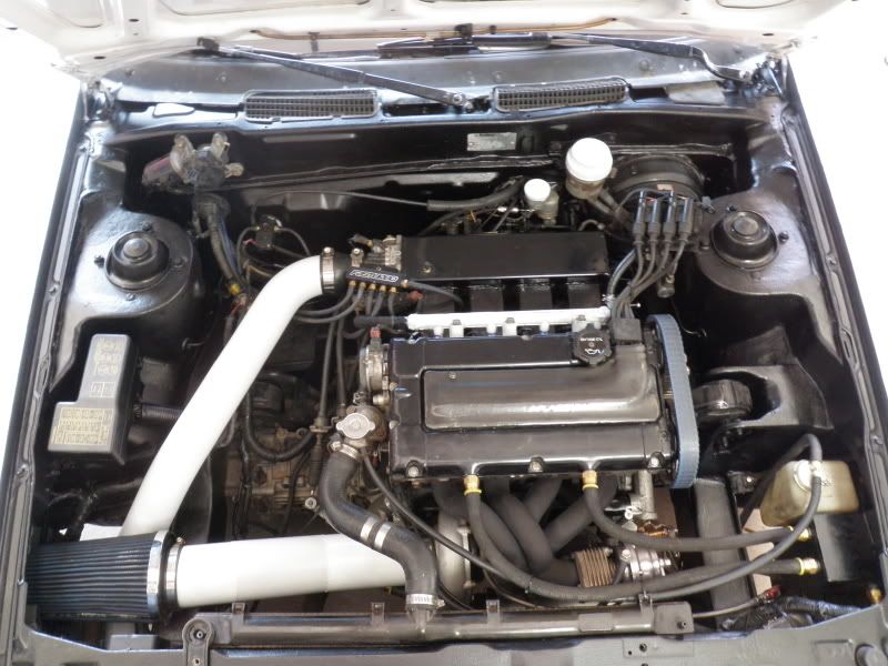

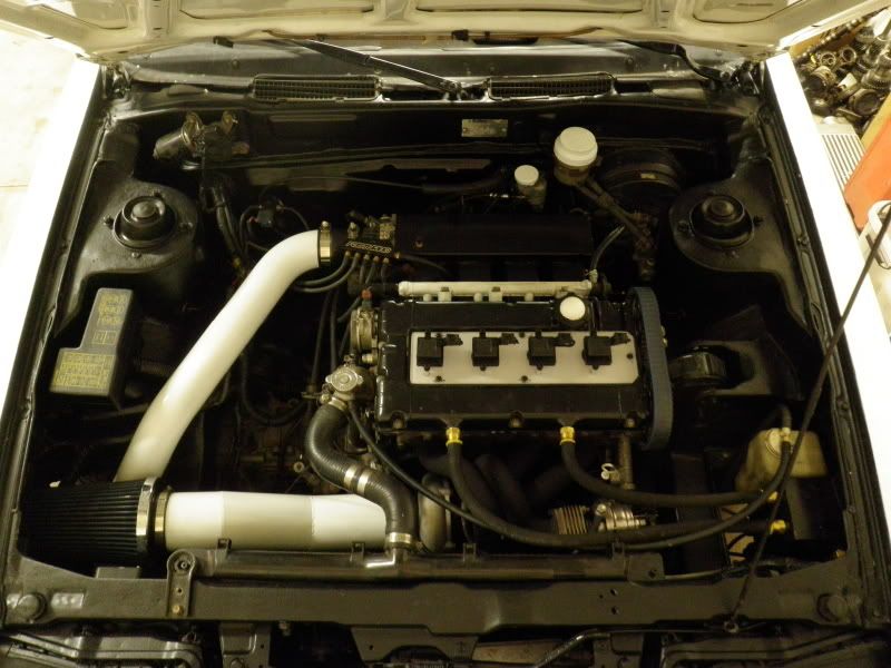

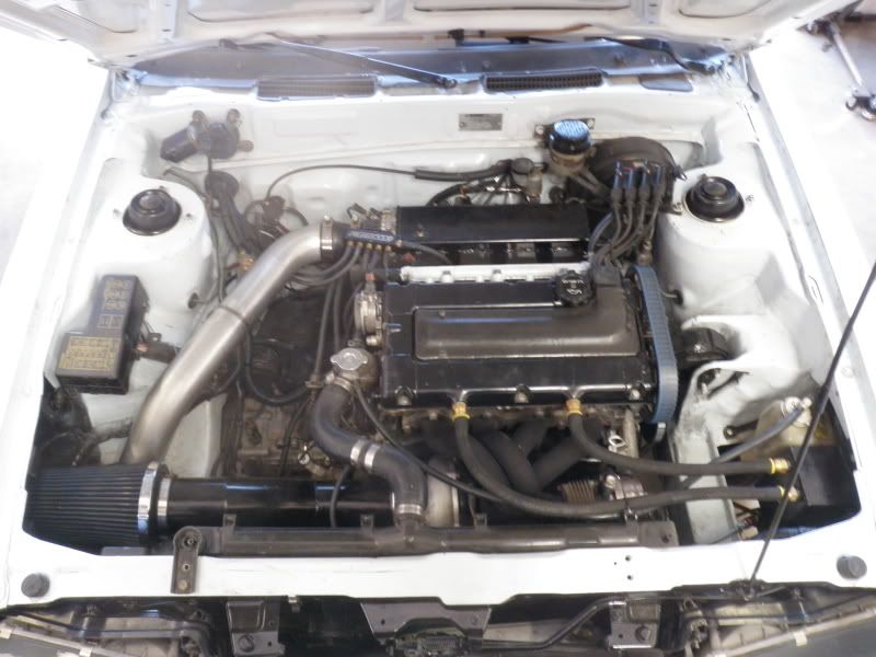

so figured i would give my engine bay another facelift... i still wasn't happy with it.
before
after
also lowered 2 inch's... i need a bit bigger wheel but its gettin there.

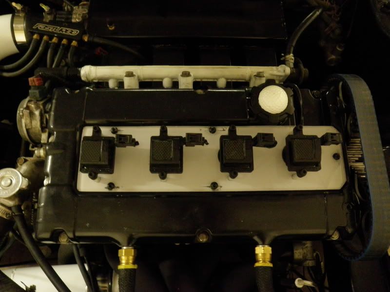

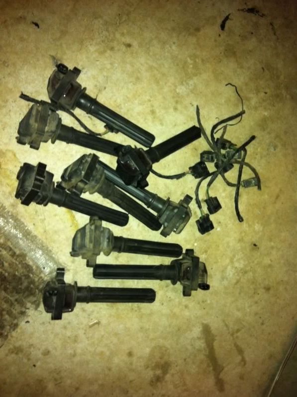

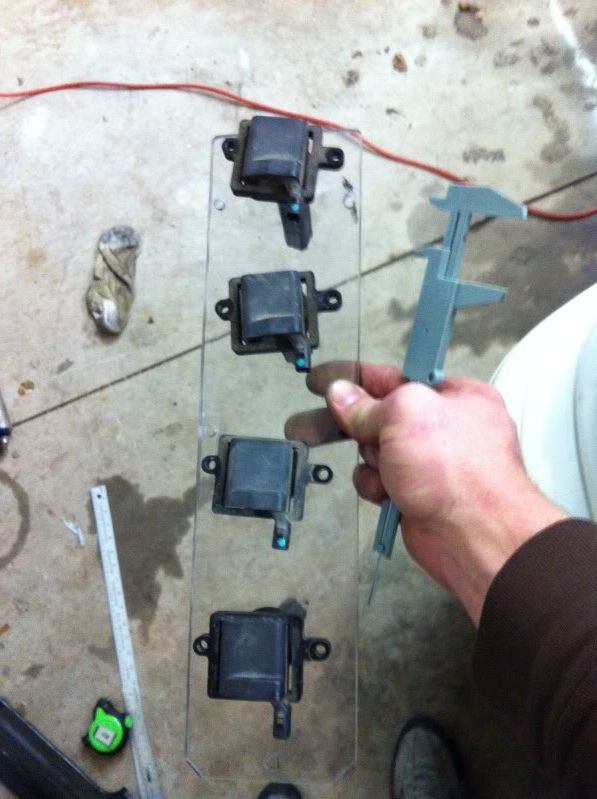

and lastly made myself a little coil on plug set up.
started with some coil packs from pull-a-part off a intrepid
mocked em up on a spare sheet of lexan i had laying around.
finished looking like this

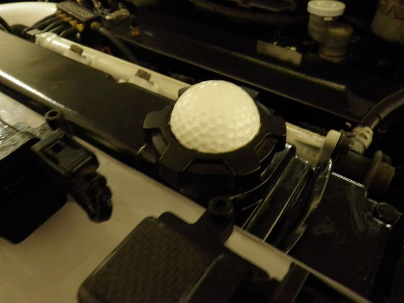

then for fun i added a little oil cap touch.

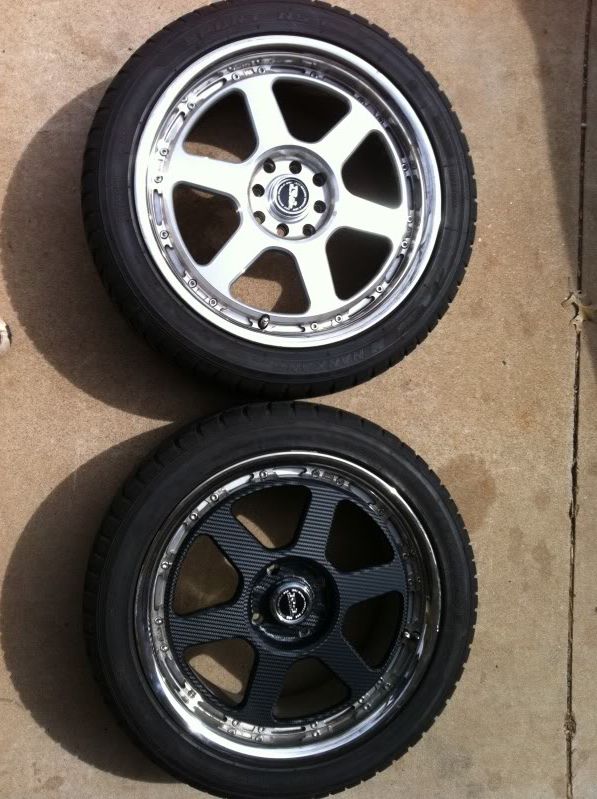

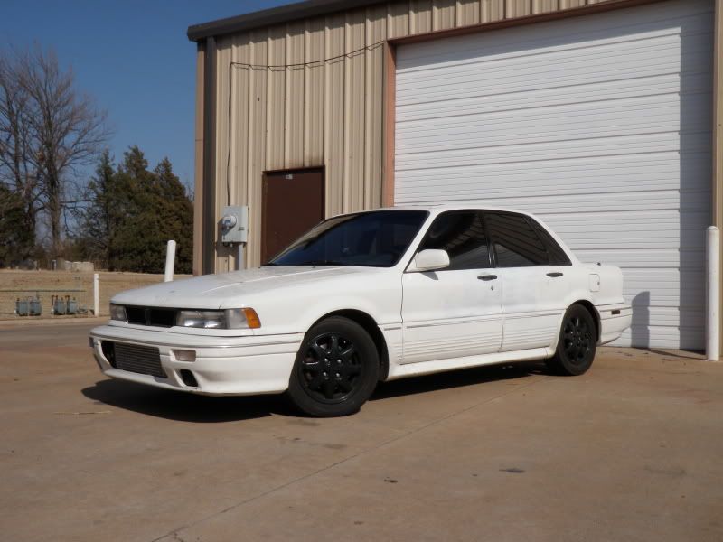

got some new wheels and droped it.
heres what they were befor.

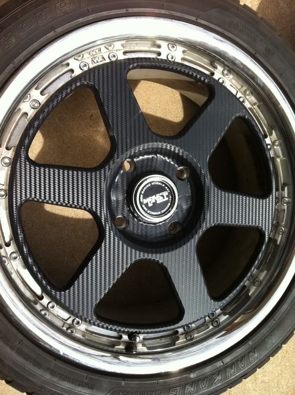

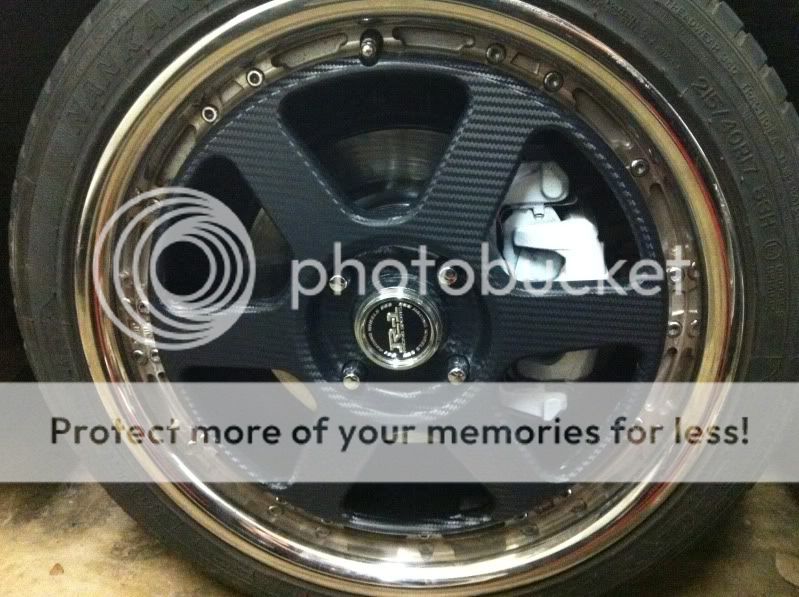

decided they were to plain so i figured i would try out 3m's new carbon wrap.
after pic
We went down to Tx2k11 supra/gtr nationals. it was a blast.

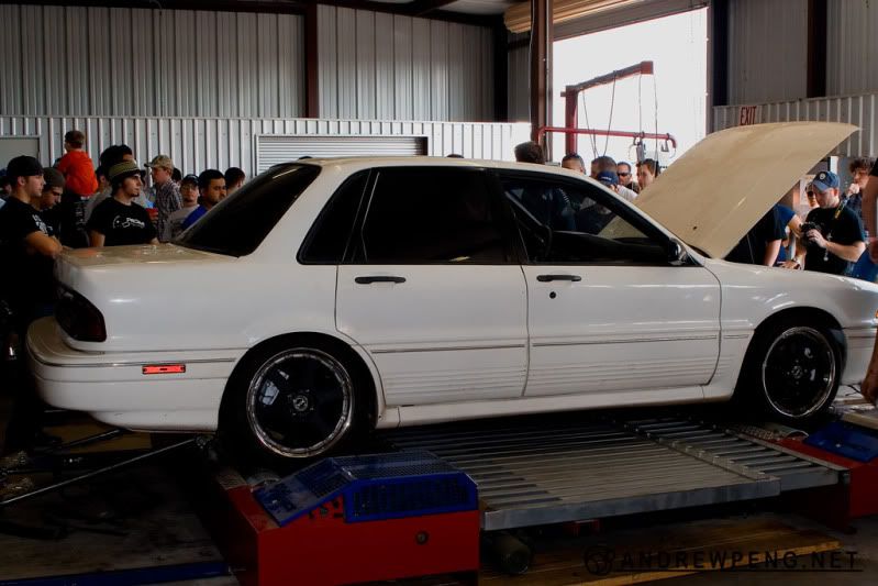

threw er on the dyno to see what'd it do.
Wow i like the wrap on the wheels. Hopefully it will hold up.
Btw what did you put down on the dyno?
