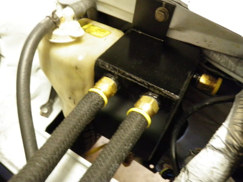

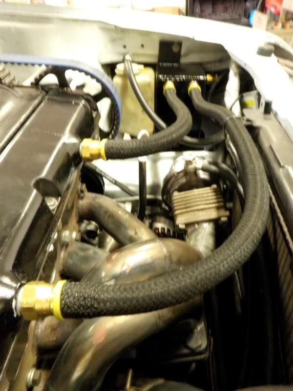

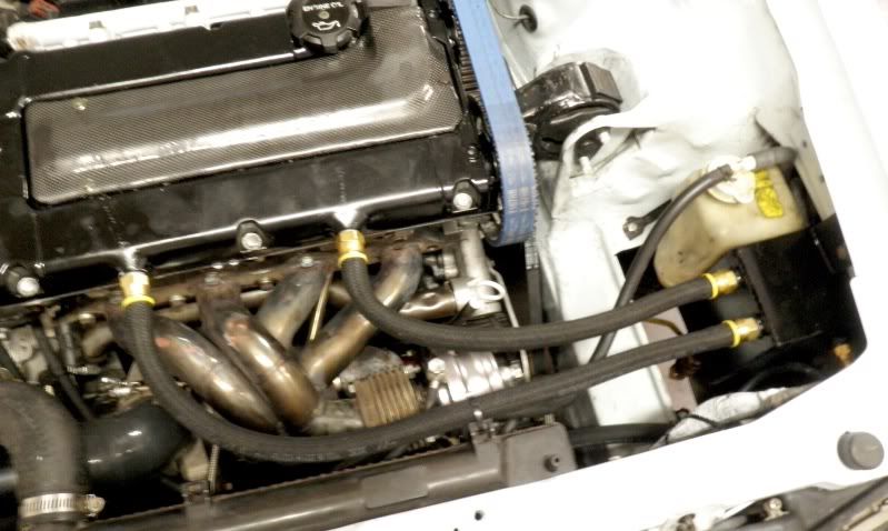

finished catch can pics...

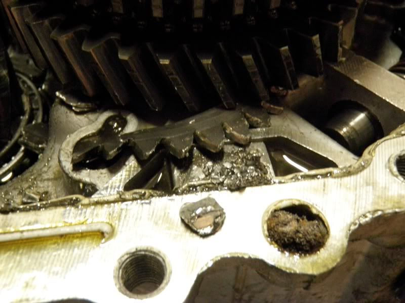

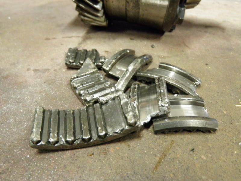

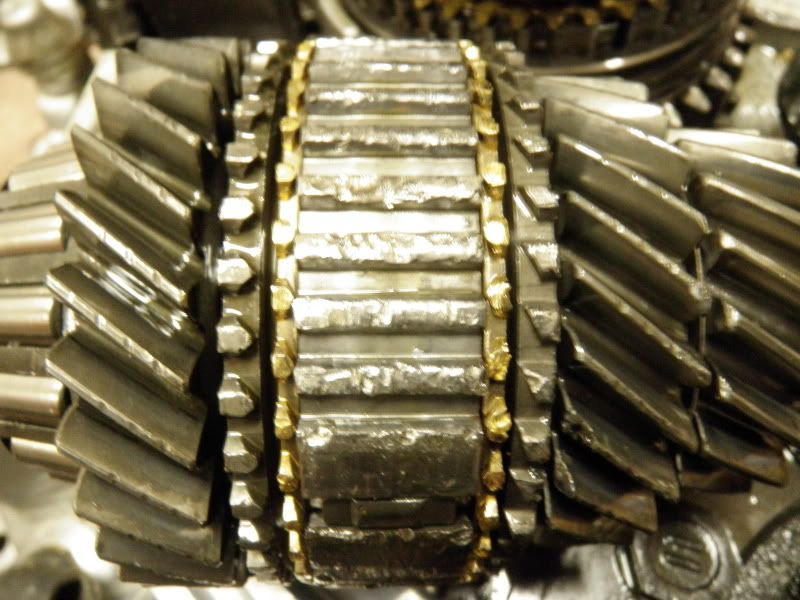

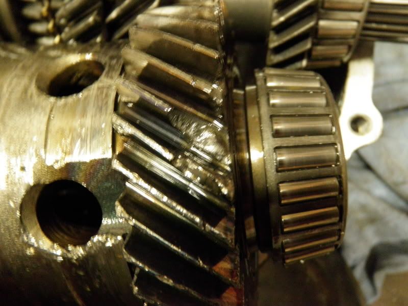

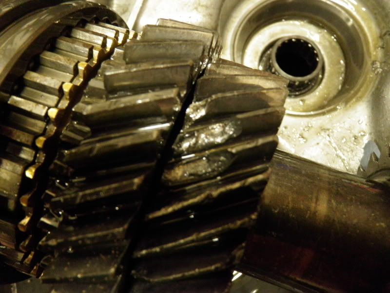

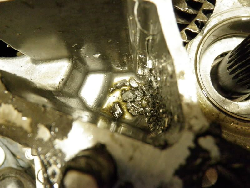

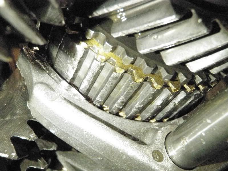

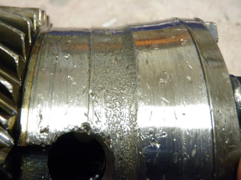

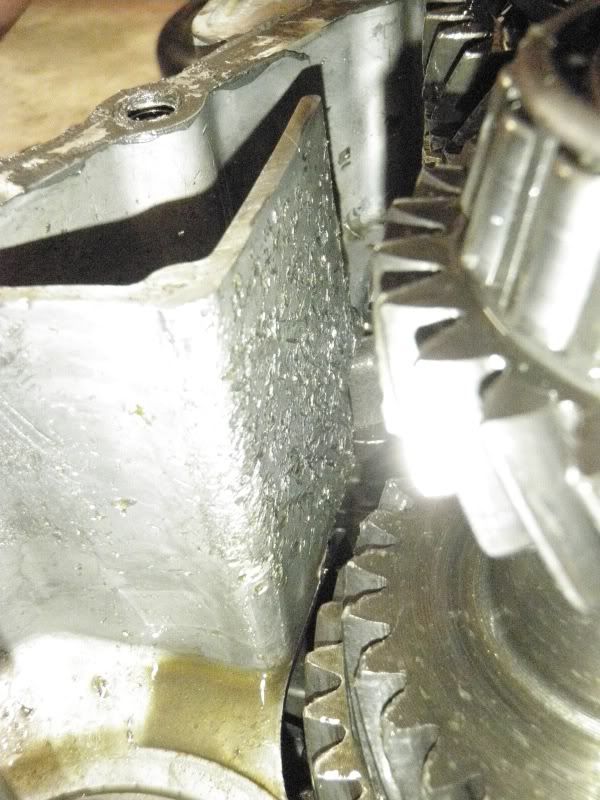

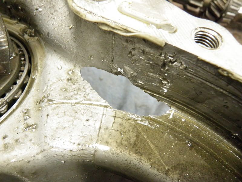

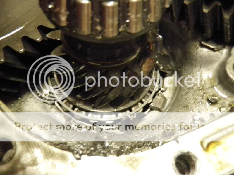

was fun and did a really gentle 13.7 at 120... but sadly broke my trans...

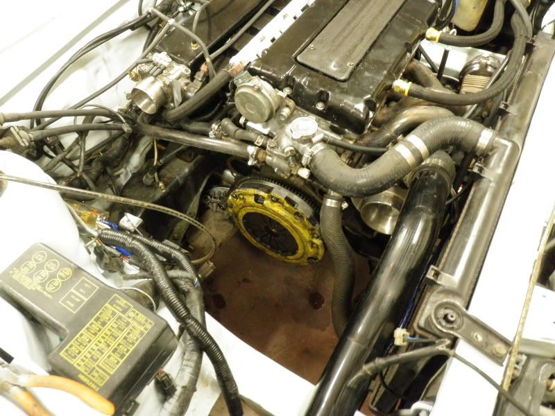

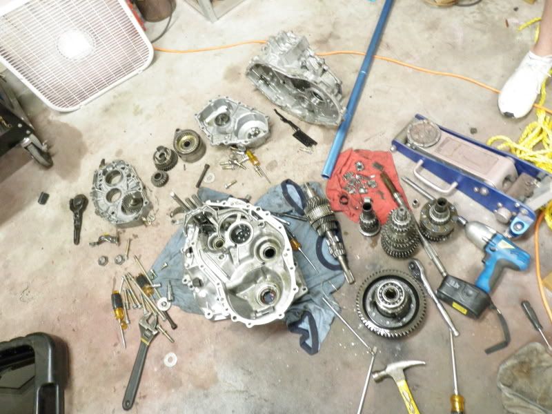

so pulled my trans out tonight to see what the damage was form breaking at the track....
so guess im not rebuilding this one /ubbthreads/images/graemlins/smile.gif new built tranny FTW

really not positive what happened... i had a missed shift 1-2 first run... but who knows when it actually broke. i mean the trans had 175,000 miles on it so : )
i got a new trans in the works. HE HE

In the new trans, make sure you dont have that same piece of crap 3/4 assembly.
The earlier models have a MUCH stronger slider, and do not have a record of going kaboom like yours did.
