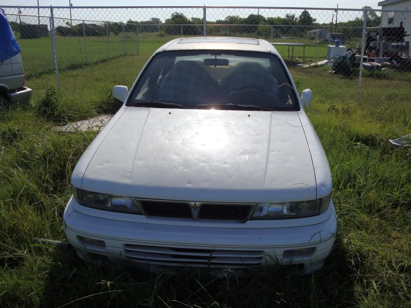

hey everybody names Josh and i finally got me a vr4 project.

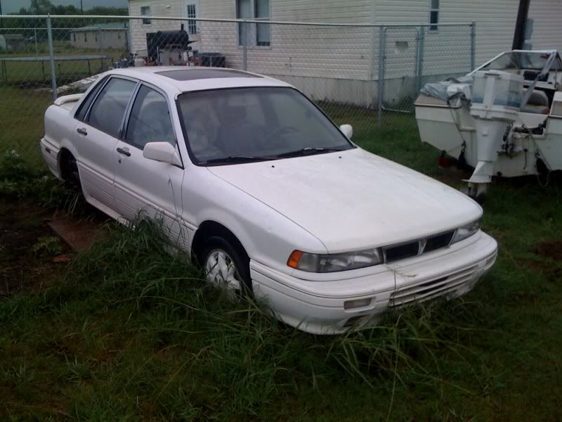

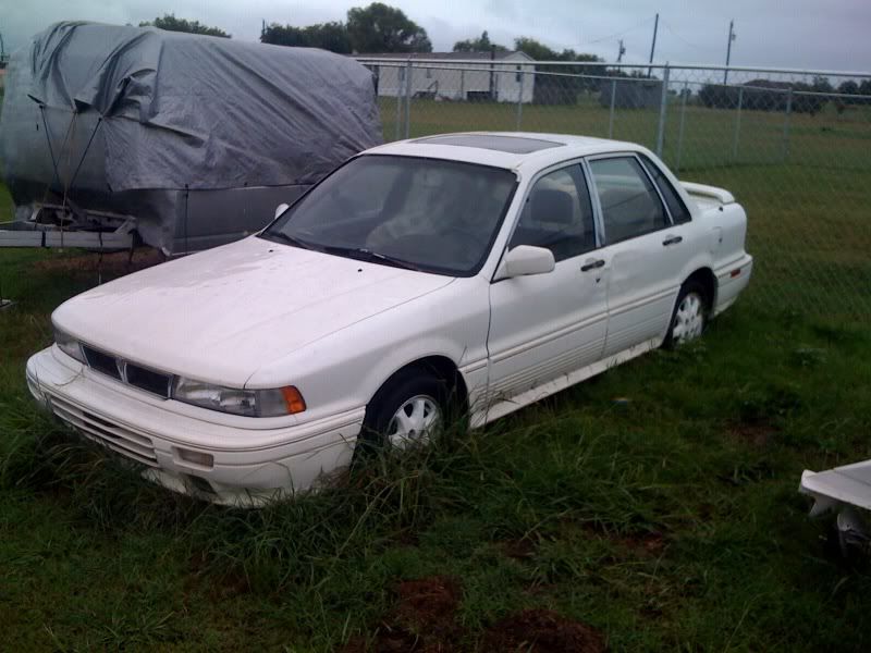

saved it from a field outside dallas texas.....
Code Name is Project Golfball - due to being white and lots of hail damage dents.
I MUST WARN YOU.... THE FOLOWING PICS ARE NOT PRETTY AND MAY SADDEN YOU....

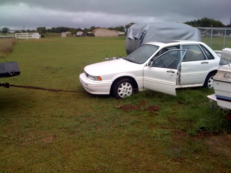

Backstory is it has unfortunately been sitting for about 6 years.... after a lot of work we got er loaded up....
forgot to get outta the car befor we loaded it and i got stuck.... it was interesting gettin out....
anyways got big plans for this car....

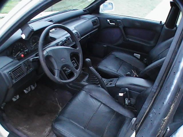

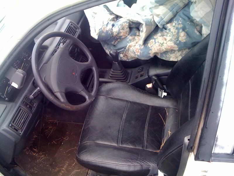

the interior is in really good shape because they had it all covered but everything else is really rough.

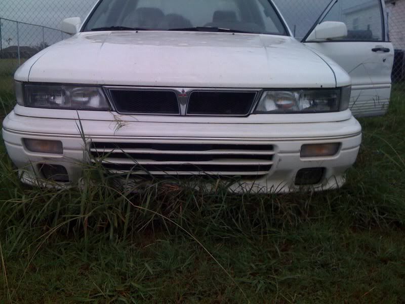

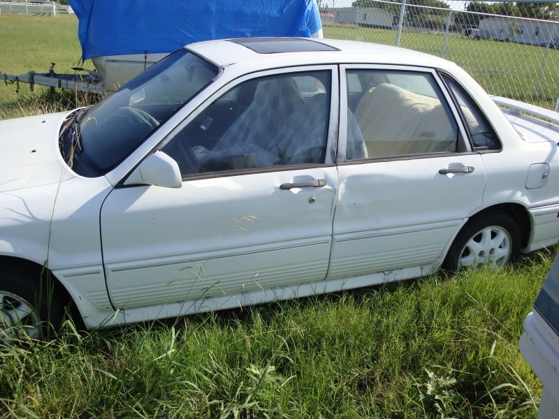

Looks wise im gonna try my best to fix all these dents, pop em out, bondo em smooth, repaint the whole car.

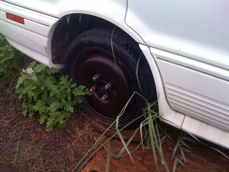

Sadly since it has been sitting so long everythings got a nice heathy layer of RUST..... which sucks. the biggest victim so far seems to be the brakes.
WHAT brakes will swap into the vr4????

How many miles? Hard to tell, but looks like driver's seat doesn't have the typical wear on the bolster; i'd say low mileage?
Did it go thru a hailstorm(s) or something? hood is easy to replace, hows the roof and trunklid. anyhow, looks like it has potential and good luck on it. As mentioned above, do all the basics first and get a solid foundation going then the mods are the easy and fun part /ubbthreads/images/graemlins/grin.gif

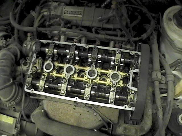

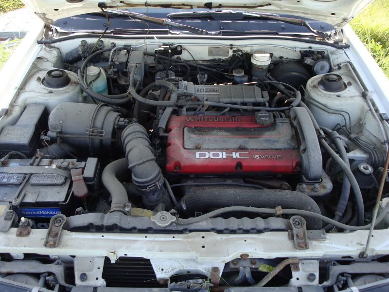

got it home sunday night about 830pm.... got home from work monday about 6 and had the car up and driving around the block by about 11.....
seems the drivetrains ok... tranny is really difficult to shift... hear thats pretty common with 1g's....

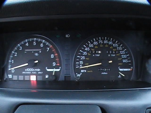

motor sounds really strong... OH has 170,000 ish miles....

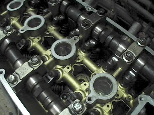

when i took the valve cover off to check everything and pour oil and what not all over so i could start it up it all looked spotless....

BODY: the car went through a really bad hail storm i was told... there is hail damage on pretty much every single pannel... hahahah... SAD THOUGH. im gonna try and just replace hood and trunk but the roofs gonna have to get some lovin....
Interior is deff nice.... im really glad they covered it all up befor it got parked....

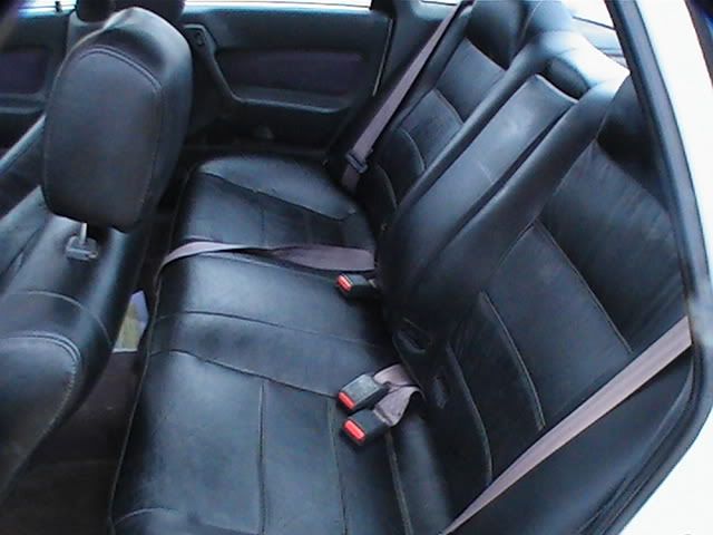

The interior looks nice for sure, but the seats still look like the leather could use some conditioning. That back seat upright part should be wrinkly and soft. I suggest some leatherique, stat. www.leatherique.com
