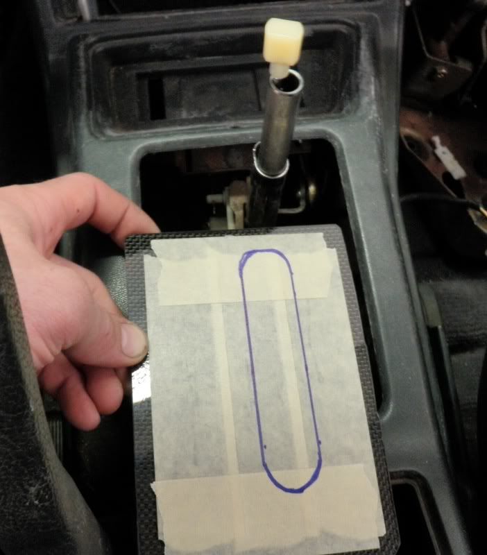

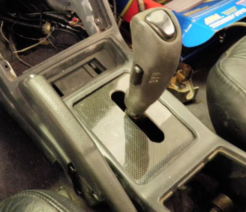

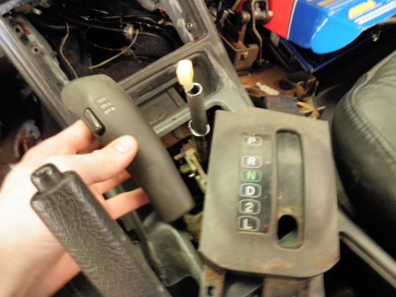

been trying to figure out what i wanna do with the shifter and got it figure out...

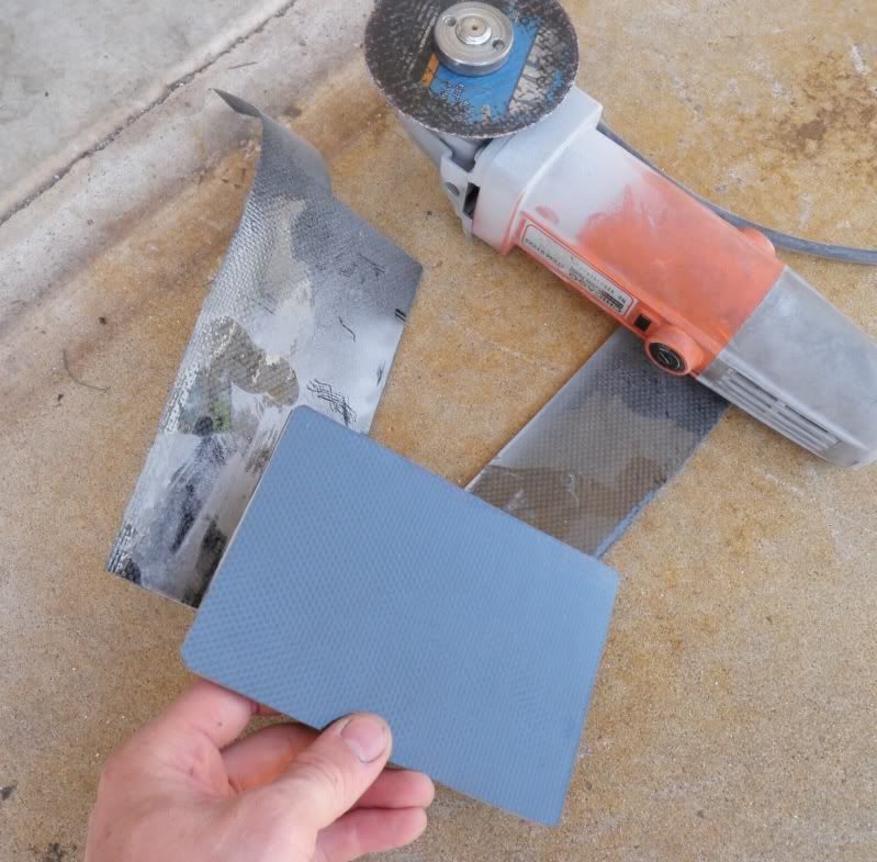

chopped out a nice CF plate from a piece i made
pulled apart the stock shifter...
measured it out and marked it
chopped and installed.... not perfect but good enough

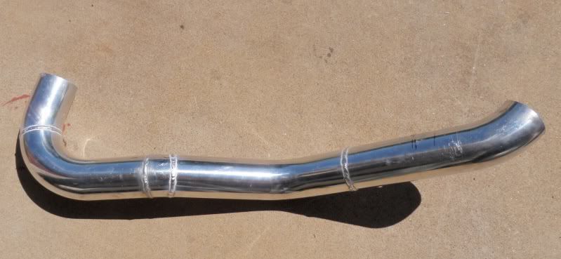

got the other boost pipe (intercooler to tb) done...

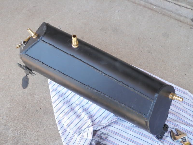

all aftermarket manifolds put all the ports in the same spot. well one of the nice parts about doing it all yourself means i can put the right size port exactly in the spot that i want it...

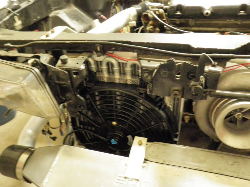

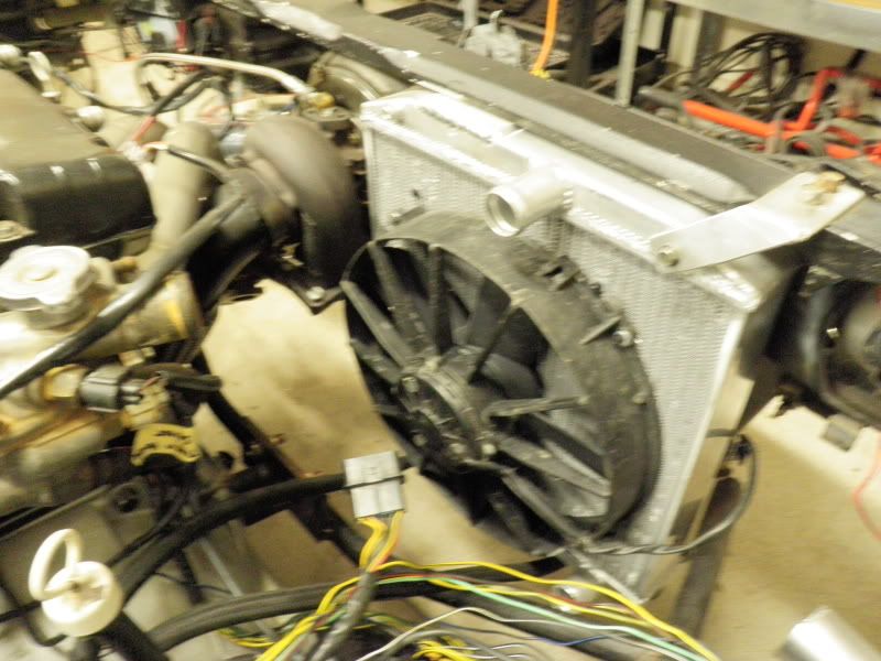

did a little sandwich stack with my tranny cooler and radiator, then bottom right is my oil cooler mounted to intercooler. So everything should stay nice and cool.

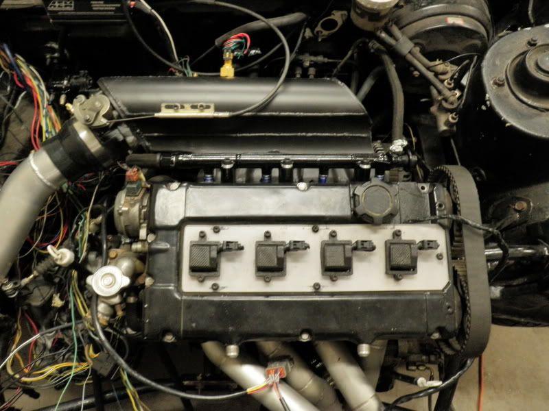

intakes done with all barbs and 5 bar map, fuel rail and inj back in and cleaned up. tb cable sorted...

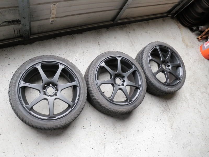

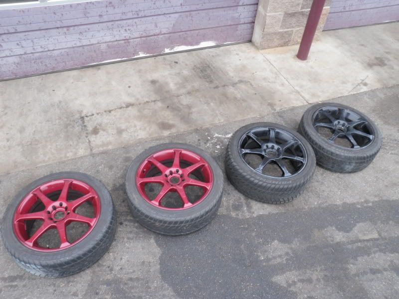

picked up some new wheels...
plasti-diped em for now

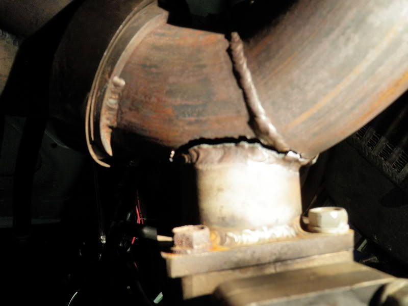

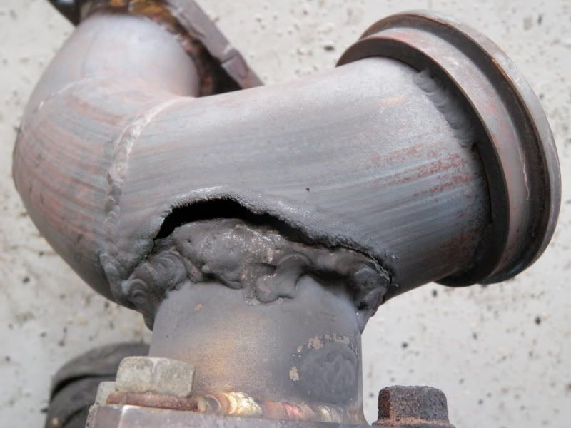

Cars so fast it decided to blow itself apart /ubbthreads/images/graemlins/smile.gif
just welded it back up for now but plan on rebuilding that whole piece out of some heavier stainless.

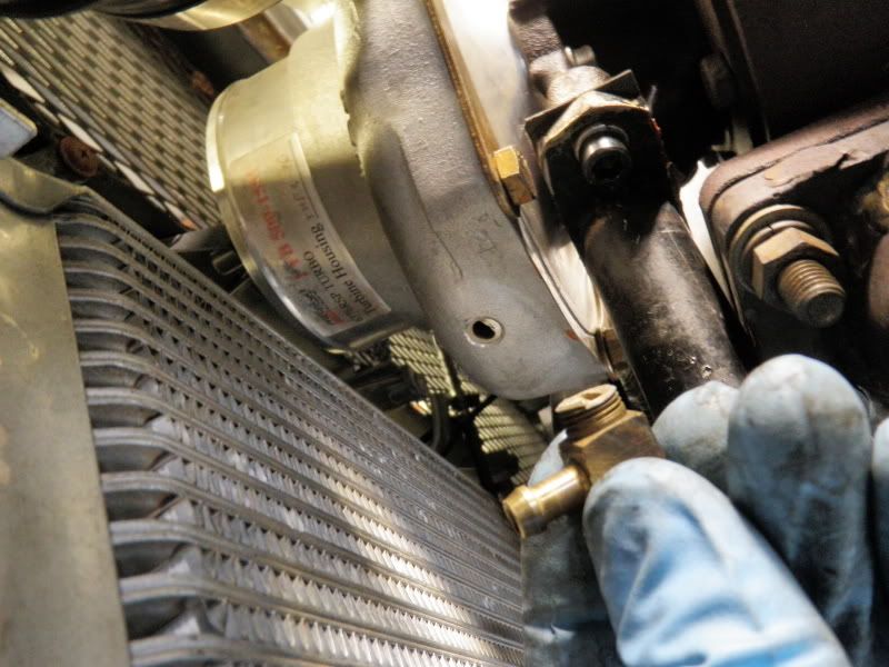

was messing with the boost controller and broke this fitting...
so while the cold side housing was off fixing it i threw some paint at it to make it stand out /ubbthreads/images/graemlins/smile.gif

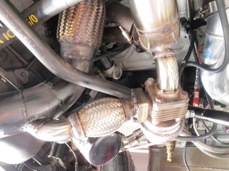

the old nasty exhaust manifold pipe that blew out at the track
got it all fixed up with some thick SS, even went a little larger pipe to help flow, also recirculated my wastegate while i was in there.

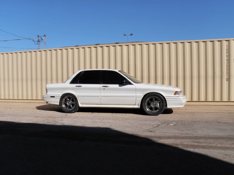

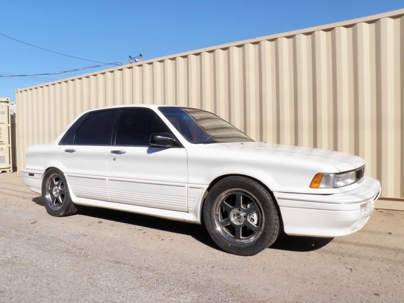

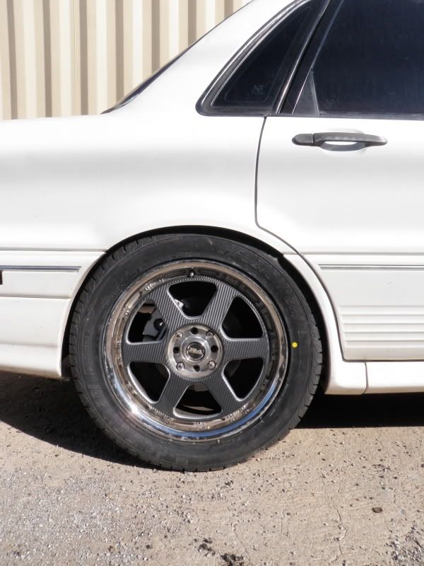

Finally got my new tires, old ones were 24.6, these are 26.1, that should help get my MPH back.
needless to say it fills the fender opening quite adequately

Love the new rims!what are those? and I cant wait to hear the new recirculated wastegate on that setup. when are you going back to the track? /ubbthreads/images/graemlins/devil.gif

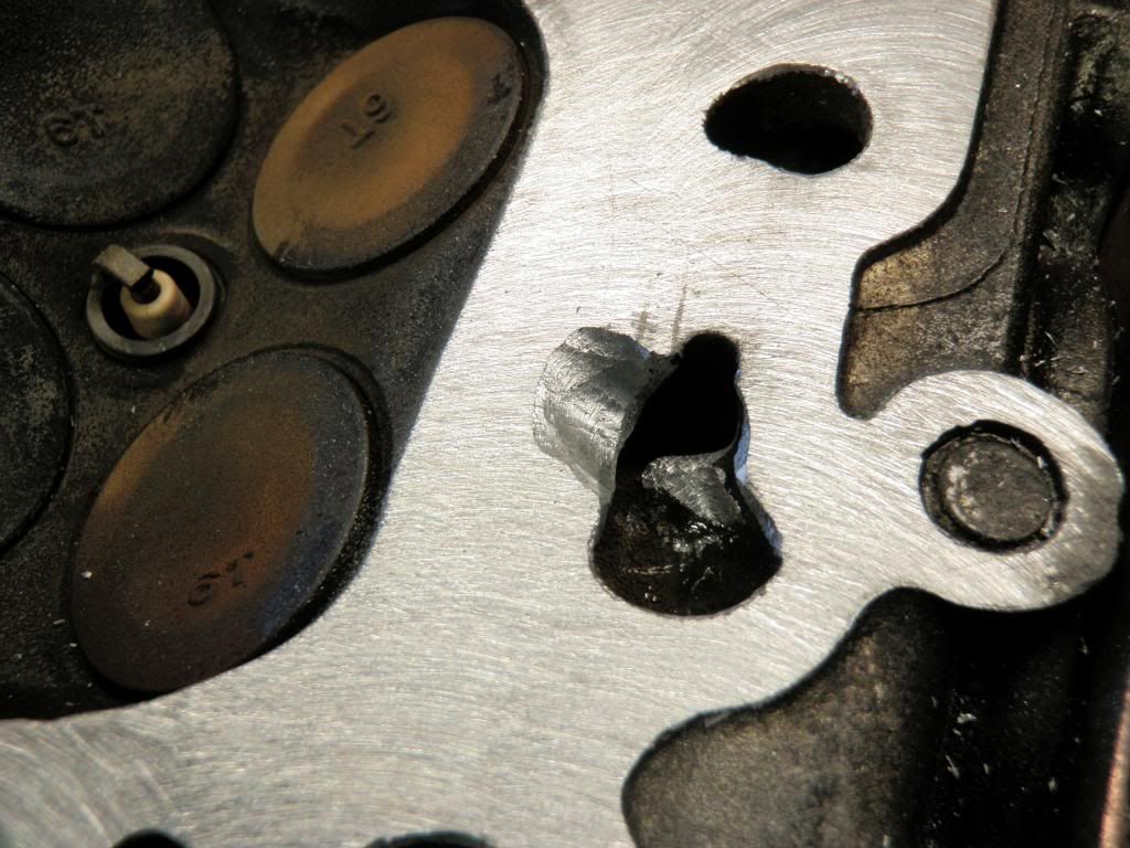

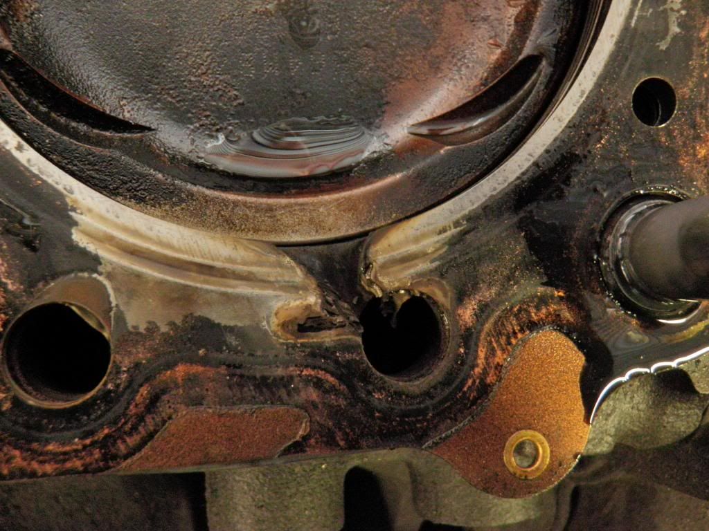

went out and did some tunning and got it running solid... then went and raced a 1000whp truck and got a got a solid win..... WHILE blowing a head gasket.
got it apart and man did i blow a gasket and torch the head in the process..
it wasn't that deep (forgot to take a before) this is cleaned out ready for welding.
Welded it back up thoroughly and re-decked it. Got a new expensive billy badass head gasket and did all the black magic tricks to all the stuff using all i have learned from the gurus to re-seal the head. I think its staying down this time.
Got a bunch of goodies im dong this week to be ready for 2k13 so its game time
