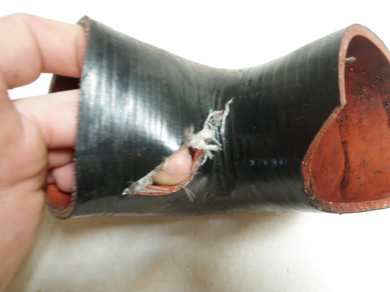

then here was my newest problem happened last saturday night... did a 3rd gear pull and went to hit 4th and had no power...
so gotta get a new one and should be back in business...

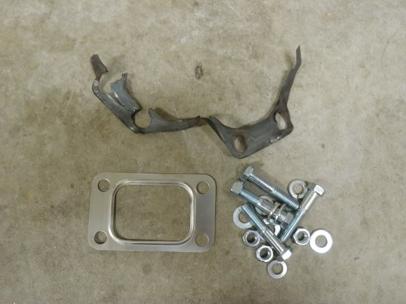

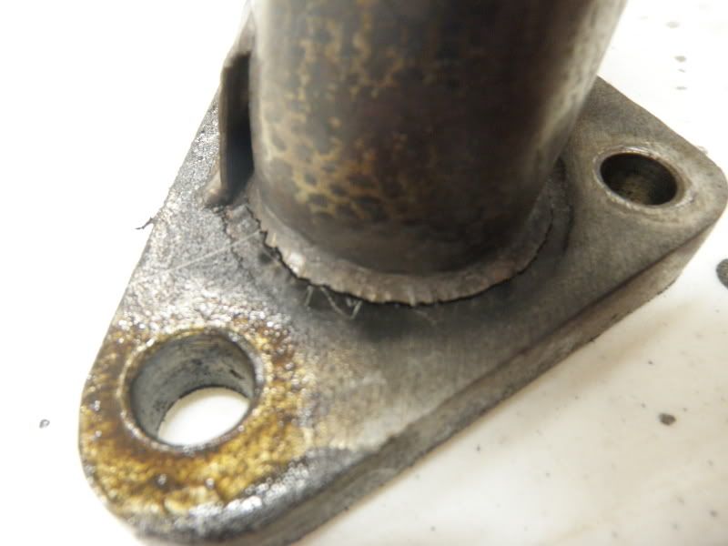

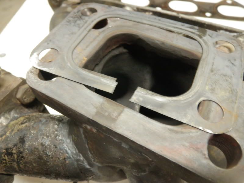

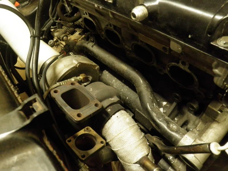

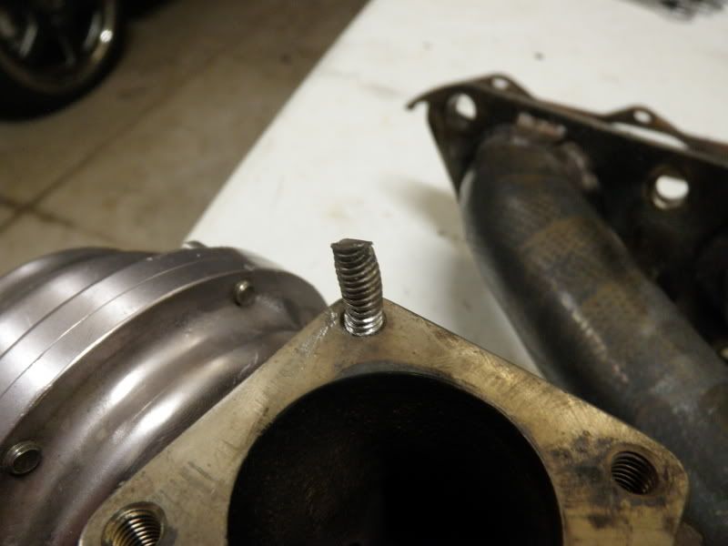

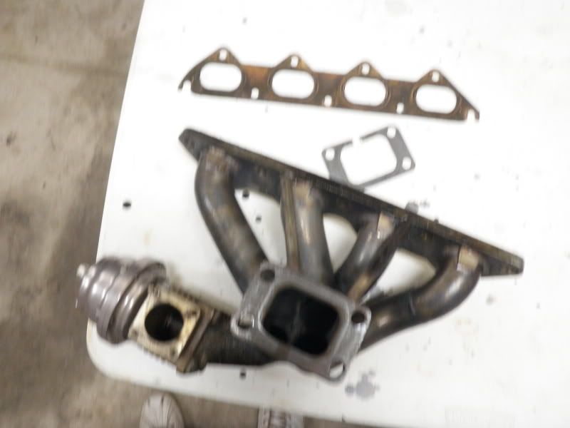

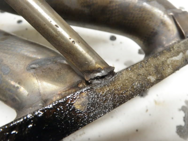

so had an exhaust leak from the last weekend out racing so i started investigating the source.
turns out there were a lot of them.
and just for added fun this bolt siezed up when i was trying to take it apart so i had to cut it off
so got em all welded up and back together for tonight and still have a huge exhaust leak coming from somewhere... awesome. LOL.

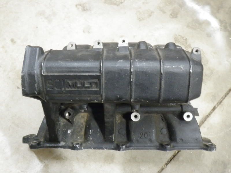

welp... decide to do some work on the ol' s###box. /ubbthreads/images/graemlins/smile.gif

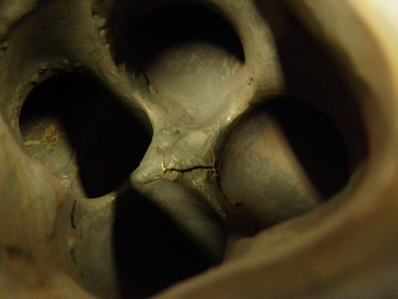

whats this... on just a factory manifold
ohhh no what happened /ubbthreads/images/graemlins/smile.gif

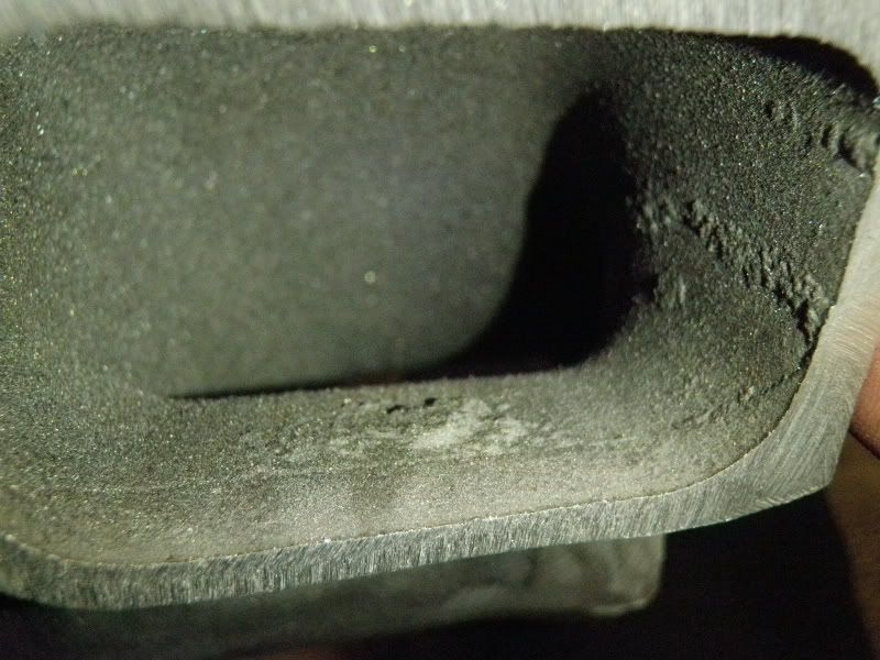

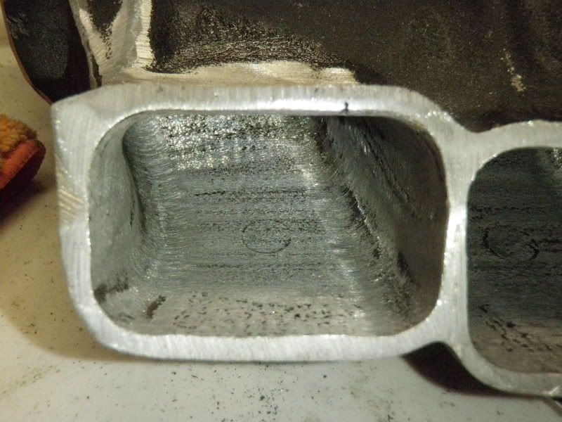

then spent some time cleaning up the runners...
before
after

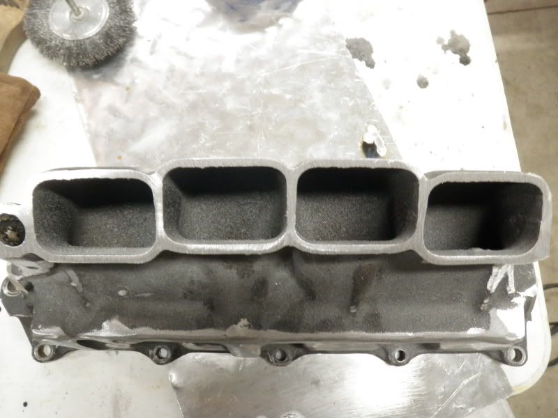

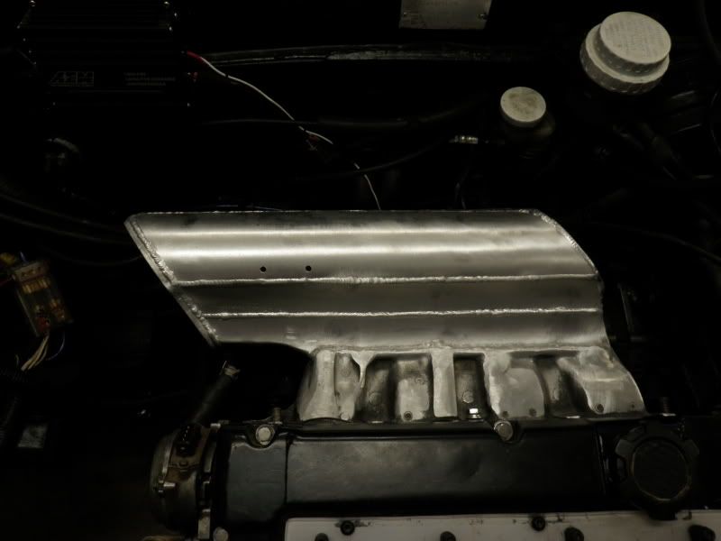

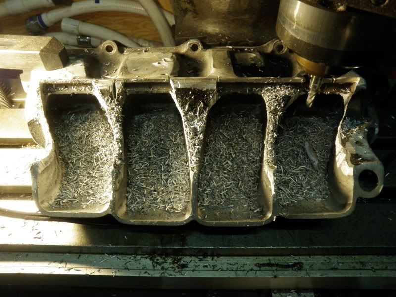

sorry for the really long time since my last update, i have been busy with a million other things but its not time to hit it hard on golfball, i got a tons of stuff in the works but here is an update on the new intake manifold.

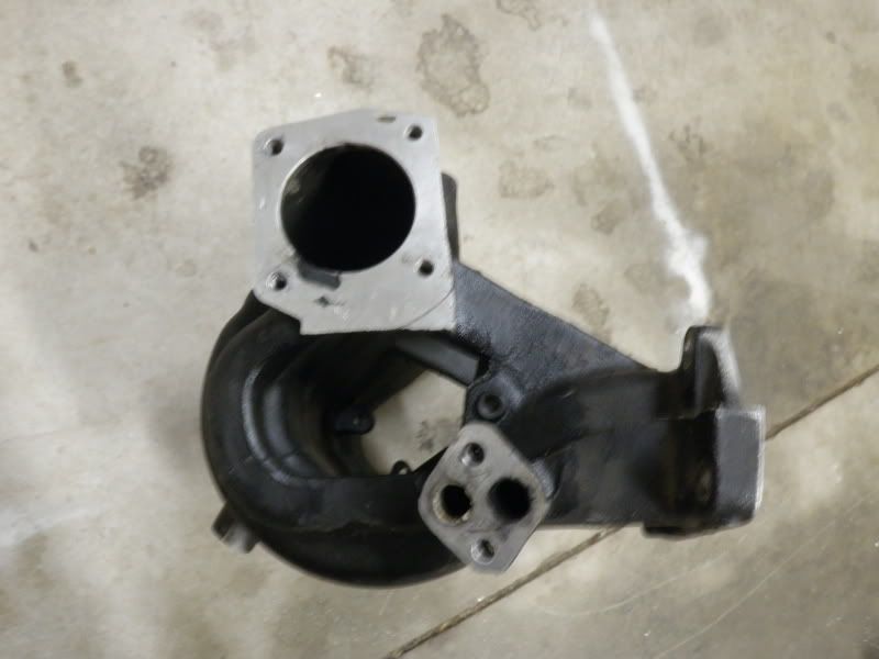

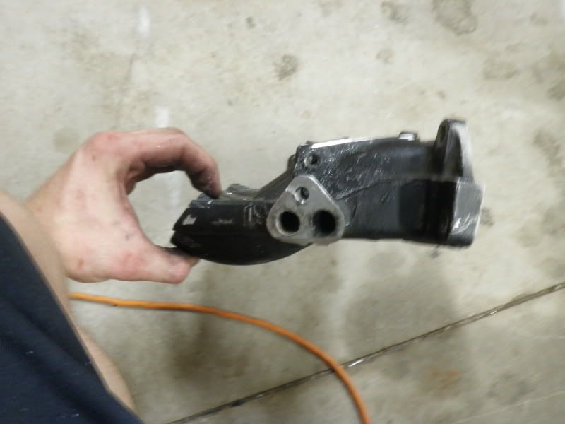

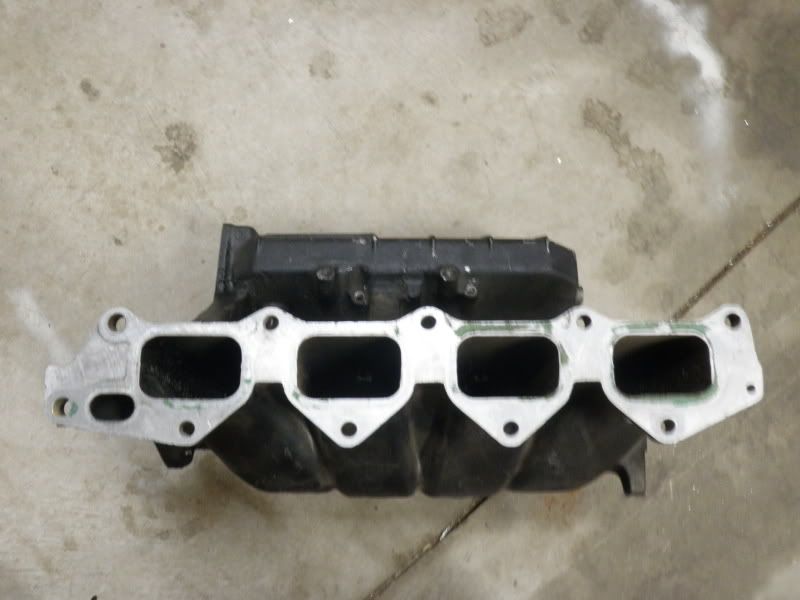

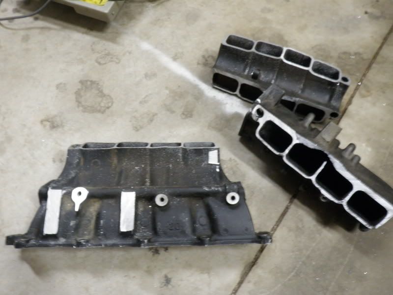

stared with a stock manifold

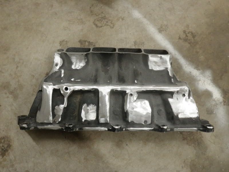

chopped off the runner
removed all the extra brackets and unsused sections

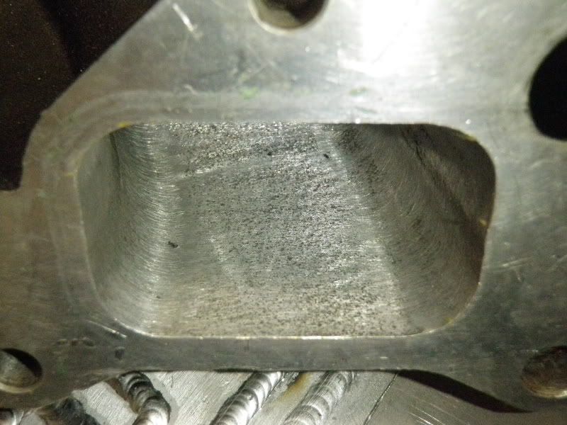

chopped out the the part where the runners gonna fit

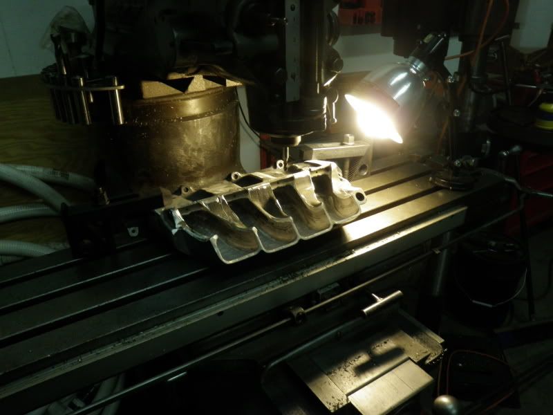

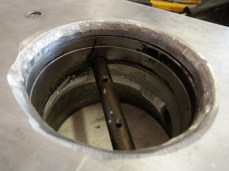

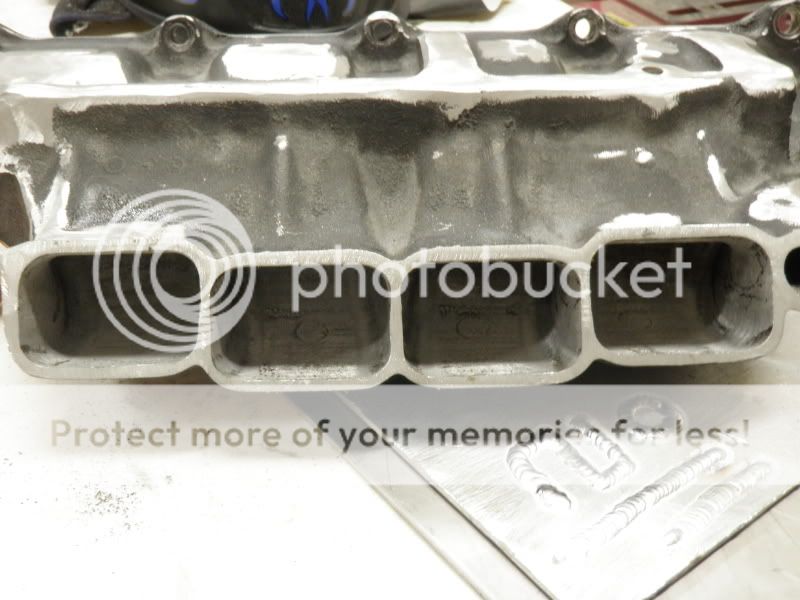

threw it on my bridgeport and machined it out a bit.

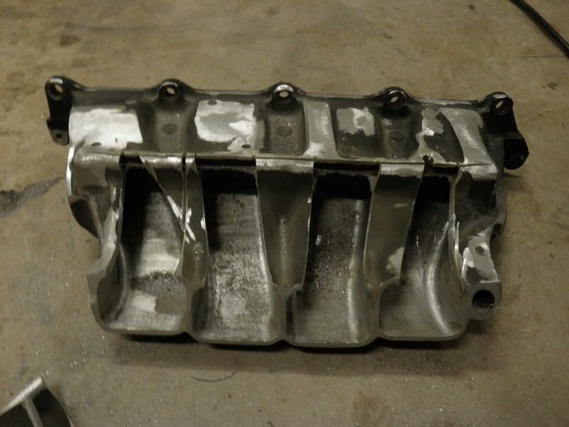

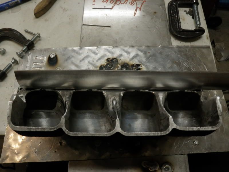

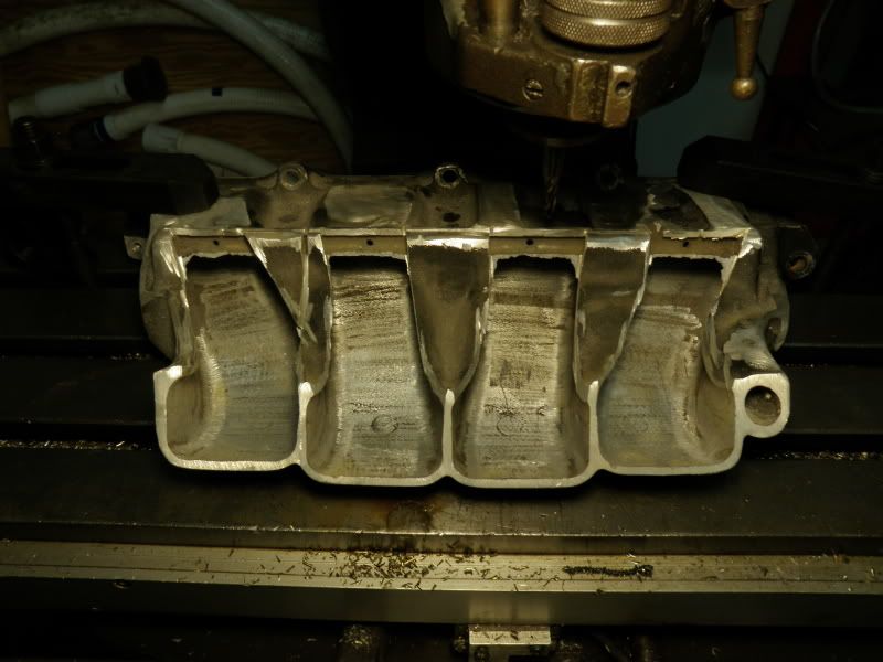

befor
after

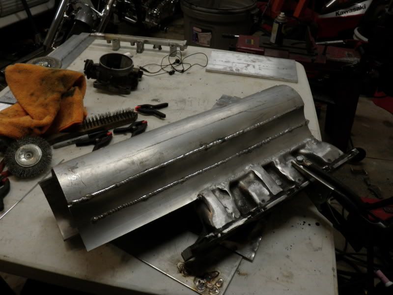

then started welding er up.

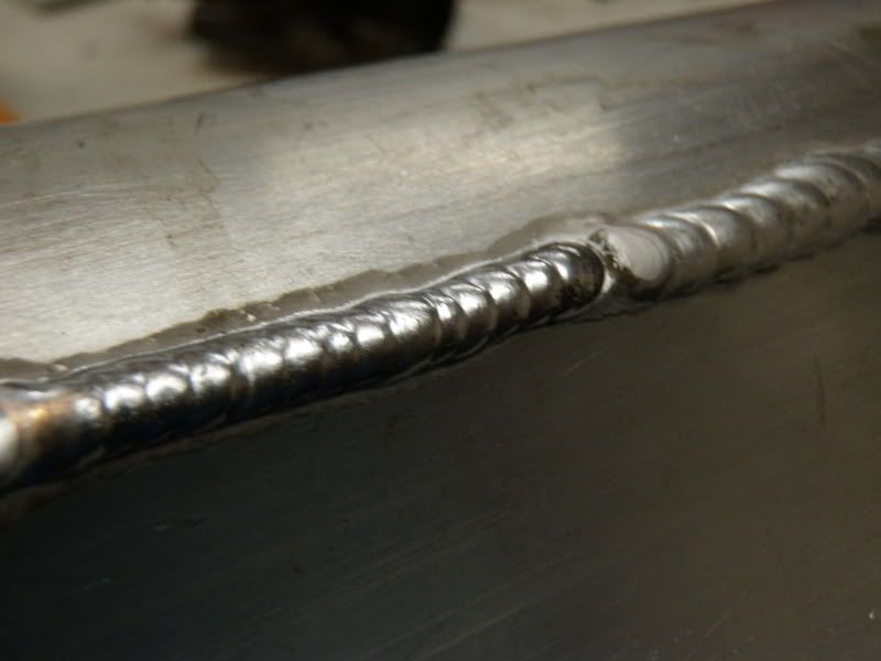

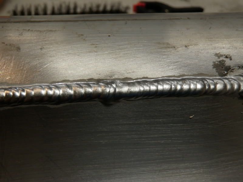

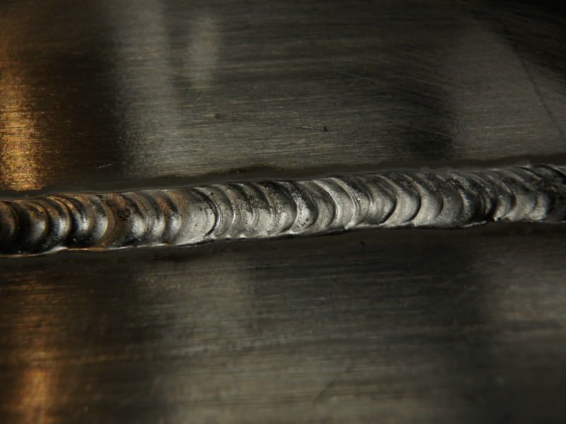

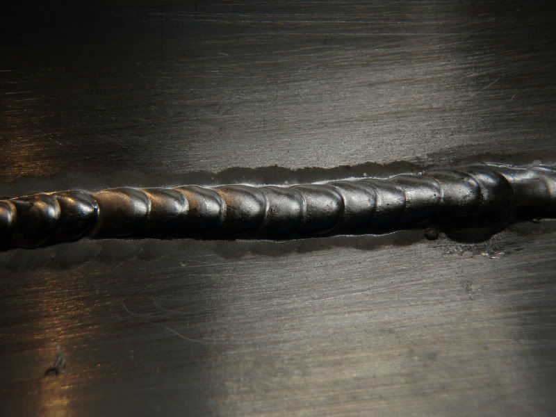

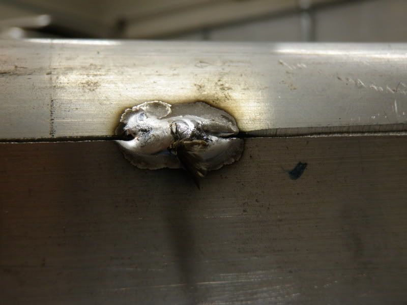

SIDE NOTE, i had a bug land in my bead as i was welding, teach me to weld a night with the garage door open lol
couple of weld close ups (have only been welding aluminum for about 2 weeks now so i got a lot to learn but its coming along pretty quick and im seeing great improvement every time i touch the torch.

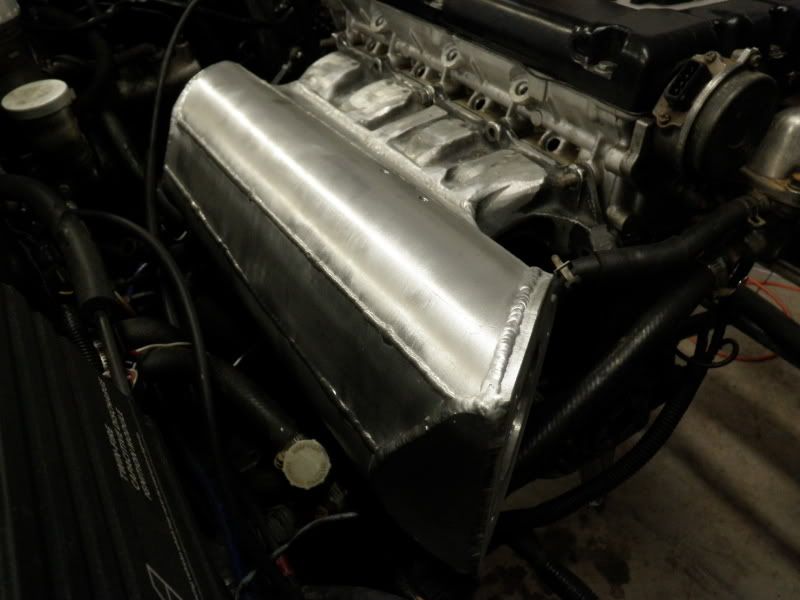

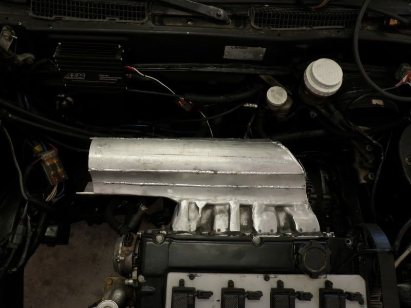

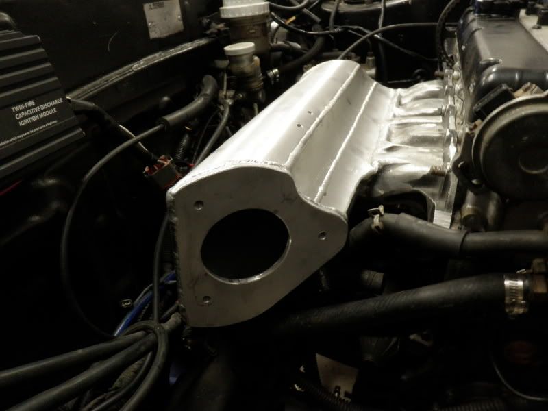

all put together.
on the car

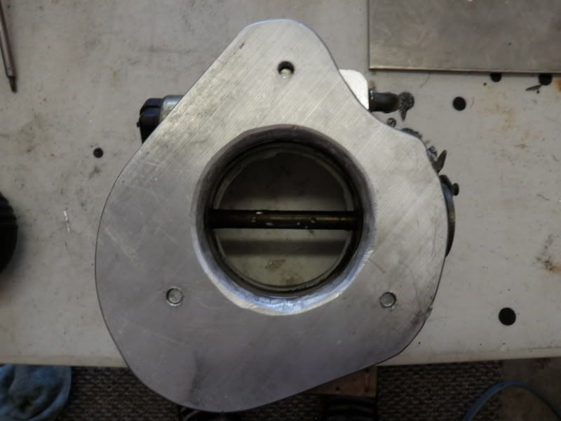

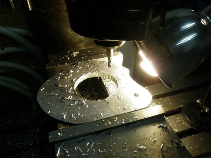

used my the mill to make a throttle body flange to couple it to a 76 mm GM throttle body
Some finished pictures

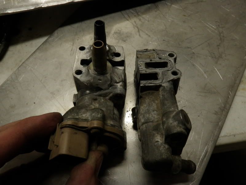

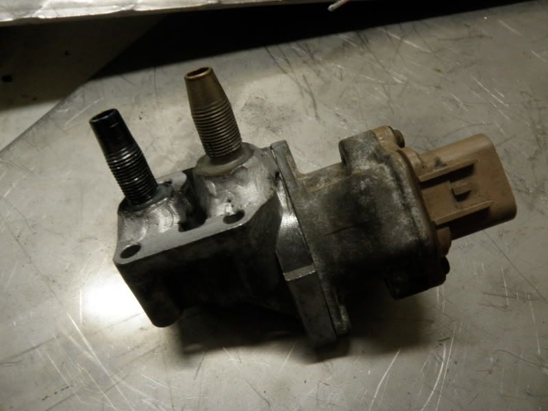

then lastly something im very excited about and could potentially be a great idea for production, i used my stock Mitsubishi throttle body and chopped off the idle control motor to make a remote mount throttle control unit that will plug into my stock wiring harness but still allow me to use the larger 76 MM GM TB.
stay tuned because there should be A LOT of updates to follow.
