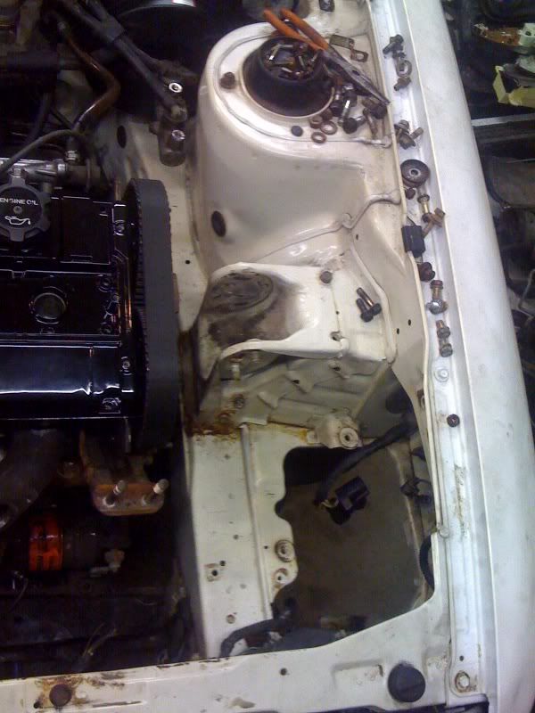

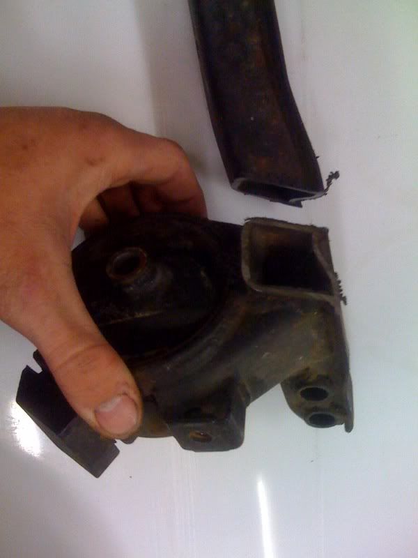

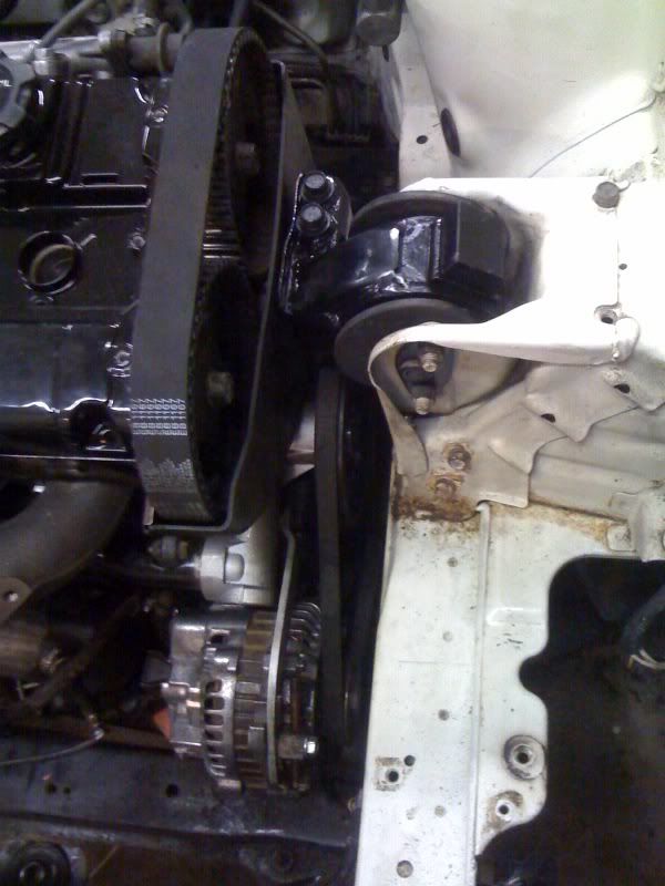

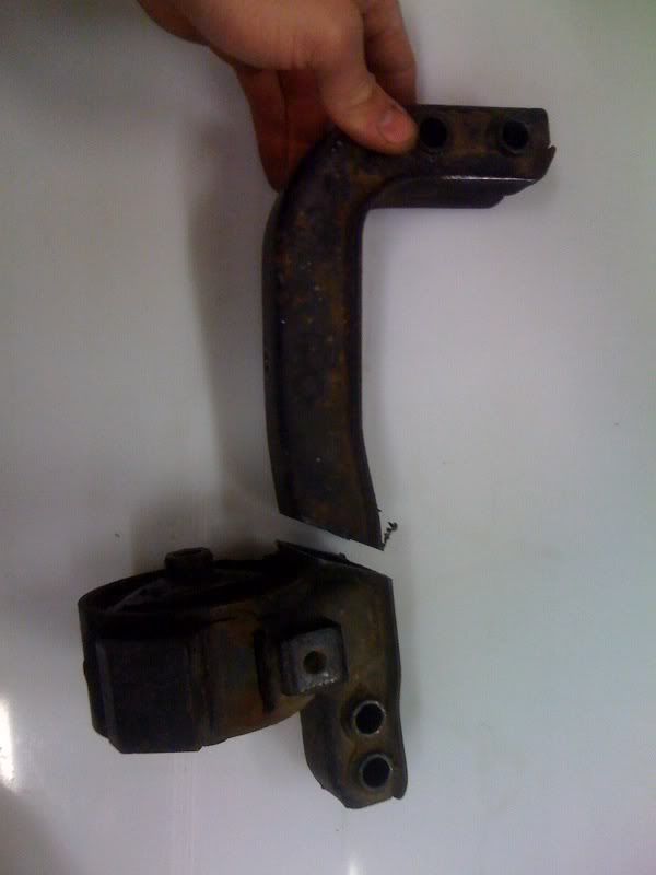

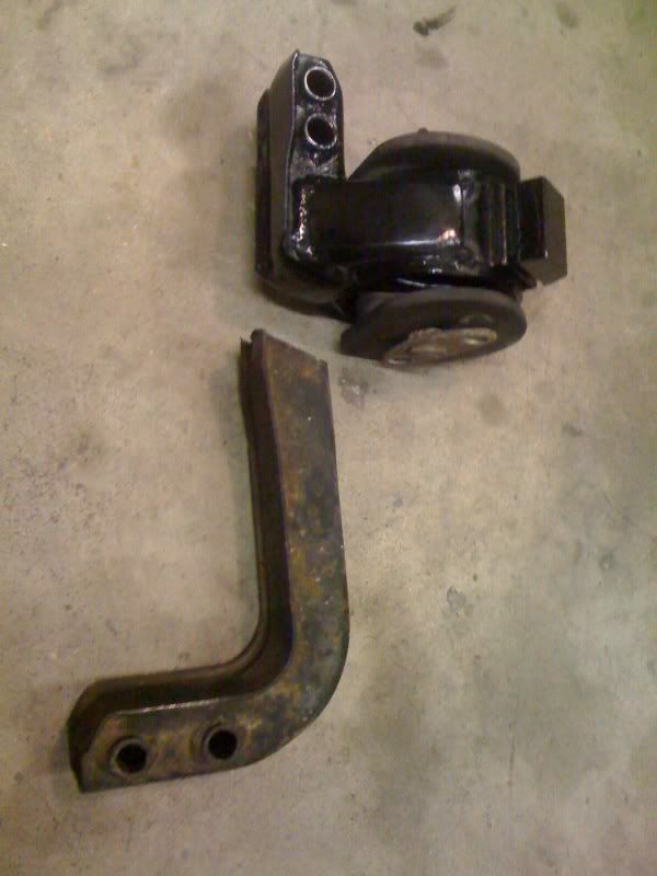

chopped the motor mount down.... looks wayyy better....

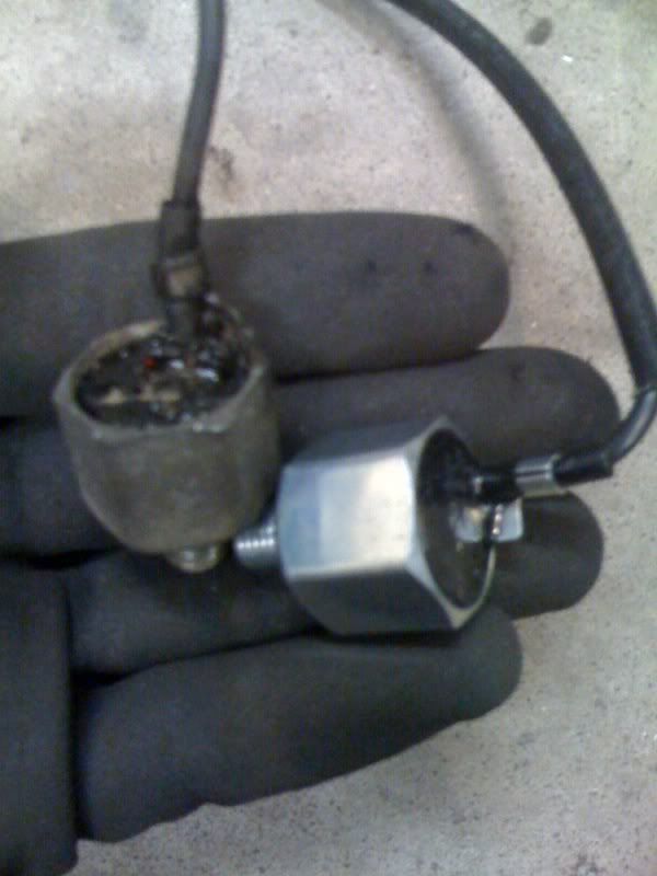

New knock sensor

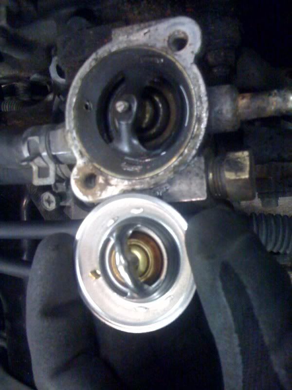

new "race" low temp thermo.... 160 instead of 190

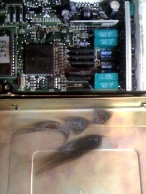

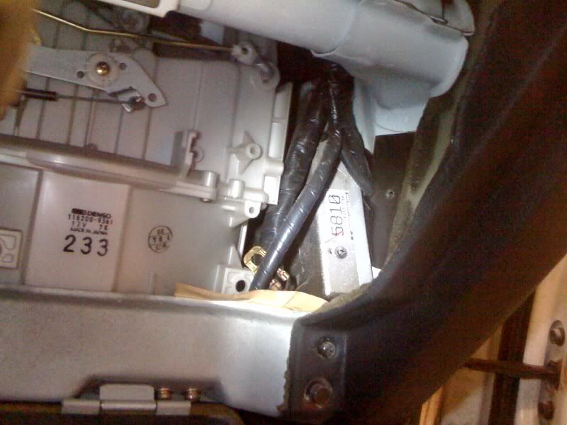

thanks to mitshu for making the ecu very difficult to get to.... /ubbthreads/images/graemlins/smile.gif
finally got it out.. good thing too the stock ecu has some burnt circuits....

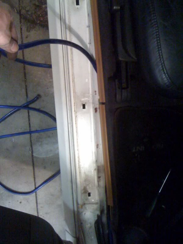

also got my battery cable run from the bay to the trunk....

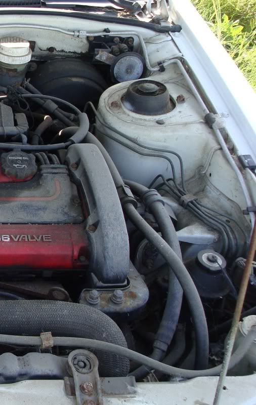

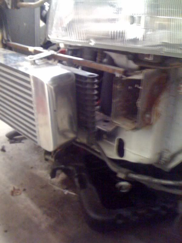

here is the before
and after... (no abs, power steering, ac system)

I can get the ECU out in 2-3 mins. You don't go through the front, you get it from underneath.

especially since below temp (can't remember what the temp is exactly d'oh) the ecu pulls timing much in the same way it does when it gets too hot.
11,993
Anything under 180degrees and the ecu is still in warm-up mode. I would suggest the stock thermostat for better fuel economy and power. There is zero reason to run the lower temp thermostat in a car that has properly working fans and radiator.
And yeah, the ecu comes out super easy from underneath. One bolt and one nut and the thing slides out with ease.

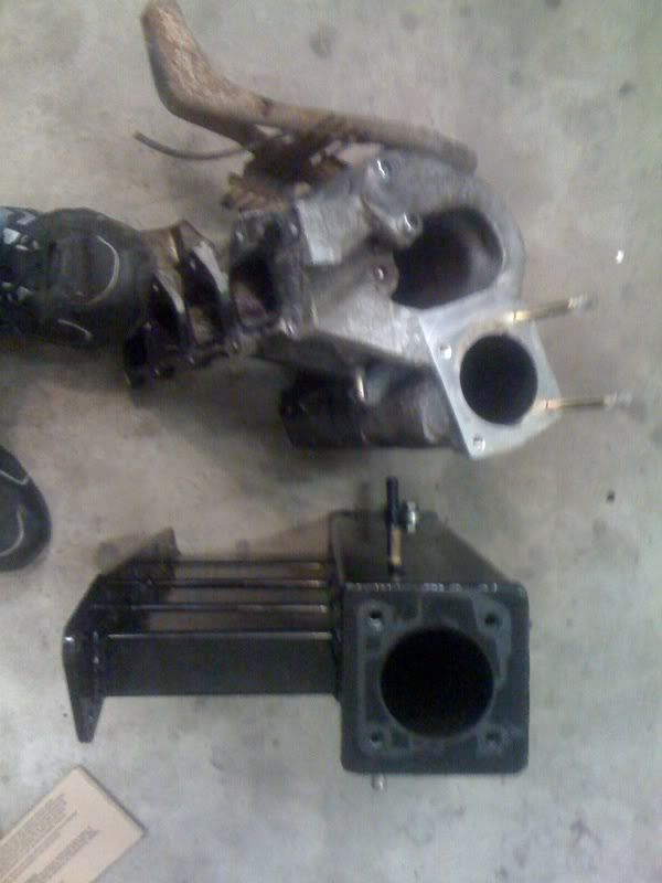

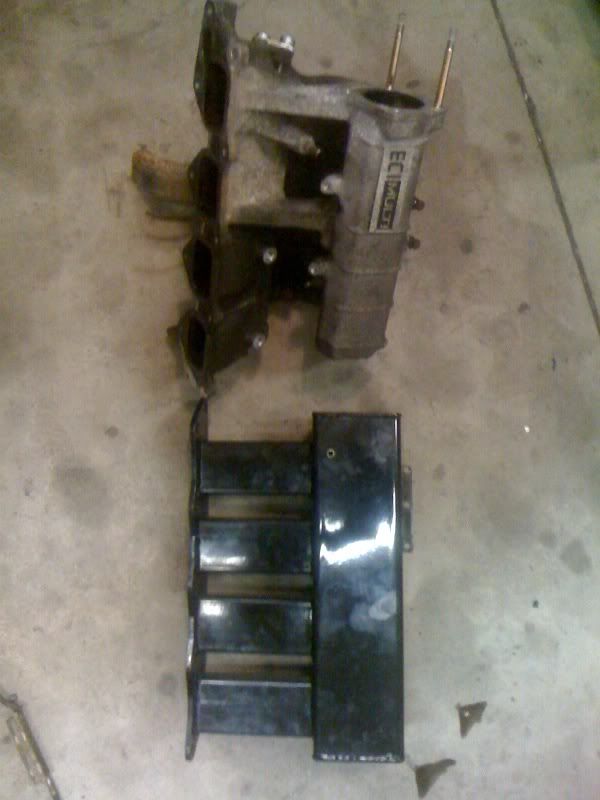

What's with the super thin flange on that intake? Hope it doesn't leak. /ubbthreads/images/graemlins/uhh.gif

Yeah that wasn't worded right.... i was really pissed thinkin it was gonna suck balls looking at the ecu but once i popped the two bolts off and it practically fell out i felt stupid.
figured why not on the thermo.... if it runs wierd i will swap it back.... dont care about fuel economy and only running the half radiator so i wanna make sure it doesn't run to hot....
and not sure what flange your talking about on the intake?

I'm thinking he means the runner flange. The one that bolts to the head. They are usually pretty darn thick to prevent warping under the heat and leaking.
11,993
Quoting fastjetta:
It isn't just a fuel economy thing with the thermostat. What do you think you're going to gain by using the 160degree unit?
And yeah, I'm talking about the flange that bolts to the head.
You cant even start seeing the fuel trims change until about the 180 mark. You are goin to end up chasing your tail trying to tune the thing.

yeah if it acts funny i will just swap it back out.... no biggie...

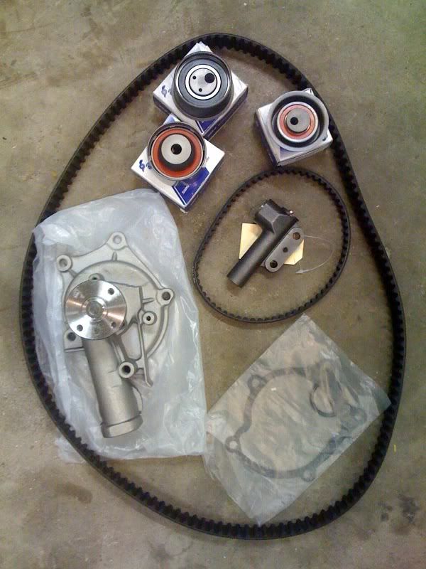

yeah i know, i know.... just did the new belt and tensioner since it came with the kit....
then stage 2 build i will yank those out... just didn't work out to remove them this time.

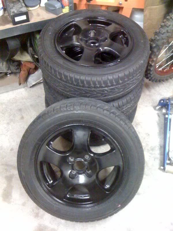

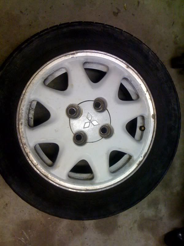

got me some new wheels.... OH WAIT the douche told me they where 4x114.3 and there 4x100....
so i guess these are staying.... thinkin there gonna get blacked out though....

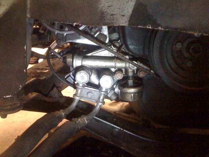

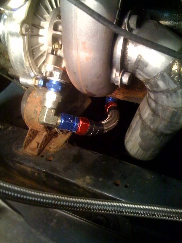

got my new oil filter housing and oil cooler mounted up....

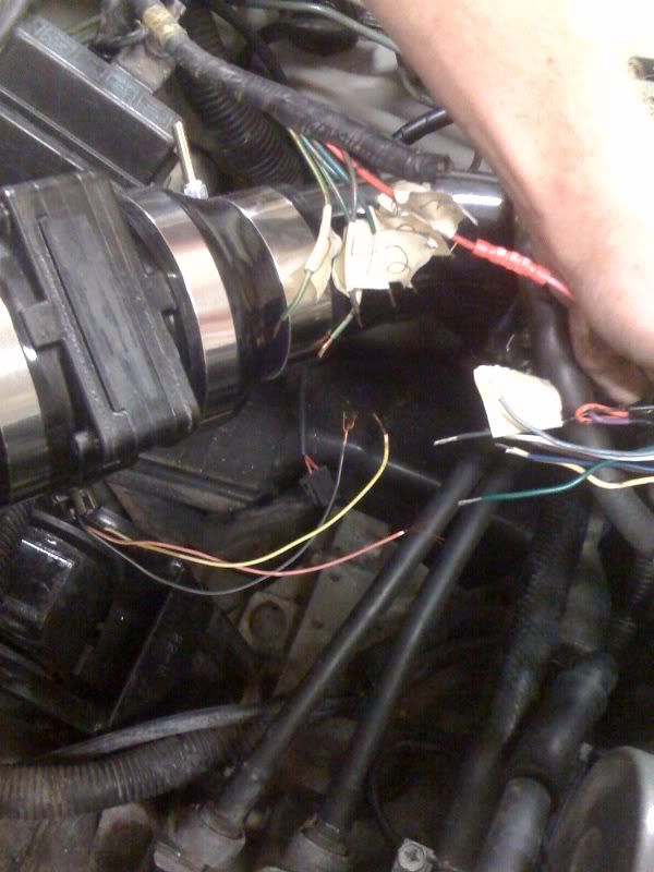

now im stuck with this damn wiring mess..... 3"gm maf, gen2 maf translator and stock wiring.... BLAHHH

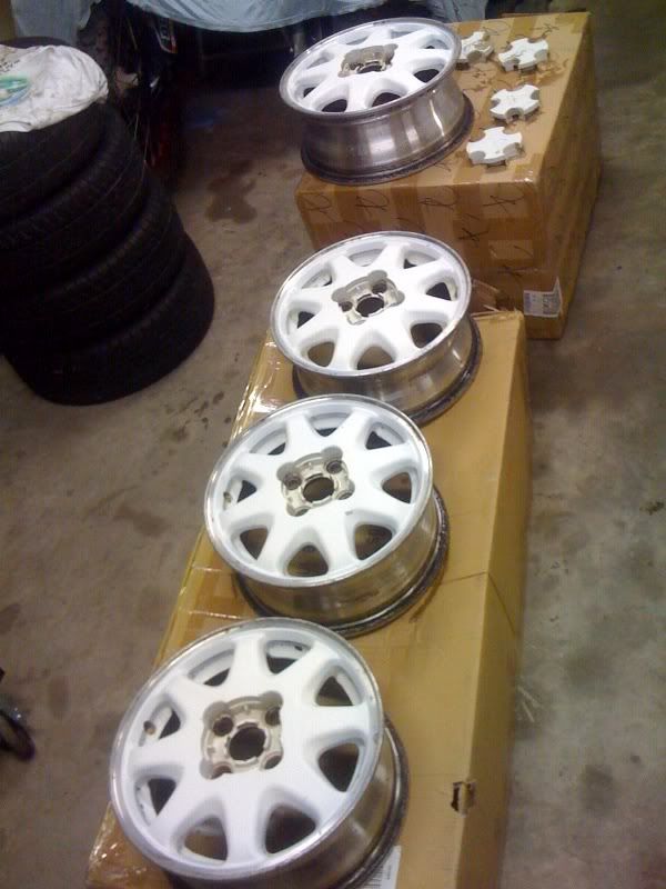

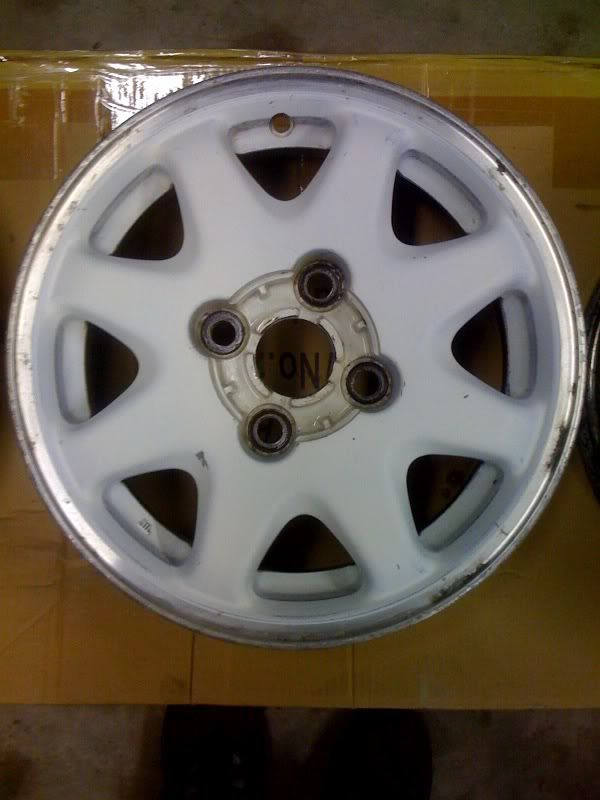

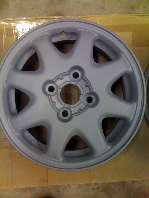

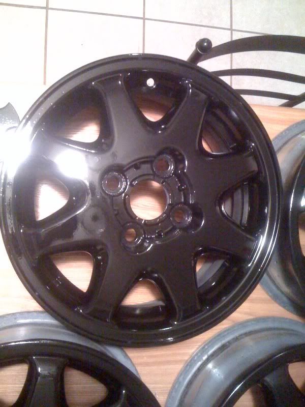

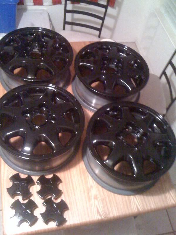

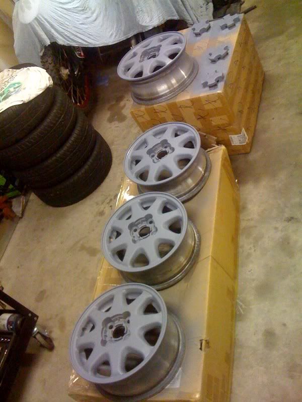

welp since the dude sold me the wrong sized wheels.... im just gonna take the tires off em and put them on the stock snowflake wheels....
to make em look good.... did a little painting....
cleaned and prepped....
3 coats of primer....
3 coats of base and then 4 coats of clear.... and whammy, shiny new wheels.
they look pretty good, gotta let em cure overnight and might wetsand and polish tomm just for fun...
