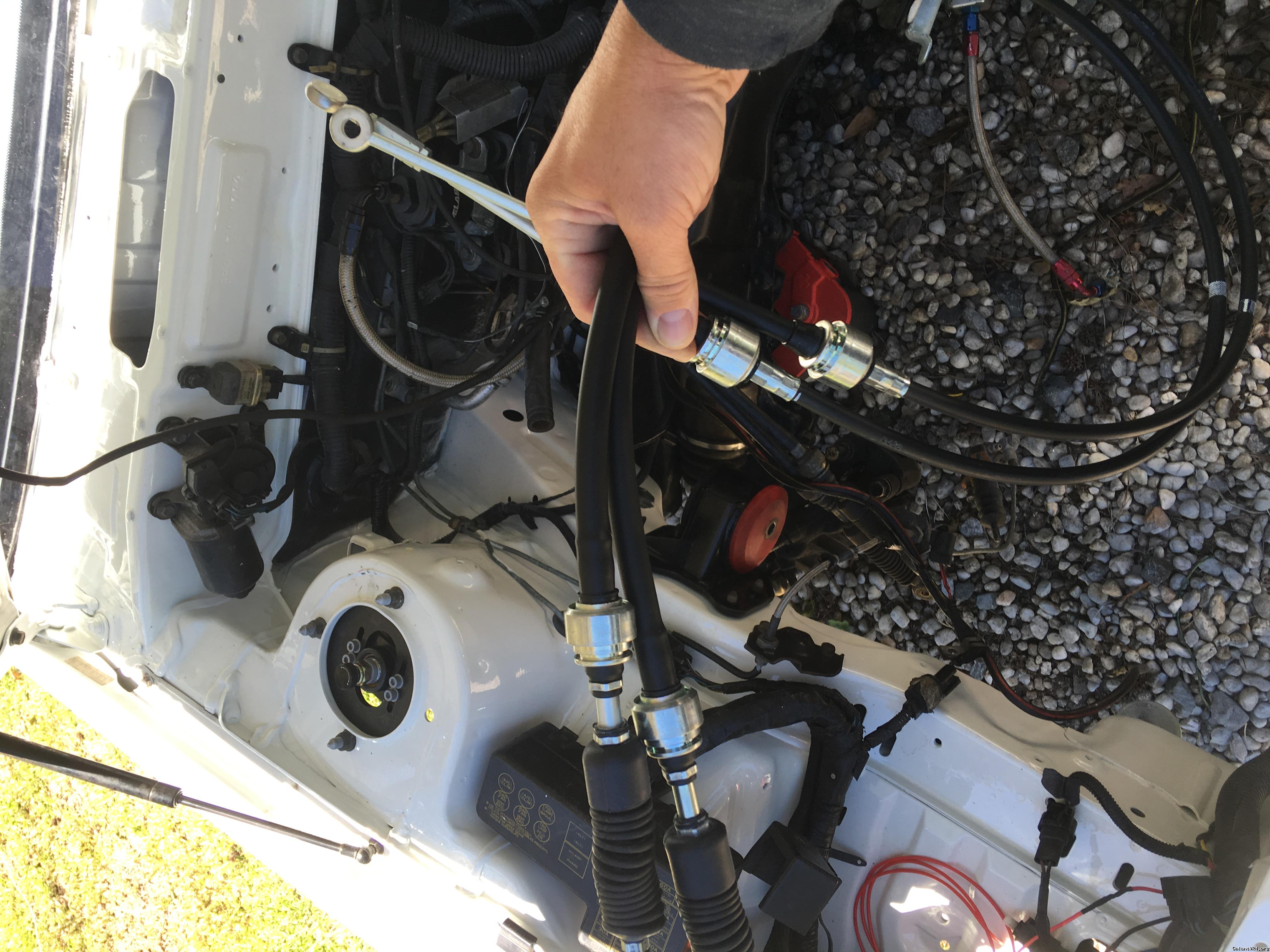

New shifter cables:

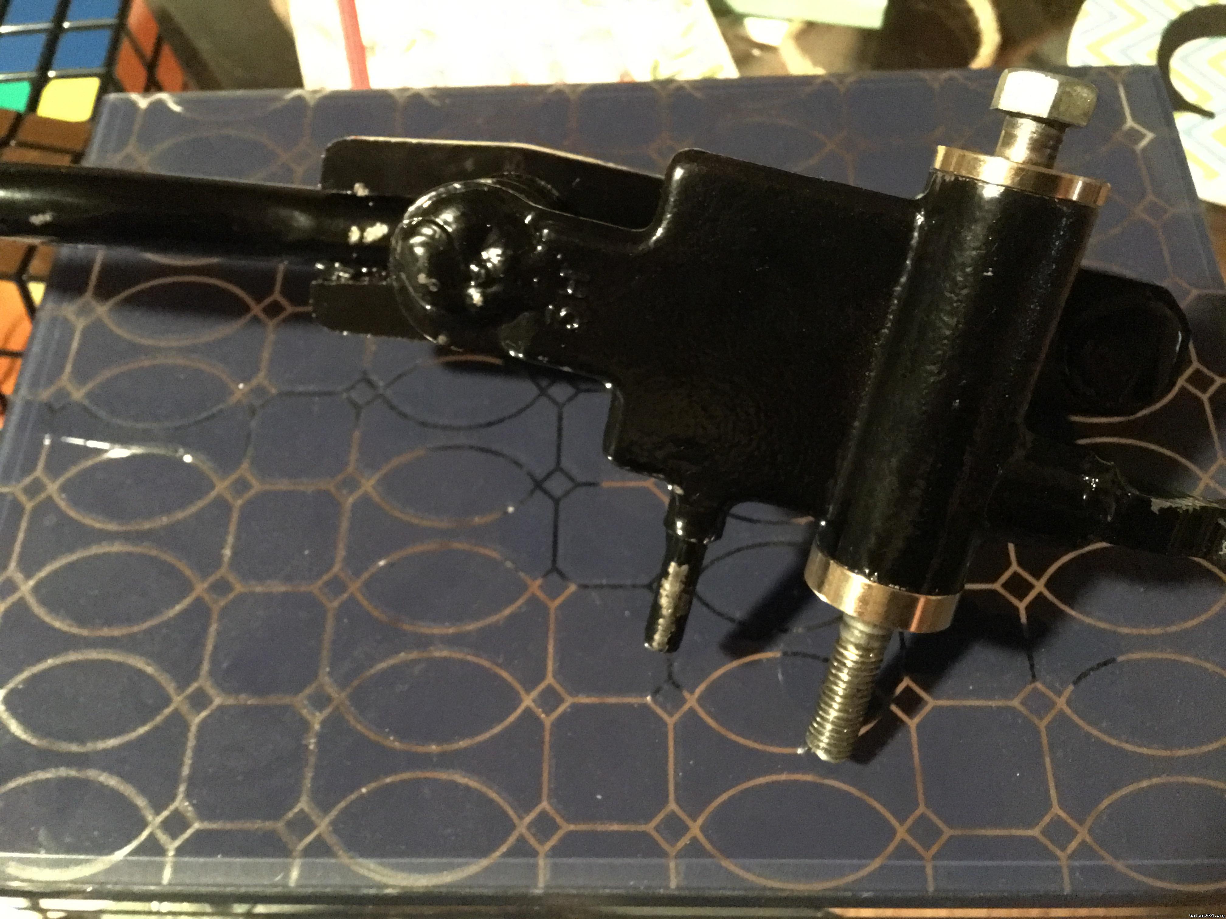

Custom shifter bushings for the 3KGT shifter setup:

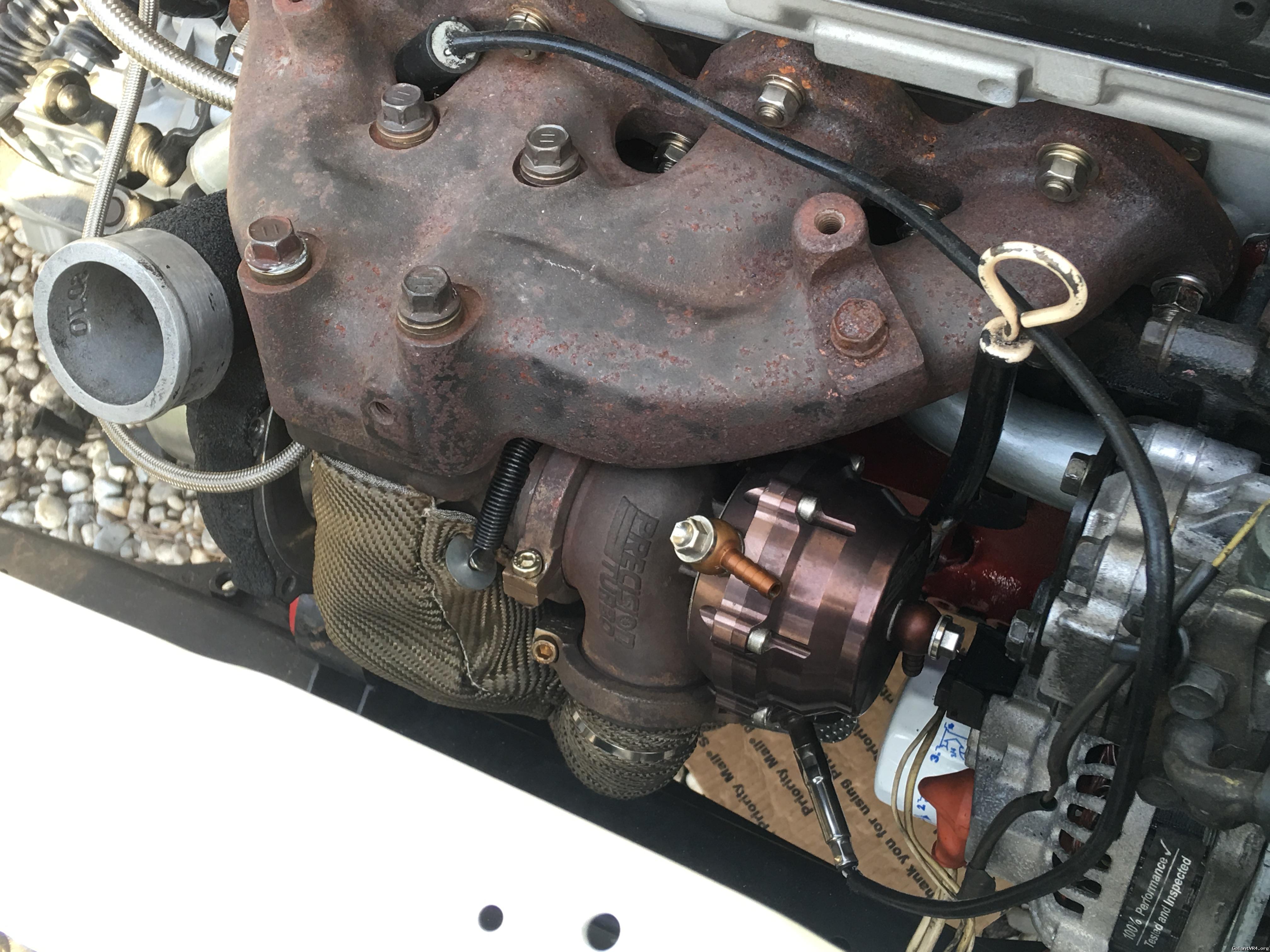

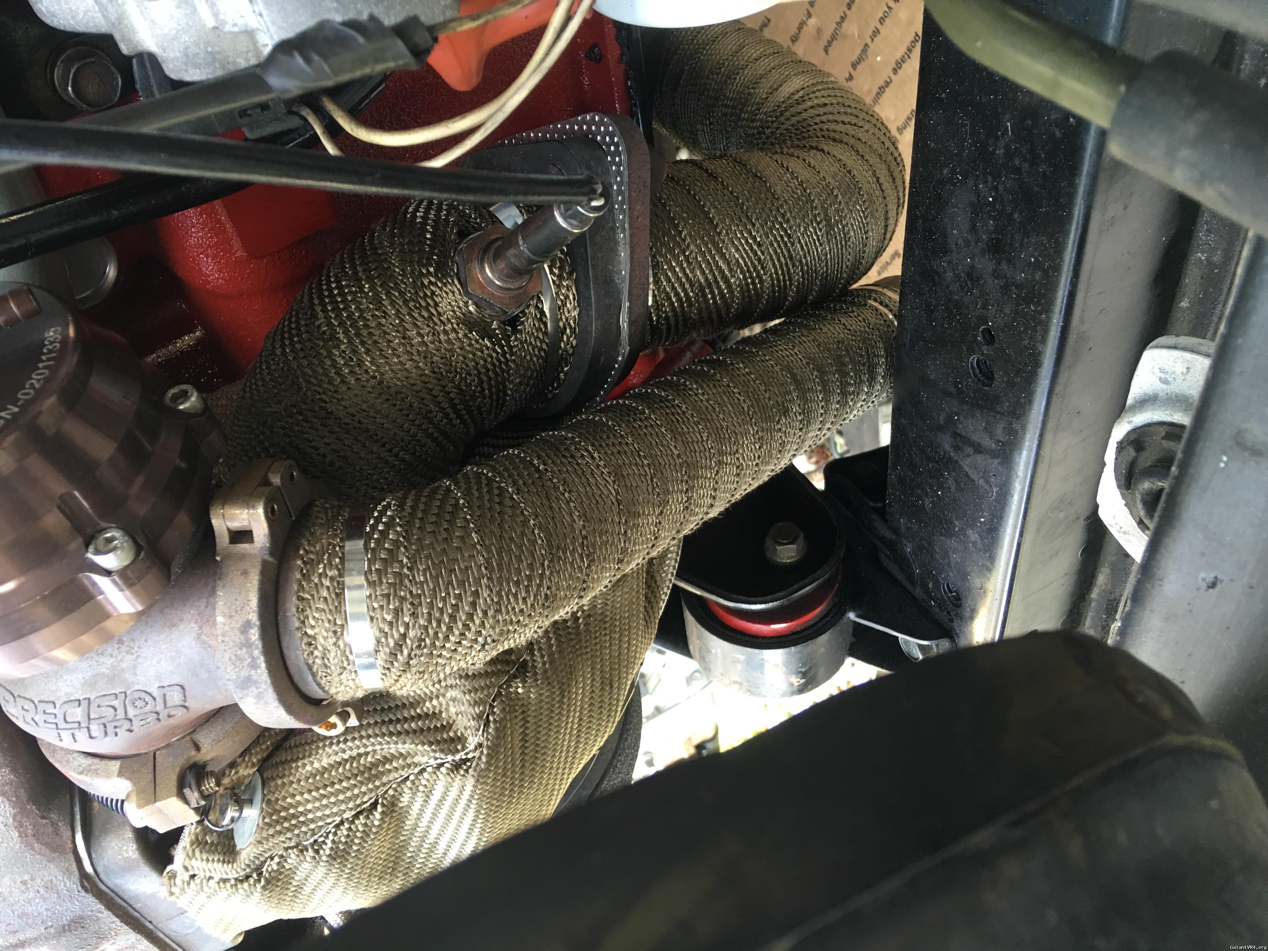

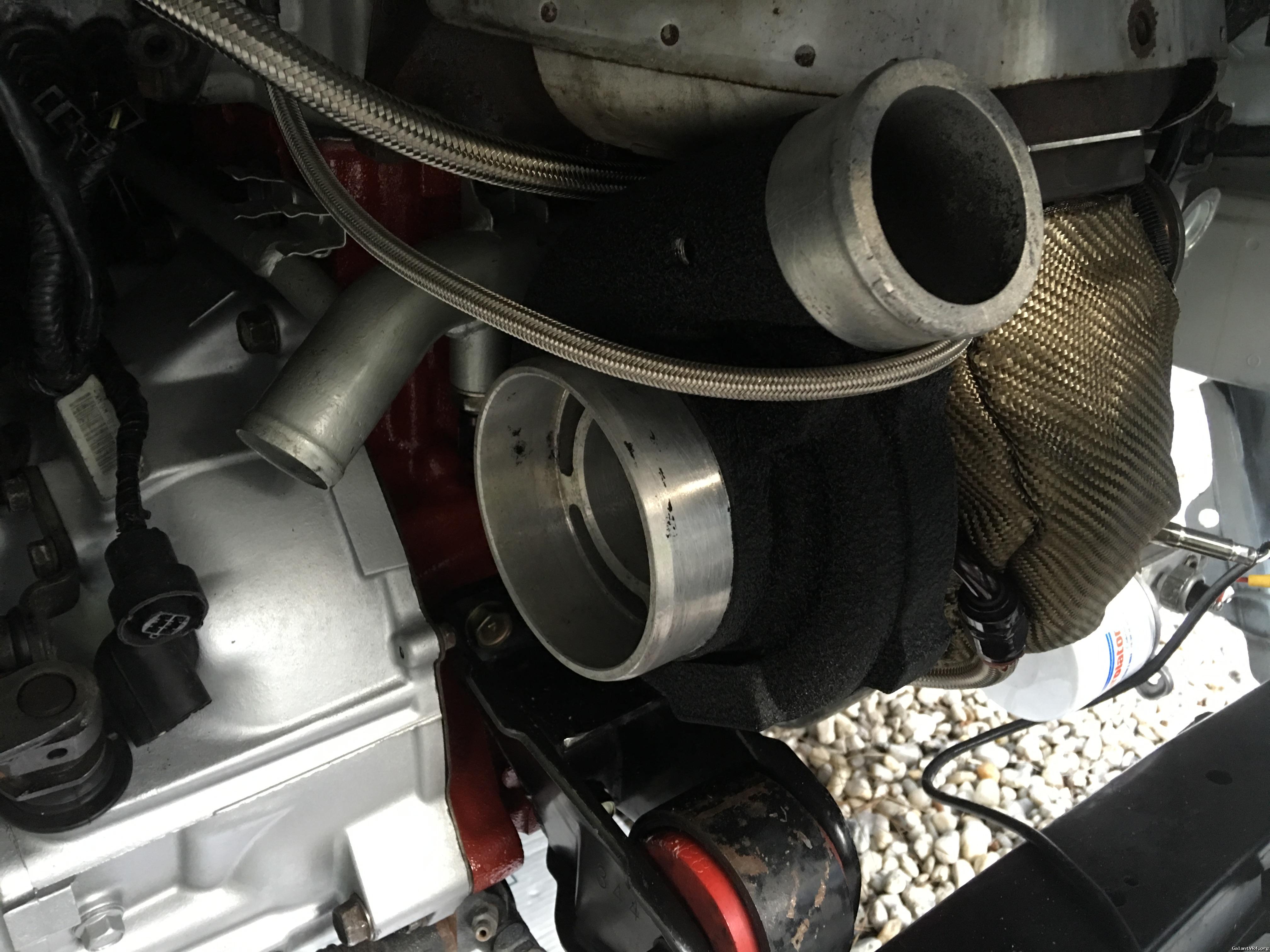

Exhaust wrap and turbo diaper in place:
Wrinkle finish for the compressor housing:

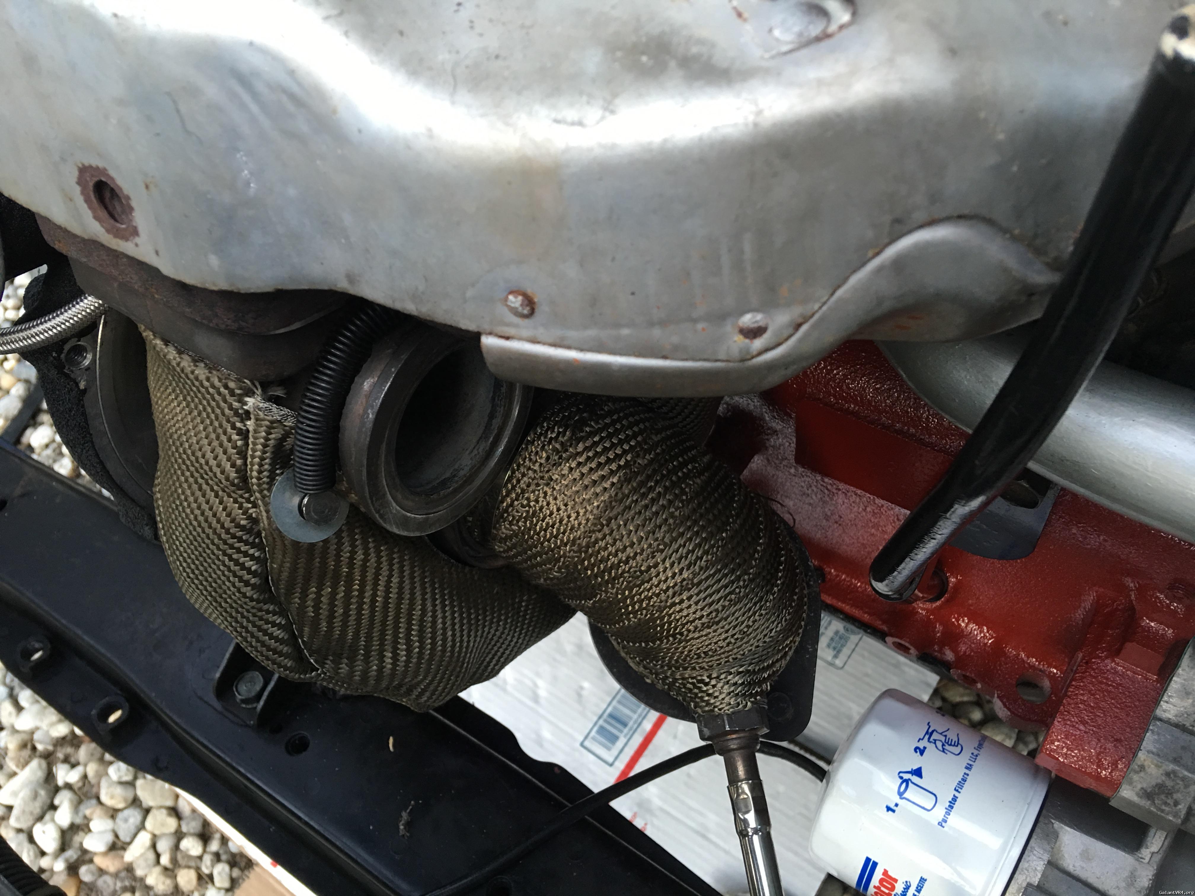

Wastegate in place and dump tube wrapped:
Wrapped the downpipe while I was at at:

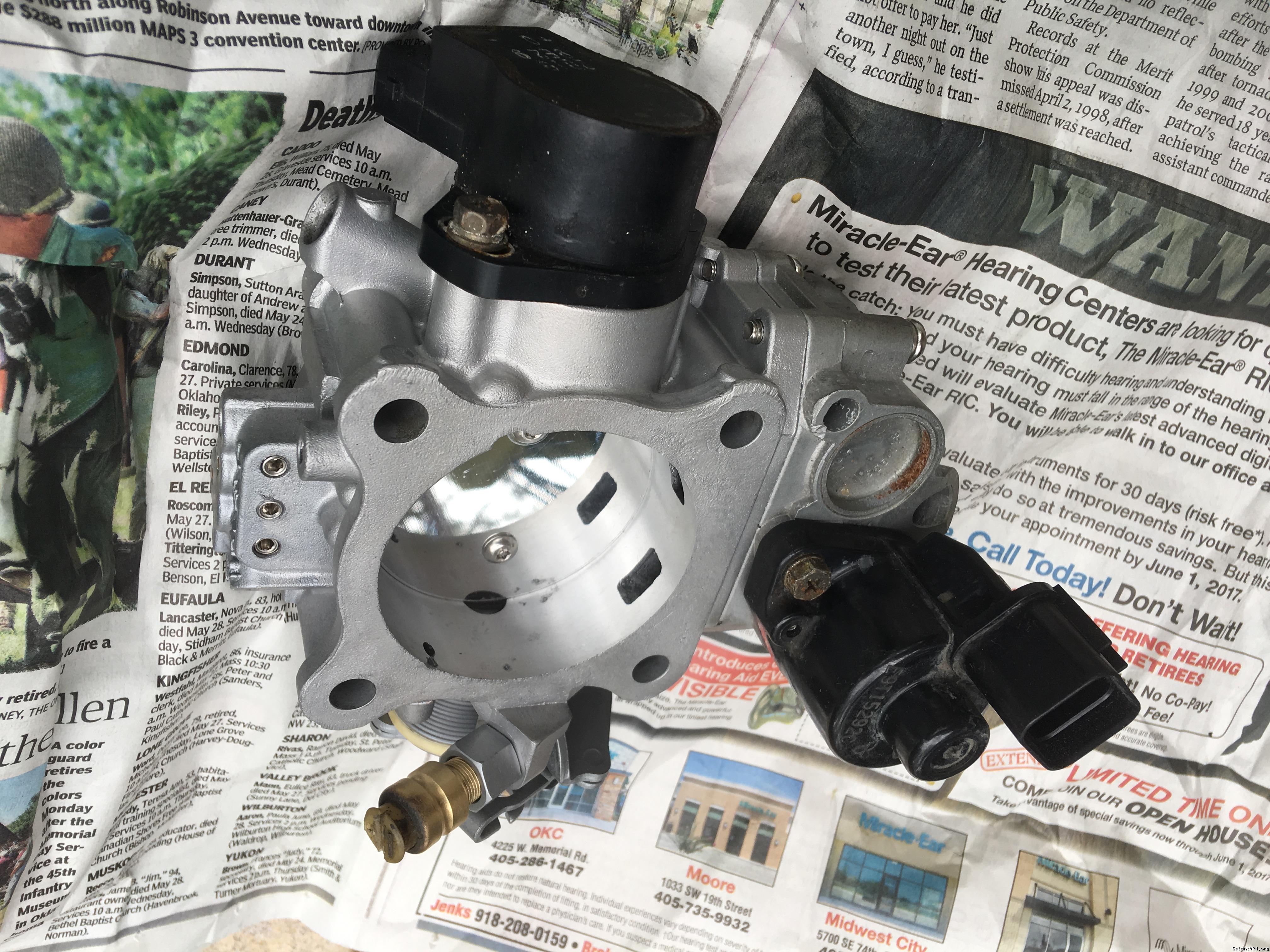

Rebuilt throttlebody with some custom touches /ubbthreads/images/graemlins/wink.gif:
Thanks to by buddy Jimmy for the machine work on the shifter bushings and for removing the FIAV junk on the throttlebody!

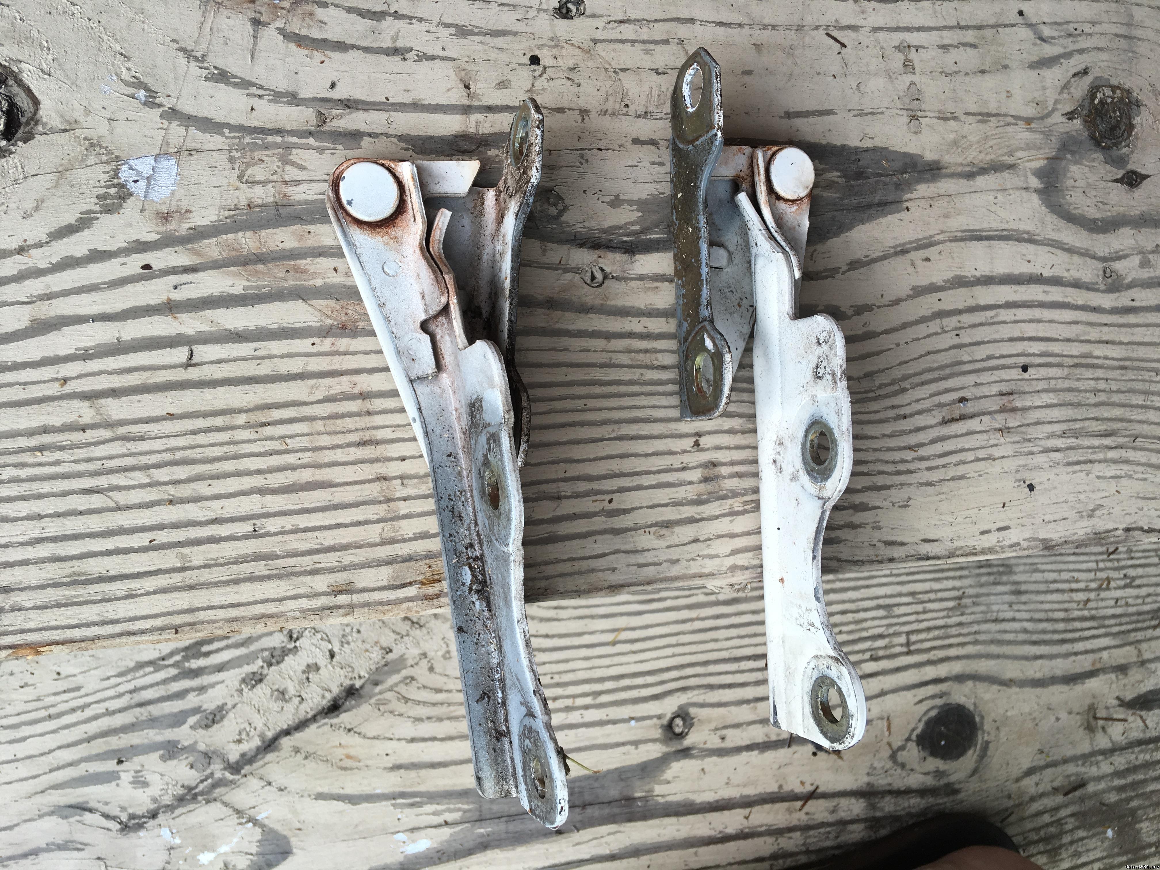

I recently replaced my hood hinges as well. I figured out a way to fix them though after I had them uninstalled. Just install a 5/8" c clip in the joint and it takes up the slack. spray a little oil or grease and they are as good as new.

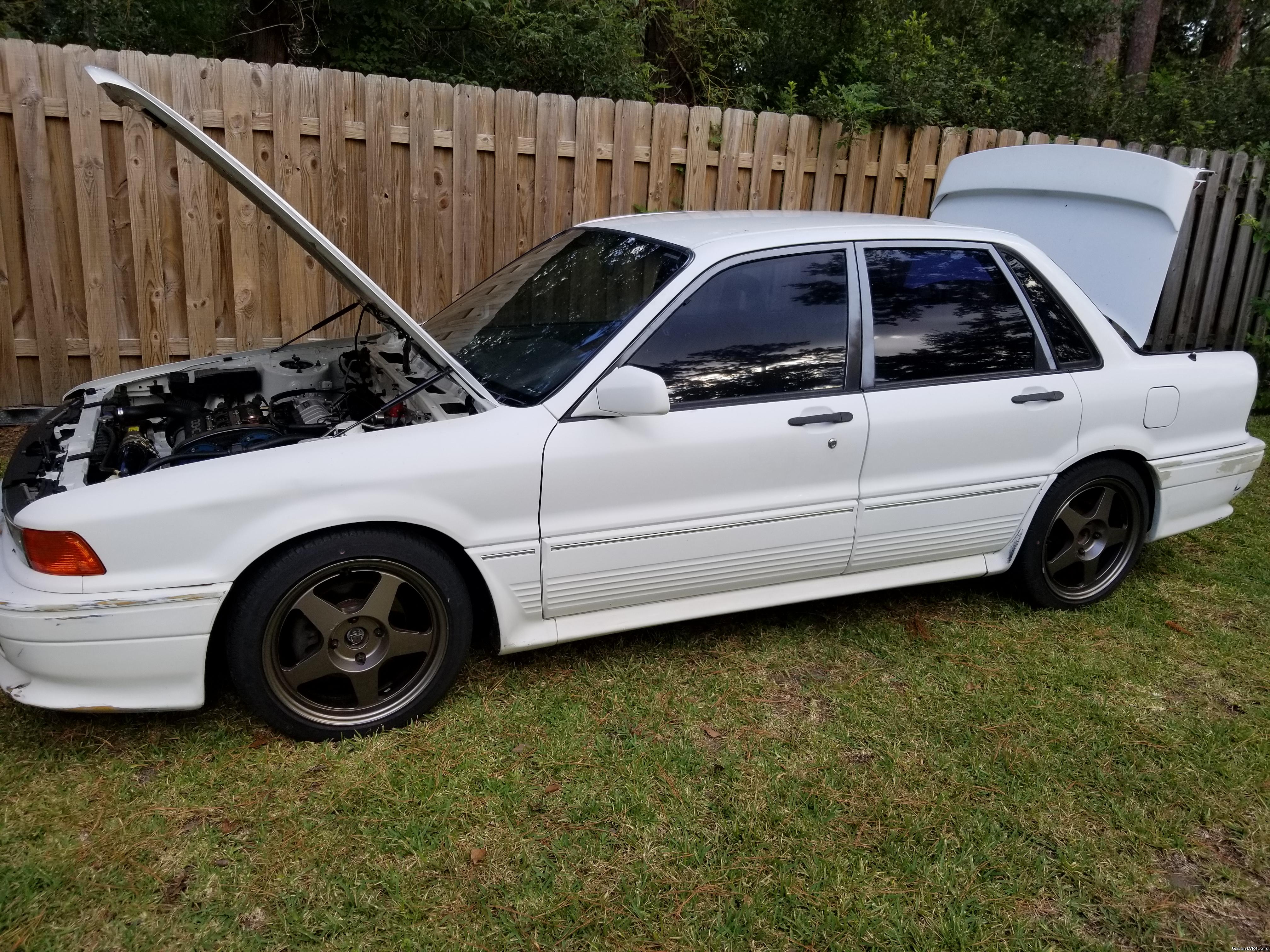

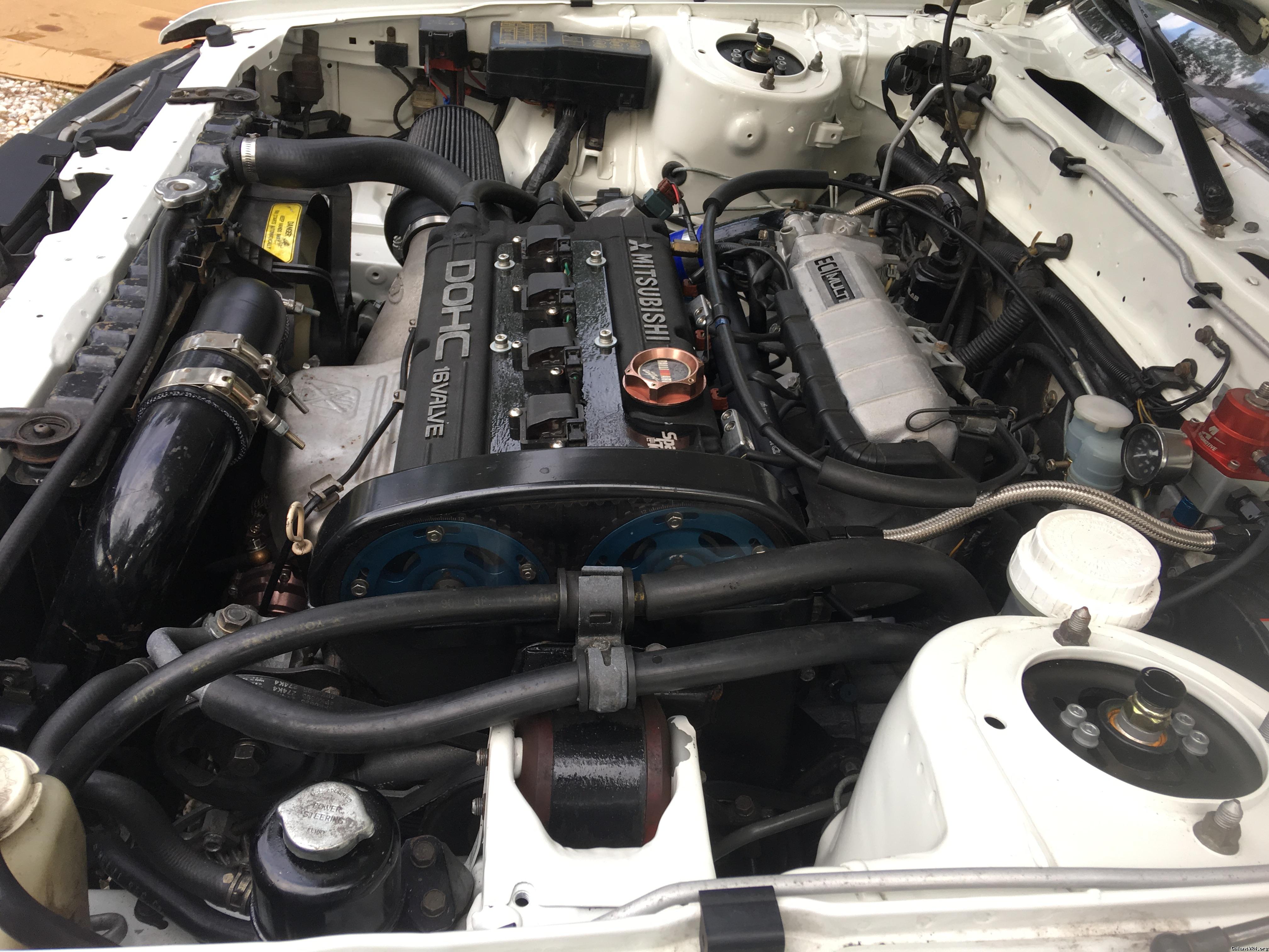

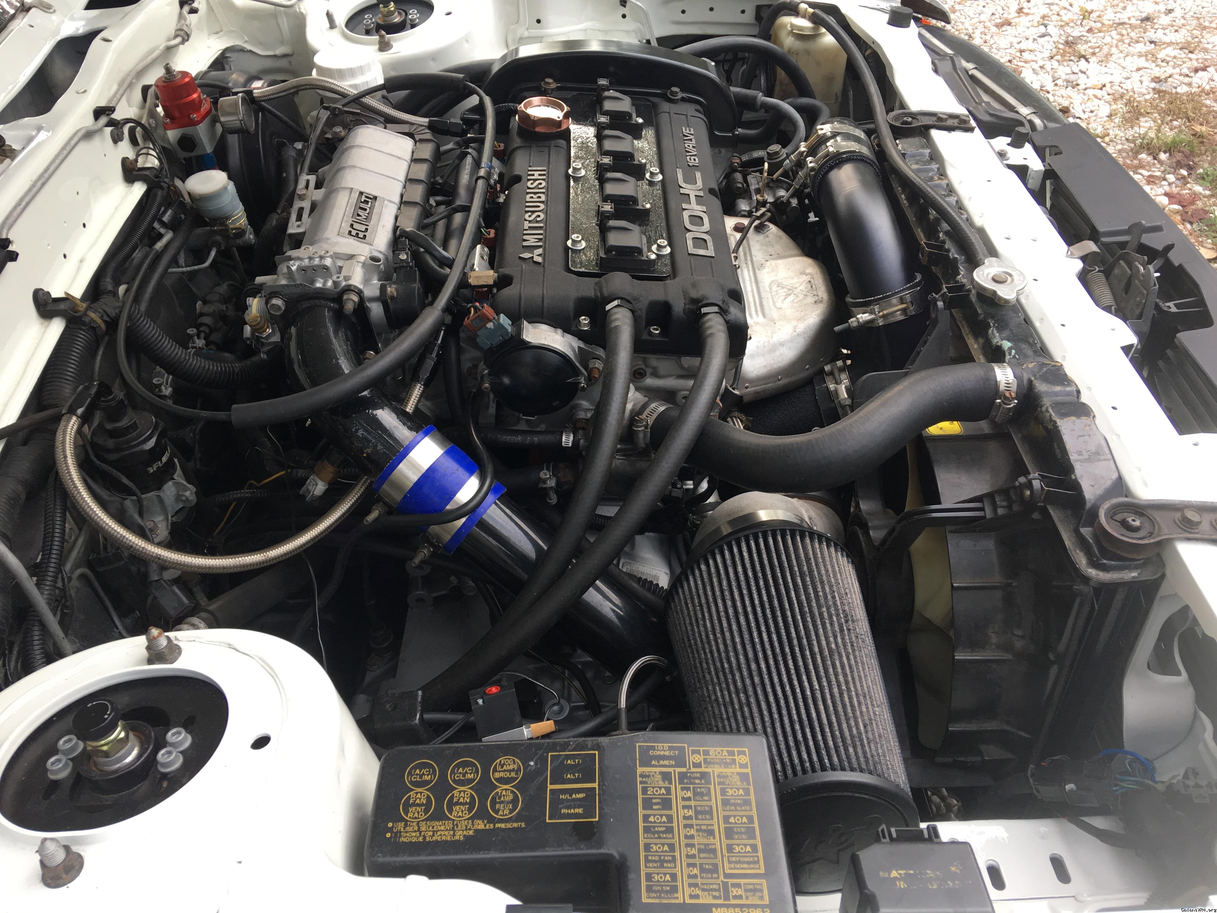

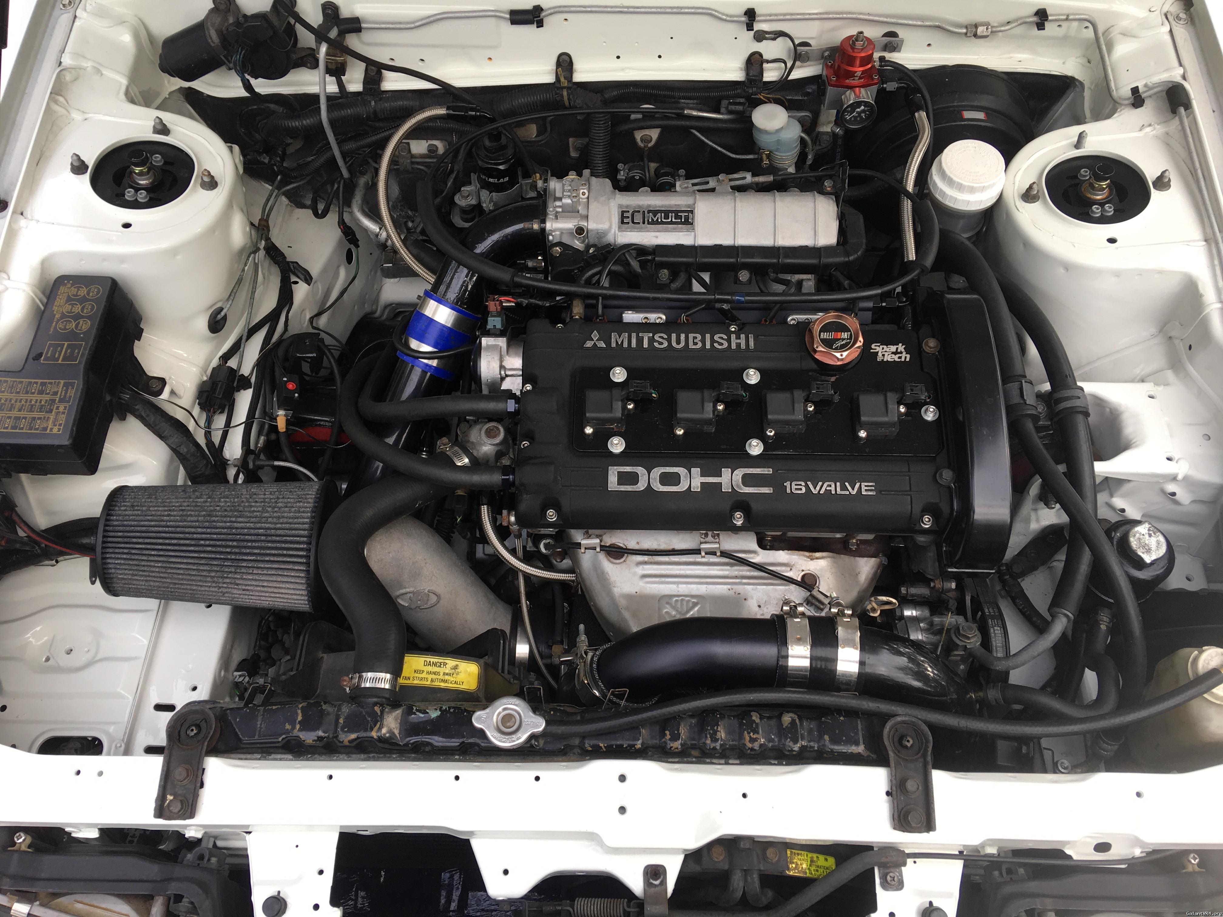

Well, the car has been up and running for almost 3 months now. New setup runs great and has an entirely different feel than the 2.0/hta68 combo did.
I'm still in the process of finishing up things, but have taken some time to enjoy the car a big and give it a low boost, baseline tune so far. At around 19 psi on 93 oct, it pulls as hard as the hta68 maxed out on 32 psi. It's nice and safe the way it is now but I'm itching to dump some of my old friend E85 in and see what a 35R in a bolt-on FP housing can really do.
Here are a few pictures of how it sits currently. Still some oragizational stuff to do, but all in all I'm pretty happy with the way it turned out so far.

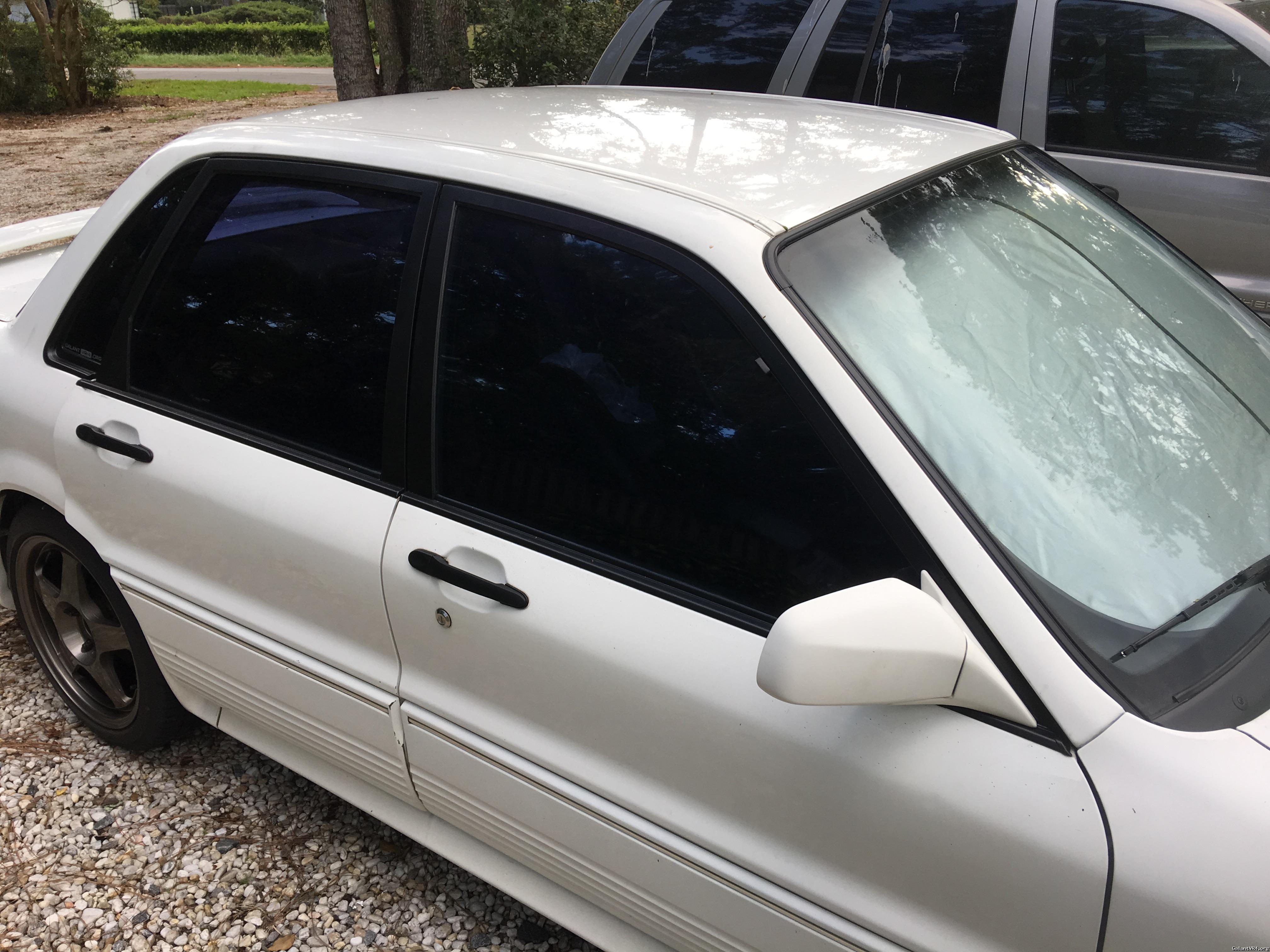

Well, her buddy is looking rough in that pic!

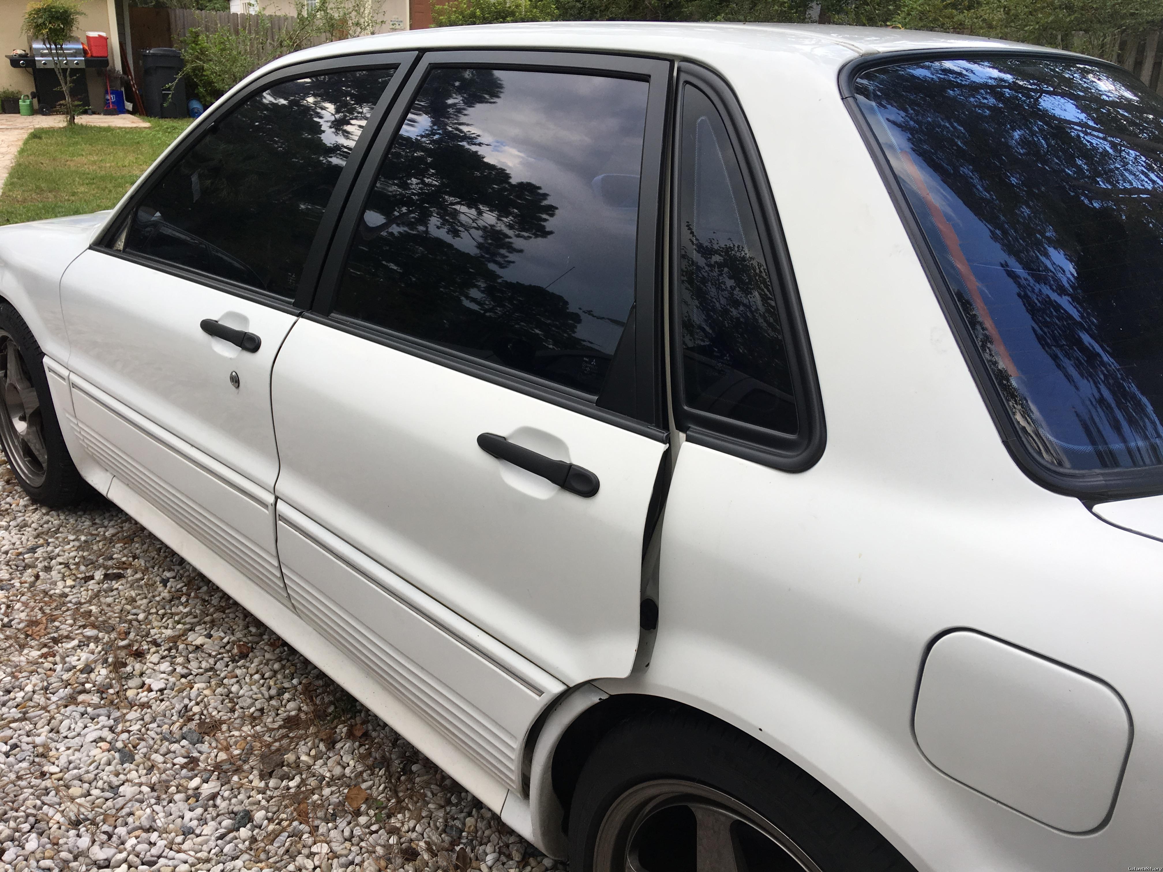

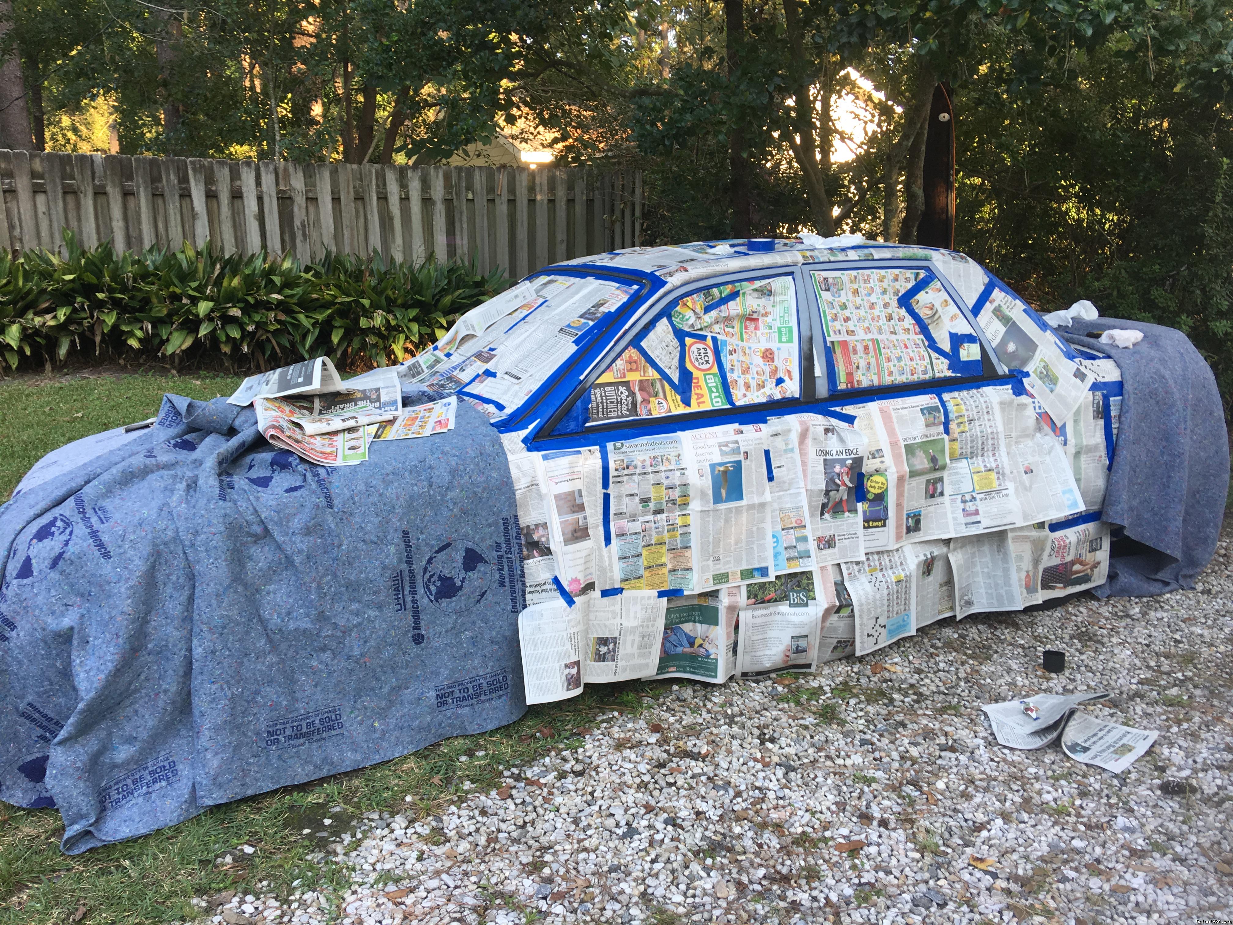

That was a "before" pic of the door and window trim refreshing project. KoR32t4g took the lead on this one and did most of the masking and prep work. It wasn't a quick process, but nothing worthwhile is! The end results were a night and day difference. This little touch should have been done a long time ago!
Masking overkill, check!
After removing tape
Still working
New stickers to rep the .org
I'll get some better pics once I get it cleaned up.
