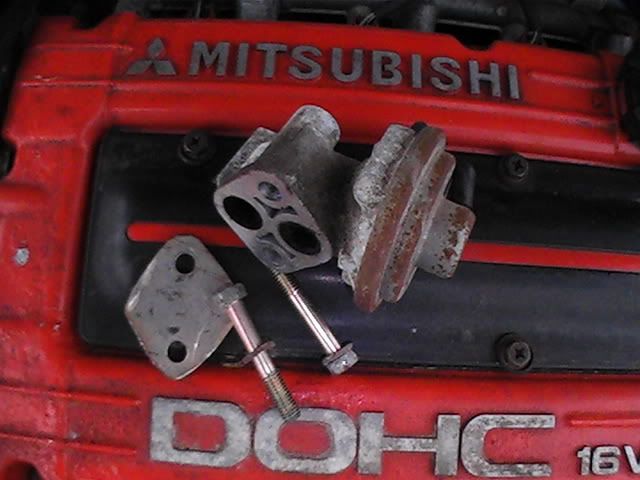

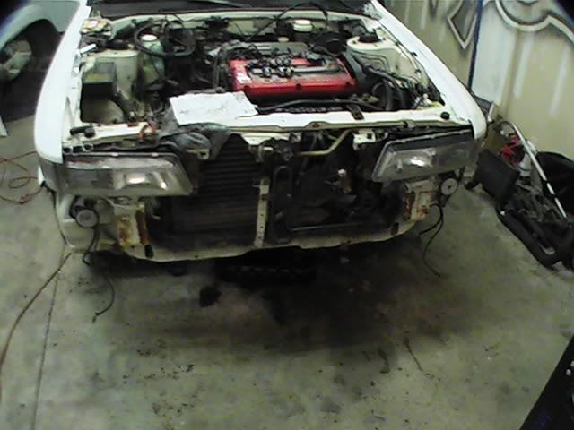

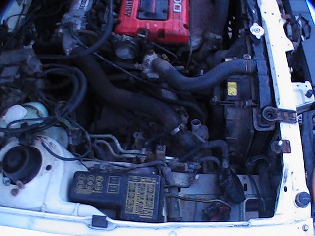

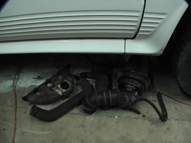

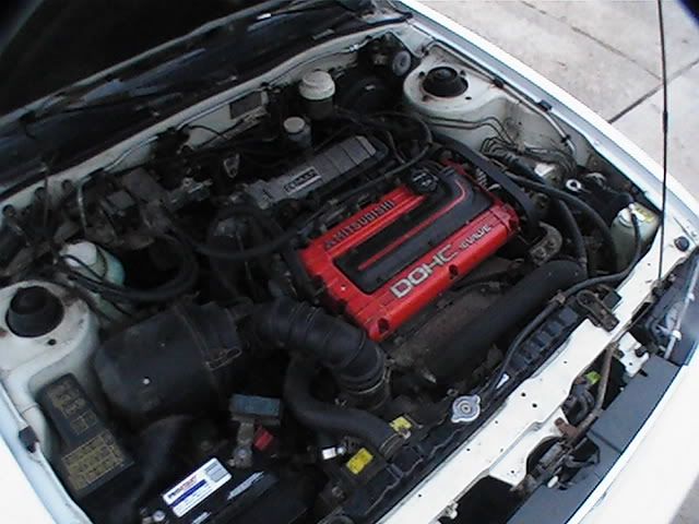

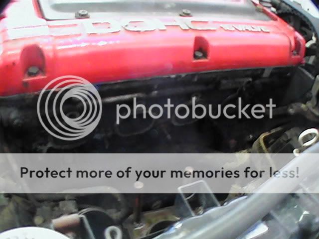

here are some more progress pics.... started taking stuff apart and diggin into the engine bay to see what i got goin on in there....

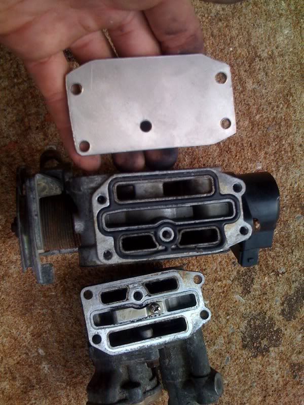

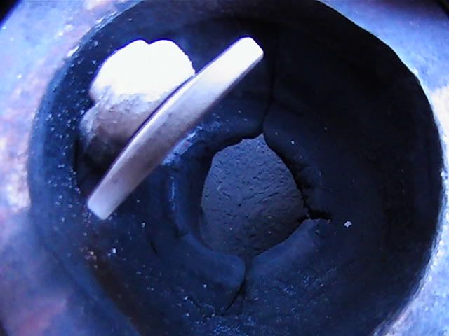

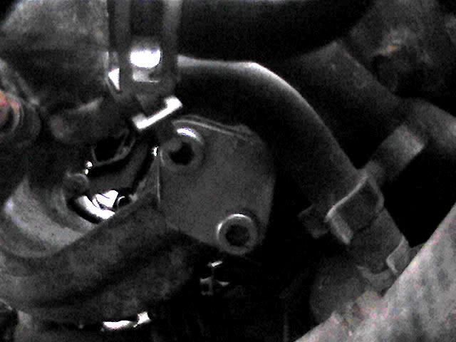

made a little EGR block off plate.... my egr was nasty dirty, im surprised if it even worked....

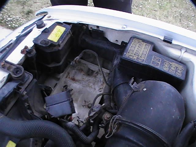

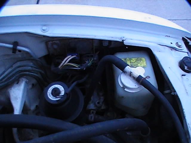

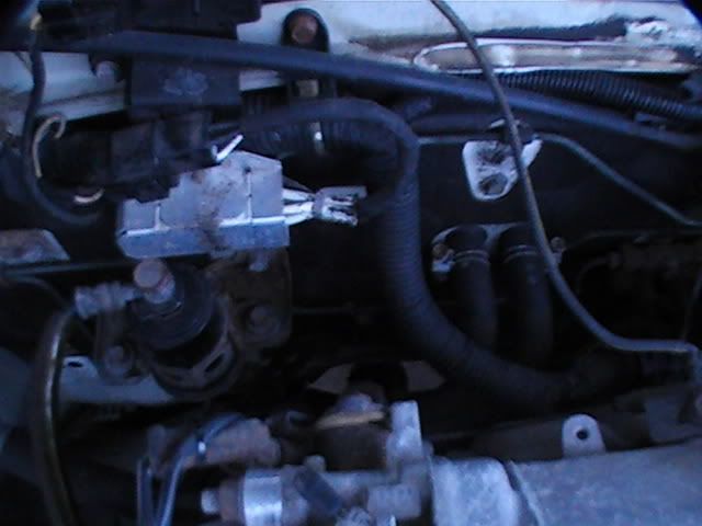

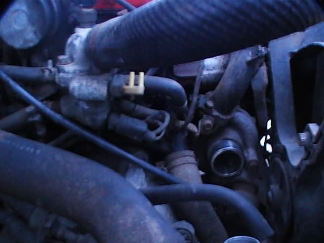

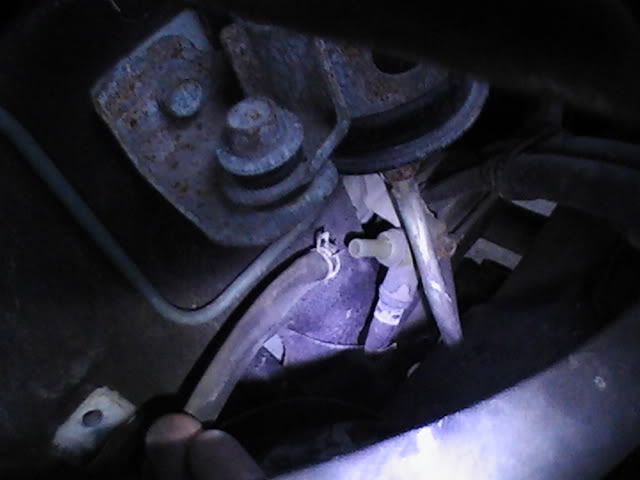

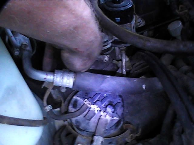

Pulled the charcoal filter out.... i disconnected it here i hope thats ok.... not sure where the other tube runs off too....
Pulled all the factory air box stuff out to clear some space....
If anyone see's anything that can be removed just point it out to me... .HAHAHA....

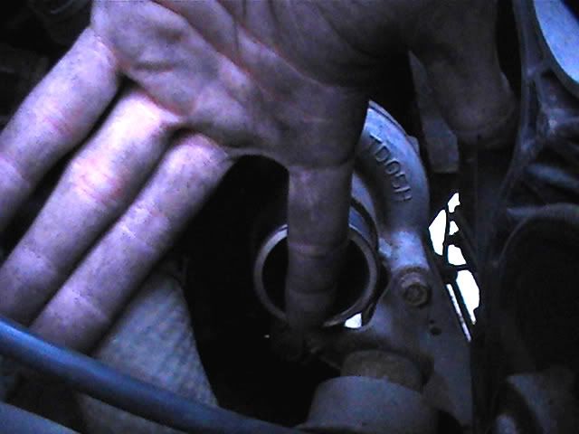

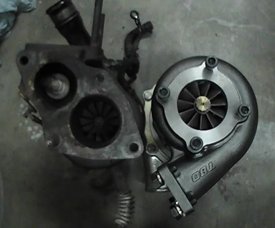

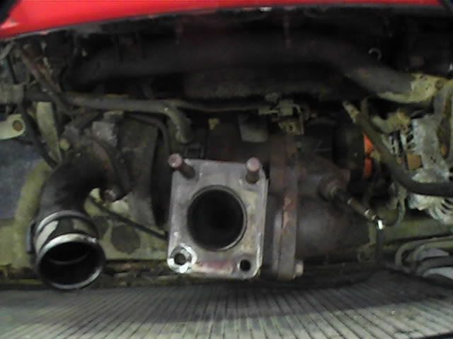

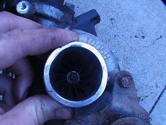

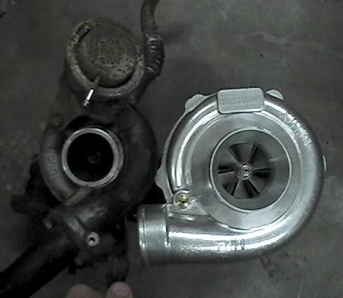

man these stock td05 turbo's are SMAAAAAAALLLL hahaha.... esp when i compare it to my jetta's t70....
my index finger bout clogges the intake....

i need input on what kinda turbo to go with....
thinking dsm link
60-1 maybe....
1000cc injectors
big front mount
act 2600
then new pads and rotors all around.
new tires.
then go from there and drive it to see how she holds up....
11,993
We need to know your goals before we help you decide on a turbo. "Wanna make it fast" is a bit vague.

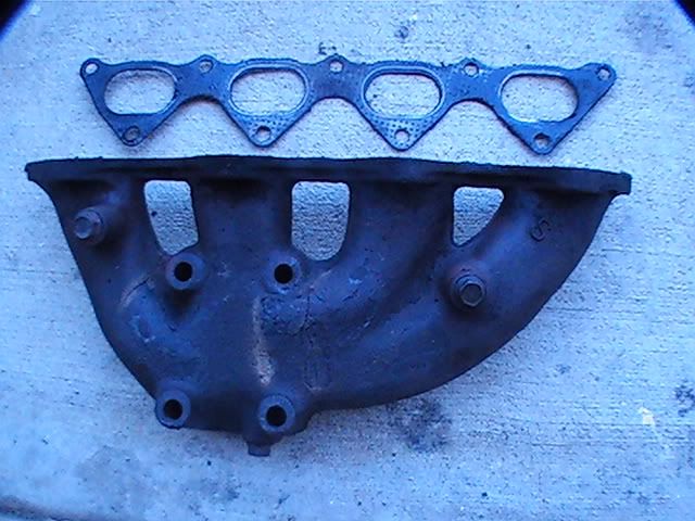

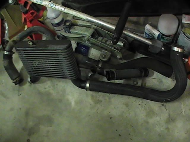

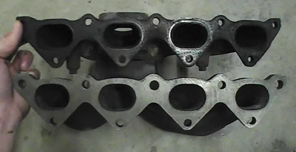

Got some more progress done....

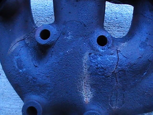

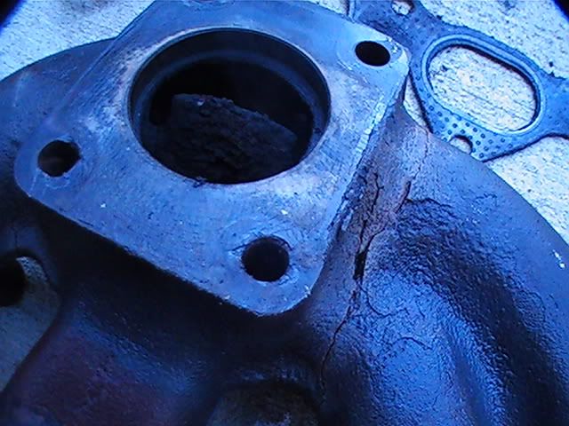

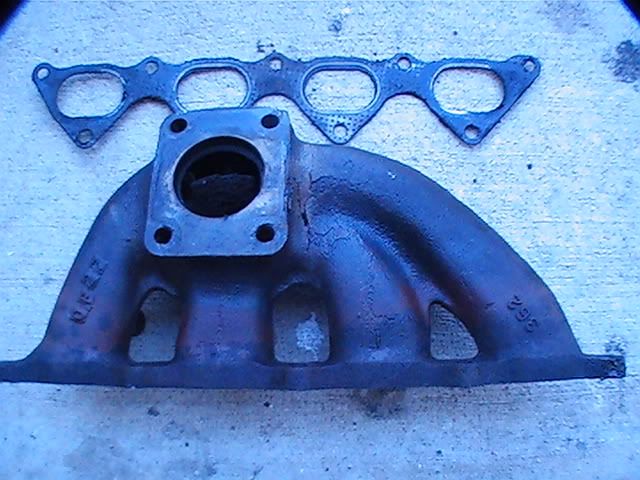

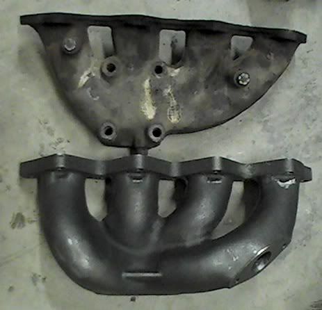

manifold was dominated....
cracks all over it....

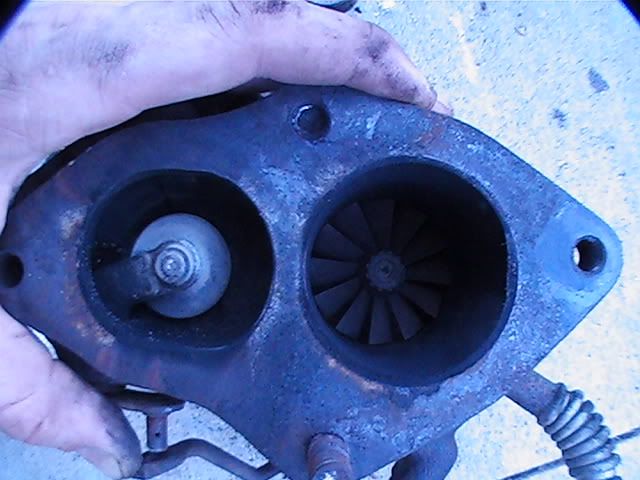

the intake side of the turbo was good....
exhaust side not so much....

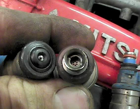

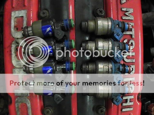

got my new injectors...
little bit of a difference...
started taking some weigh off...
Piles of parts now....

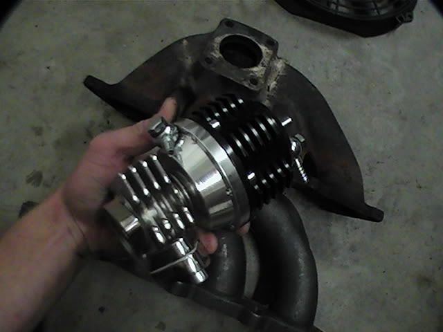

my massive 38mm wastegate...
hard to tell but the new ones a lot more open inside (and i did some mild porting to make it as smooth as possible)

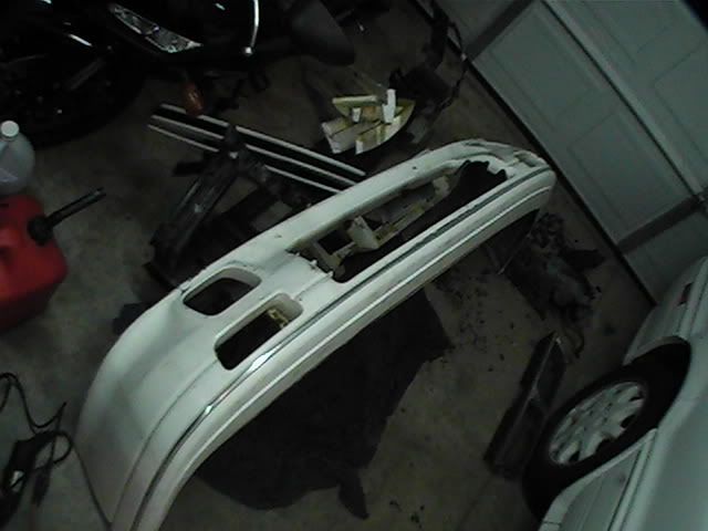

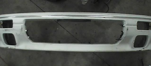

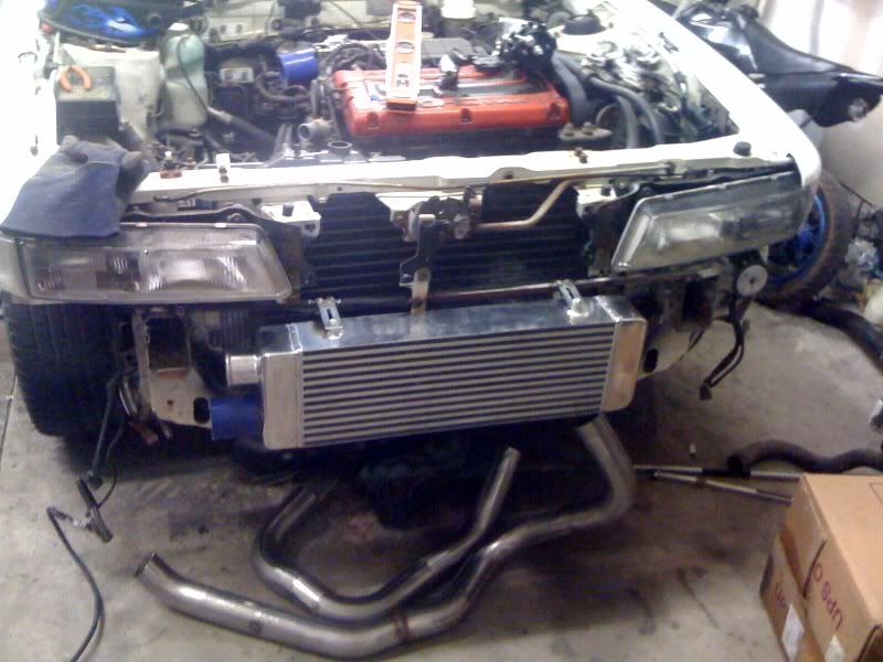

got some preliminary bumper cutting done for the FMIC

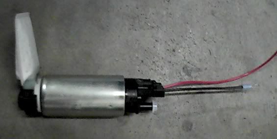

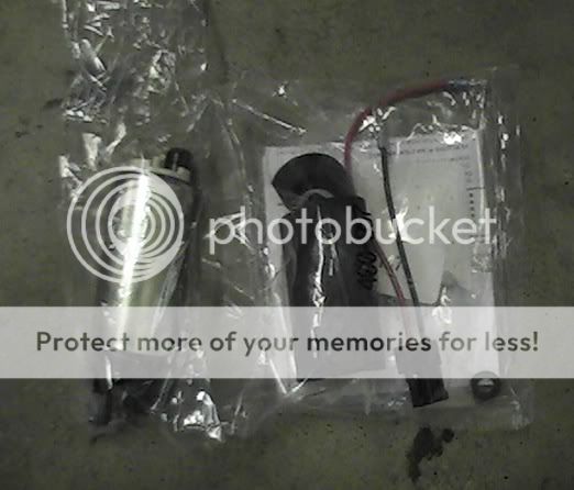

YEAH FOR THE WHINNER.... walbro 255....
gonna try again to install it tonight.... all the bolts on the gas tank are rusted out...

you know it.... i have one on my other car for two years now and its got zero shaft play and pulls hard so i dont complain....
i mainly just wanna get it together and running then i will upgrade later....

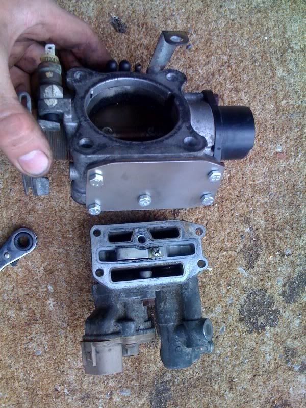

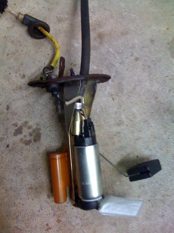

got some mild updates.... only the pictures i had on my phone....

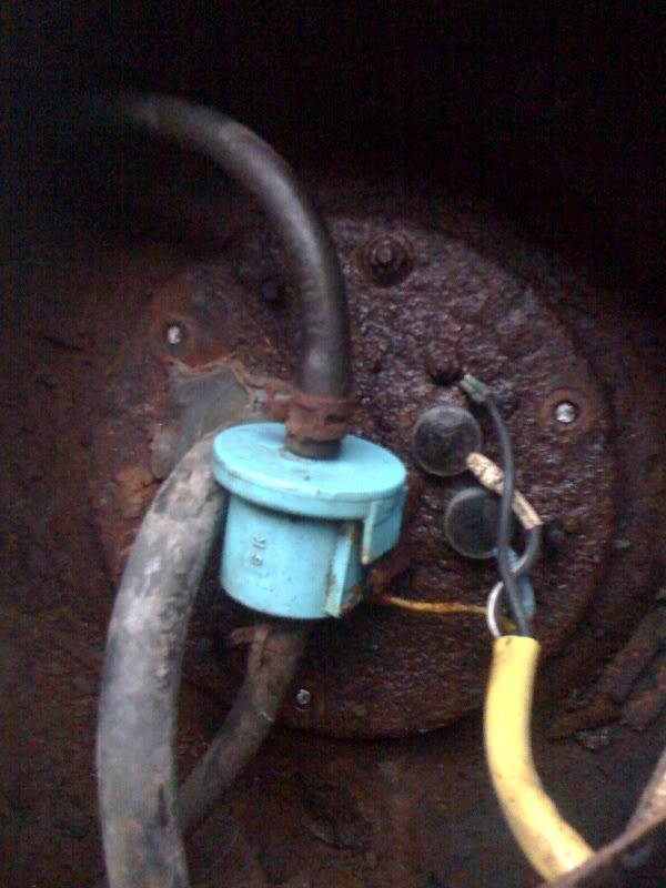

this is the joy i go to have trying to get the fuel pump out....
4 of 6 studs broke off..... but got the new walbro mounted up and hooked up....

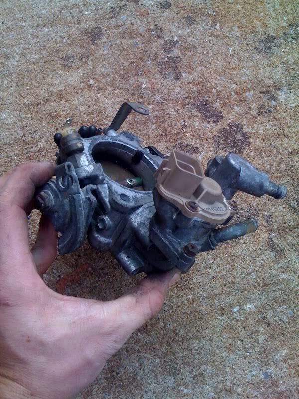

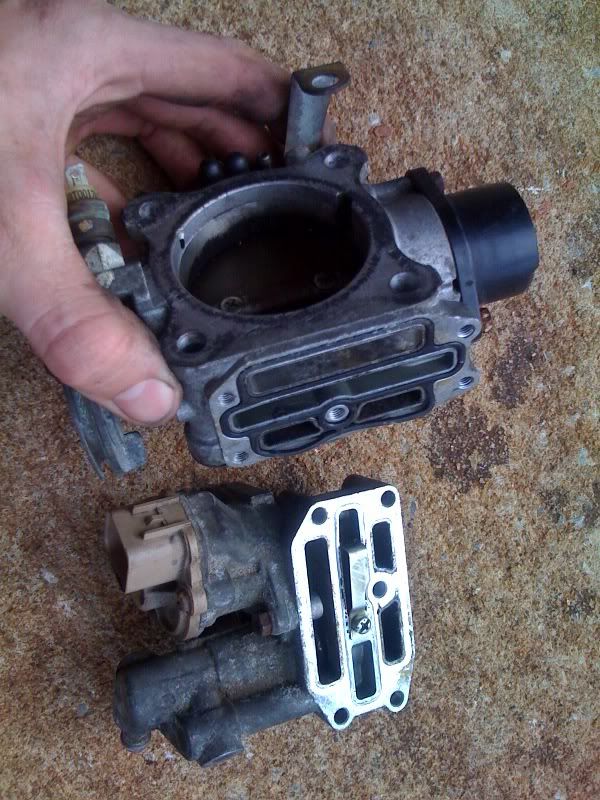

made a little throttle body block off plate.... here is what the whole thing looks like...

mounted up the front mount.....

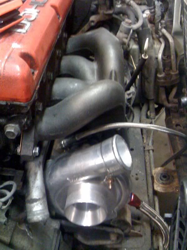

got the turbo and mani mounted up ..... GOSH jrod and snax got to see how much that sucked to do....
-also got the oil lines all in and on which also sucked balls...

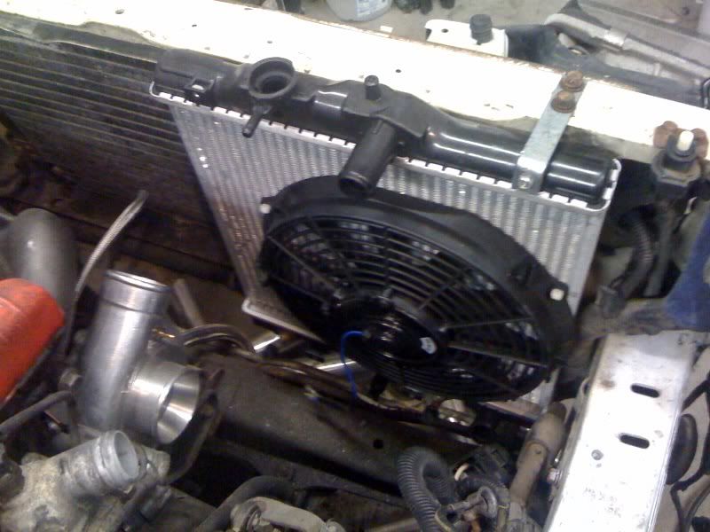

got the half radiator mounted up with the 12" slim fan.... still gotta wire it in....
and lastly..... got all my boost piping cut mocked up and tacked together gonna do the finish welding and polishing prolly tomm in the morning...

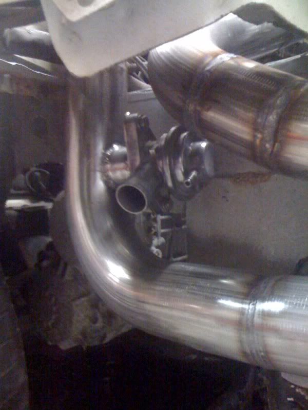

Is the turbo oil drain actually going over and around the front crossmember? Or is it just hanging there and I can't see the unfinished end? I know there are limits as to how far rotated from straight up/down the feed and drain need to be for proper draining and that center section looks clocked quite a bit. /ubbthreads/images/graemlins/dunno.gif
Piping looks nice, but maybe you want to throw one or two couplers in there somewhere. Seems like it'd be a hassle to have to remove the whole pipe to access something in the engine bay if needed.

yeah its a little cocked but its as vertical as i can get it without removing the front motor mount.... i think it will work worse case i will just have to redo it again....
and i dont know anything about your setup i just know on other fast cars i have had once you start running a lot of boost it sucks balls blowing off couplers.... so for me the less couplers the better.... (the piping is still really easy to remove the way it is)

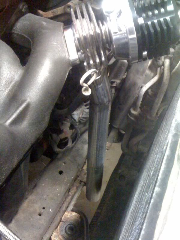

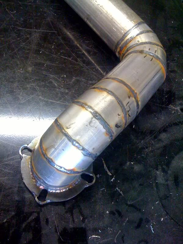

UPDATE.... got a bunch more done....

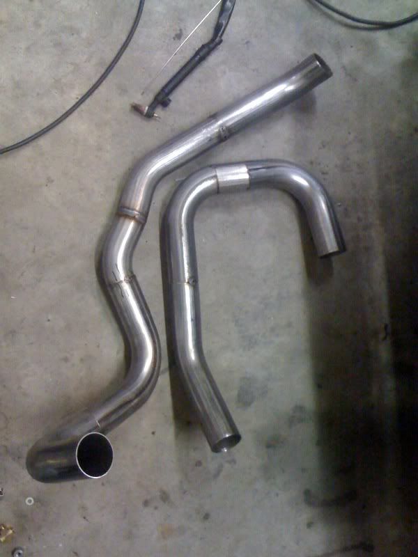

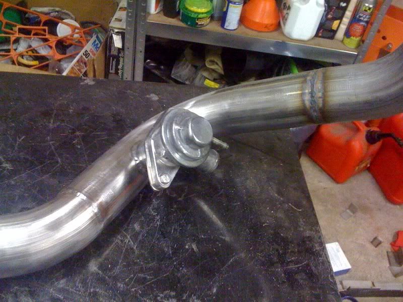

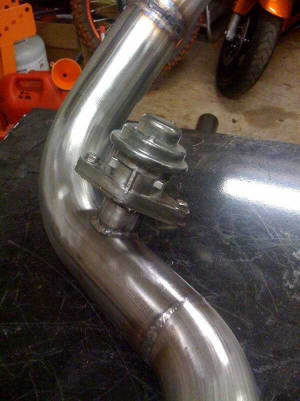

finished welding up all the seems on the boost pipe and mounted up the BOV where i want it.
its gonna be low and out of the way but should be nice and loud outside the car...

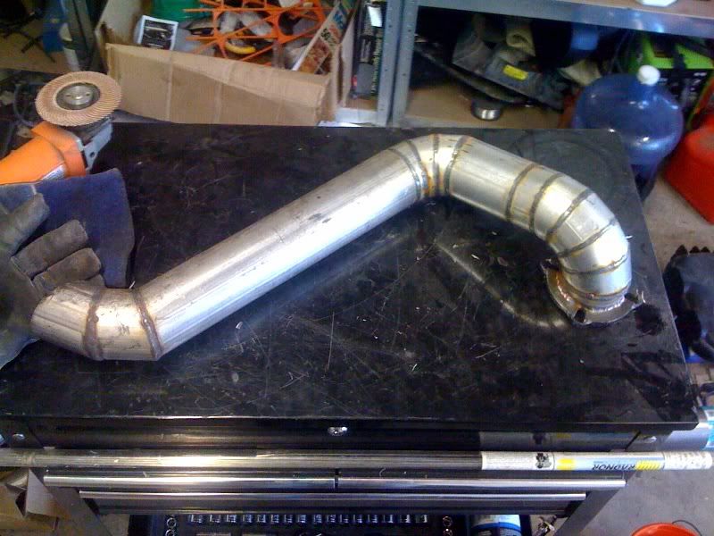

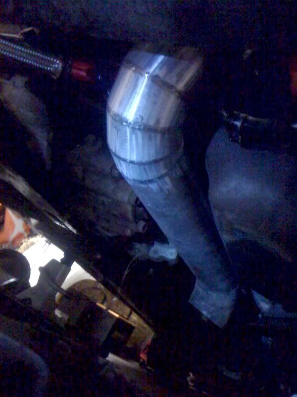

then made myself a little downpipe.... wish i woulda bought some 3 " mandrel bends.... this will still flow just as good but damn is it a ton more work....
my entire boost system is 7 welds.... the downpipe alond is 10.
for now im just running it to here.... just past the motor with a turndown.... gonna be loud and fun...
then lastly i did the wastegate dump tube..... which fortunately was really really easy...
So yeah pretty darn close to done now... gotta intall the ecu and wire up the fan and stuff like that....
then as soon as my MAFT gets here, hopefully tommorrow i can start this bia up and see what happens...

The build is looking good. Just a few comments that may or may not help. You will want to recirculate your BOV unless you are planning on running a speed density setup. At the very least you should look into upgrading from a 1g MAS to either a 2g or 3g MAS because the 1g MAS is a major restriction. With the 255 pump, it's also highly recommended to replace the stock FPR with an aftermarket unit, because that pump will overrun the stock FPR causing a very rich condition at idle.
So far so good! Congratulations on saving one of these awesome cars. /ubbthreads/images/graemlins/grin.gif
EDIT: Just noticed you are planning to use a GM MAFT. Ignore that part about changing out the MAS and having to recirculate the BOV.
