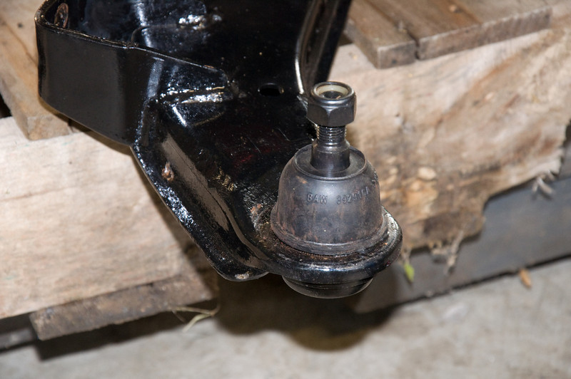

You know two new ball joints from NAPA are $36/pair right? They came out EASY once you take off the snap ring. I don't know how everyone complains about bending the arm or making it weaker, both of mine came out with a 2 taps from a ball peen hammer. Not even enough force to put a ding on the threads. Seriously, I didn't even scratch the paint on the arm to take the joints out.
I suspect some people trying to get them out don't take off the rubber boot and the snap ring underneith then bend the arm beating the sh*t out of it till the snapring breaks. /ubbthreads/images/graemlins/rofl.gif

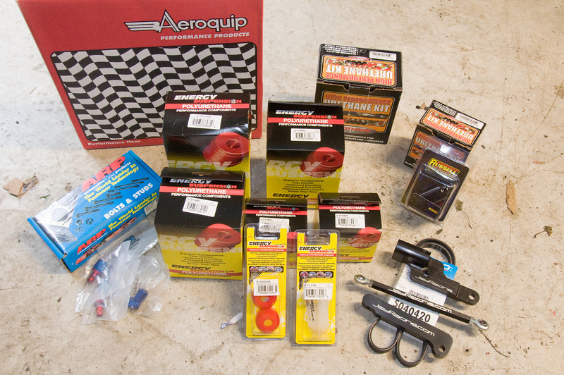

Im starting to receive all the parts I ordered to start actually putting #139 back together:
Summit Racing: $136
$25 russel -6 fuel filter
$30 prothane Tbelt side motor mount insert (had the other 3 laying around)
$52 15ft of -6 Aeroquip sockettless fuel line
$29 worth of -6 hose ends and fittings for fuel lines
My oem feed line was all mangled directly under the original fuel filter (that needed to be replaced for sure). Im planning to cut the oem line down by the steering rack and use a -6 tube nut & flare the stock line. Then run -6 sockettless hose to the aftermarket filter, to the rail, and to an Aeromotive fpr I kept from a previous parts car.
EnergySuspensionParts.com: $135 set of ES poly suspension bushings
JayRacing.com: $125 alternator relocation kit (oem alt, will fix typical alt death. My lower ic pipe is a bastard to get on with the alt in the way too)
Ebay: $4 skateboard bearings for the shifter cable/trans connection.
Rock Auto: $60
$17 steering rack boots
$16 front ball joints
$13 outer tie rod ends
$14 inner tie rod ends
Hopefully all these things show up by the end of this week so the assembly can really kick into high gear.

Pretty much all the parts I ordered are here (rock auto stuff not shown)

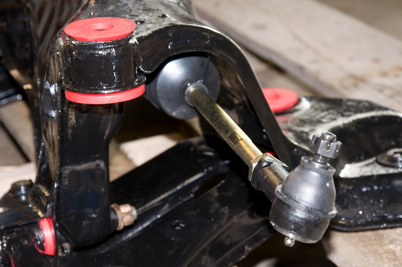

I did all the ES bushings this morning. Man, that sucked pressing the old bushings out, even with a real hydraulic press (from about 1920). ES mispackaged the lower rear control arm bushings, and Im missing one half as there were only 3 instead of 4. hopefully they'll just send me one. Also got the motor mount bushings all removed and ready for prothane, but they need to be cleaned and por painted first.

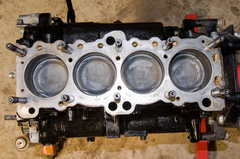

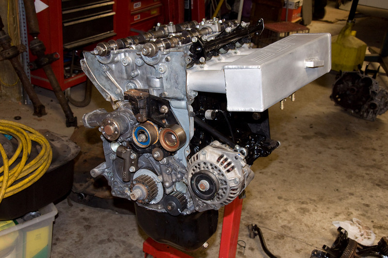

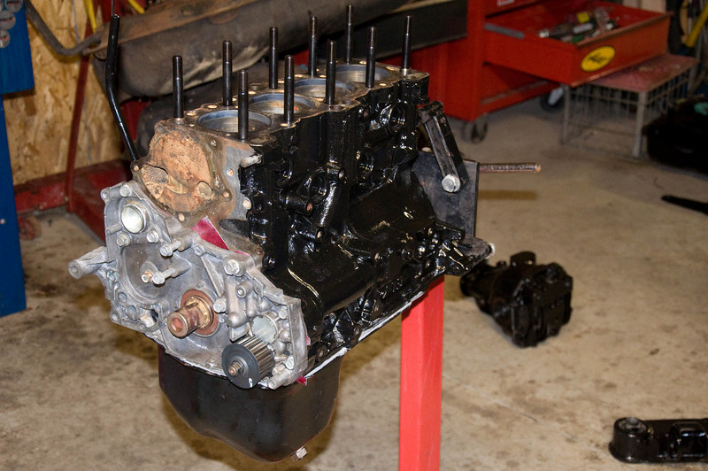

The shortblock got some work too: BSE done dirt cheap (flipped the bearings, $0.92 freeze plug from Napa, stub shaft donated from #828). front case installed, oil pan on, ARP's on.

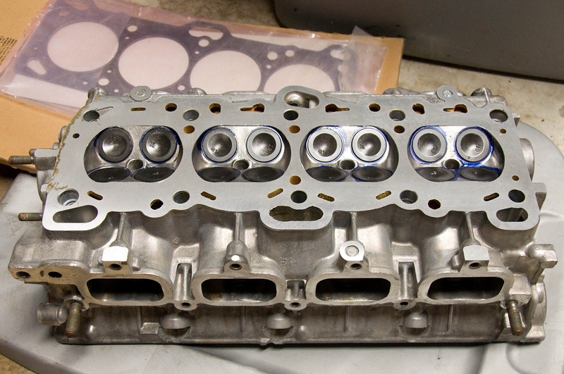

My head is done at the machine shop, picking that up monday. Basic valve job, clean, & deck. I did a light pocket port and gasket matched the exhaust ports. New valve stem seals. Ti retainers and a set of springs that tested at 10lb more seat pressure (minor upgrade). HKS 264I/272E cams are going in with stock gears. Stock valves, rockers, lifters.

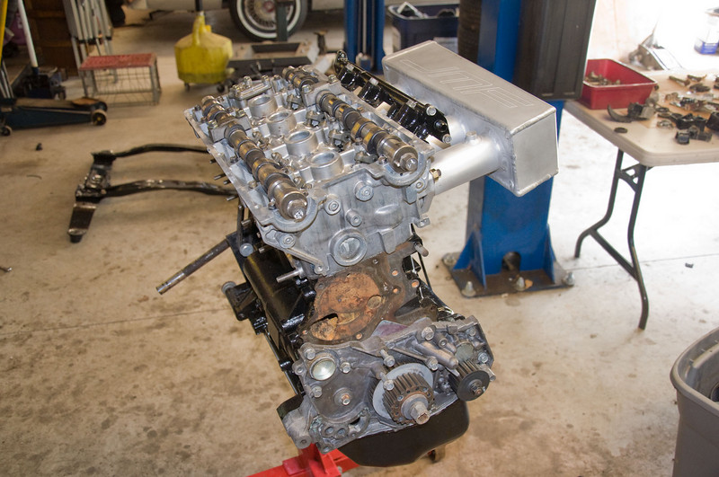

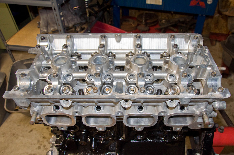

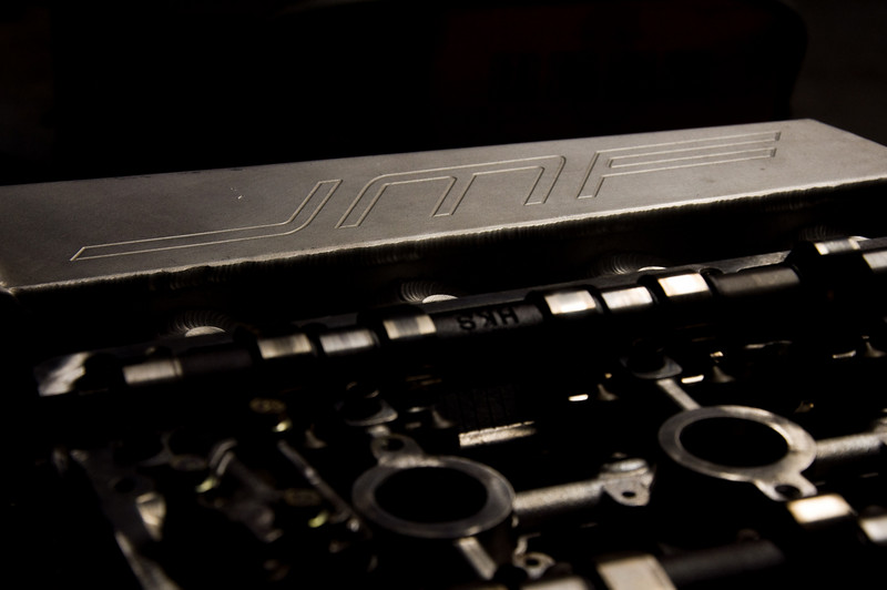

New valvetrain parts. Should be good for a solid bump in rpm, then again I don't think I ever had float issues at 8000 with stock stuff anyway.
Nice clean head:

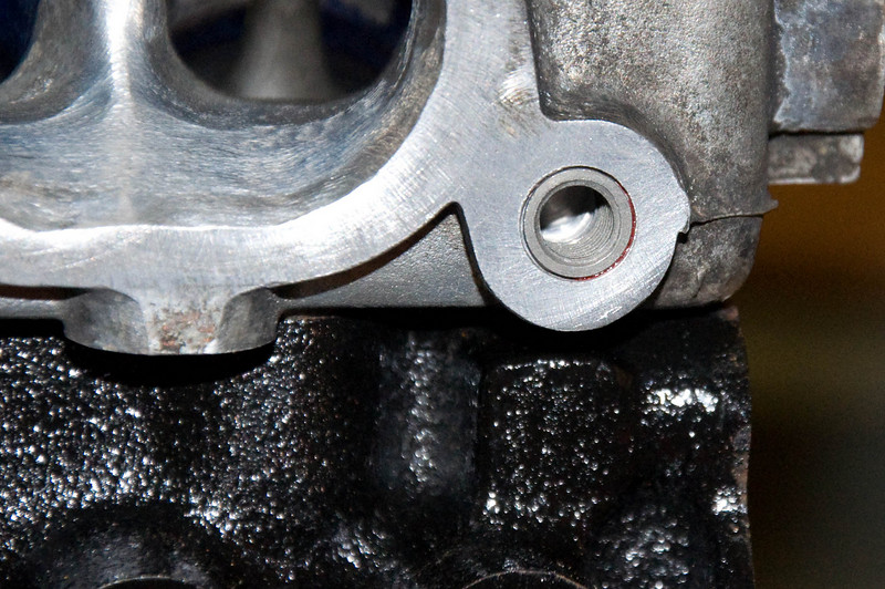

Fixed exh manifold threads: Time insert? im sure that's not spelled right. solid steel, likely better than original threads anyway.
Bolted the head down..then find my torque wrench is gone...lent out to father in law I think./ubbthreads/images/graemlins/nono.gif
Slipped in the lifters and rockers, then went to install cams: no cam seals. /ubbthreads/images/graemlins/banghead.gif I thought I had a set, turns out they are Xcase output seals or something. They look just like cam seals and I swear I checked them like 2 months ago, thus didin't order a set.
So Im held up now on putting the motor back together until I can bolt the cams down.
On a good note, I got the JMF manifold really nice looking. All it took was a dish cleaning brillo pad w/ the blue soap. It took off the top layer of paint and made the whole thing semi-polished looking:

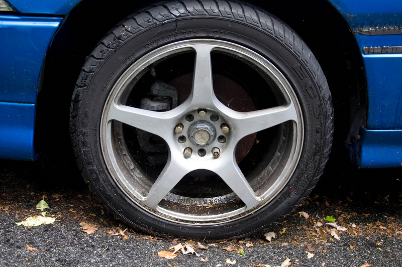

#139 will get new shoes off the last parts can I picked up (91 GSX) on tuesday:
17x7 wheels and Kumho tires. The wheels are Exel brand, and are pretty inexpensive so I might unmount one just to check weight and make sure it's not a 23lb lead wheel. /ubbthreads/images/graemlins/wink.gif

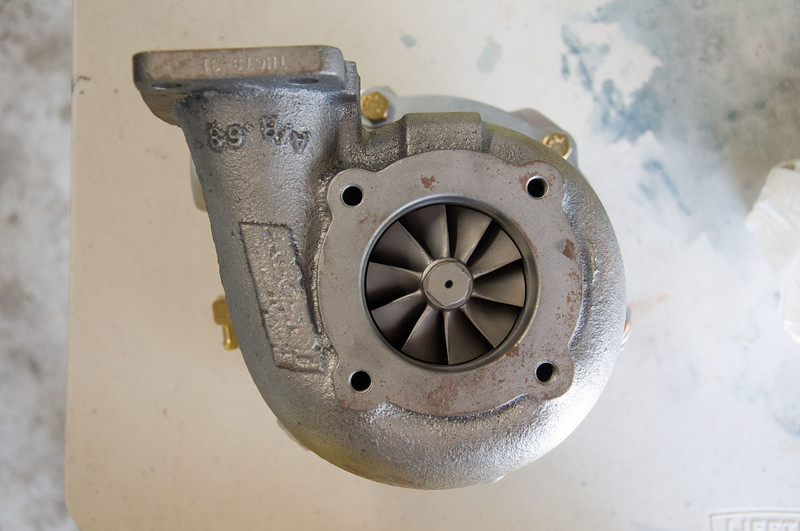

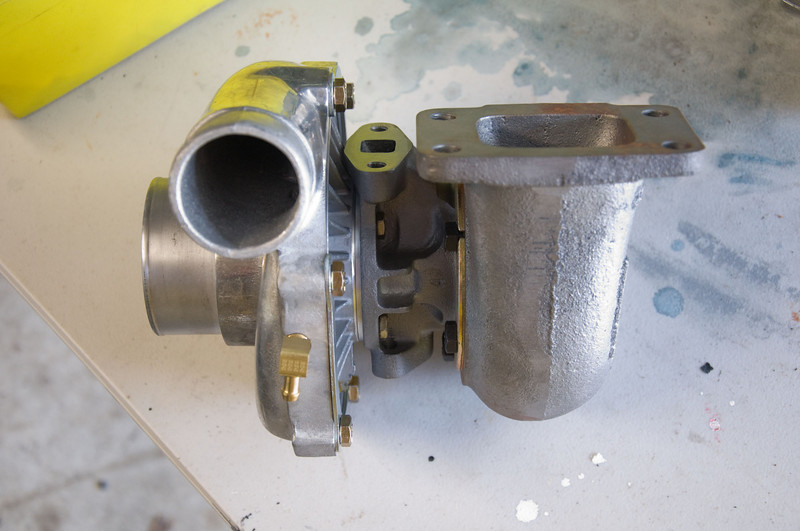

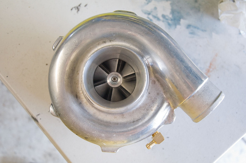

My new turbo showed up. $355 rebuilt from PTE. (remanufactured, sold on ebay). It's a PTE SC5031E. Pretty much the generic 50trim. Just need to order the 4bolt o2 housing flange and go visit Brent for fab work. Polished compressor housing as well, nice freebie.

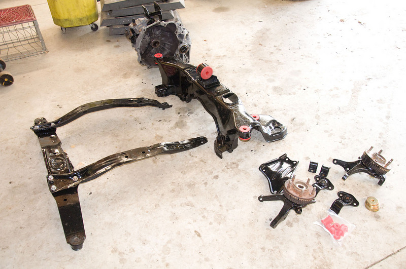

Here's what the rear end looks like. The hanging control arm is missing one half of the ES bushing, and I need to either clean up the ball joint threads or replace the joint. (sux). Axles and swaybar will go on once the control arm is in place.

Motor: gotta drill out a broken water pump bolt, and when cam seals show up I can finish the assembly. Also want to order up a JNZfinishing PC'd valvecover to top it off cleanly. Indecisive on color too.;)

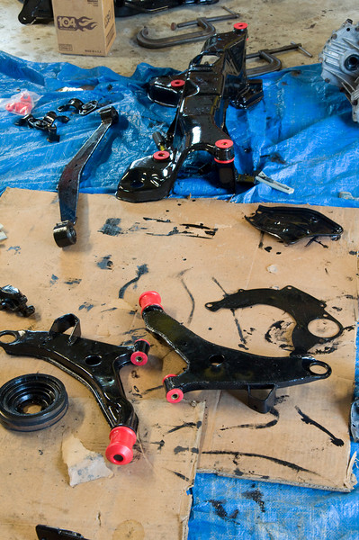

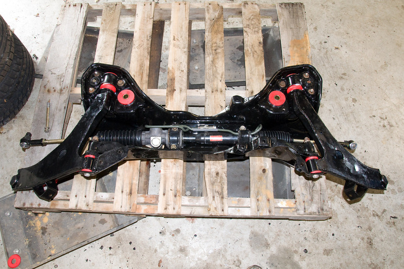

Figured I might as well quit worrying and just put the new parts onto the steering rack that came out of #931. I wish I had ordered a fresh DSM rack a few weeks ago, but it's just too late now to wait and hold up assembly work.
Put together the front subframes and control arms, sans swaybar. Bolted the engine mounts down. Set the whole thing onto a wood pallet on wheels.
New ball joints in front. easy to swap. WTF does everyone complain about?
Closeup pic of the new steering parts: inner & outer tie rod ends and new boots.

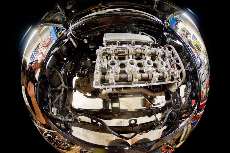

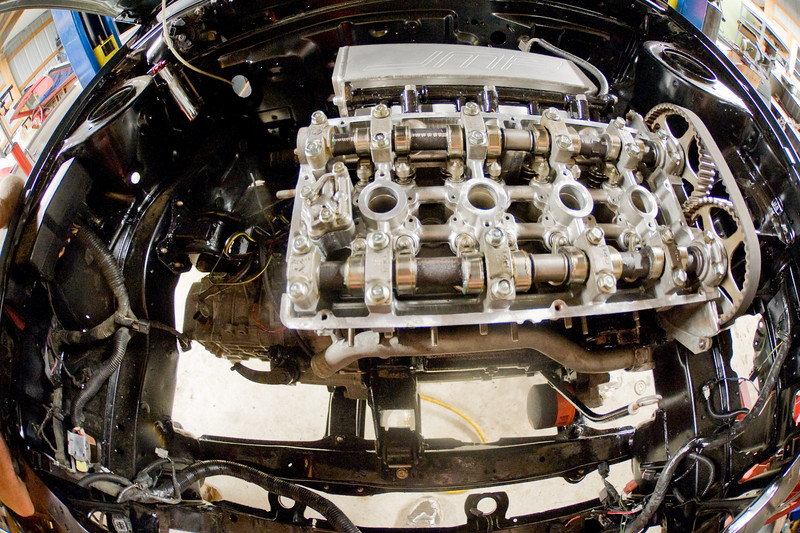

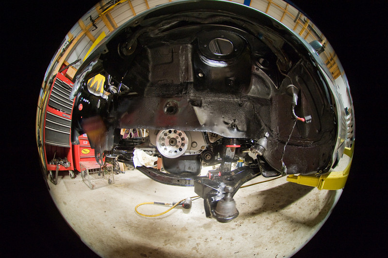

GTluke was awesome tonight. He drove out to help me put the engine in and pretty much everything went as planned:
Bolted on the flywheel, act clutch, transmission, starter motor, axles. Then we go to out the front assembly into the car. Ran into some dumb problems with getting the steering shaft knuckle lined up as well as the lift arms hitting the wood pallet. no biggie adjustments and we were in business. Put the trans mount on while luke played with the steering part.
So the engine, trans, and front subframes are bolted in. There was clearance enough for the alternator pully with the Jay Racing relocation kit without hammering in the frame rail. maybe 5mm of space?
A few pics. (I was using a 10.5mm DX fisheye lens that I cut the lens hoods off of on a full frame camera. It's a complete 180* view, pretty crazy)
Here's the same RAW file cropped as it would be on a DX nikon camera, you can see how there is significant additional view angle cut off compared to the FX sensor D3. (I'm a camera dork)
