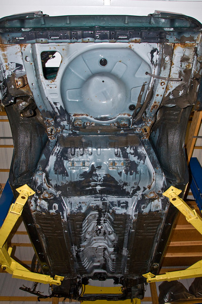

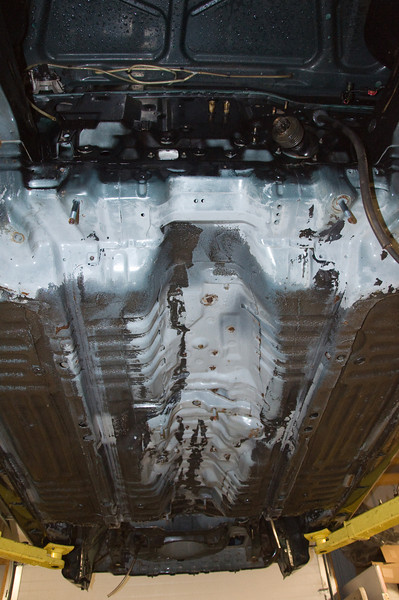

Today was NOT fun. I degreased and washed the entire underbody in prep for Por15 rust inhibitor paint. The degreaser I used seems to eat skin and turn the underbody coating into drippy slime. This was a suck ass job if there ever was one to do on a car. It's clean enough to lick now, all the black undercoating dries off clean and not sticky.
On a good note, the floor of the garage is spotless now after being squeegied.
The car has to dry tonight and I'm planning to go put a coat on tomorrow afternoon.

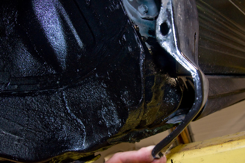

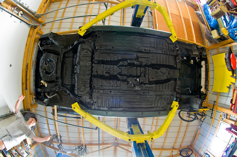

I got the main portion of the underbody coated in Por 15 today, again, a suck nuts job brushing it on. It didn't help that the stuff gets sticky just about instantly as it was raining out and is a major workout to brush.
tomorrow I'm hoping to wash the wheel wells in the morning after removing the front ABS wires and plastic fender liners. Maybe tomorrow night por15 the fender areas and any touchup spots I find.

So still getting parts cleaned and ready for another major POR painting. Now that the unibody is spotless clean underneith, everything that gets bolted to it must be the same: brand new or fresh cleaned.
I think when I'm done, this is going to end up to nice to daily drive or take out in the snow/salt.

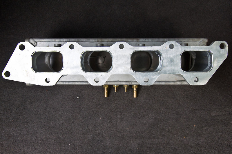

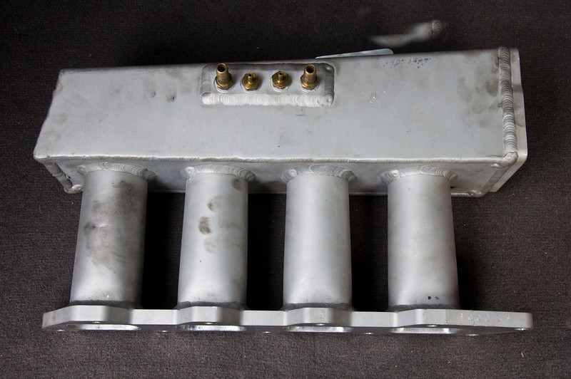

Picked up a new addition for #139. It's painted, has some greasy fingerprints, but hasn't been installed or used. A decision needs to be made:
[*]Strip and polish?
[*]Scuff and re-paint?
[*]powdercoated along with a valve cover to match?
[*]what to spray in those 4 empty bungs? /ubbthreads/images/graemlins/devil.gif
[/list]
hrm
Hope the new custom IC pipes Brent@JMF made me a few weeks ago will magically work fine with the lower TB position.

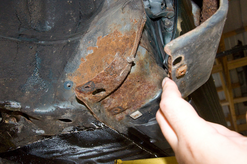

Got a bunch of new pics from this week's progress:
Before:

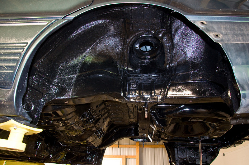

After POR-15

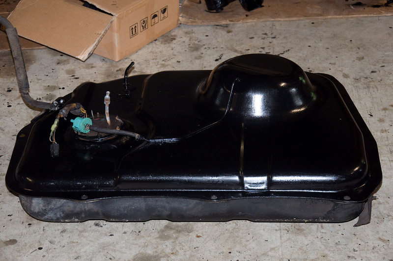

Fuel tank top is done...want to cut off the shields that are all rotted before PORing the bottom:
Ain't gonna rust no more no more

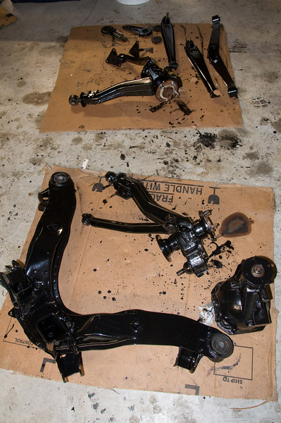

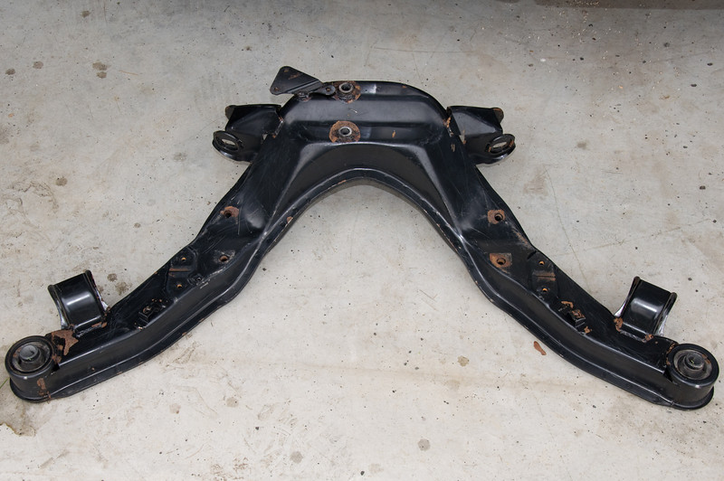

Rear suspension and subframe are done and ready to install
Next week's PORing to do on front suspension, subframes, brake calipers, and engine mounts.

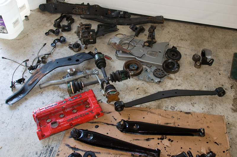

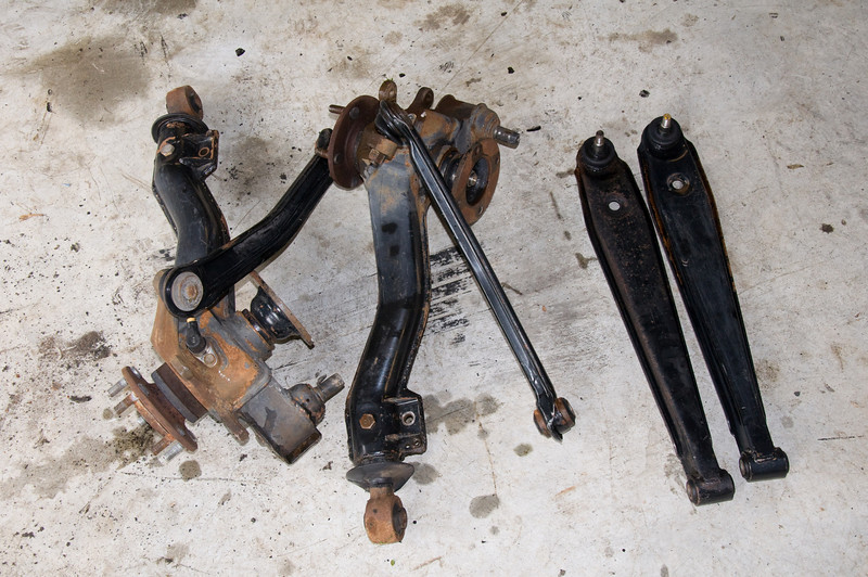

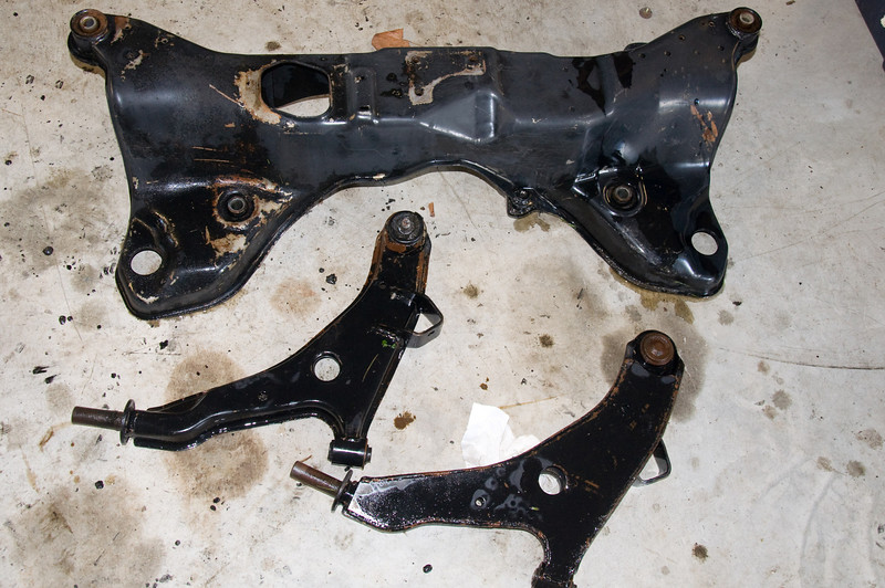

All this stuff got cleaned today:
OMG the steering subframe had like 2" deep of muck from PS leaks and dirt. Spent over an hour cleaning just that one part. A mess like that gets me contemplating ordering a $86 1.8L manual steering rack instead of a rebuilt $150 DSM PS rack.
Control arms both need new ball joints..oddly enough I'v never pressed in new joints ever! on the to-do list.

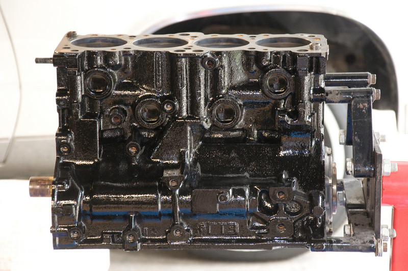

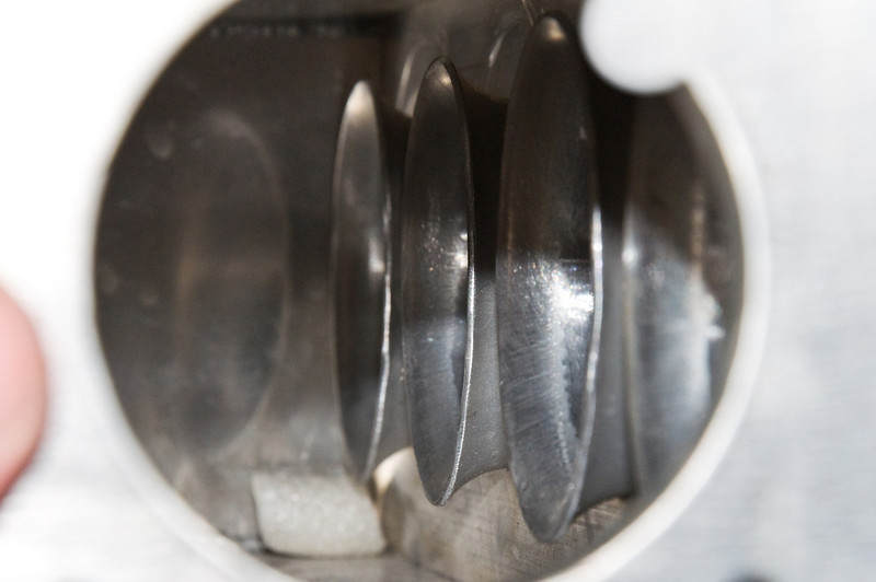

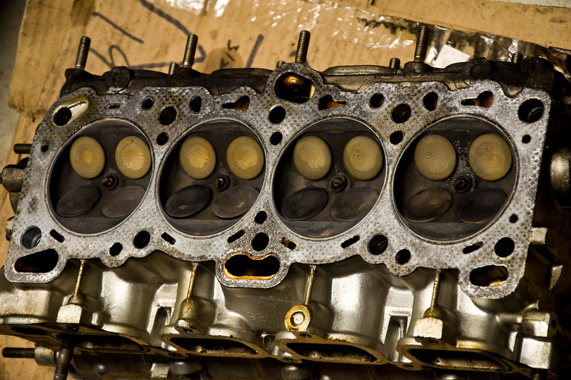

Engine is all apart and on the stand. Pistons are super clean up top without any carbon. Headgasket was perfect. Changing the oil pan, removing B shafts, new Tbelt parts. Porting the head and getting it rebuilt (have an extractor broken off inside a broken exh manifold stud that the machine shop will fix too). HKS cams, JMF intake going on as well. Engine block will get the POR treatment too.

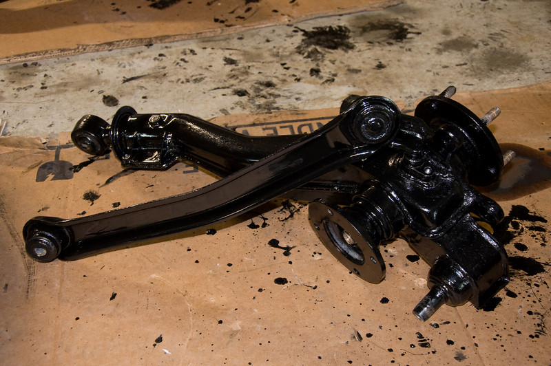

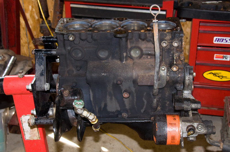

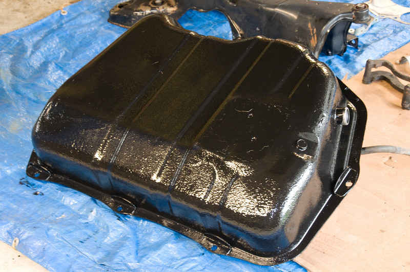

I only got about half the stuff painted today, will do the rest tomorrow morning. Getting very close to starting to finally turn things clockwise.

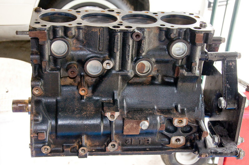

Shortblock after cleaning:
Shortblock after POR:

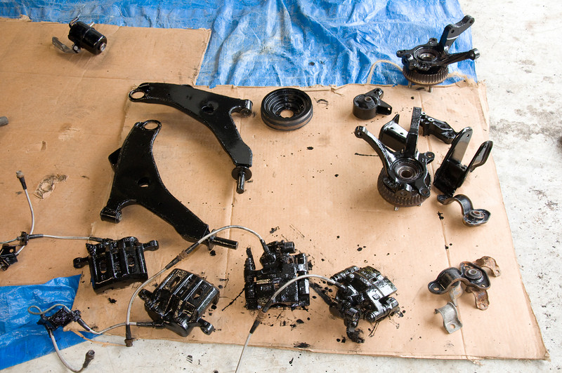

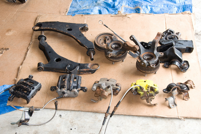

Misc chassis stuff cleaned:
Misc stuff after POR: (missed the swaybar brackets! brakes will need touchup)
Gas tank after POR. the shields are spot welded to it, ended up removing them with a chisel & hammer. Was a lot of noise and a smacked thumb to save 3lb!
Tomorrow painting the front subframe and connectors, the steel parts on the trans, and a bunch of little crap. touchup work on the rest. Then DONE with por15 for a while.
