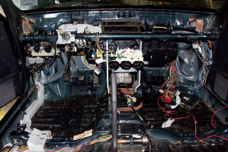

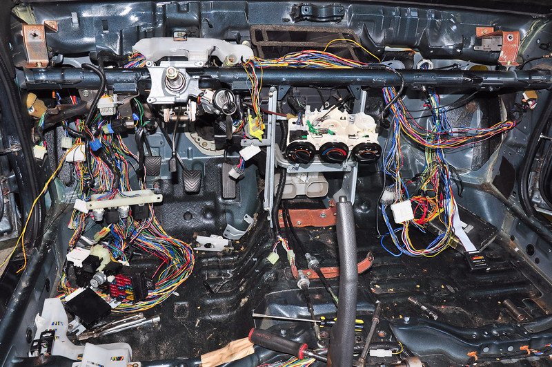

Ok, I think today was the last day of cutting wiring. Finally!
Maybe tomorrow Ill put the dash back in and move on to mechanical assembly. Got the cruise control computer, ac stuff under the dash, and misc loose wires removed.
My wiring box topped 11lb now.

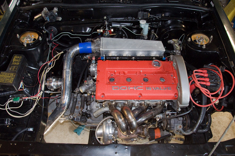

As of tonight, the engine/drivetrain are ready to go down the road. Just need to grab a downpipe gasket from napa and figure out what Im going to do for oil/coolant catch cans tomorrow. Then I need to put the interior together as well as the bumper covers, front lights, grill, and fender moldings.
I bought a JMFab coil mount bracket, and spent about 4 hours fighting with it yesterday. It was wicked hard to get on with the alternator, intake manifold, and jackshaft all in the way. Spent about 4 hours in that alone.
Still some final details to deal with but I think Im going to be able to make it to the Etown Shootout with the car next weekend. I'm hoping to be driving it around this weekend and spend next week cleaning, fixing details, and working on the tuning & setup.
snapped a few pics of the finished engine bay:

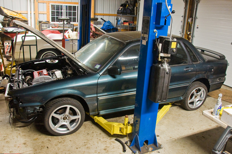

The car so needs coilovers, it's got more than a full vertical hand of wheel to fender gap in the back even with H&R lowering springs! Ever see an awd dsm with positive camber in the back? hahaha
