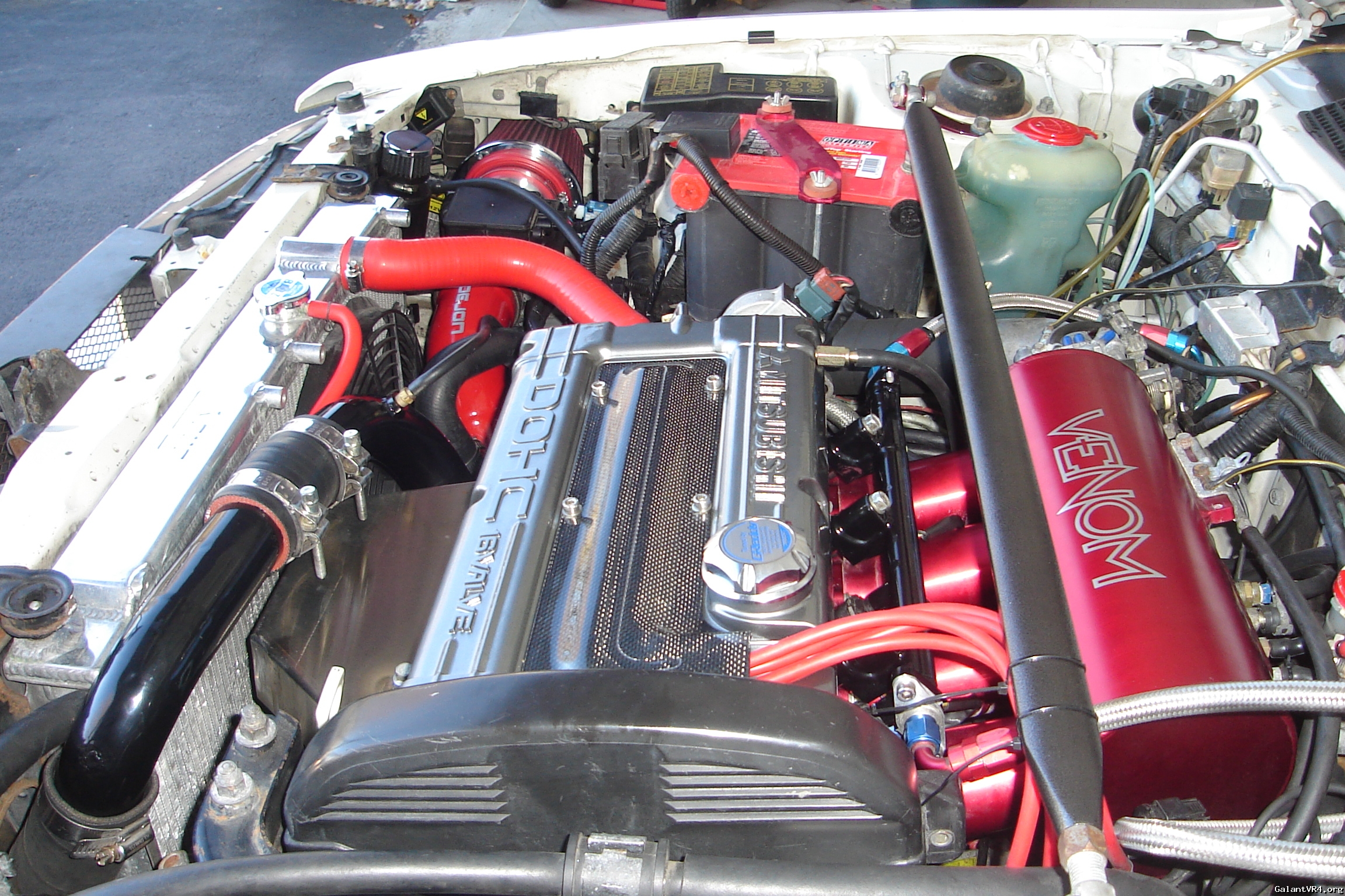

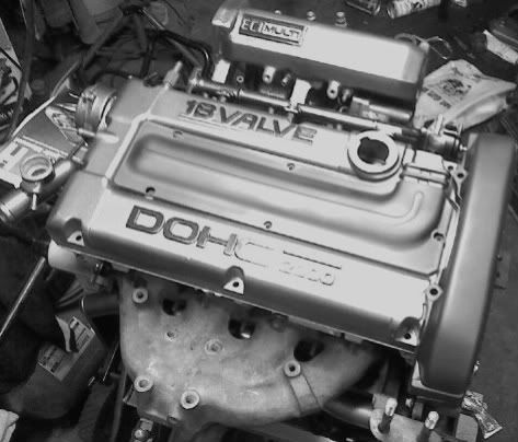

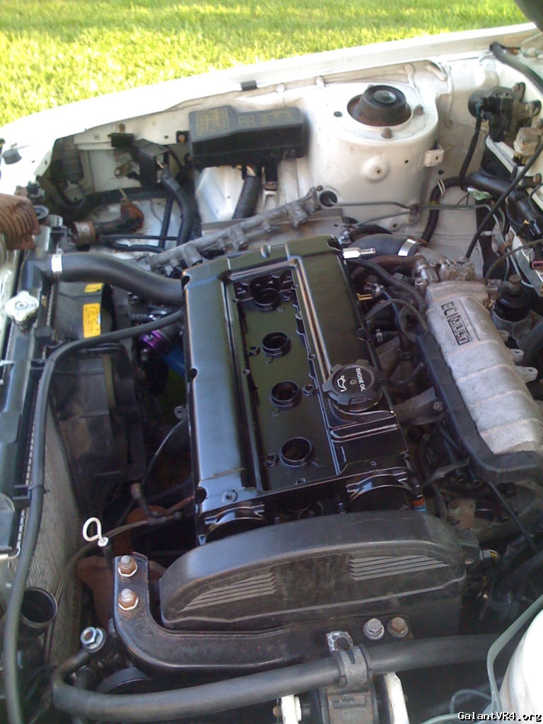

Meh. The valve cover on my VR-4 was red, nasty, and coated with six layers of paint, and I couldn't stand it. So I bought a valve cover from Nate Crisman and sandblasted it and then proceeded to airbrush it with Duplicolor Semi-Gloss high heat engine enamel. It looks pretty good in my opinion, despite the fact that the areas where the letters were shaved off are not totally smooth.
The valve cover is just being placed over the one on sixsixtwo's VR-4 for mockup because I'm not going to my VR-4 until later this weekend or so.
Anyhow, comment on my valve cover, or post your own pictures of yours!

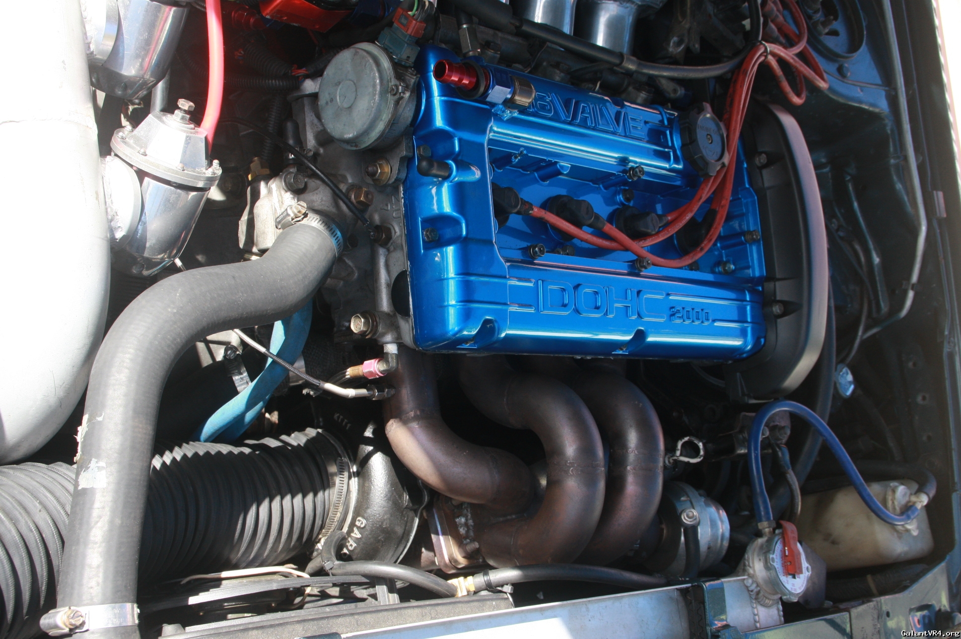

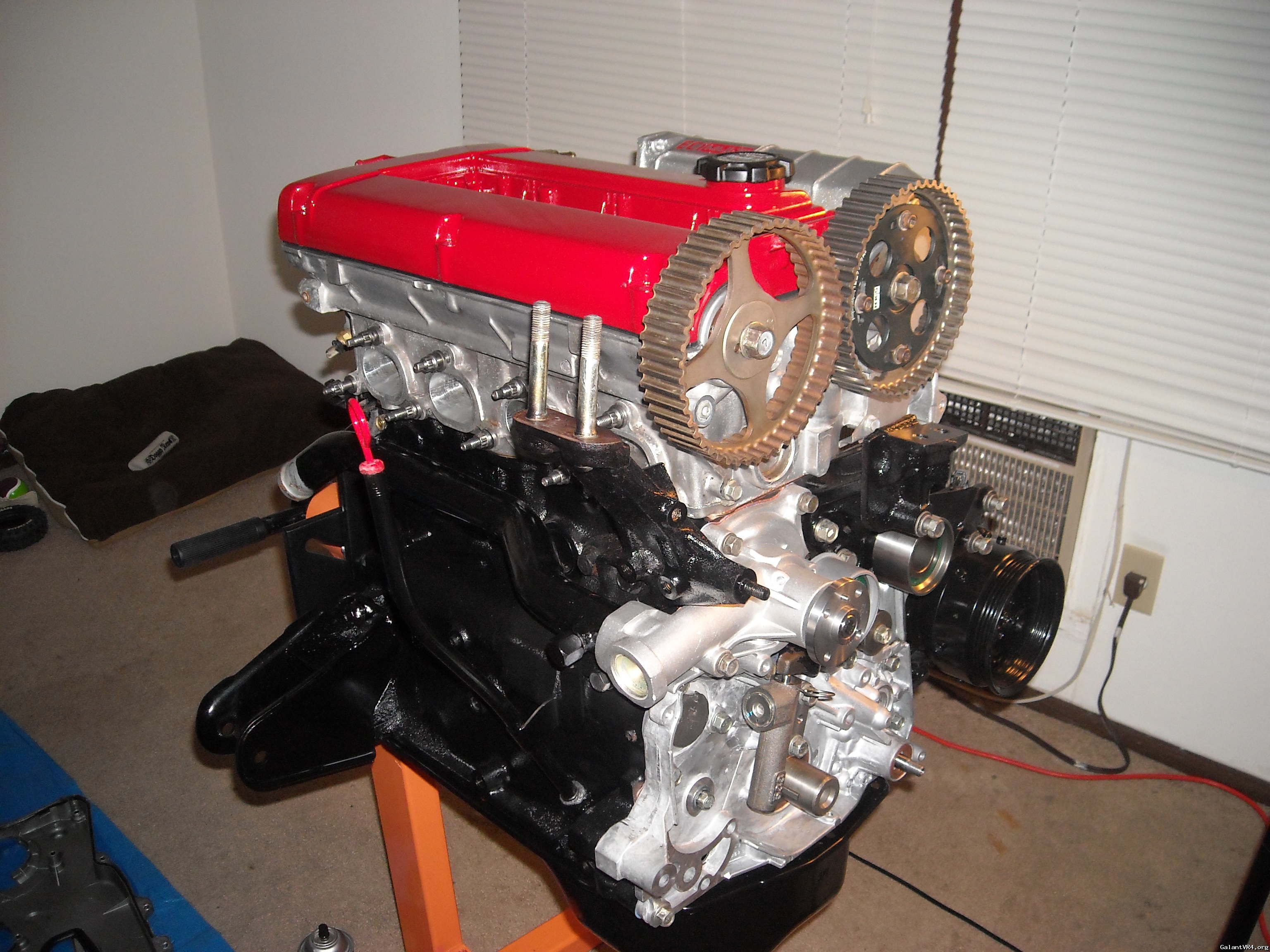

You never wan't to sandblast a vc because you can't get all the sand out of the baffels and it will ruin your turbo and maybe your engine over time /ubbthreads/images/graemlins/frown.gif but here is how mine turned out, Kind of like yours.

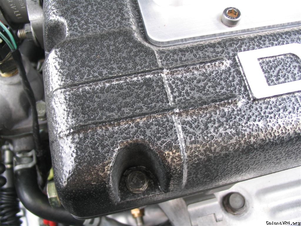

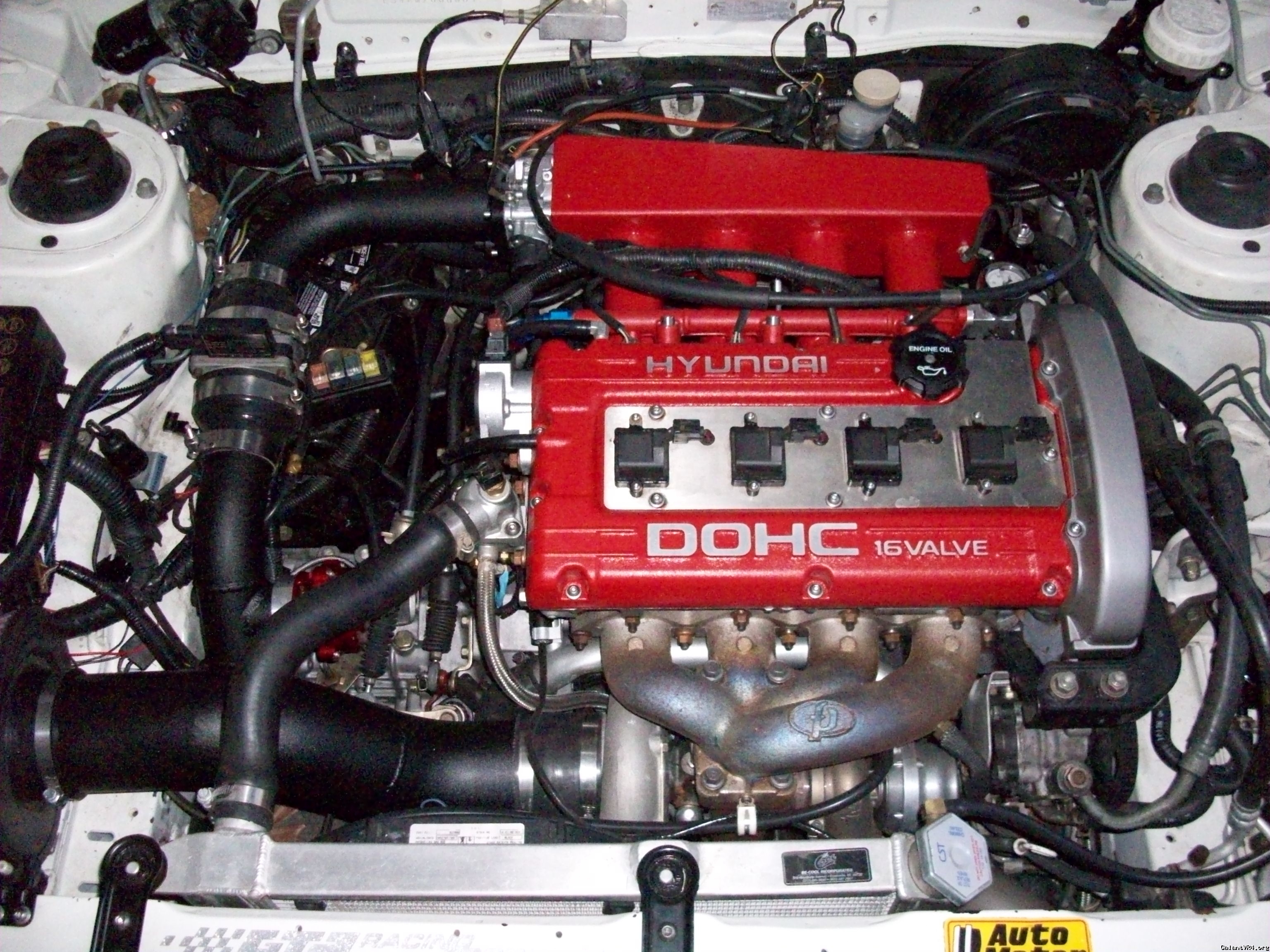

heres mine so far...
Its powdercoated black wrinkle w/ polished letters and the red diamond stat /ubbthreads/images/graemlins/smile.gif
I like the crinkle coat. My buddy did it to his oil pan. It holds up pretty well.

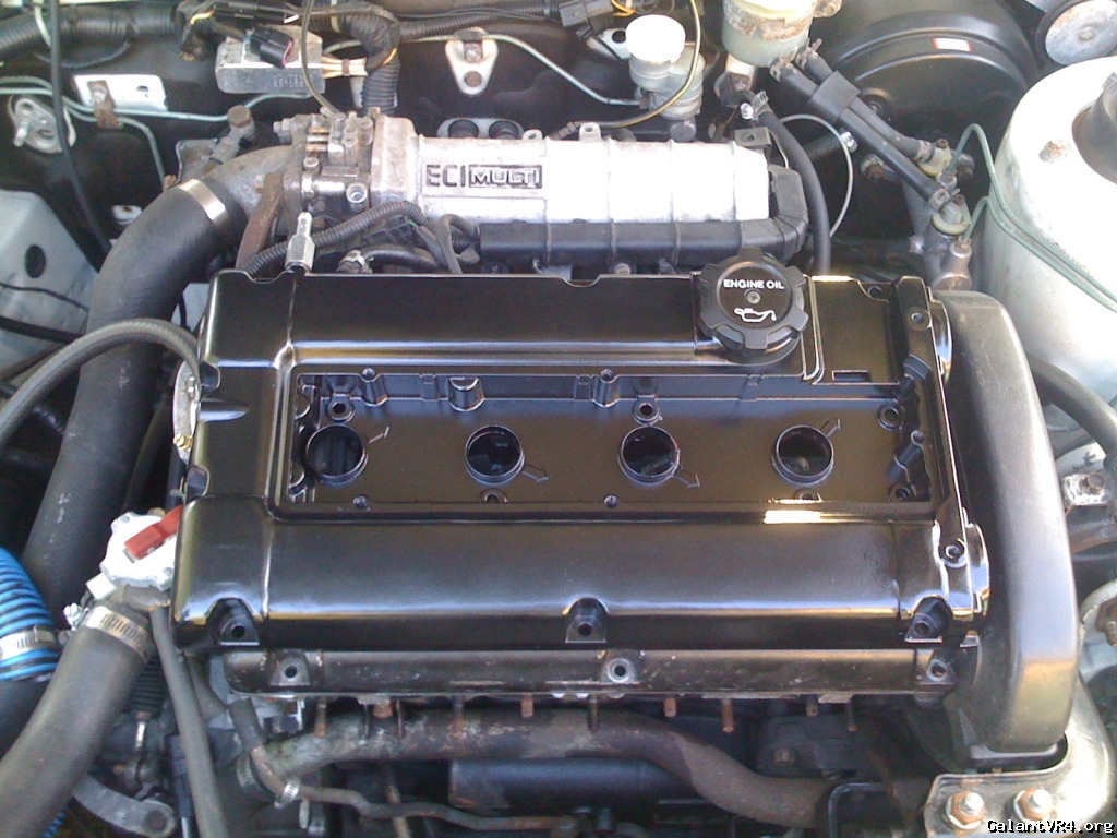

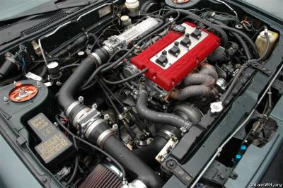

not the best angle for VC but you get the idea

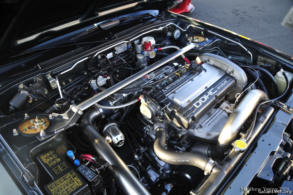

I bead-blasted/powdercoated my valve cover over six years ago. I guess I got all the media out since I'm still running strong? /ubbthreads/images/graemlins/hsugh.gif
You can clean all the crap out, and if you mask it off well enough it'll do a good job of keeping the crap out.
Here's mine:
