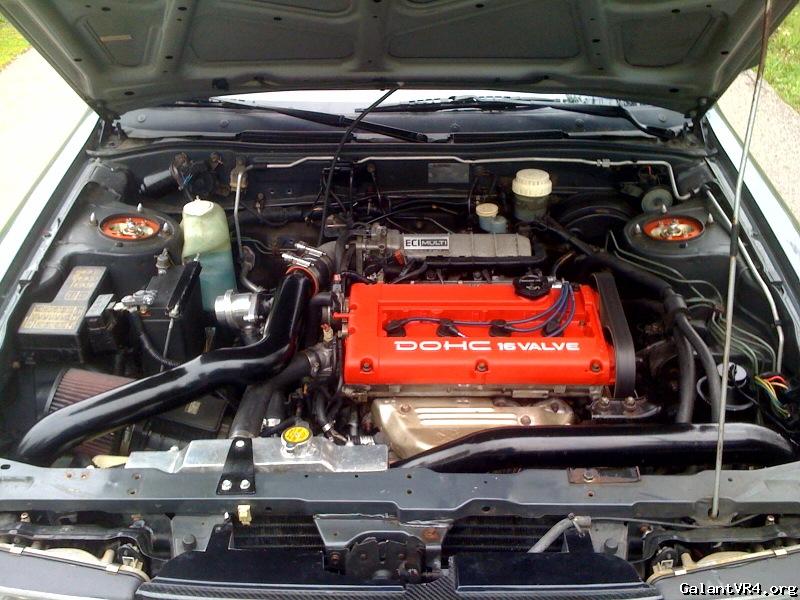

I just used a longer bolt and a washer. The bolts aren't shoulder bolts but it doesn't matter. They center when you torque them down and the VC has no place to go. I did have the Hyundai specific VC gasket however.
Not the best shot, but I just used stainless bolts with stainless washers. Even with the crinkle coat, the washers keep the bolt from ripping the paint off.
