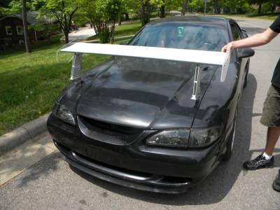

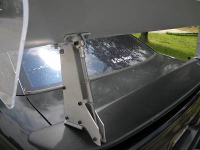

It seems like, now that you have it installed, the only issue is determining the proper pitch to get the most benefit without creating too much drag. You could presumably employ your streamers again and watch the airflow over the wing. You'd want to find a trade-off between getting the wind to come up off the wing as much as possible (thus creating the most downforce) and having the streamers follow a relatively smooth path (since turbulence is drag). I'd just put some streamers on there and steadily increase the angle until they become erratic and then back it off just a touch.

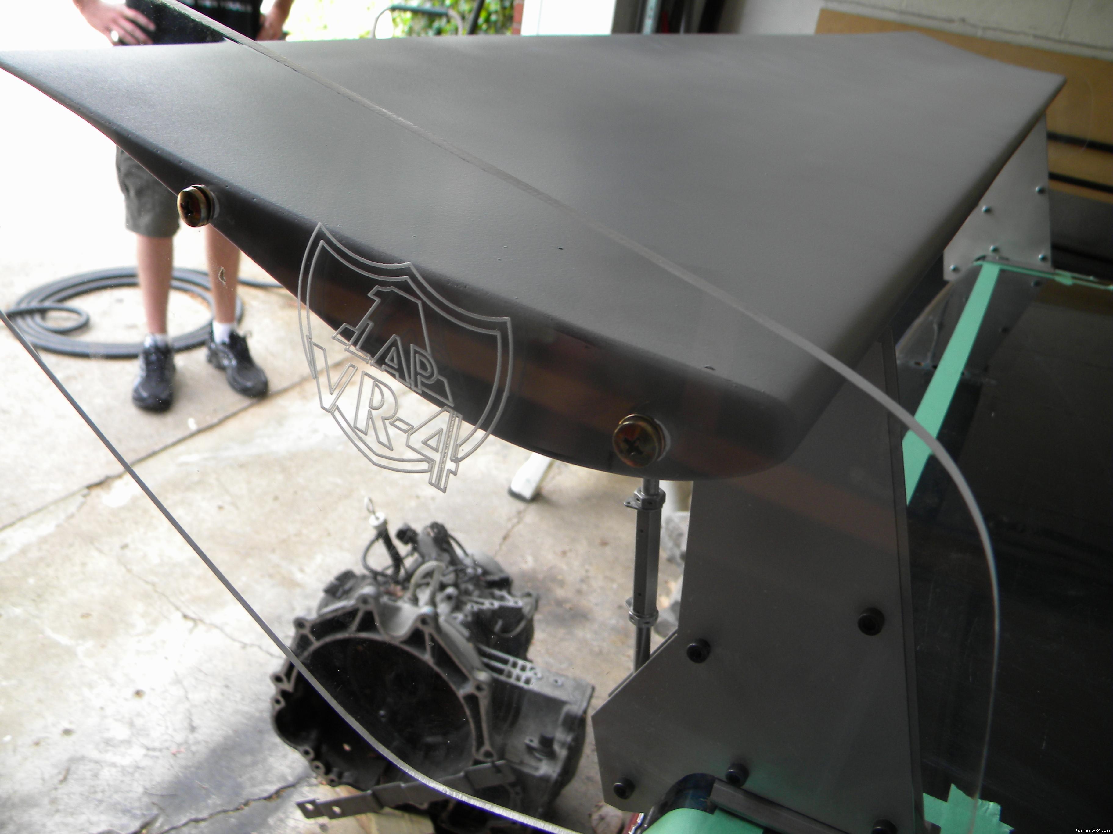

Holy crap Curt, that looks good. I'm diggin' the custom engraved wing ends.

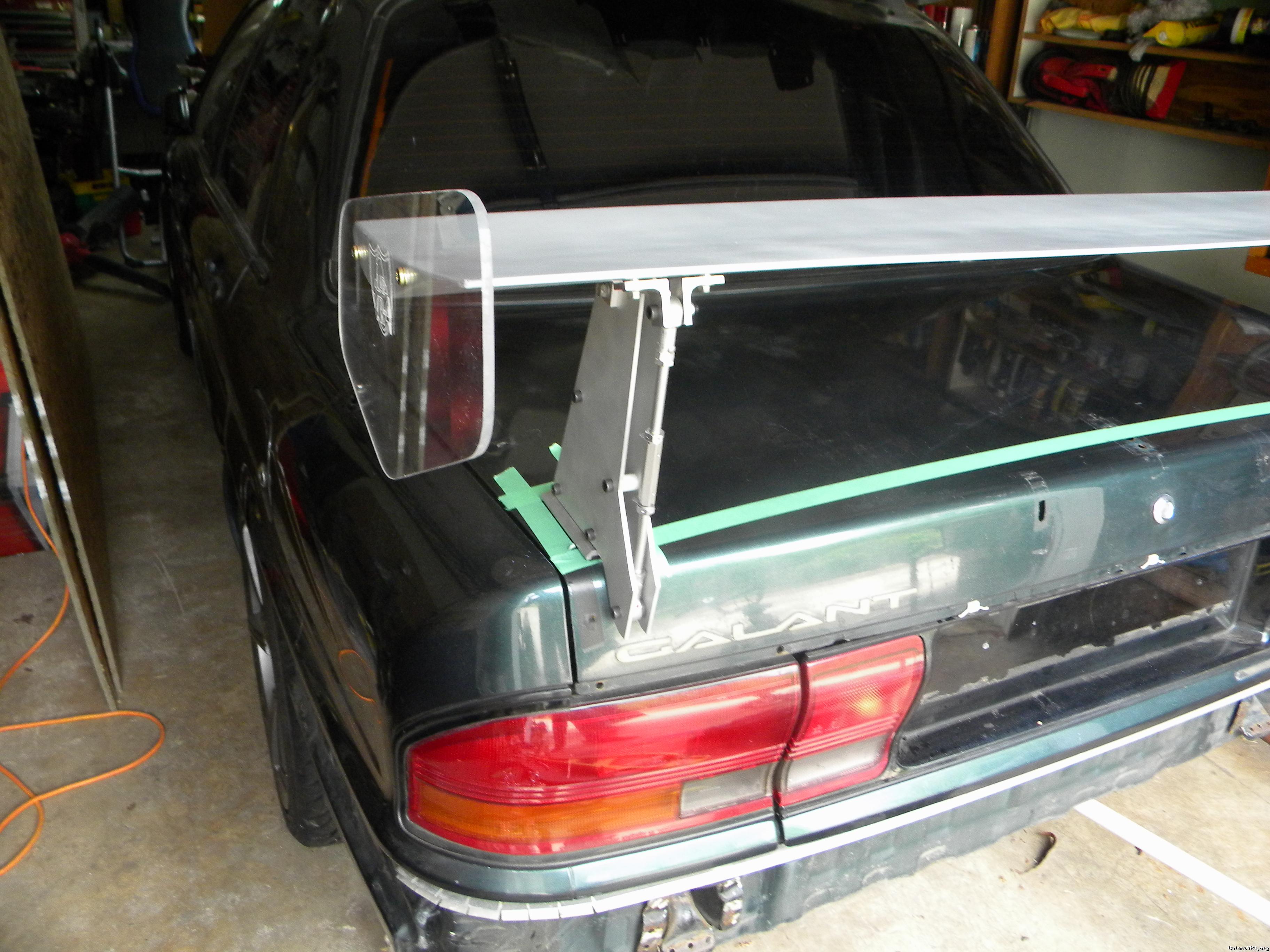

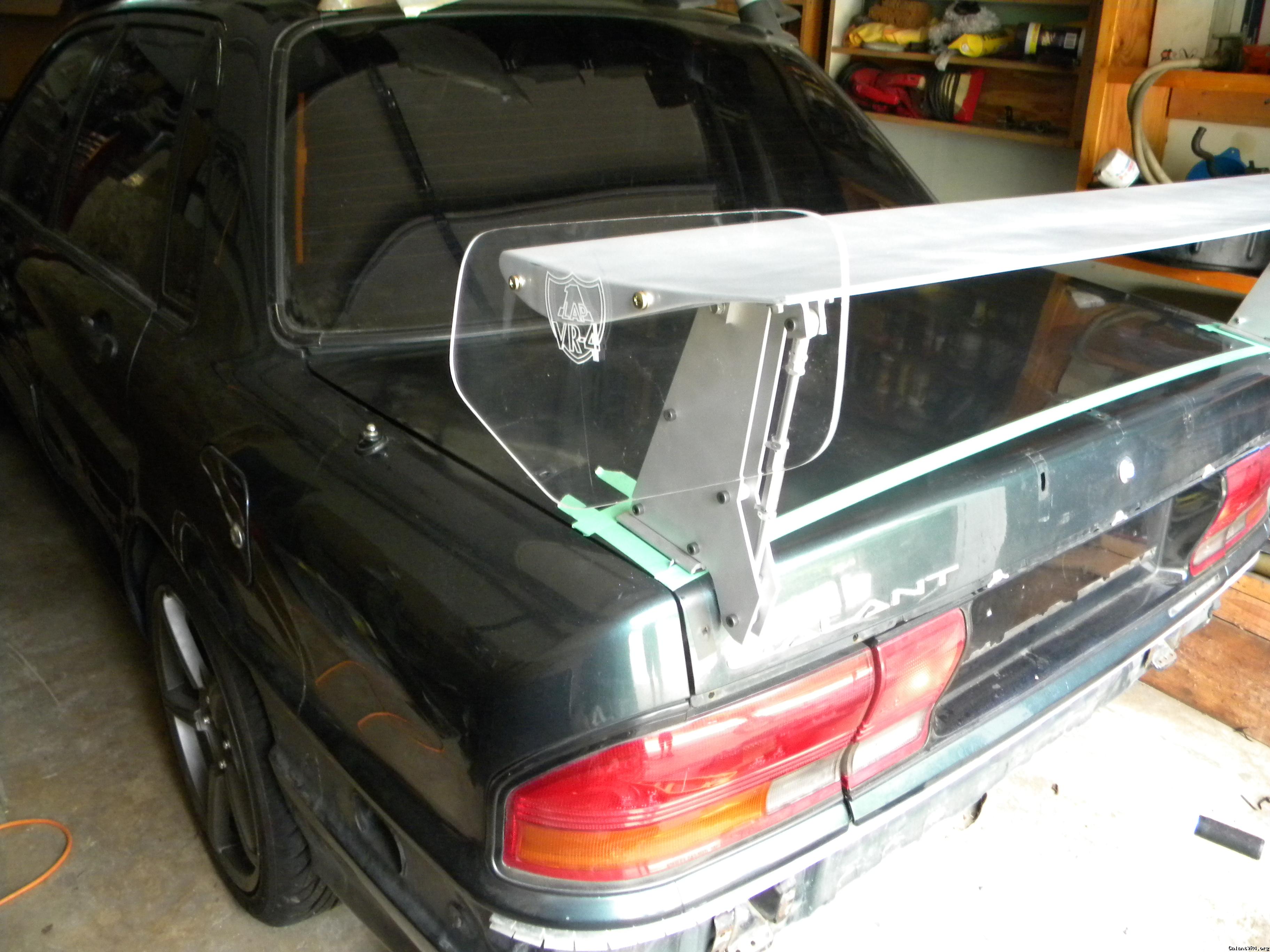

Glad you both like it, I'm glad I built it plug and play because yesterday the website said 2 to 3 days I just looked and they said delivery date is April 27....That's Tuesday so we cut it close. Looks like someones going to be wrenching Tuesday night.
I really wanted to build it different and what I envisioned was the way it is except you could pull a pin and then replace pin in a different spot and the wing would layback further in different spot until the wing was perfectly flat with the trunk for drag racing. /ubbthreads/images/graemlins/devil.gif Maybe later in the years you guys can replace the adjusters with linear actuators and have it cockpit controlled, I still think the system from a 3000gt VR4 or Crossfire would work just finding one is the hard part
Nice job, Curtis. I too like the nice touch with the one lap vr4 engraved. /ubbthreads/images/graemlins/cool.gif
