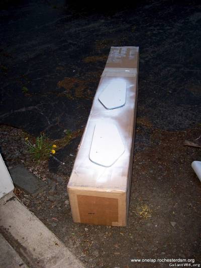

wing for the one lap team. done with pictures and shipped

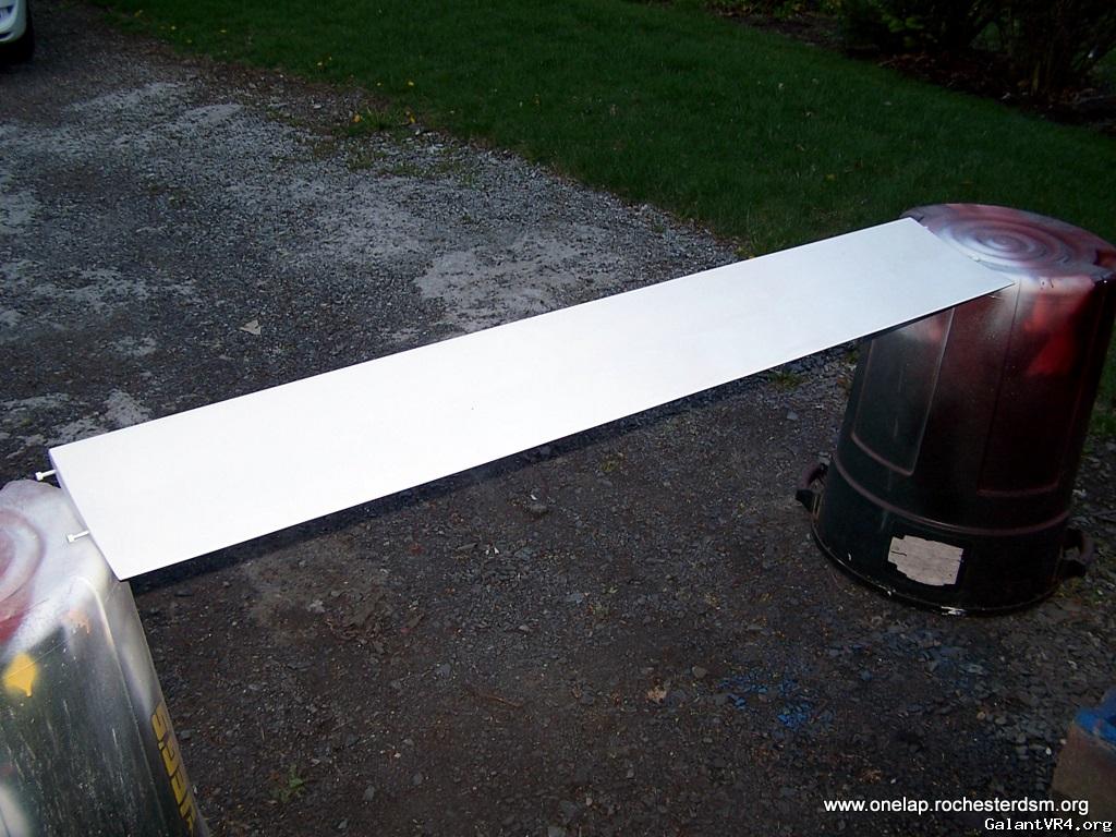

I will give you a big public /ubbthreads/images/graemlins/applause.gif wing was super sweet, only thing I've ever messed with even close to that was aircraft parts. Reminded me of the shape of an Apache tail rotor blade and noticed the shape was uniform all the way across. That's not easy to do I know on something 5 feet long.
Lots of times you see parts that are carbon fiber and the part doesn't have the proper lay or is wavy or twisted. This thing was perfect looked like it was a solid model from a drawing cut on a big dollar cnc mill.
You sir have serious skills. /ubbthreads/images/graemlins/worthy.gif

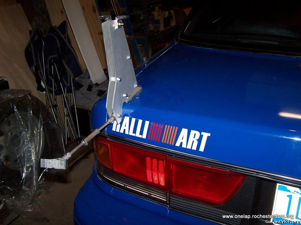

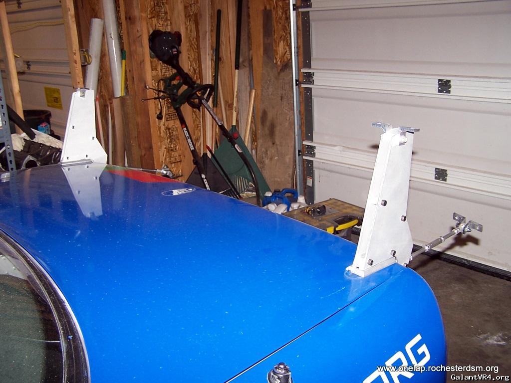

It is here and it is bad-a$$ that is for sure. The pylons look great and if you are around tonight Curtis I will give you a call to talk about the support under the wing.

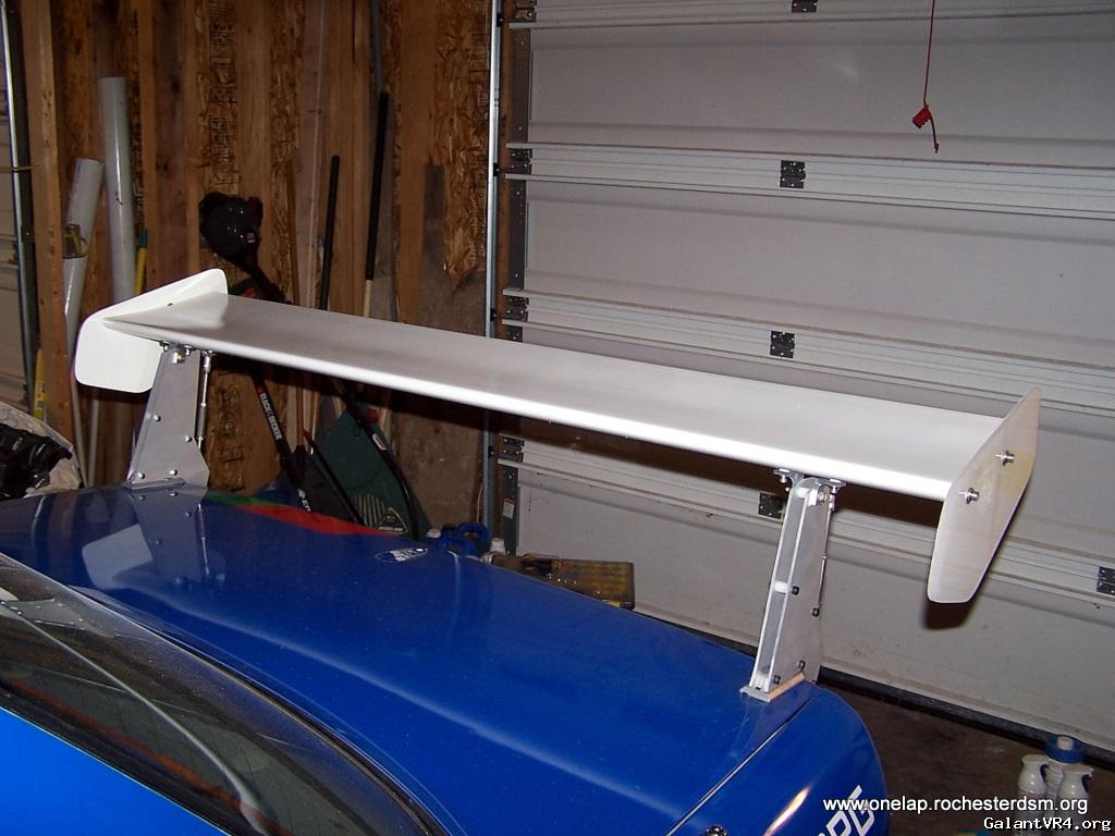

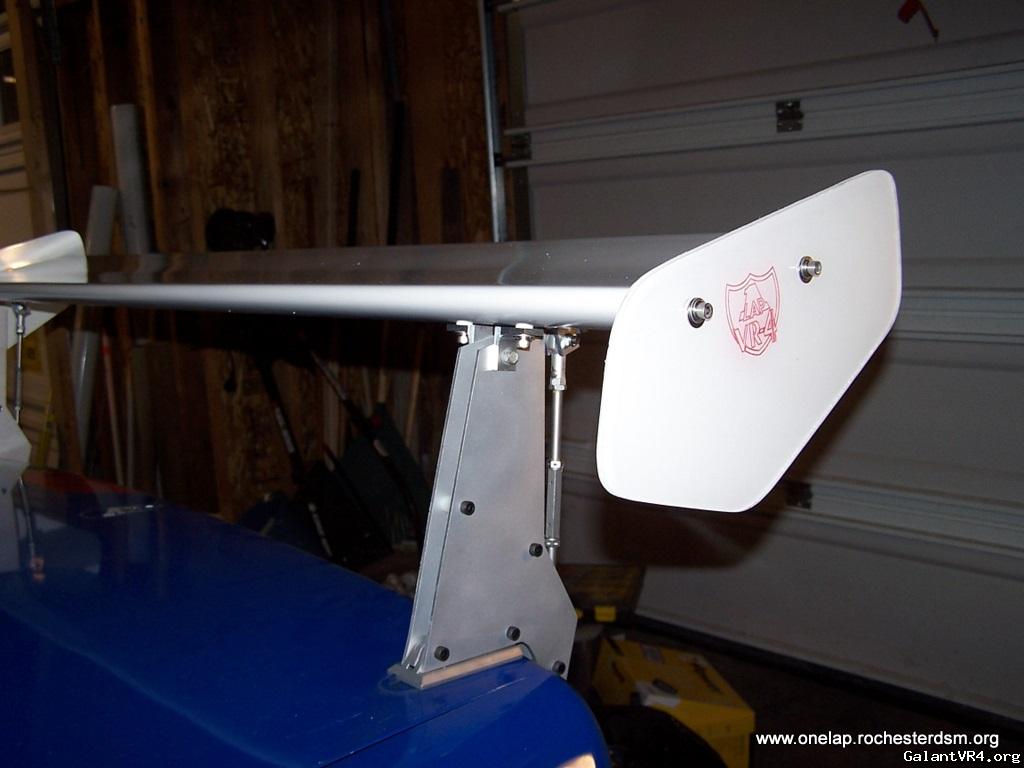

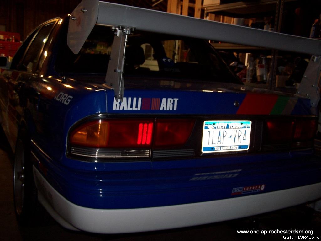

Steve and I worked tonight to peal the rest of the stickers off the car and to paint/mount the wing. We decided to go with white because it fit the paint scheme better then black. Once it was mounted it took me a second to get used to it but every time I took a peak at it I liked it more and more. The car just looks mean and with the front splitter on its going to look nasty.
I wish there was more drama to write about but Curtis is the man. The pylons fit the car and the wing fit the pylons. It was too easy. Here are some pictures from tonight. I'll get some more tomorrow in the light of the day.

I like it and the angle of attack on the wing looks close. It was hard to really tell on mine nothing but a shell so the nose is up in the air. Can't wait to see it with the splitter up front in a 50ft away shot. You guys did good with the white paint. /ubbthreads/images/graemlins/applause.gif
Just wish you guys had a track day before you leave to get the splitter and the wing dialed in. A thin pressure sensor under the wing mounts would help but no time to score one this late in the game. Maybe a few on ramps on the interstate could help at 120 plus /ubbthreads/images/graemlins/devil.gif

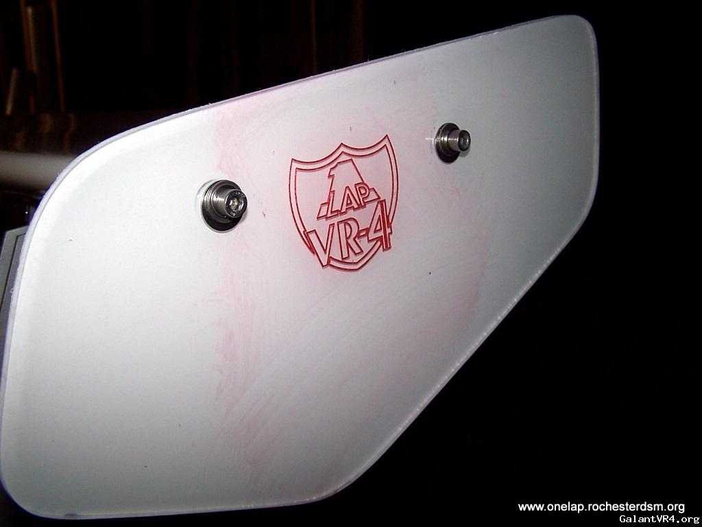

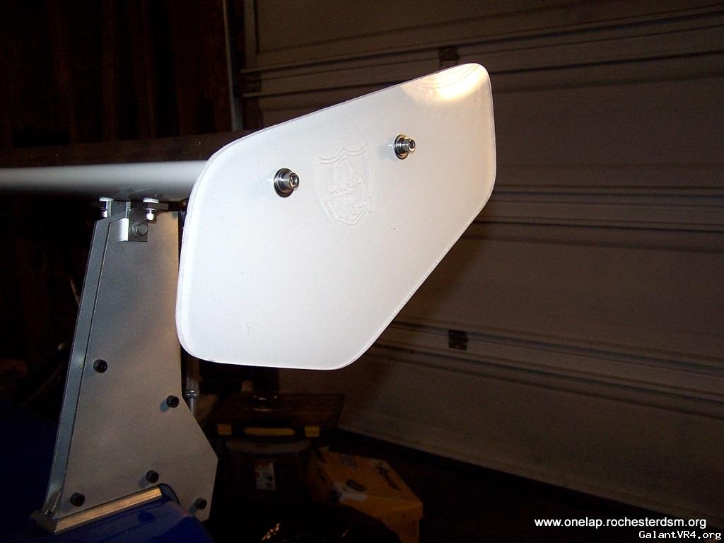

I forgot to add a few photo's where I highlighted the logo in red. I didn't want all that hard work to fade into the background. I went back and forth for the last couple of days worrying about how to paint the wing so I am glad you like it. I think it fits the "Works Rally" theme pretty well.
GreenGSX
May 15, 2005
681
Rochester, New York
The red is easy. Just get a toothpick and go to town. Just kidding.
I used rattle can high temp engine paint which is what I had on hand. To put it on all I did was spray it into a shop rag and then I wiped the color into the logo. I let it set for a few seconds and then wiped the excess off with isopropyl alcohol. It takes a couple of coats but the key is the IPA which wont spal the polycarbonate. Still needs a few more coats to get it even but I like how the it makes the logo pop.
