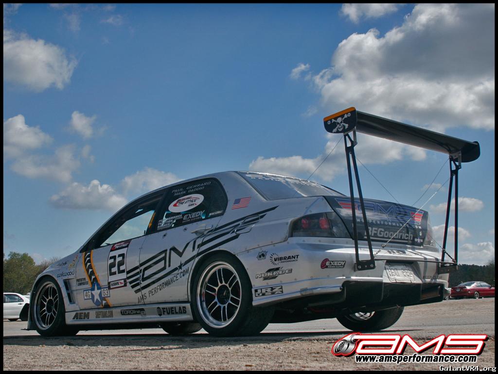

Curtis, I was looking at the Aeromotions R2 wing that AMS sells and noticed that there is an additional bracket that attaches to the bottom of the wing on the nub. It's triangular with two points mounted on the pylon and one on the wing. The adjustable rod provides the second wing attachment point. Is it possible to just make that triangle bigger to get more height out the pylons you already have? The adjustable rod could just be extended pretty simply.

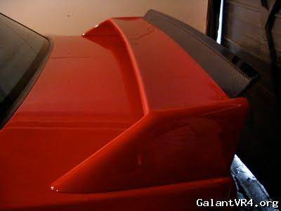

How about something like this on the stock vr4 wing it worked for the bmw e30 m3 dtm?

If the One Lap team is on a budget, I would vouch for going with an evo rear spoiler as they are higher and more aggressive.
If the team has a little dough to spend, get a spoiler like the piece from AMS and get it about a foot or a little less off the deck lid as far back as you can. I know I'm speaking in very general terms, but really that's all you can hope for at this stage. Real accurate aero takes copious amounts of time and money. If you don't have both of those, then the best thing you can do is make an educated guess. Based on my experience, that guess is to go aggressive wing and get it up and back.

Without giving too much away the team was offered a wing that is similar /ubbthreads/images/graemlins/wink.gif to the AMS R2 wing that I linked to. So the design of the wing isn't an issue. What we need to know is how high off the deck should it go? Curis has pylons already that are 6" high which I thought was too low. I was thinking it should be close to the height of the roof.
