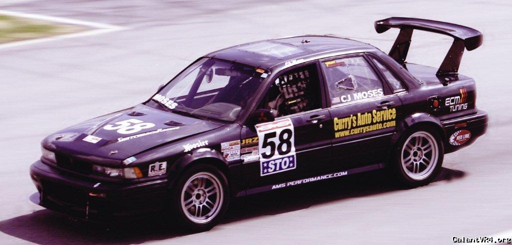

wing for the one lap team. done with pictures and shipped
^^^the way the above works is by looking at the bottom. that huge channel under the car is what I was mentioning in my previous posts about creating areas of low to negative pressures under the car.
Also, the car above is a front wheel drive drag car that typically goes straight. you really don't need down force in the rear of the car, but you do in the front.
I think the simplest solution is to the wing very high, and removable. You could buy wing struts for air planes to create the vertical portion of the assembly. Then buy some kinda off the shelf airfoil for cars. Create some kinda bracket that protrudes through the bumper that attaches to the wing and can be removed with ease.

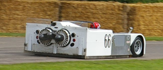

Ok, time to get serious with some suction fans a la Chaparral 2J
The vacuum-traction system allowed the chapparal to generate up to 0.5 g more lateral acceleration during cornering; at all speeds.
2J at Watkins Glen

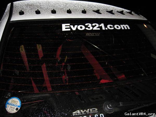

Quoting evo8ya:
here are some universal vortex generators that would help direct air to the wing. I've seen before and after vids using the string tests and they really do work.
My official vote is VG's and an oem Evo III wing. IMO it's the only wing that follows the e39a's body line w/o looking out of place. I was searching through my hard drive looking for pics of one mounted but couldn't find it. I know it has been done though.
Here's an example on a Evo III.
