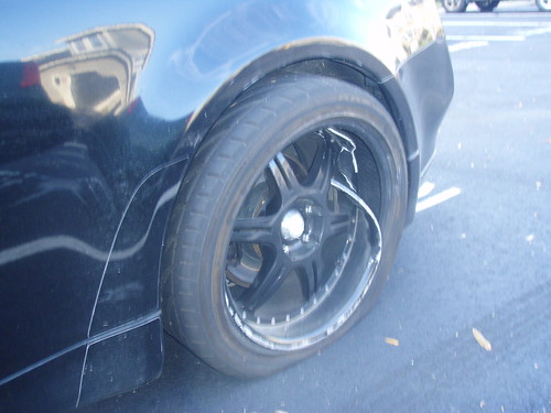

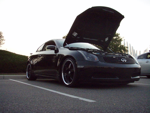

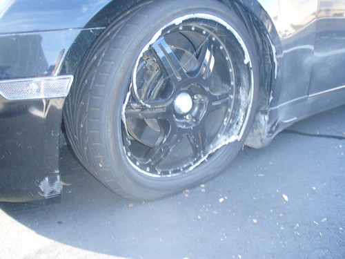

As long as you a aware of what can happen to cast rims. I don't know your budget, but nice rims pop up for cheap from time to time. I had a set of Gram Lights 57Pro (4x114.3) for under $600 shipped from Cali. And I just pick up a set of 3-piece Work VS-XX (4x114.3) for $700 shipped from Canada.
Try looking at 240SX forums, the S13's had the same bolt pattern as our GVR4.
Here are a Set of Stern ST-2's,(cheaply made Cast rims) I had on my G35.
Here is what they should have looked like. Notice above the whole polished lip is missing.
I'm glad I have another set of rims laying around, otherwise I would have been sucking.
