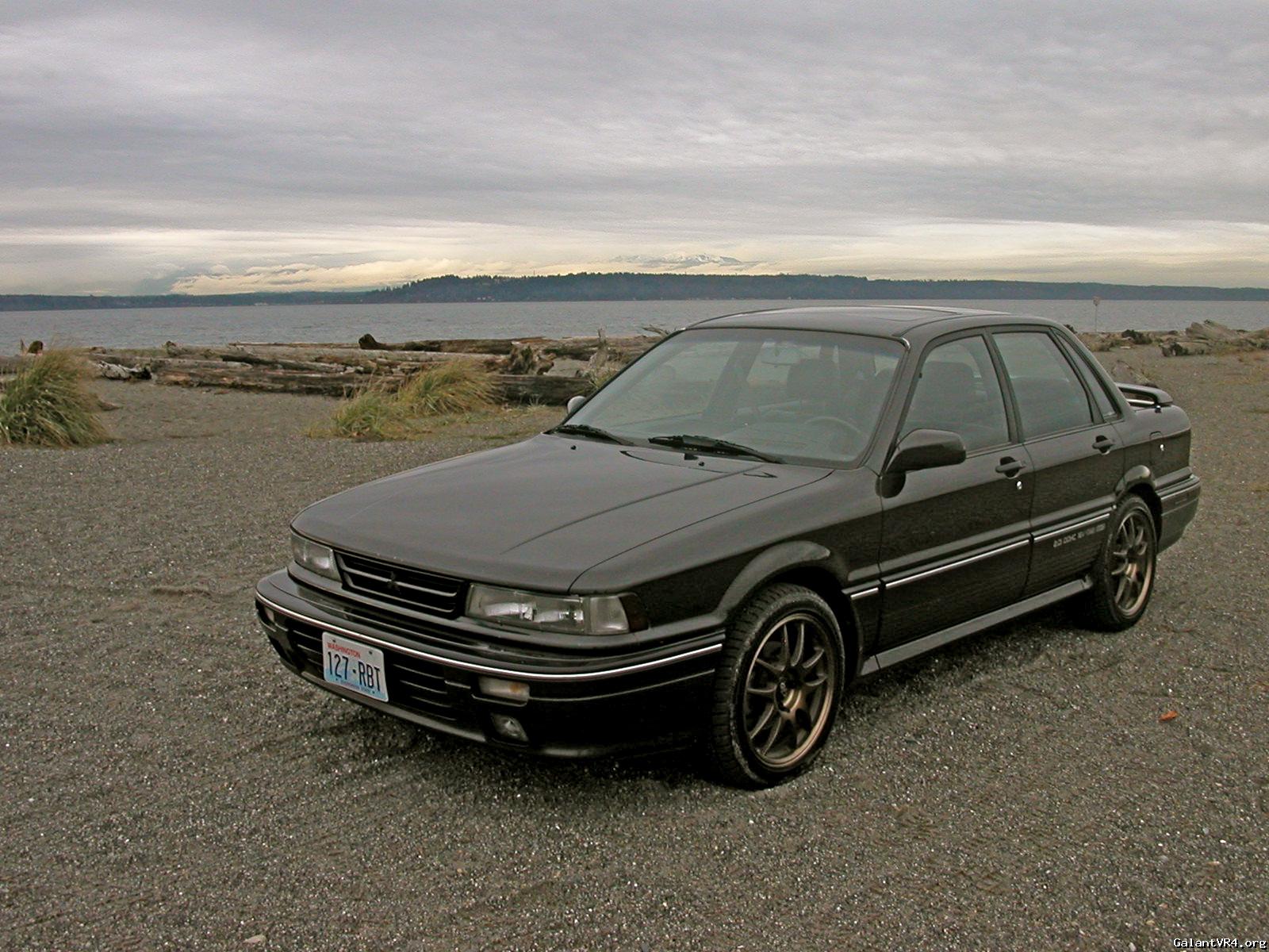

For example, here's my car now.
I absolutely love the look of these wheels. The color, and the style fit right in with what I want this car to look like when its finished.
