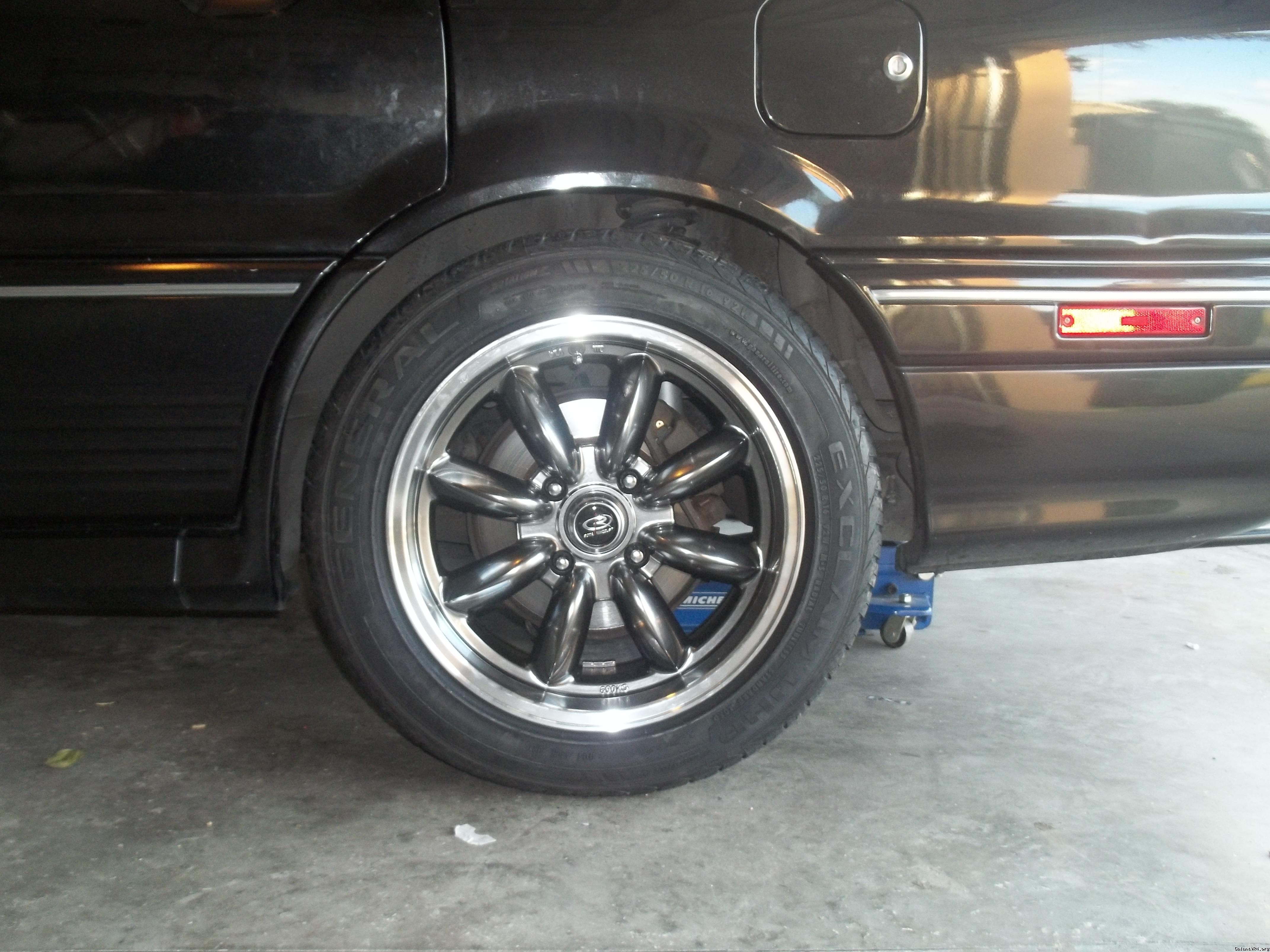

I purchased just 1 225/50/15 tire and mounted it on the rim to see how it looked, Pics don't do it justice . It now looks real old school. Now I get to save for some coilovers

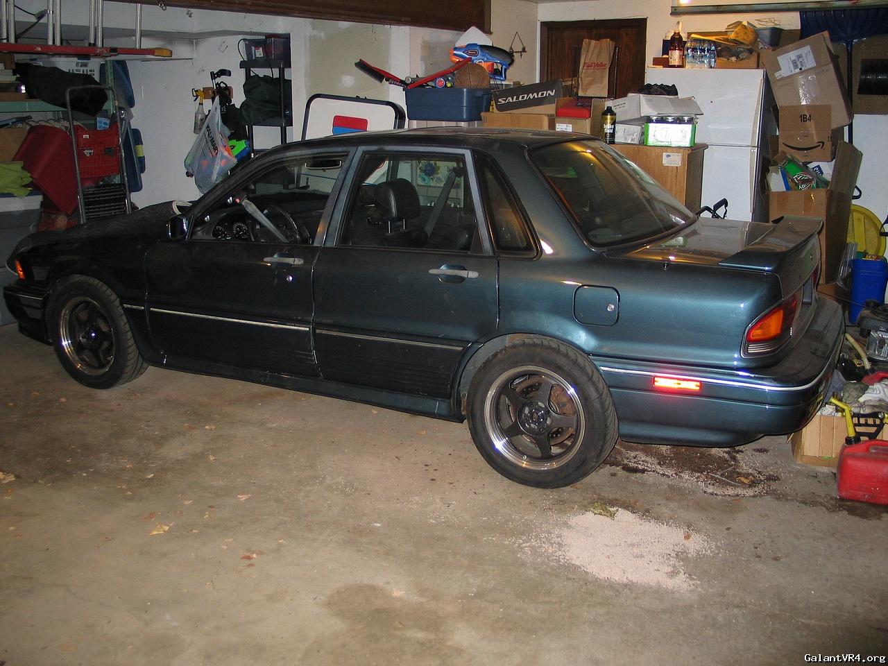

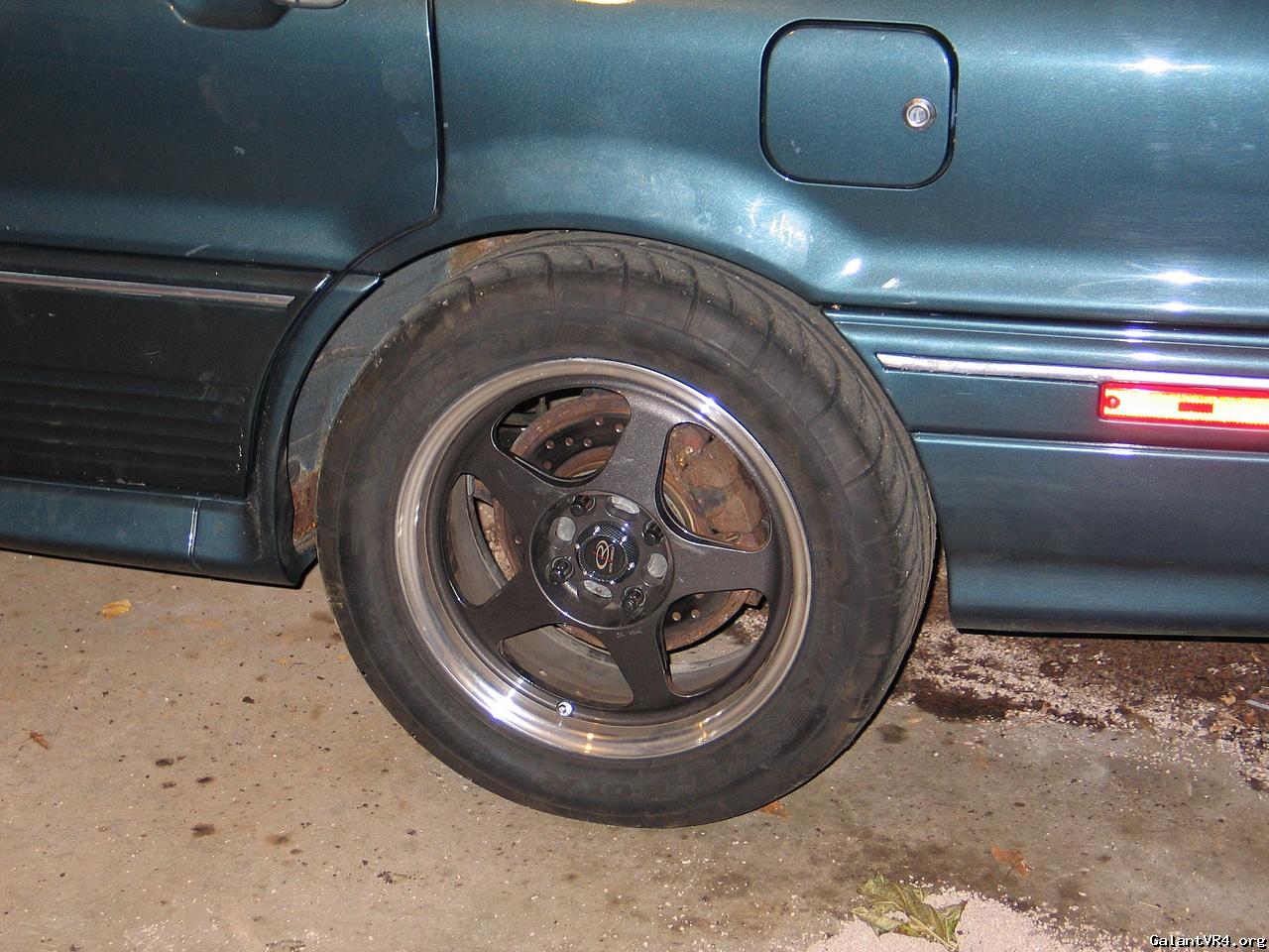

Quoting Struc:
I can take some more pictures if you want. Hopefully this helps. I believe my rims are 7.5" wide, however.
The tires are Bridgestone Potenza RE01R, 225/50/16 on Rota Slipstream wheels.
Ignore the wheel well gap. I have H&R springs with GR-2's on it now.
Same set up as I wanted to do. Can you take a pic of the car from the back?

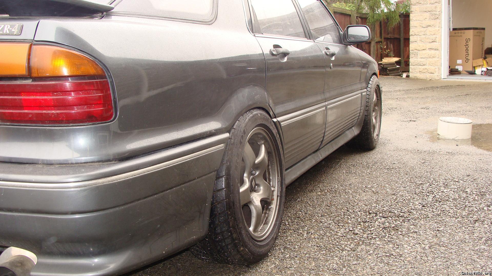

16x8.0 with Bridgestone Potenza RE-01 225/50R16. I actually preferred the profile the 245/45R16 had

Quoting RedTwo:
Yeah that's a little too proud of the wheel wells for me! Is that an odd offset because those stick out a long way for 8" rims. I'm pretty sure the 18 x 8s on the other car tuck under further than that!

Yeah... the offset is up the shooter - the wheels are +30 but the center bore is too small by 2mm so they're spaced out another 10-15mm (or maybe more) to fit. I really need to get them down to the machine shop!

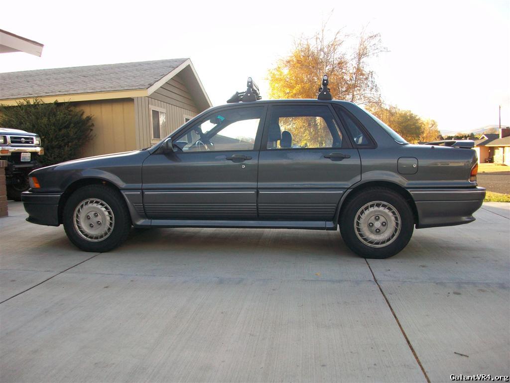

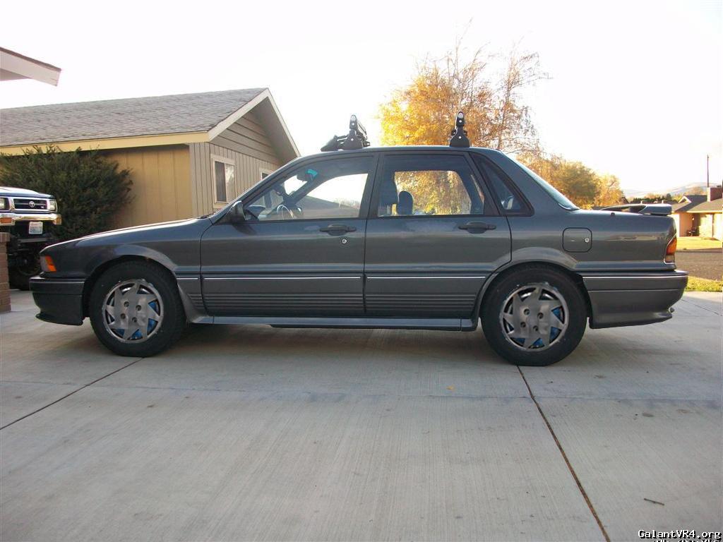

11,993
It's the perfect size for snow tires, IMO. Super easy to find since it's a common size for Subaru Legacies. I picked up all four of these in good shape for $50 off Craigslist last fall.
