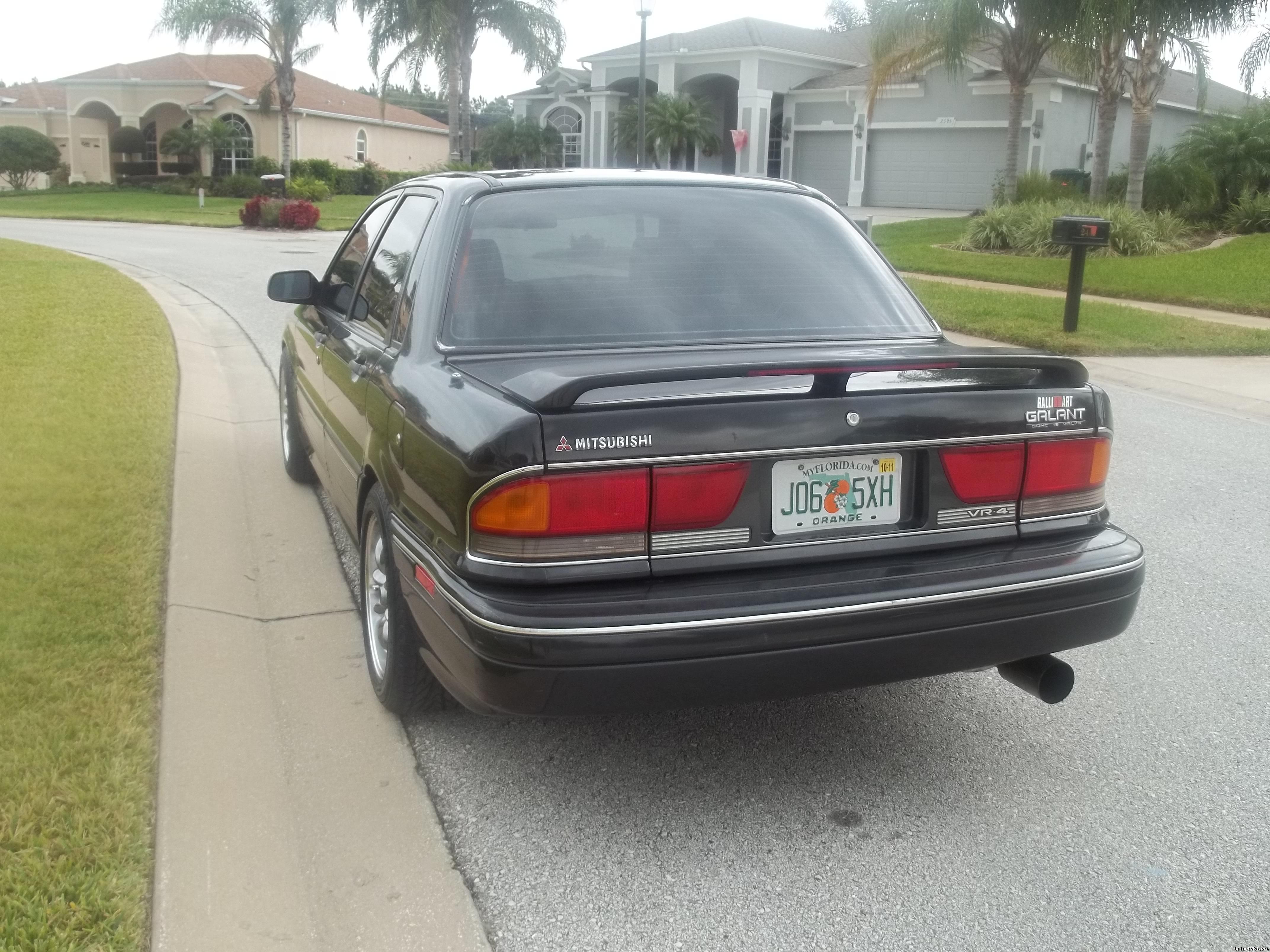

I wanted to see how wide the tires looked if someone was driving behind you.

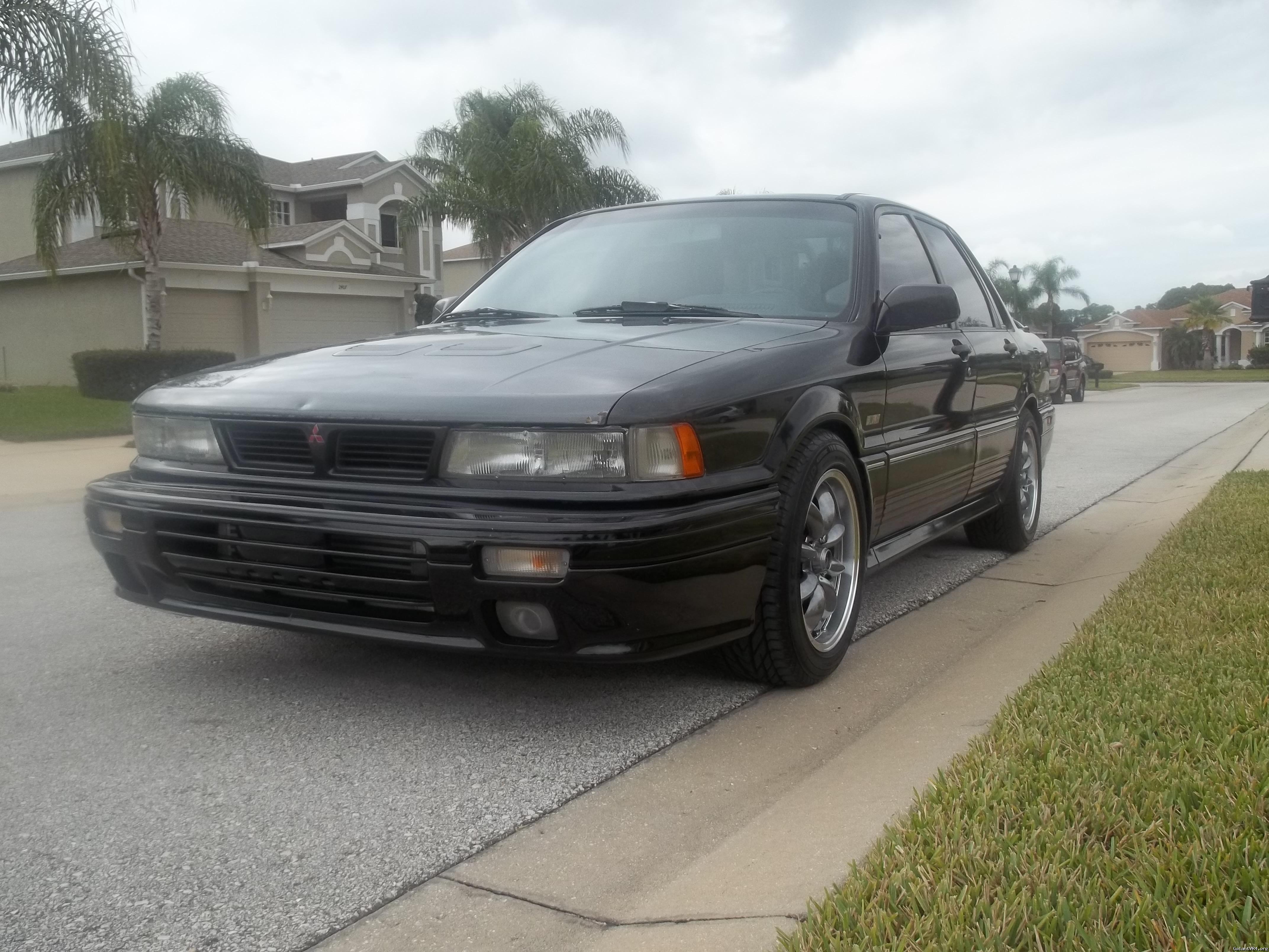

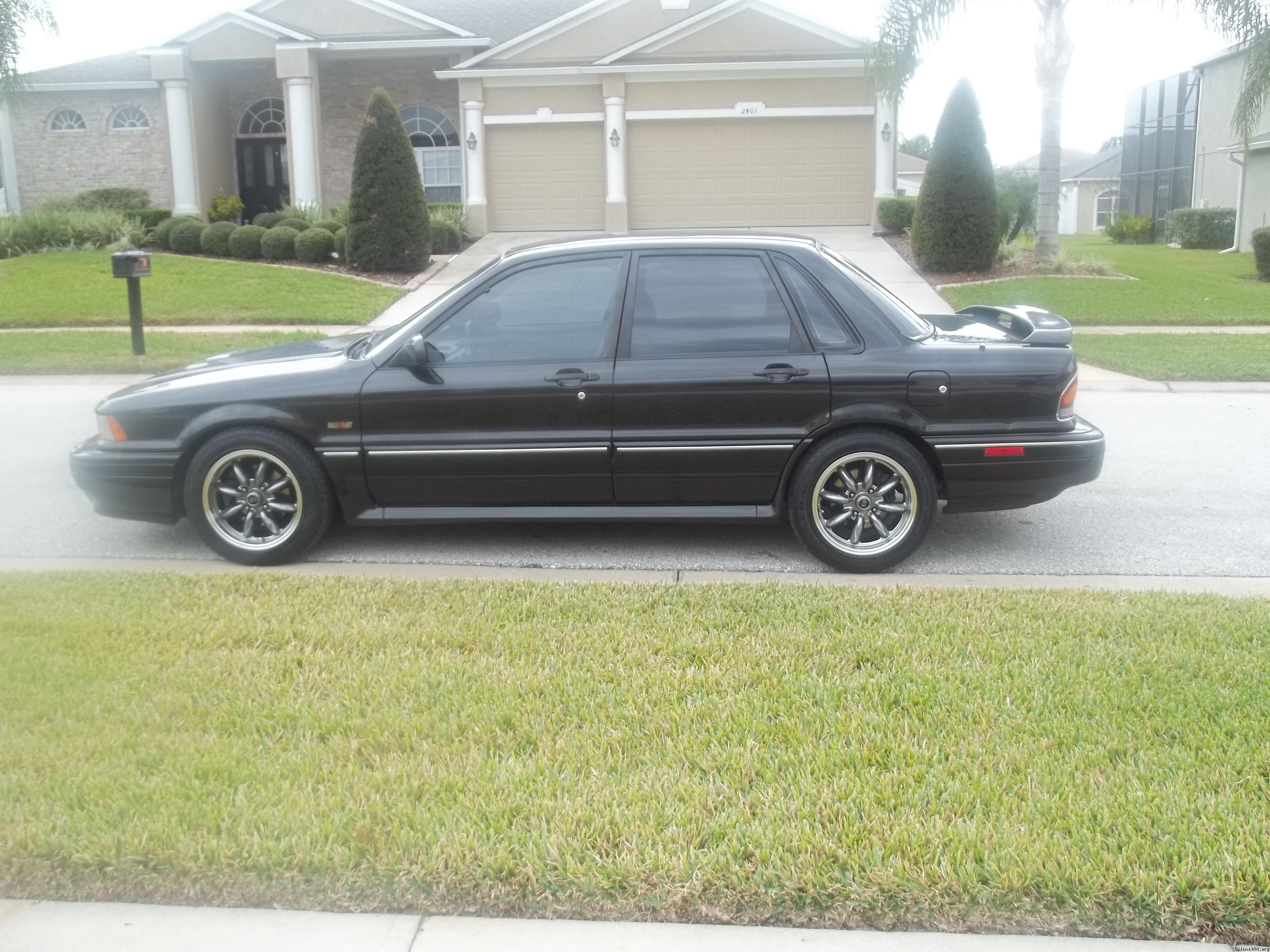

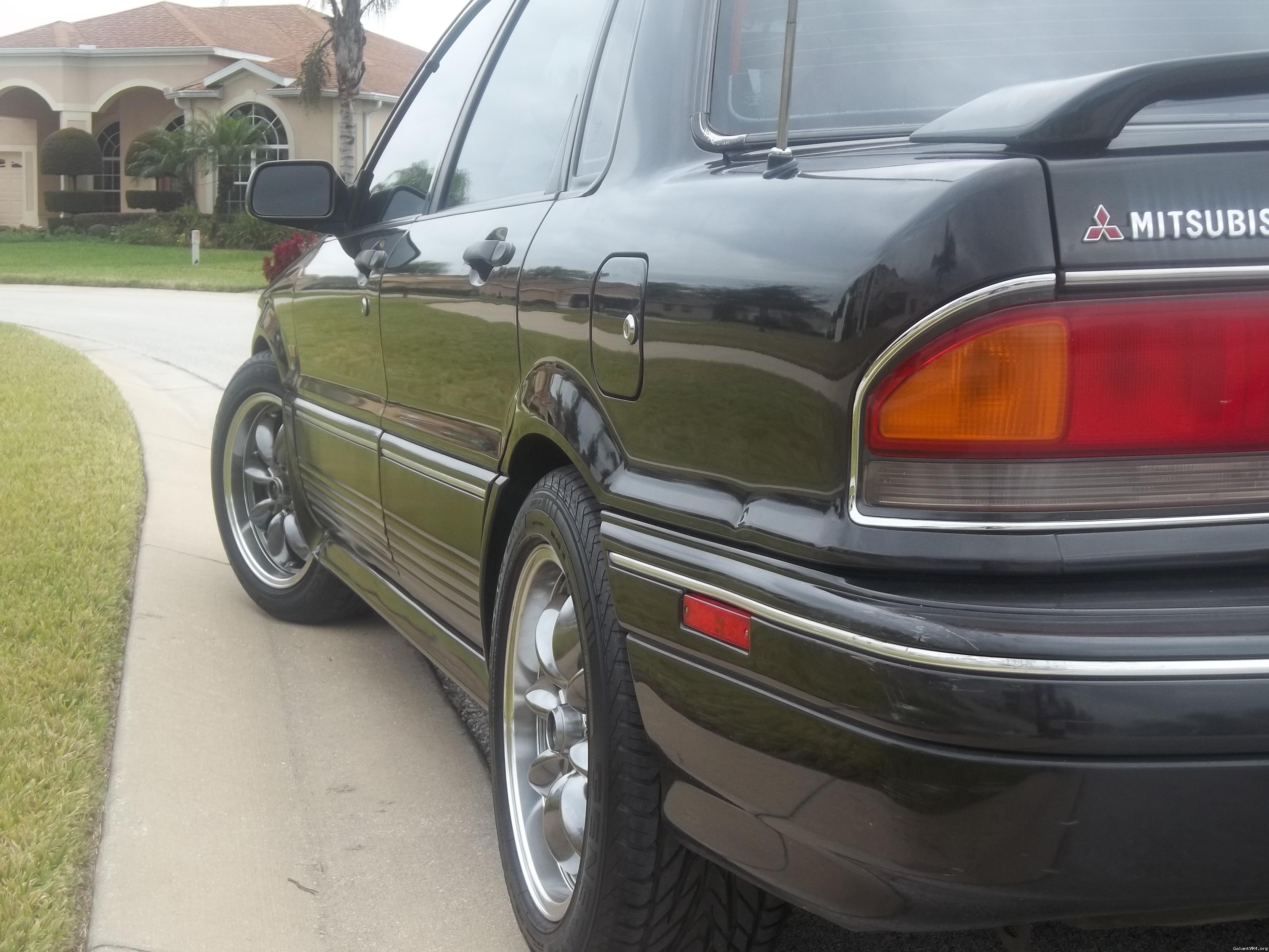

Some pics of the wheels on the car with 225/50/16. Wheel and tire combo weighs in @35 lbs 2oz.

Quoting vtecds1:
Ah. Ok, how about this picture...
