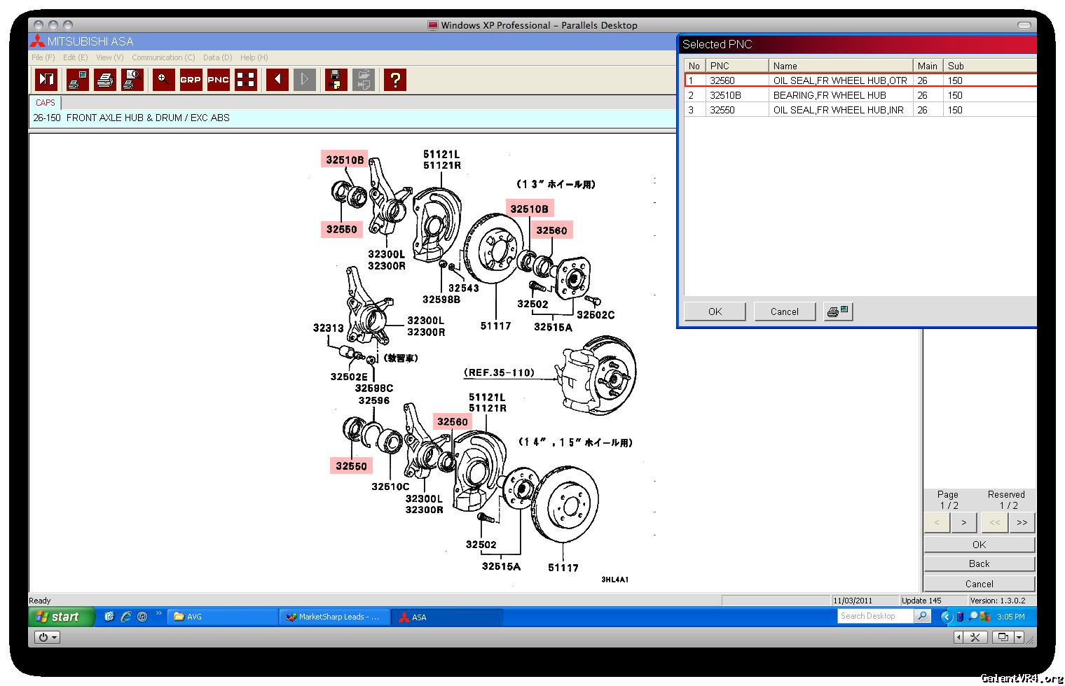

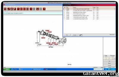

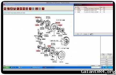

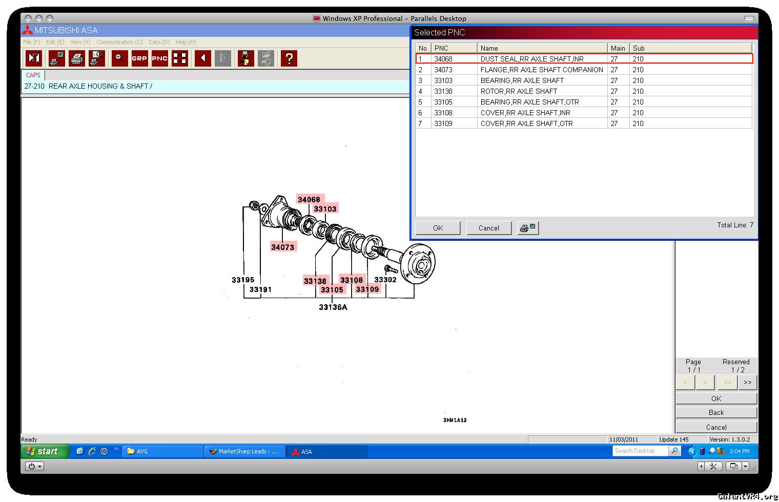

Looks like CAPS is showing two bearings per assembly for the rears (as best I can tell), and one per assembly for the fronts.
Here are screen captures of the part numbers.

So I need ALL of that stuff you highlighted?
For the front I see this:
32550 - Oil seal
32560 - Oil seal
32510B - Bearing
For the rear I have no idea because there is like 4 dust shields and alot of stuff /ubbthreads/images/graemlins/rofl.gif

I believe all the parts are the red-highlighted ones, and they are also in the pop-out box to the right.
I think for each rear assembly you'll need:
1x 32550 - Inner Seal
1x 32560 - Outer Seal
2x 32510B - Bearing
But perhaps Steve can confirm?
There are two different bearings in the back. 33105 is the outer bearing, you also need 33103.
The part number's for those are:
33105 - BEARING,RR AXLE SHAFT,OTR - MB569972
33103 - BEARING,RR AXLE SHAFT - MB290175
They say Right Rear, but it's the same for the left side.
